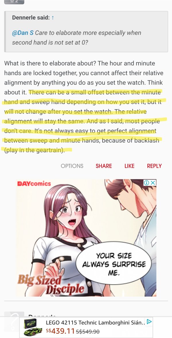

@Dan S
Your post was edited. The yellow part of your message in the attached photo only came about when I was writing my message and I posted it.
