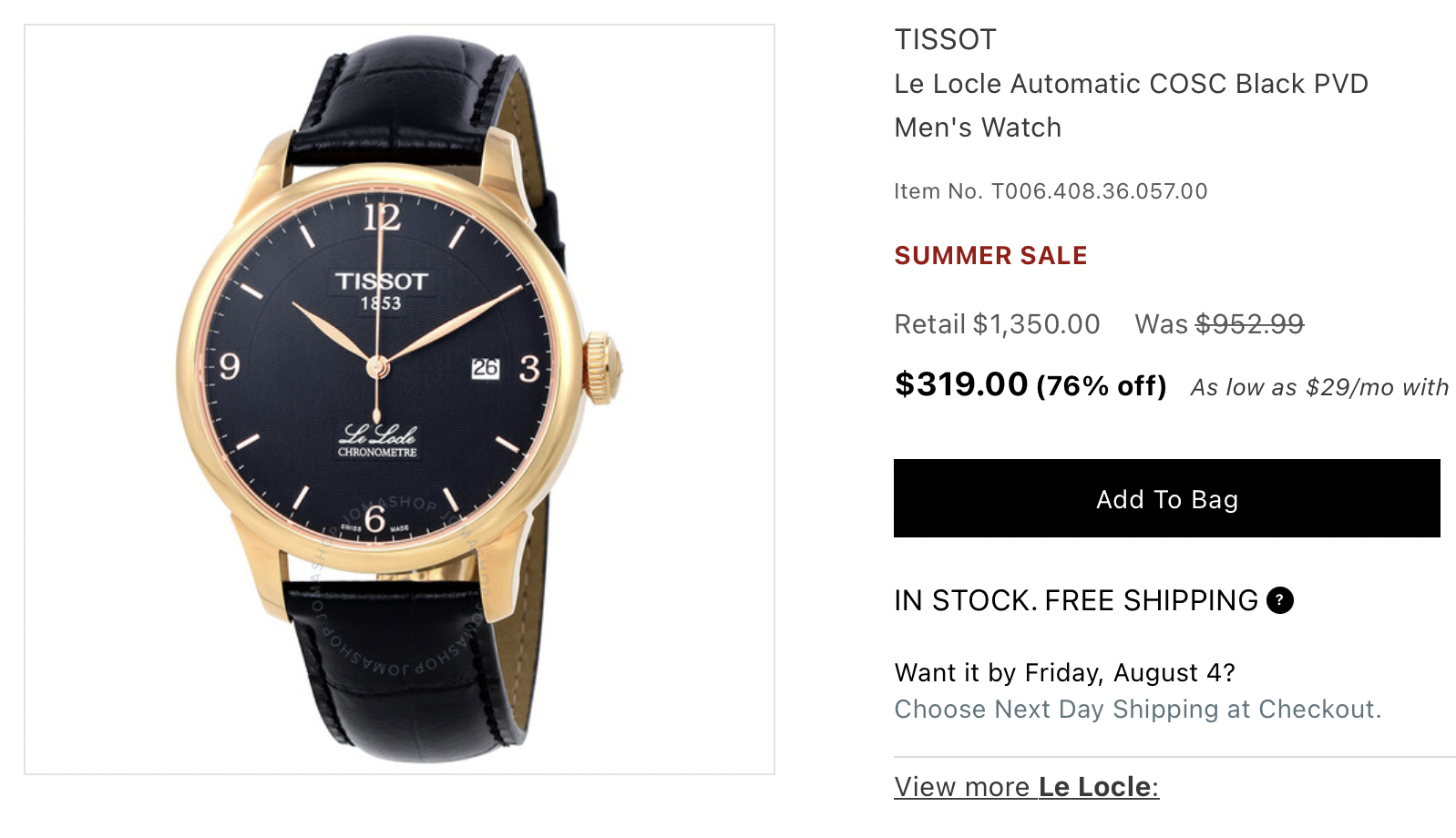

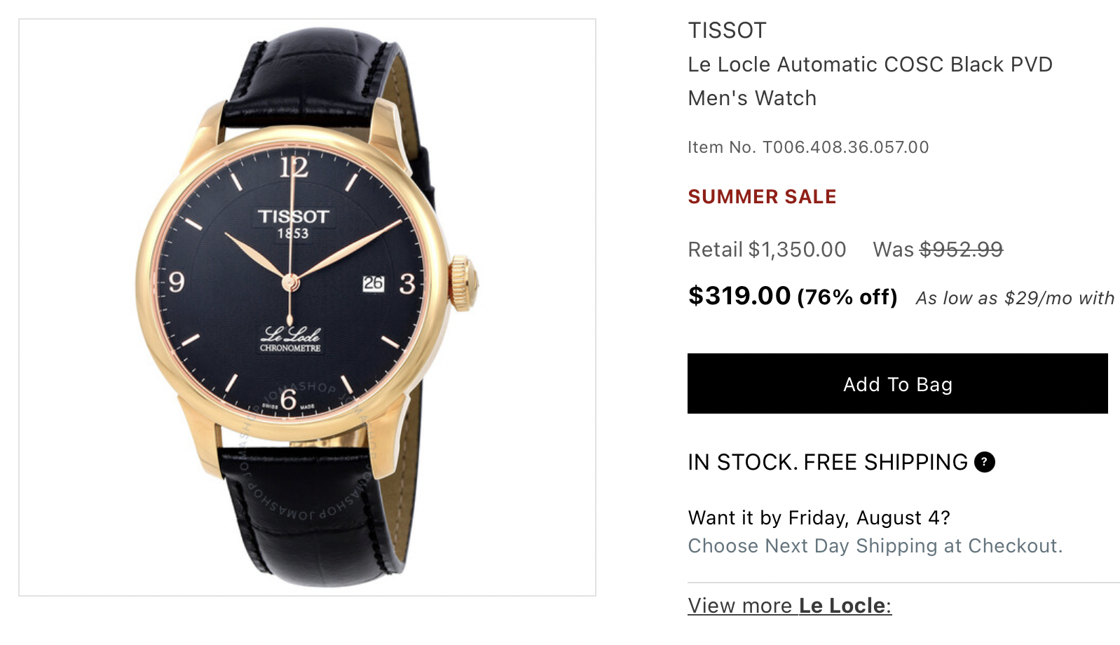

For practical purposes yes, I personally don't need any precision down to the seconds level. The TISSOT below is COSC certified, I have it but the goldish case is a little too flashy for my taste though. And look at the price ! It can even be used as a beater at that price ::psy:: I don't need that level of precision for my daily life.
