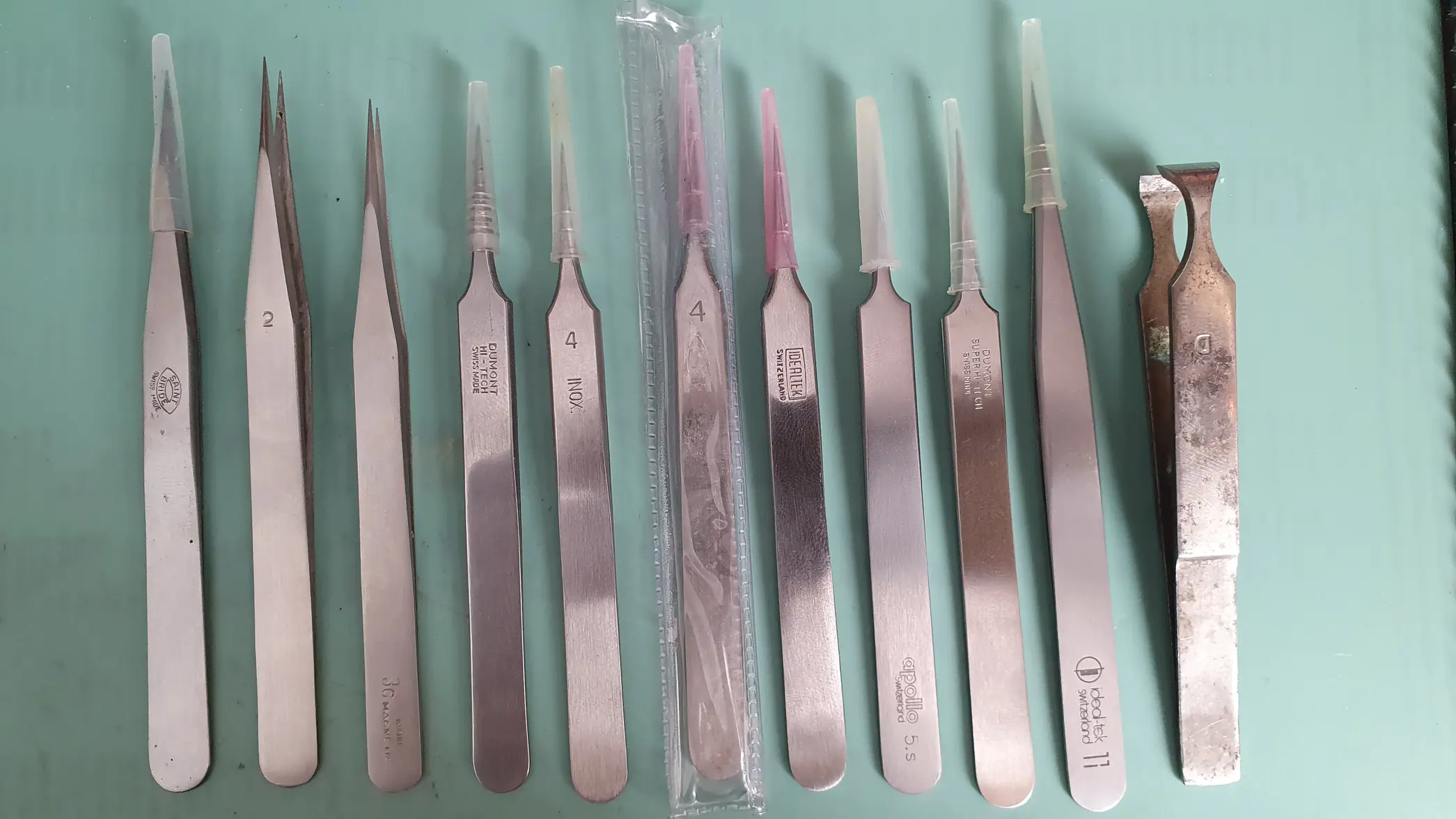

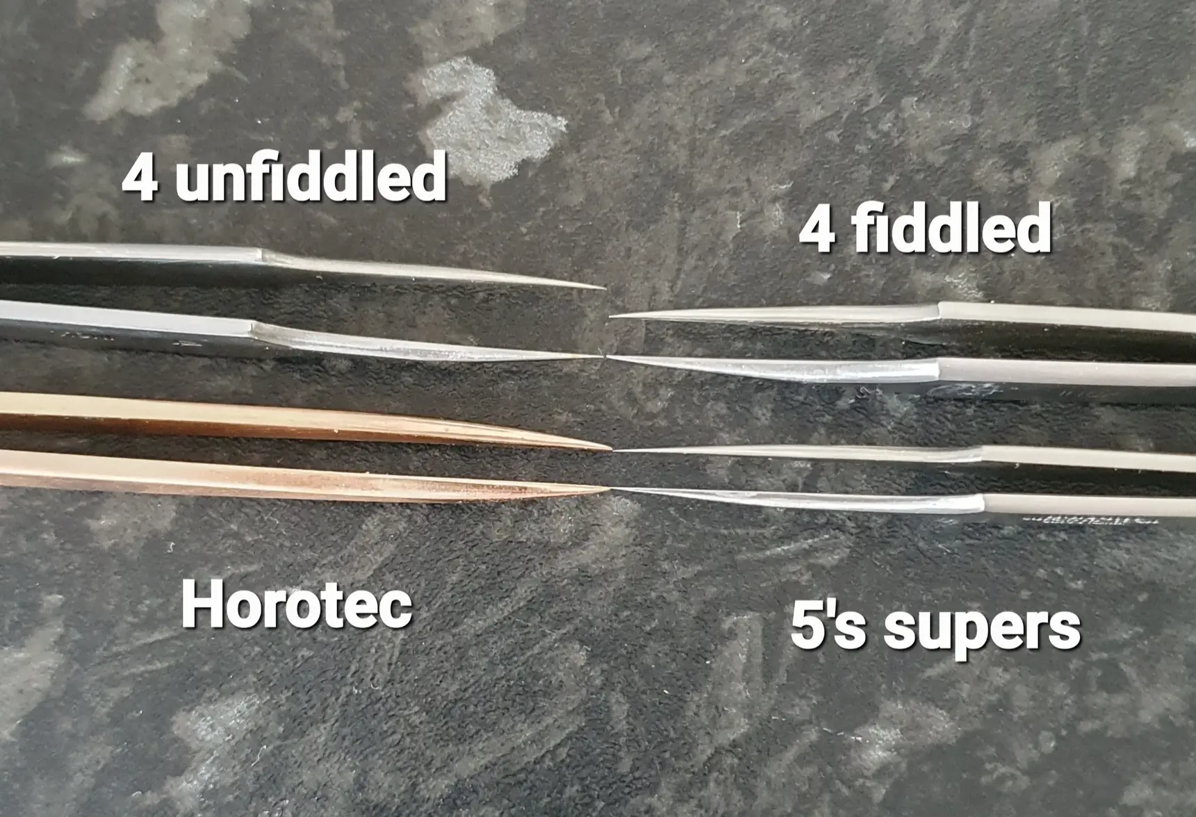

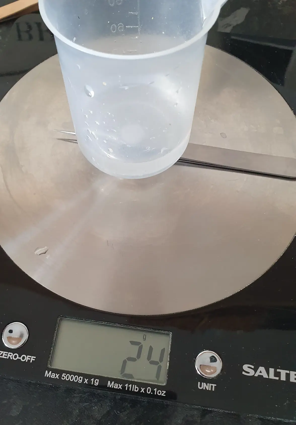

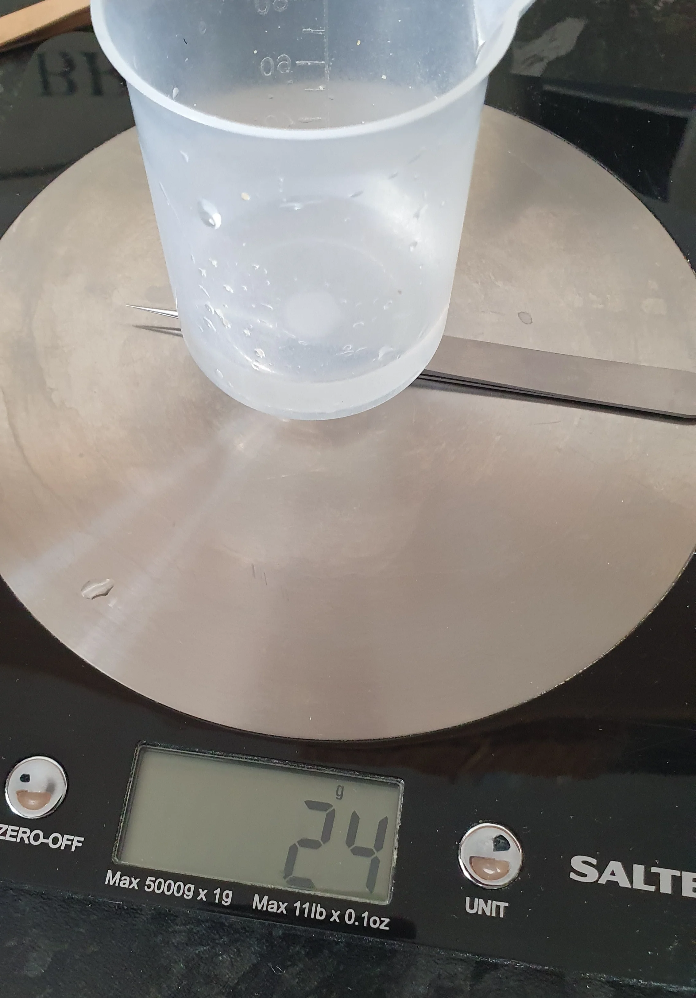

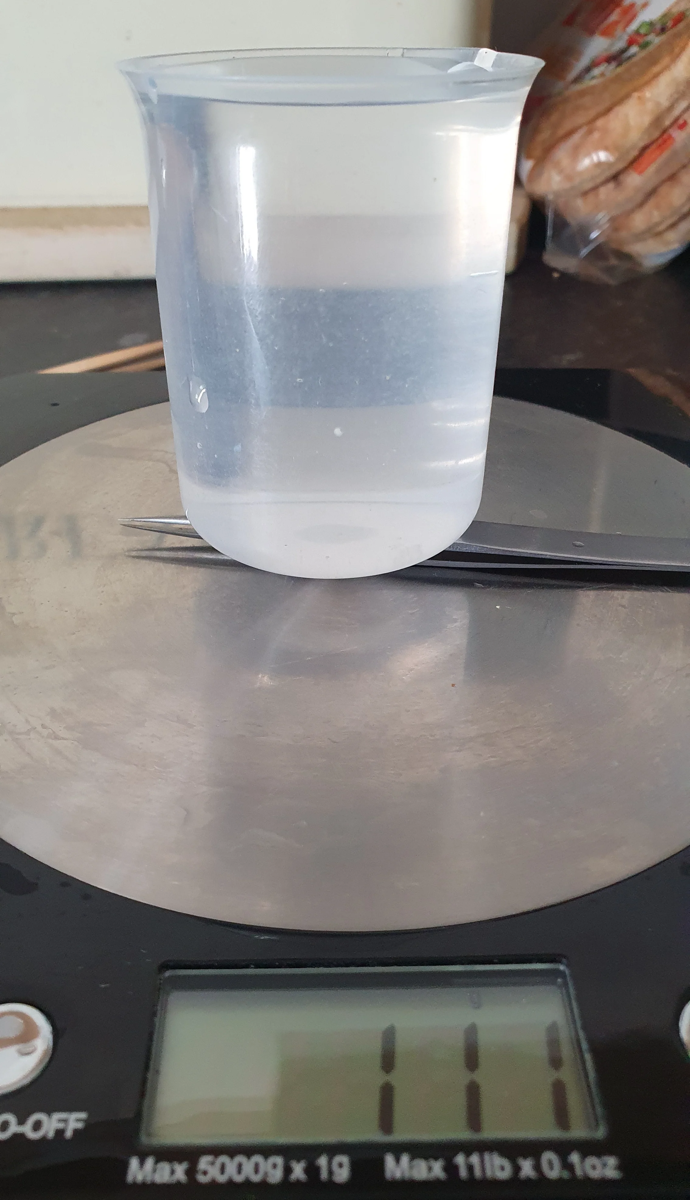

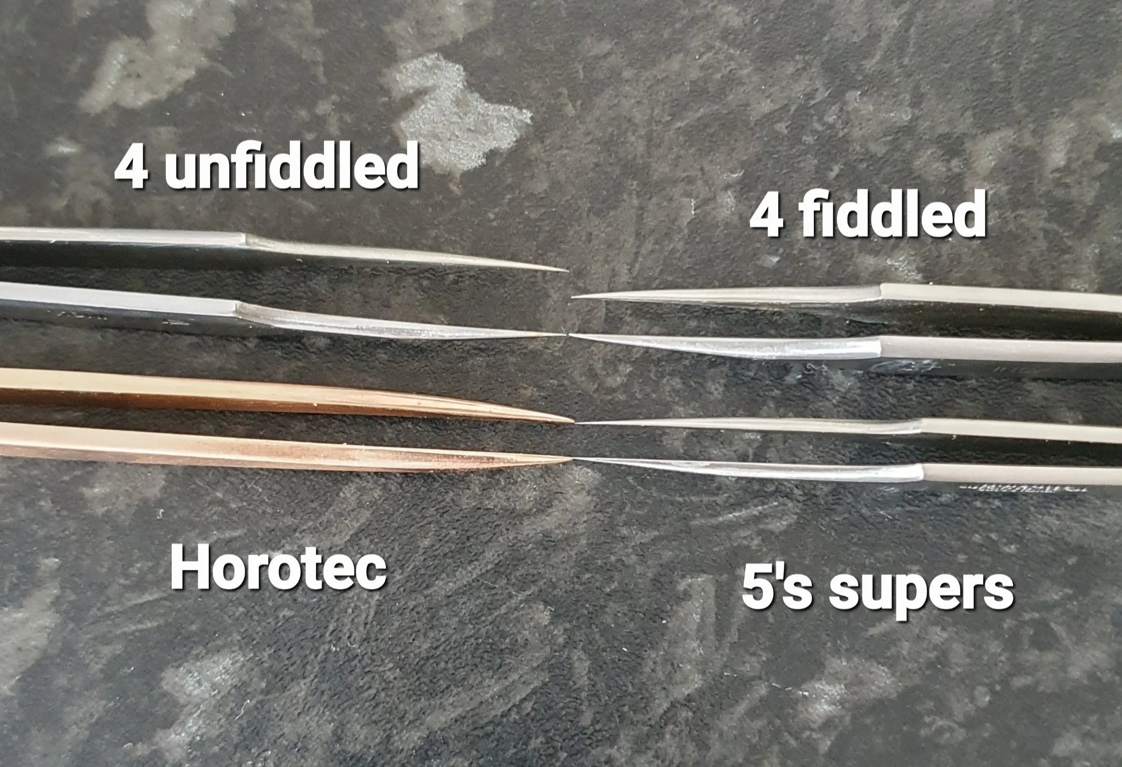

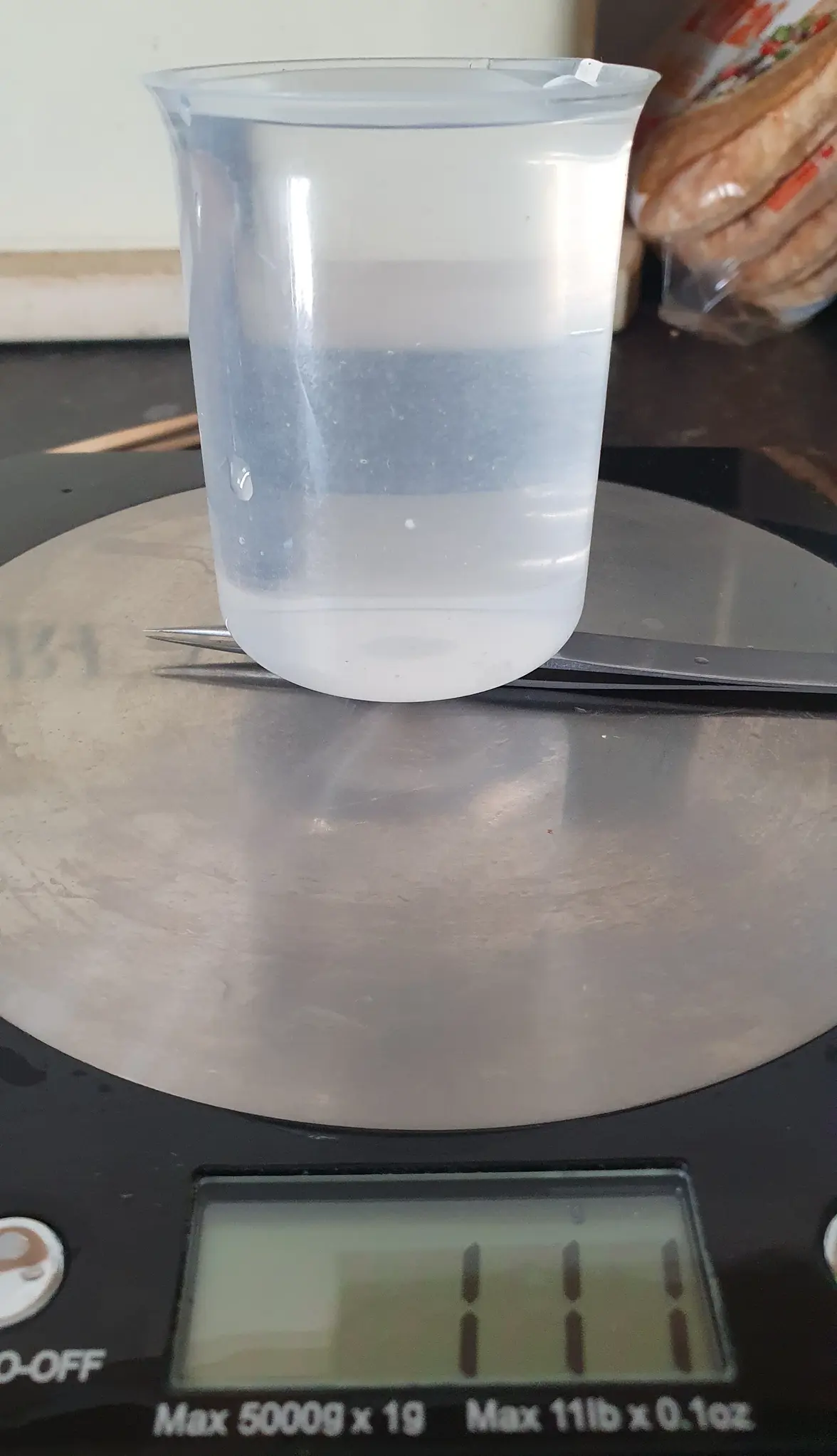

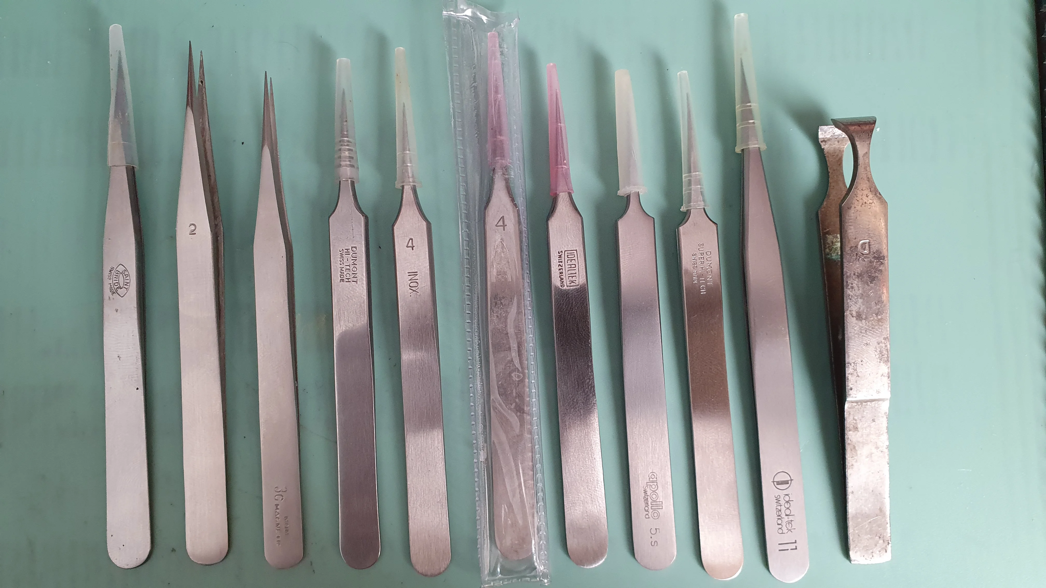

One more recommendation regarding tool acquisition: have a look on eBay
As a frugal kind of fellow most of my tools are second-hand. These just arrived for £45 delivered. 3 Ideal-tek (the older ones are nicer), an Apollo (not bad) 2 anti-magnetic cheapies, a Saint Bride, some snips and 3 Dumonts, 2 of which are hi-techs (4's) and a super hi-tech Dumoxel (5SA ?). The Saint Brides are very nice but I can't find much about the company? The Demoxels are incredibly light closing so I thought I'd try @JimInOz experiment: A featherweight 24g! Probably too light for my sausage fingers, my everyday bronze Horotecs came in at 39 and my Fontax 5's are 41g. The normal Hi-techs maxed my scientific apparatus out but came in around 130g I decided to level the playing field and adjust their openings to the same size The Hi-techs came down dramatically to 51g and the Dumoxel increased to 31 so they may yet replace my beloved Fontax. For reference the adjusted Ideal-techs came in at 55g.
So no real conclusion, apologies for the ramble but I'm recovering from a hand operation and am quite quite bored, thank you for listening 😊
