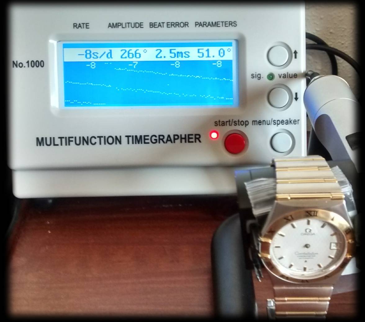

  14. ChrisN Oct 26, 2014
    2,218
    4,756
    Be very careful reading these as Al says and you have found out. Here is a Connie with a very nice 1120 movement that needs a service anyway as it has been many years. I popped it back in its case as have already removed the hands.
    Looks not too bad.
    And now two minutes later, slightly skewed and with additional protection for the case.
    I don't know what it is picking up but, clearly it has problems. Seat it properly again and it goes back to the first picture. I have given myself a few worrying moments with this machine:eek:
    Cheers, Chris.
