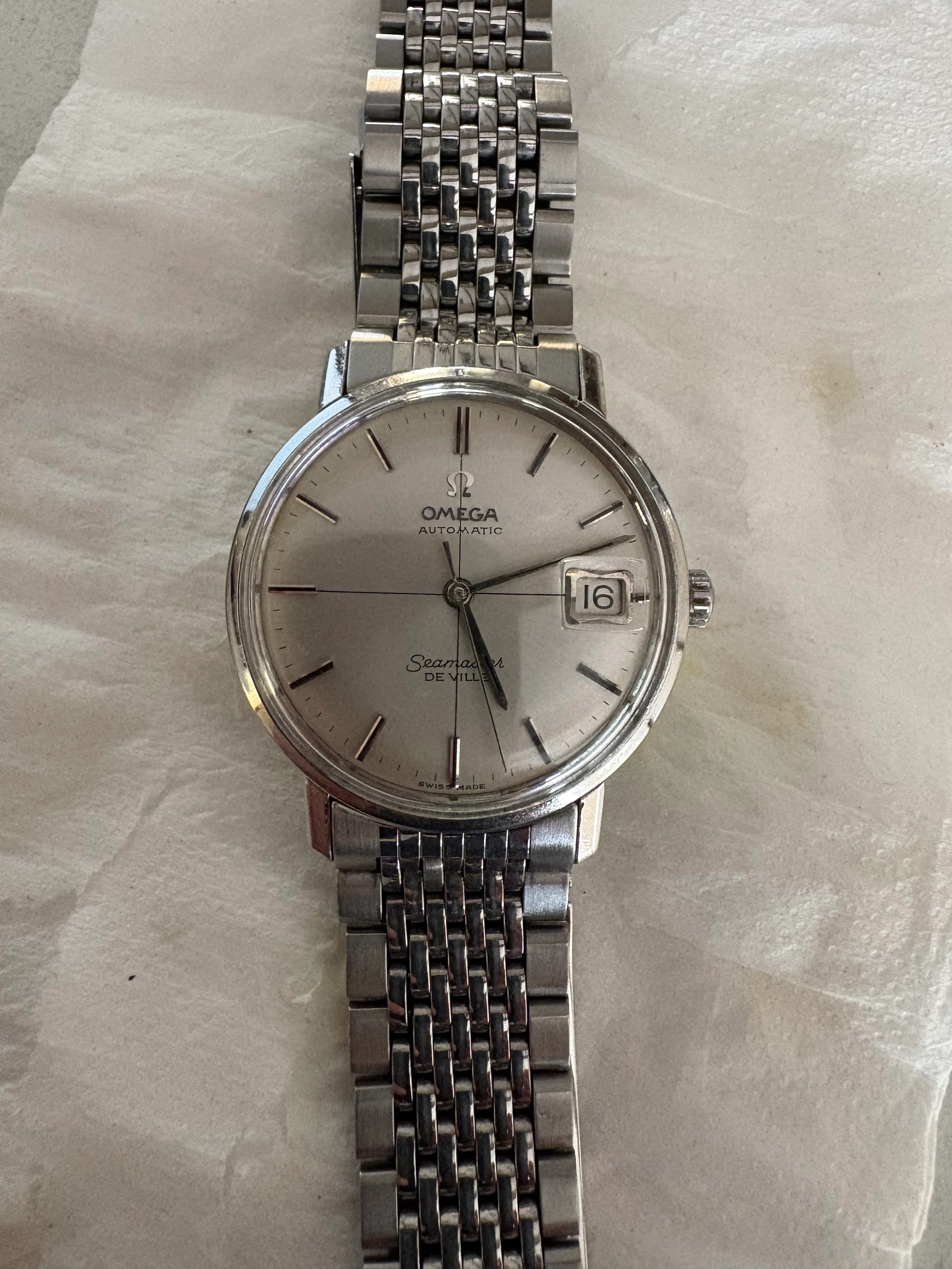

I have just purchased a 1965 Seamaster Deville 166.020 with a 1037 Beads of Rice bracelet that has spring loaded pins in the removable links.
Can anyone please tell me how to remove these links? I didn't want to push too hard on the spring loaded pins, so I gave up for now.
Thanks for your help.

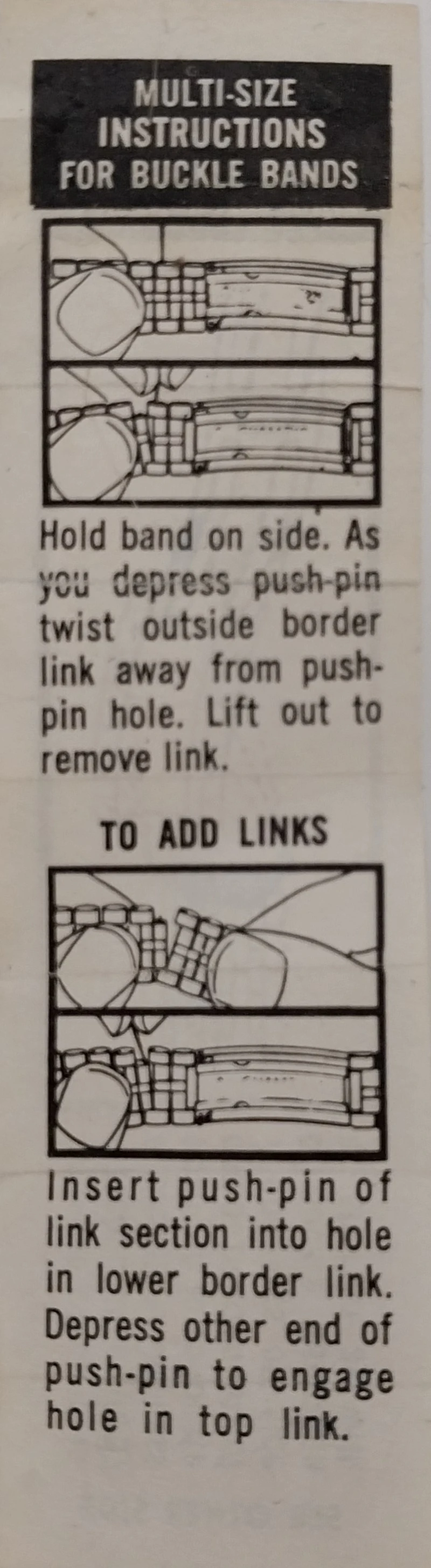

There are several threads on this topic with photos. I didn't do a comprehensive search, but this one popped up quickly.

In brief, compress the spring-bar from one side and displace that side of the link. Then, while holding the link to avoid having that side of the spring-bar fall back into place, compress the spring-bar from the other side, and detach the link. Repeat on the other side of the link, and then reverse the process to secure the bracelet. Before reattaching, double check that the grains of rice are in the correct orientation.
Some people will do this inside a plastic bag to avoid losing any small parts. At the very least, it's good to do it on a desk/table with a border around the edges, like a watchmaker's bench. You can set something up temporarily using the sides of a cardboard box.

Thank you everyone for your replies. I followed the link that Dan S supplied and the pics there made it easy to follow. I don't think I'll break it now that I know the technique involved.
