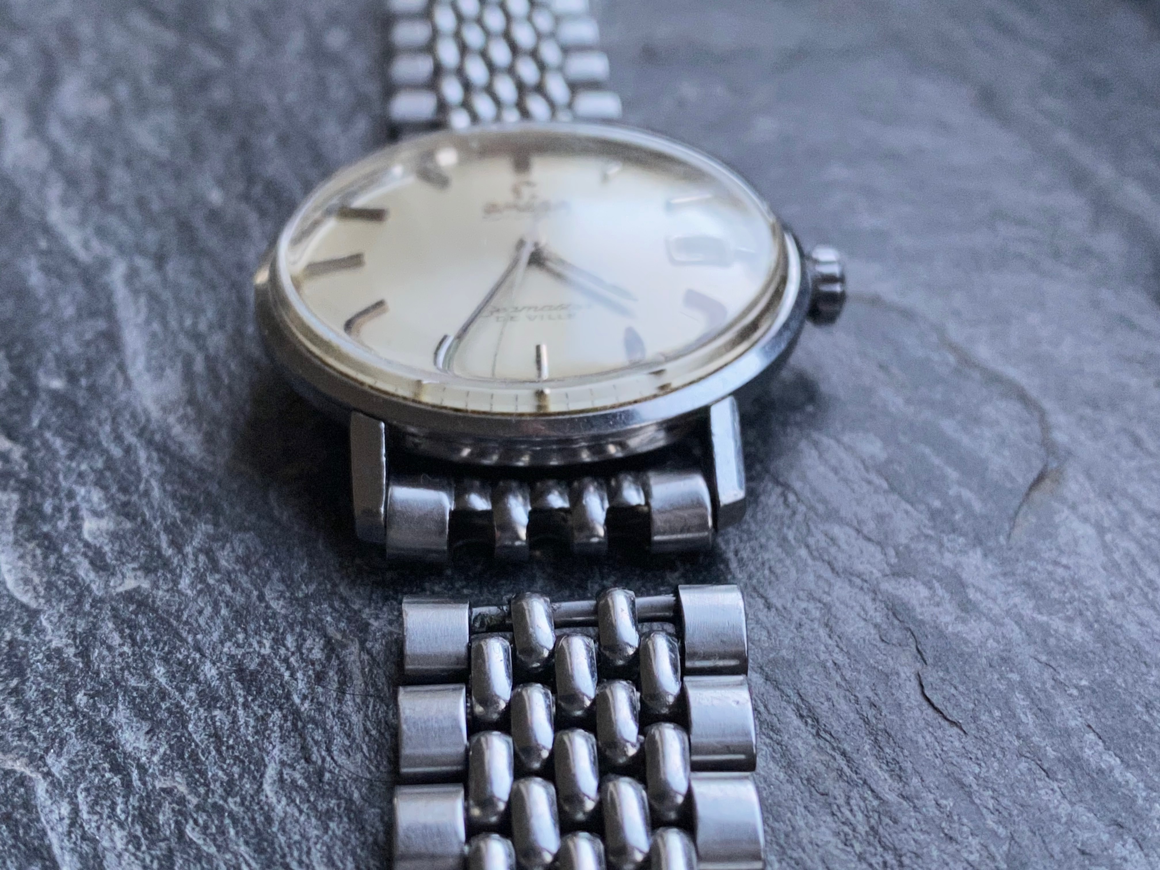

Dear all,
unfortunately i destroyed the stainless bracelet of my vintage Seamster DeVille. It is stamped No.12 Omega 1502. Does anybody know where to get replacement beads or a complete bracelet. I did some research but only found several "reissues" on ebay. I'd like to keep it in original state as my father handed the watch down to me several years ago.
Attached some pics of the watch and the damaged bracelet. At least i would need 3 of the beads to fix the connection. Btw - the width of bracelet is 18mm and i'd also need the 18mm springbar.
Thank you for your help.
Cheers
Dominik

Original bracelets pop up on here and on eBay quite frequently.
Ref 1068 and 1036 are pretty much the same as your current one.
Interestingly the 7 row Beads of rice bracelet (rather than the 5 row on yours) is the one more often seen on this model of watch.

Thanks for your swift reply Davidt. Do you know if the size of the 7 row beads is the same a the 5 row? As said, i'd like to keep the watch in original state so would like to keep the 5 row. But if the size of the beads is the same, i would keep an eye also on 7 row spares...

It is rare to see Seamaster Devilles issued with the 5 row BoR, I believe they were only issued on SMDVs from 1967 (would love to confirm this if you could open the caseback, or have the serial of the watch). Either way, there are a variety of bracelets which you could potentially use. As mentioned by @Davidt there are the 1068 and 1037, but there is also the 1036.
The 7 row will also fit, but not 'original'. If you keep an eye on here, or on ebay, you will definatley find one in a couple of weeks.

The 7 row is the same size (18mm). It the endlinks that are harder to source.

These were sold on a strap, bracelets were sold as an accessory at the time of sale or often when the leather strap wore out, there is no correct bracelet for these.

Do you use the entire length of the bracelet? If not you can just remove part of the bracelet to free up the three links and then adjust the setting on the clasp.

Wow, that's a pretty pricetag for 4 steel links.
Fortunately the endlink is ok after some plier work.
Do you know if i can use any 18mm springbar to connect the endlink?
@ConElPueblo - could be a good idea - will check the range of the clasp.
@X350 XJR - that's interesting. My father didn't mention that. Despite loving the look of the BOR with that watch - what would be the suitable leather strap for the Seamaster regarding originalty?
If anybody of the OF has some spares, please pm me.

I would say that this is incorrect. There are specific endlinks for watches, to match the profile of the case and lugs. Therefore there are correct and incorrect bracelets for watches. There are tables (here: https://omegaforums.net/threads/case-bracelet-endpiece-list.81618/) produced by Omega demonstrating what bracelets and endlinks are correct and incorrect for certain watch references.

I've got some pieces left to fix that, if you like you can send me a PM

Due to the generous help of the forum member Passover i was able to fix the bracelet.
Thank you very much Passover and thanks to all for your comments. Great forums.
