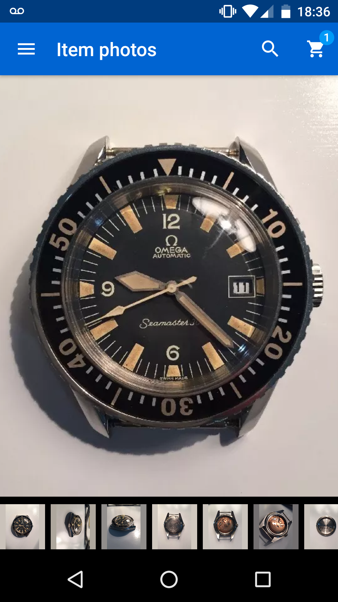

    After the recent discussion about "cooked" dials, I'm starting to think that is the case with this watch. Notice how the dial plots are browned, but the dial is marked "swiss made" (luminova) rather than "T swiss made T" as a tritium version should be. Screenshot_20160520-183657.png

    something is wrong witht the bezel too I think.

    2,247
    3,048
    Thought the same thing, myself. Looks like a bezel from one of the well-known fakes. I'd stay away.

    561
    2,562
    Fake middle case and caseback ::puke::
    Fake bezel ::puke::
    Re-worked service dial and hands (minus second hand, which actually is a correct early type, but not for a 166.024 wannabe) ::screwloose::
    Original crown, but not for a 166.024 wannabe. ::screwloose::
    Serial way to late for a SM300 ... no one in the 3xx range and surely not a serial 34x ::screwloose::

    15,047
    23,790
    Even the seconds hand looks "cooked":thumbsdown:
