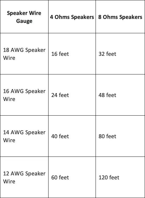

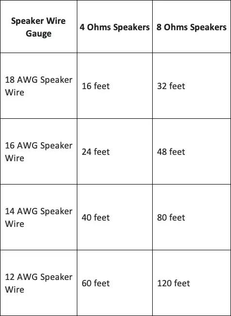

There is a lot of hype and opinions when it comes to interconnect cables and speaker wire. For me, I think the stated benefits for the hyped speaker wire couldn’t be noticed or appreciated except with extremely high quality source components and speakers. I have a current McIntosh amp connected to mid 1990s McIntosh speakers that I am perfectly fine with using standard speaker wire and following well established guidelines based on wire gauge, maximum distance and speaker impedance. The audio signal's volume and overall quality will degrade if you use wires that exceed their recommended length.
The reference table below I got from the internet. It is populated with lengths, gauges and speaker rated ohms that I have seen as fairly uniform across various references.
Note: AWG = American Wire Gauge, which is the US standard measure for the diameter of electrical conductors

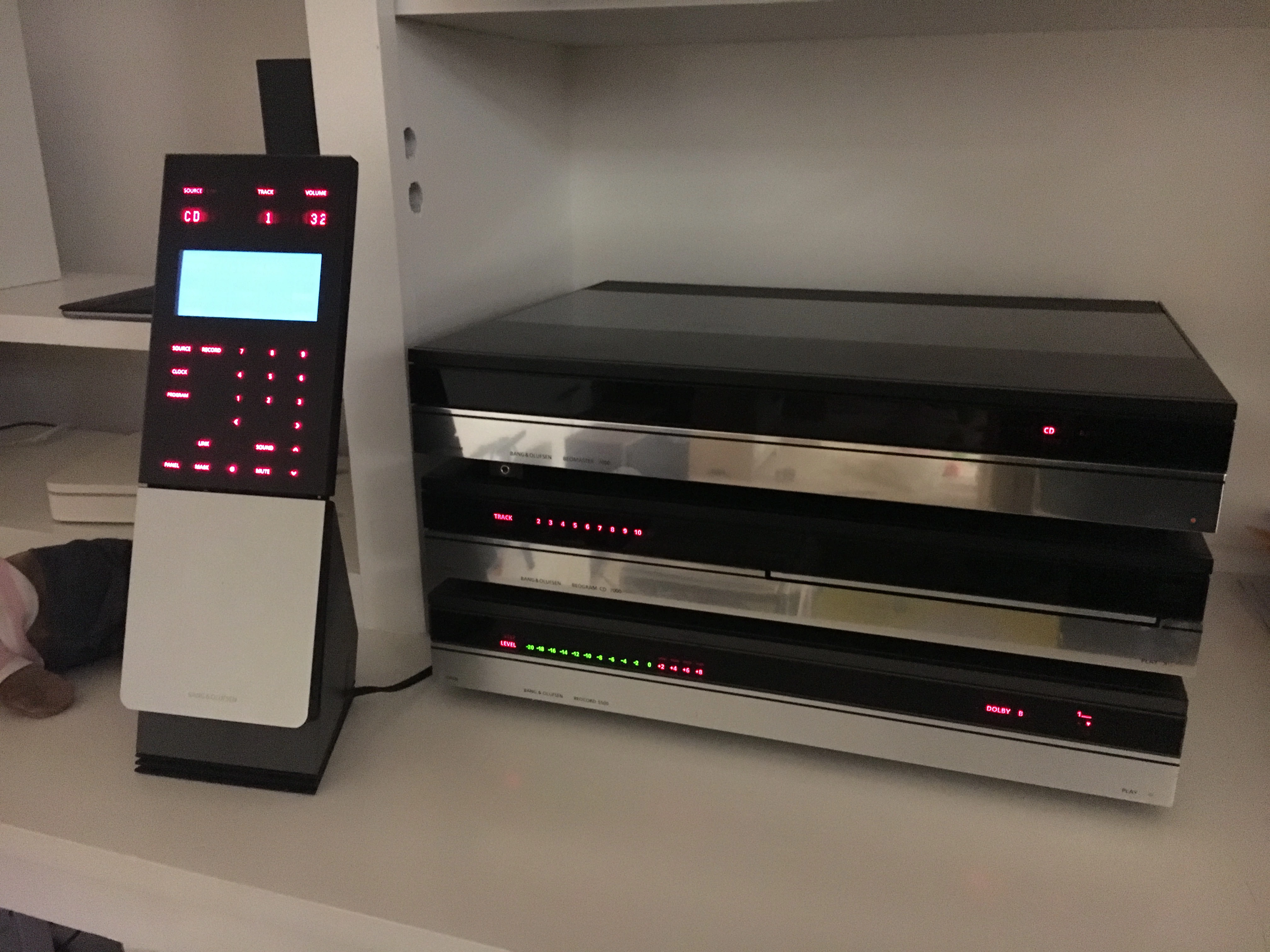

I got the beolab pentas with these. I picked up the system from an old lady for cheap, the remote had a motor in it that articulates whether flat or vertical. I used to always have a B&O syustem lying around for fun. Have fun with those speakers, they move a lot of air.
