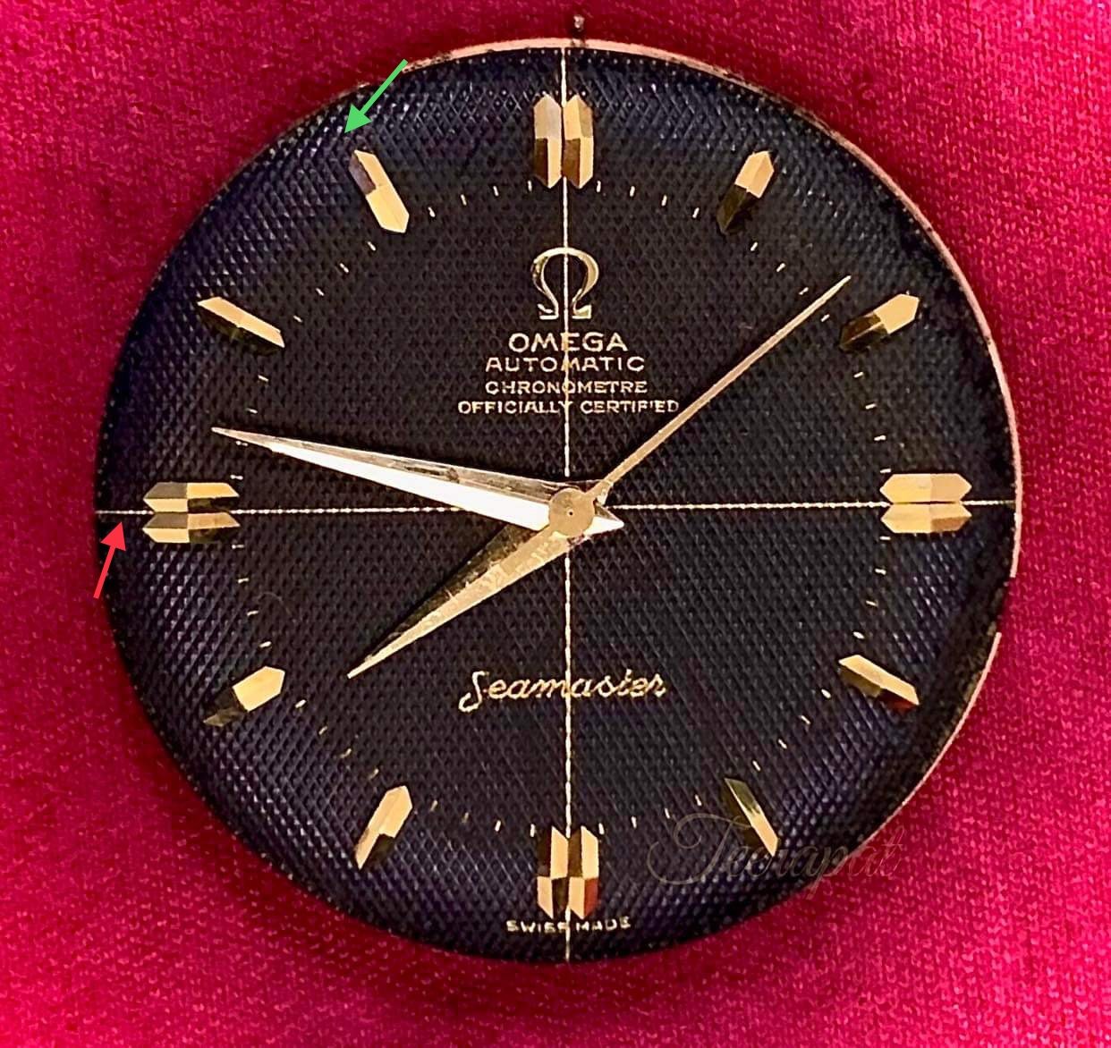

1,024
4,126
Please note that my watch (jumbo) has ‘the gap’ between the edge of the dial and the outer edge of the markers (as indicated by the red and green arrows).
However, the usual case size of a 1950s Seamaster like this ref. 2577 has a smaller gap next to the hour markers.
By the way, the distance between two opposite hour markers was the same, approximately 21 mm, in both the jumbo and regular models.
Therefore, I believe that the dial of the jumbo reference (such as 2675-2494-2521) should be larger than the usual size of the Seamaster.
