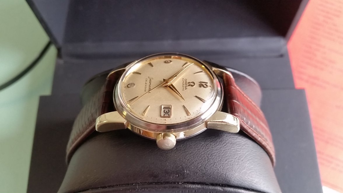

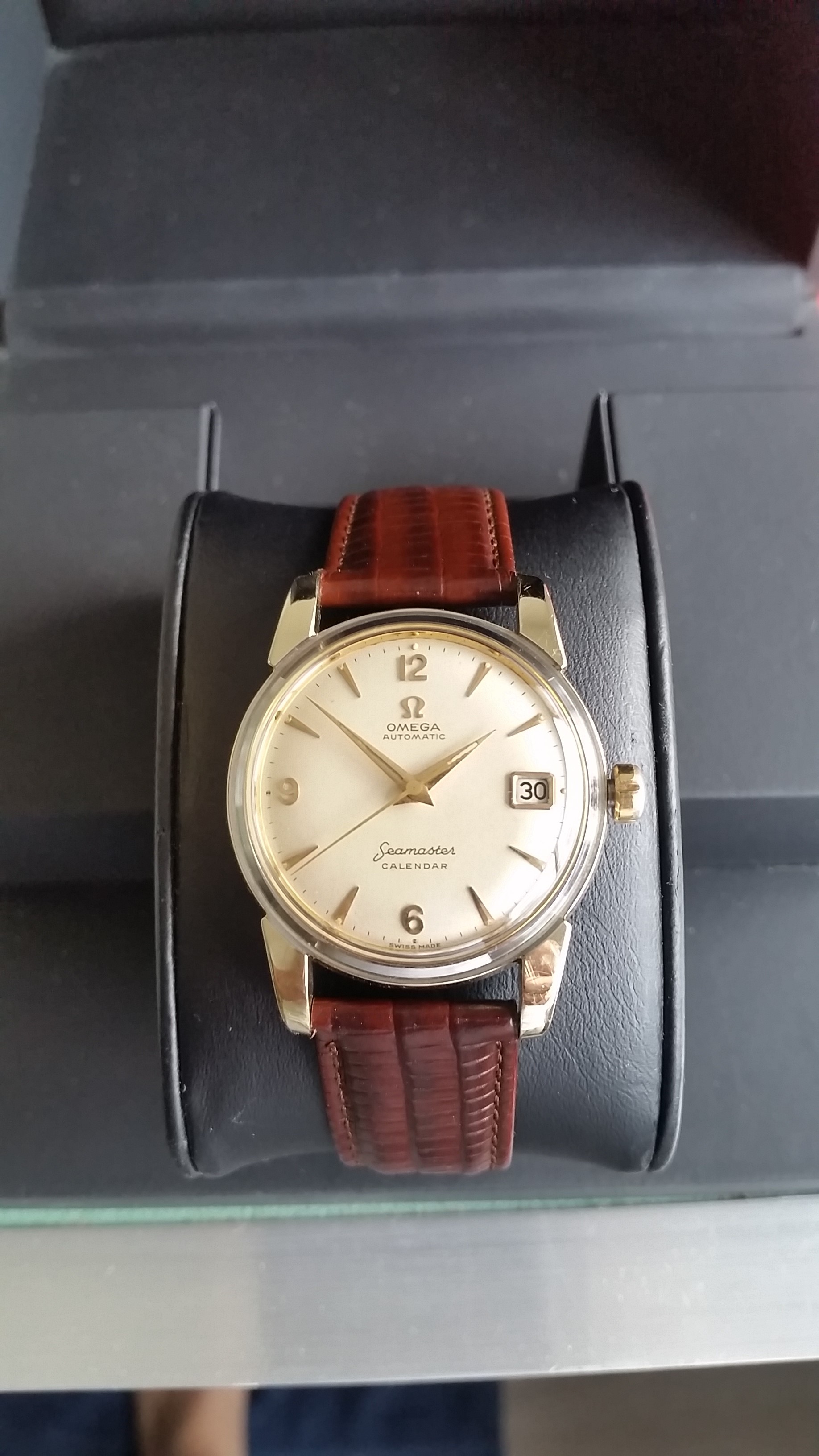

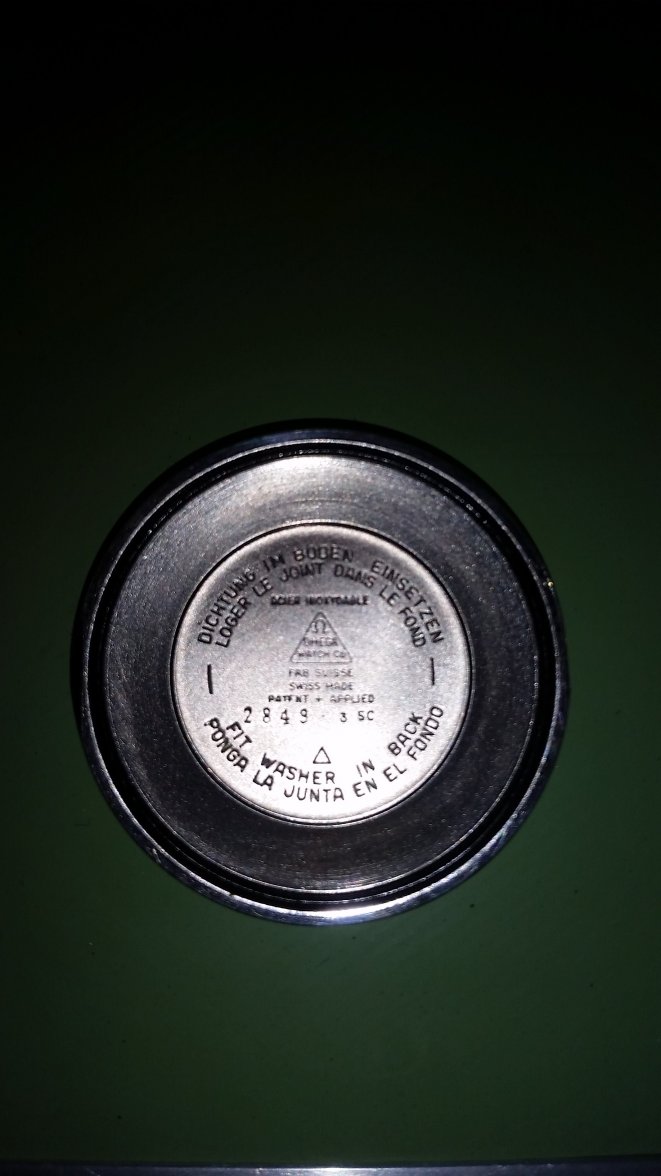

    Dear Omega Forum,
    I am looking to purchase my first real watch, and I am currently looking for a vintage watch. This is due to the relative lower price, as well as the history behind the watch.
    I have been searched throughout the forum to provide an answer, as well as OMEGA's official vintage database, however with no luck. I hope you can help!
    I can not identify the work as 503. Seller claims it's a 2849, year 1957. It seems very polished, and I Seller has informed that glass/plastic has been changed. Watch was listed at $800, I offered half of that amount. Watch seems authentic, however, I do not believe it is a genuine 2849 from 1957. I am concerned whether it is a fix-up of different parts, and that the watch will not function properly. What do you think? Thank you in advance!

    Not sure why you would think that this is not a Ref. 2849?
    https://www.omegawatches.com/planet...ache=1&cHash=26cfb925b7933ac778f8284108e6c824
    Movement and case matches the Database.
    I agree that it has been polished, the crown needs replacement and both the hands and dial have been relumed. I think the dial is otherwise original.
    IMO, you made a fair offer for the watch in that condition.

  5. kyle L Grasshopper Staff Member May 11, 2016
    4,417
    11,222
    Looks decent but it will need a bezel as it looks like it is missing.

  8. TNTwatch May 11, 2016
    2,876
    1,950
    Yes, and it'd be about impossible to find that gold bezel.

    I assume that the watch, without the bezel, is not waterproof? What would a fair price be for this watch?
  10. omegastar May 12, 2016
    1,836
    5,323
    Since bezel is missing, it is worth the parts, 60 euros for the case + 90 euro for the mvt + 60 euros for the dial and hands = 190 euros (lot price), if you can live with it.

  12. Archer Omega Qualified Watchmaker May 12, 2016
    26,442
    65,505
    Steel bezel is available, so one option would be to get that and have it plated. There are also people who can make a bezel if needed...
