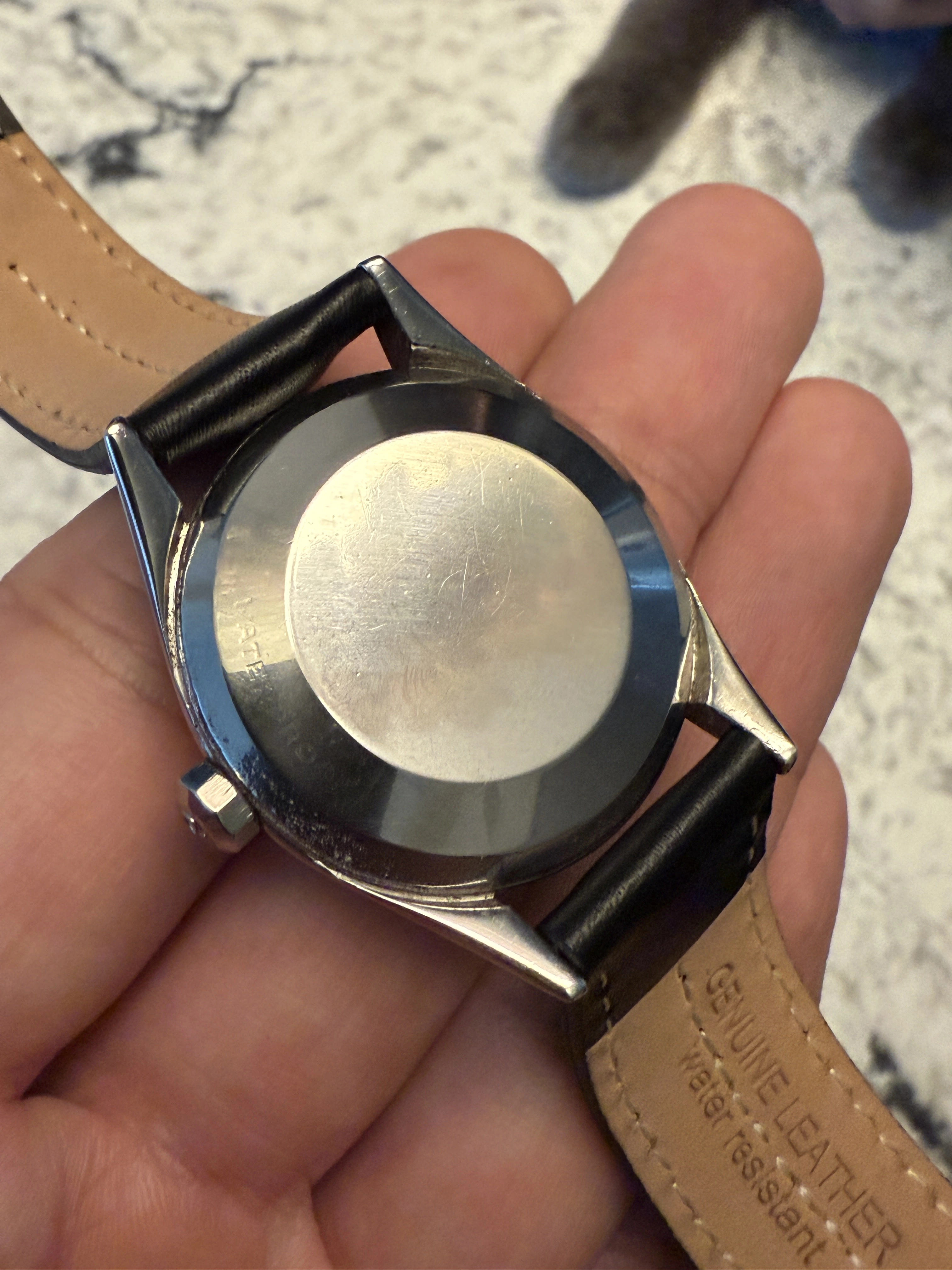

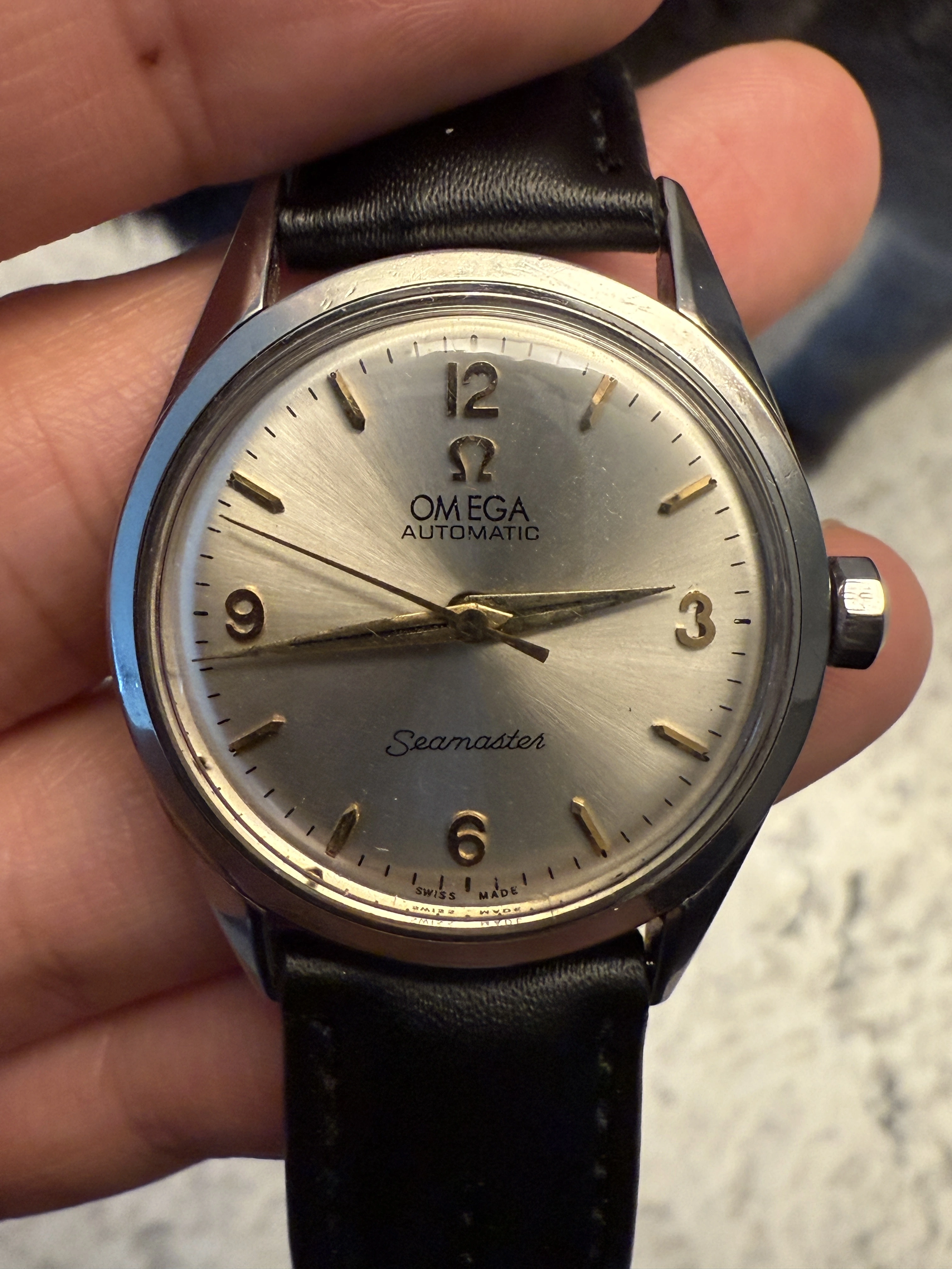

Hi - I’m curious what you think about this. I found this Omega Seamaster at a vintage market and wanted to see if anyone had any opinions. I have no experience with Omega and was told to post on here so any help would be appreciated! I have to admit I did a terrible job in checking the basics (the “E” is very off, one of the indices looks short, etc.) but I’m hoping it’s a redial.
It works very well (accurate time, crown functions well, looks well-made in person if that makes sense).
Any feedback would be very appreciated!

Genuine but in poor condition with a horribly refinished dial.
13,543
23,487
Really poorly refinished dial and the case seems to have been poorly refinished as well.
Unless you’re on an extremely tight and strict budget and it’s say £100, I’d pass and keep looking.
In fact even if it is £100 I’d pass and keep looking.
495
1,209

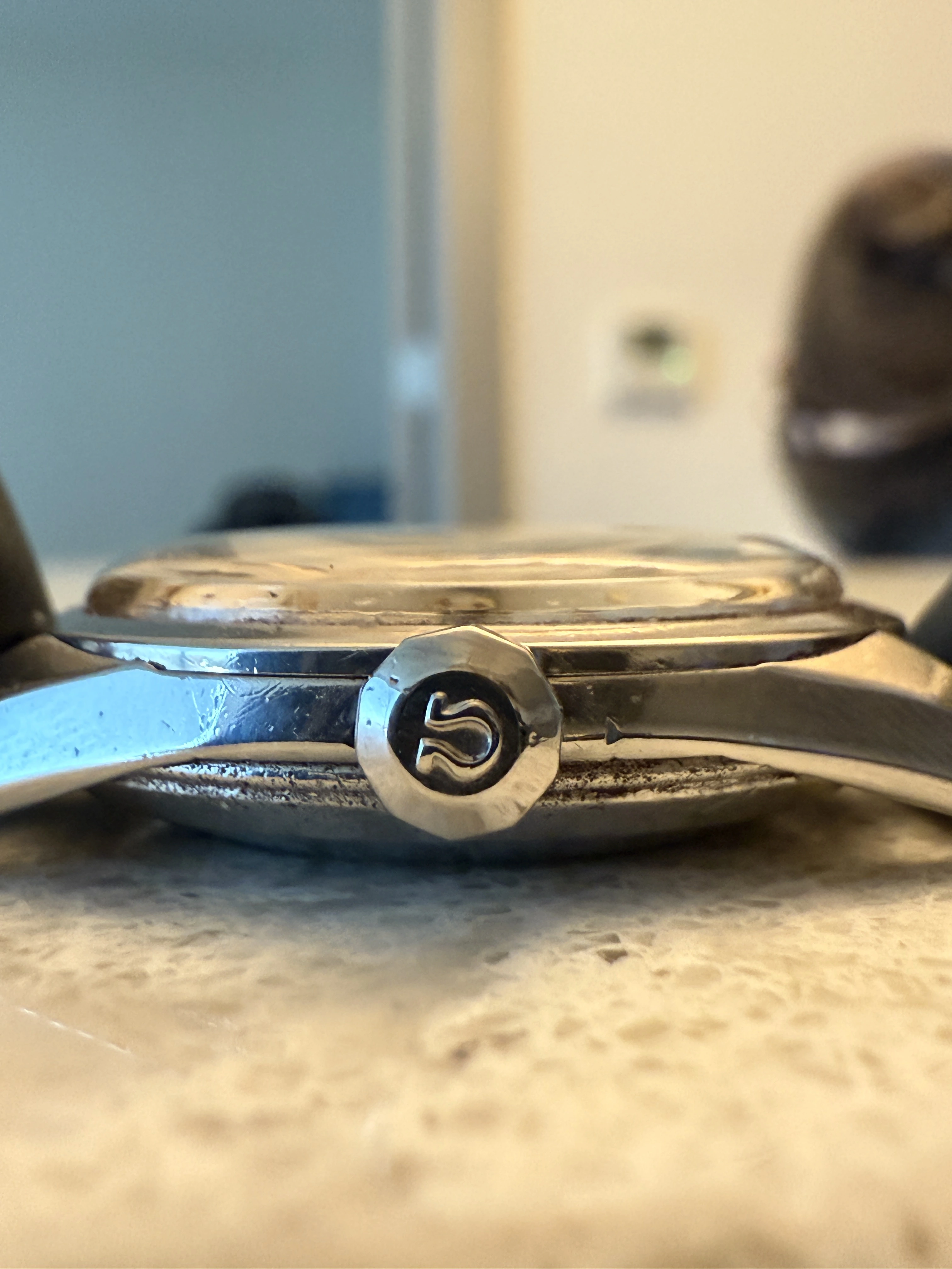

That's an oddball. Dial's been redone, the decagonal crown's from a Constellation, and the case seems to be for a 2802, the Seamaster Deluxe. I echo @Davidt in recommending a pass.
620
1,969
Well the dial has been remake entirely. The case was corroded and polished. Wrong crown
