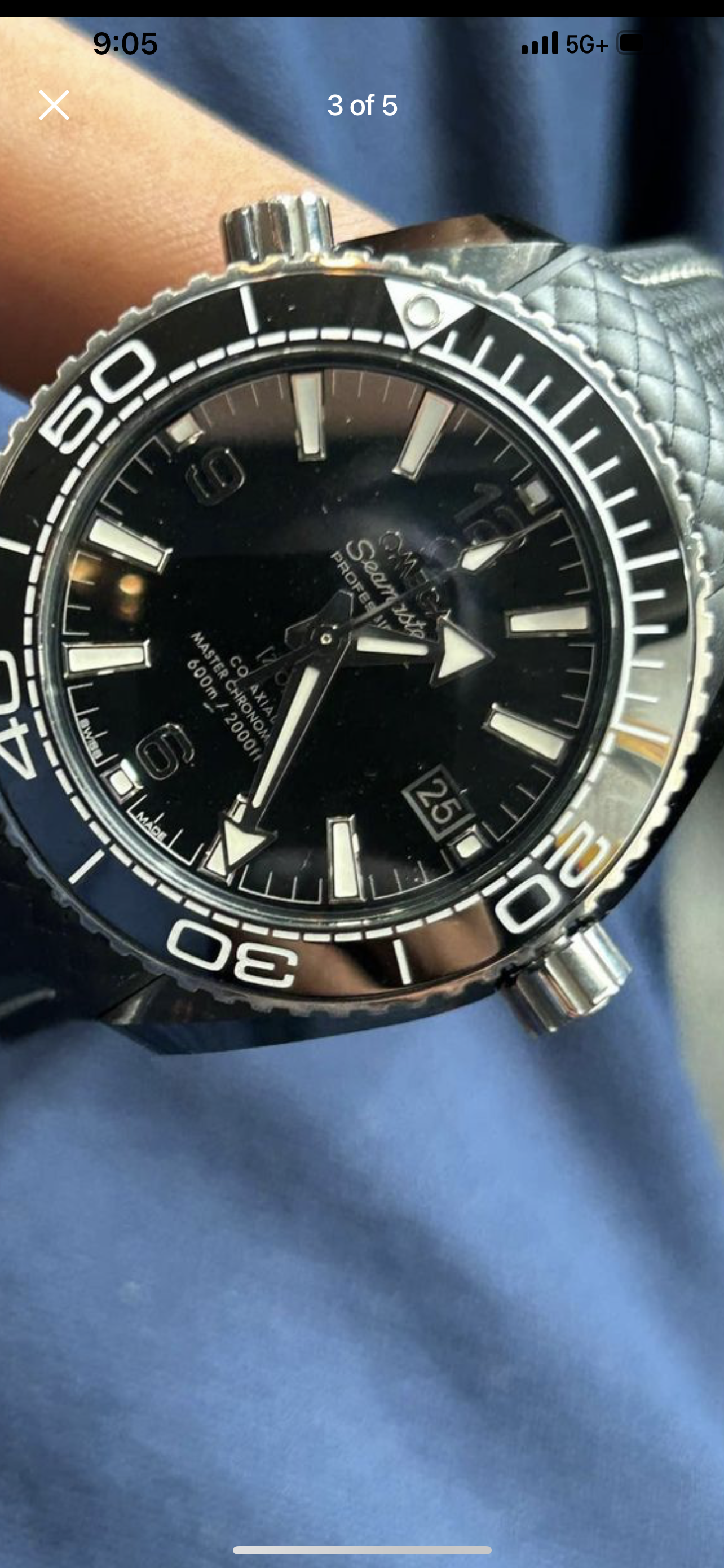

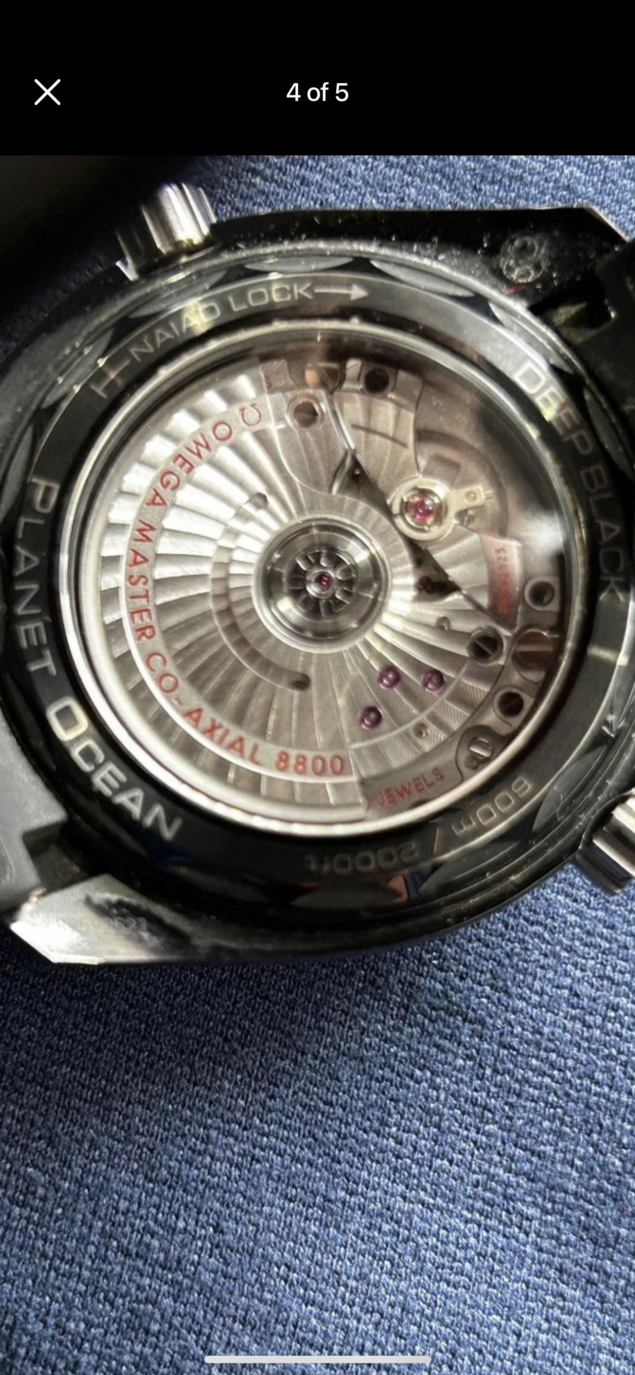

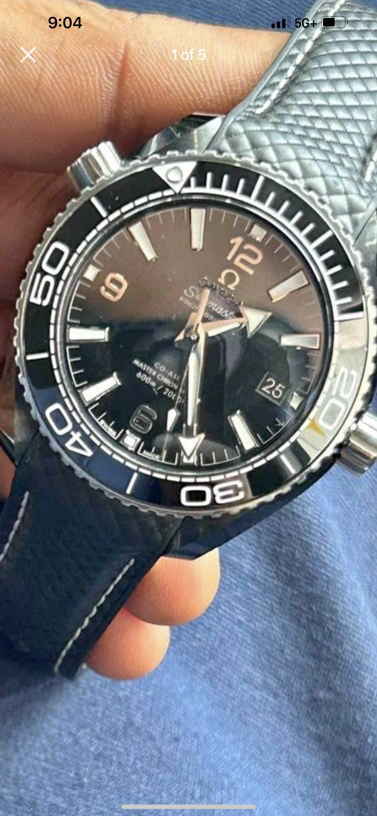

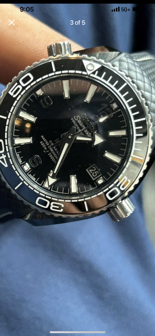

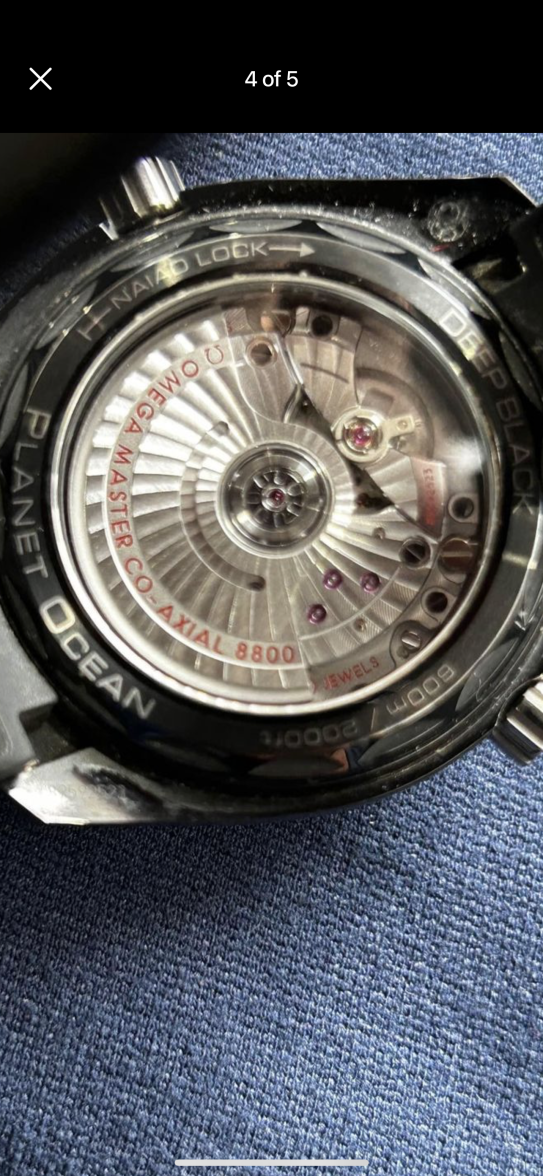

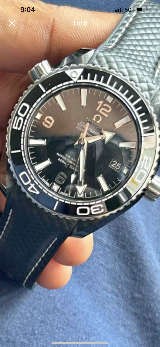

Hey there. Been a while since I been here. Need some help authenticating a watch that a gentleman is trying to get rid of. Any help will be appreciated. Thanks in advance.

These pictures are no of the best quality, you would likely get more responses if you got some high quality pics. You should google the serial number as mentioned above, there are many PO fakes out there

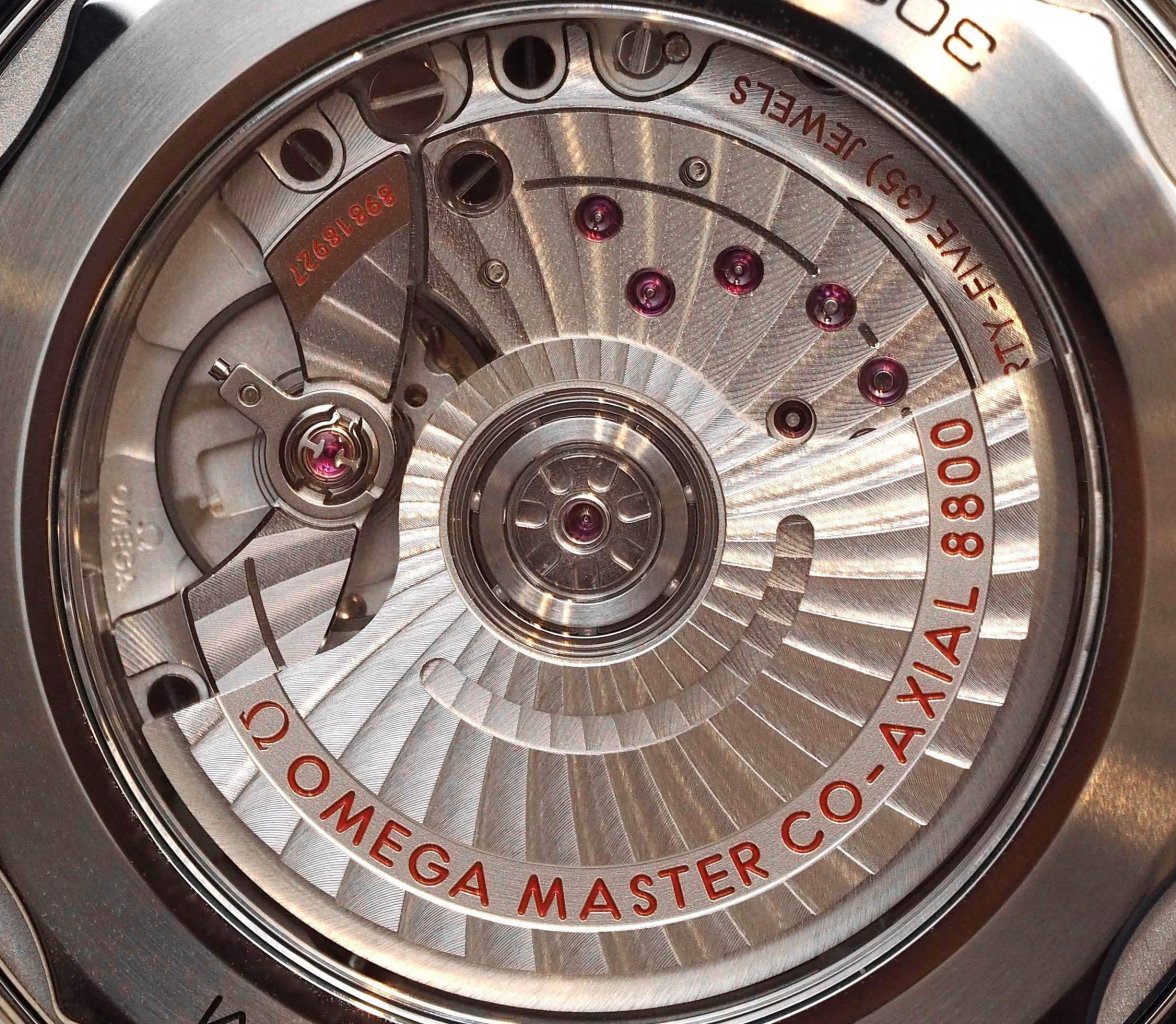

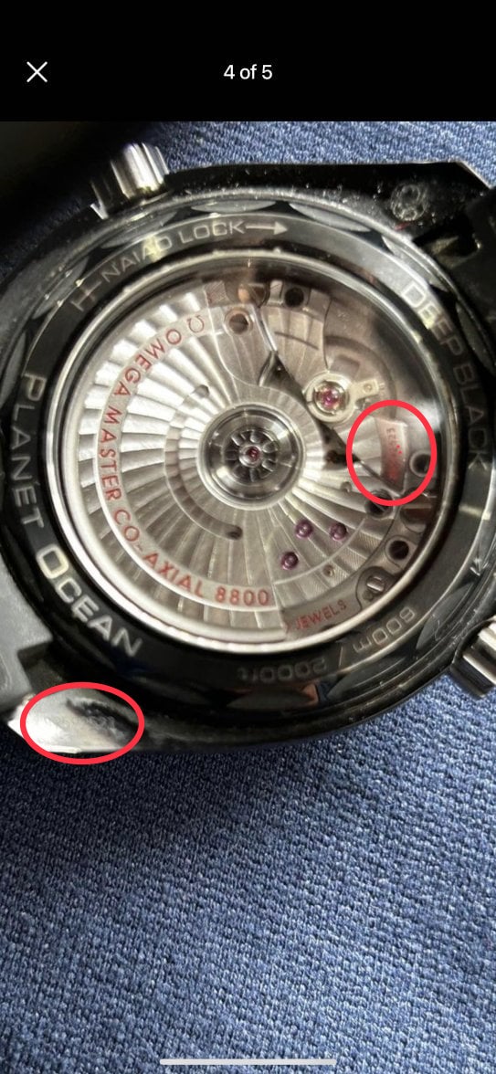

It's real unless the fakers have figured out the free-sprung balance. To my knowledge, they haven't.
Yo watchdog, can you point out specifically what you mean by this and how to spot it for those of us who are still learning about omega watches? what is it about the balance wheel that you immediately note as likely legitimate?
Thank you.
6,609
26,780
Thank you.

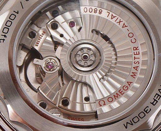

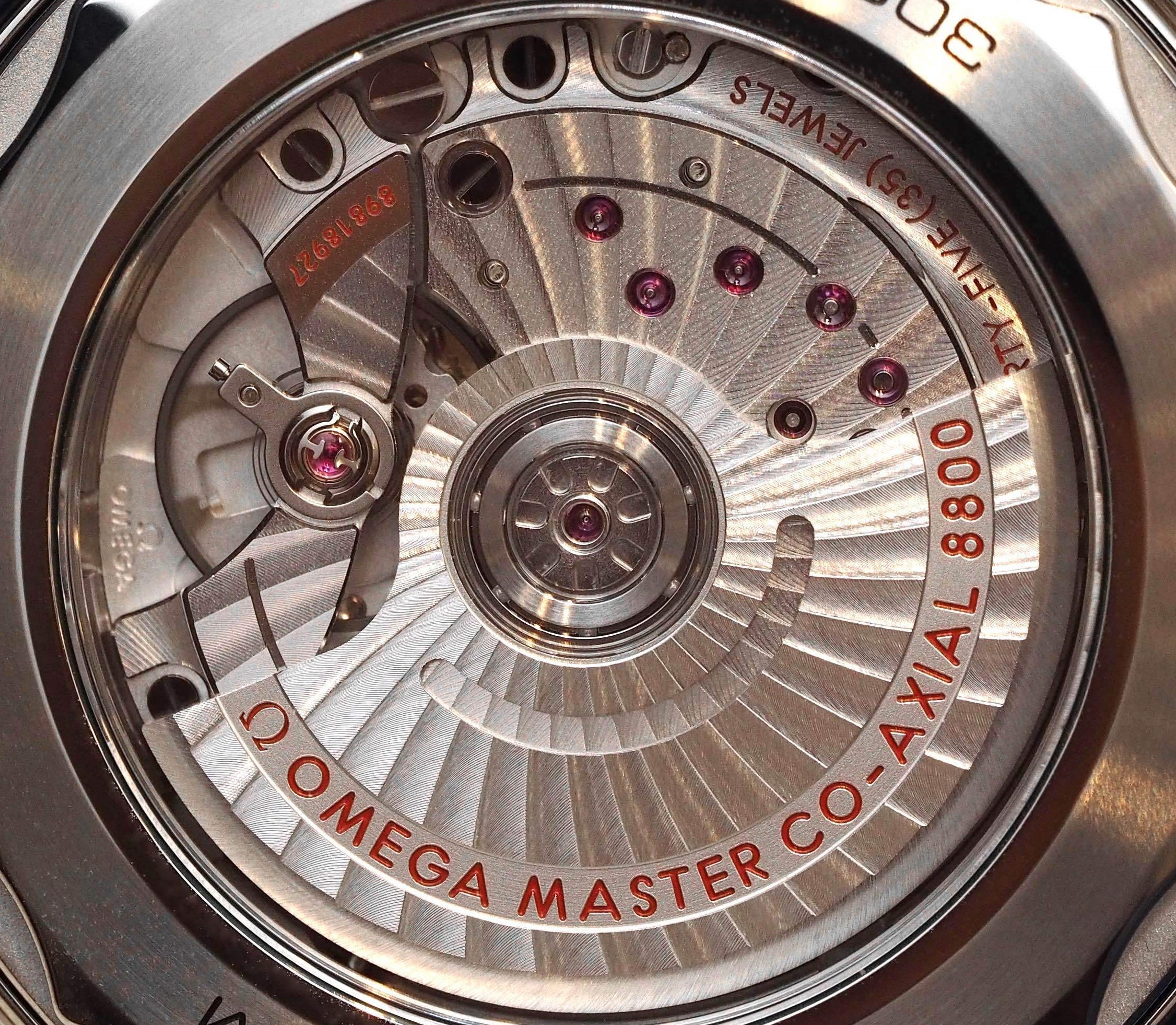

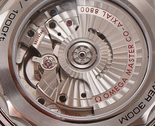

Top Real
Bottom Fake
The “free sprung balance” in the fake movement is purely just decoration and beyond that, serves no purpose. I guarantee there is no pivot in that jewel.

Top Real
Bottom Fake
