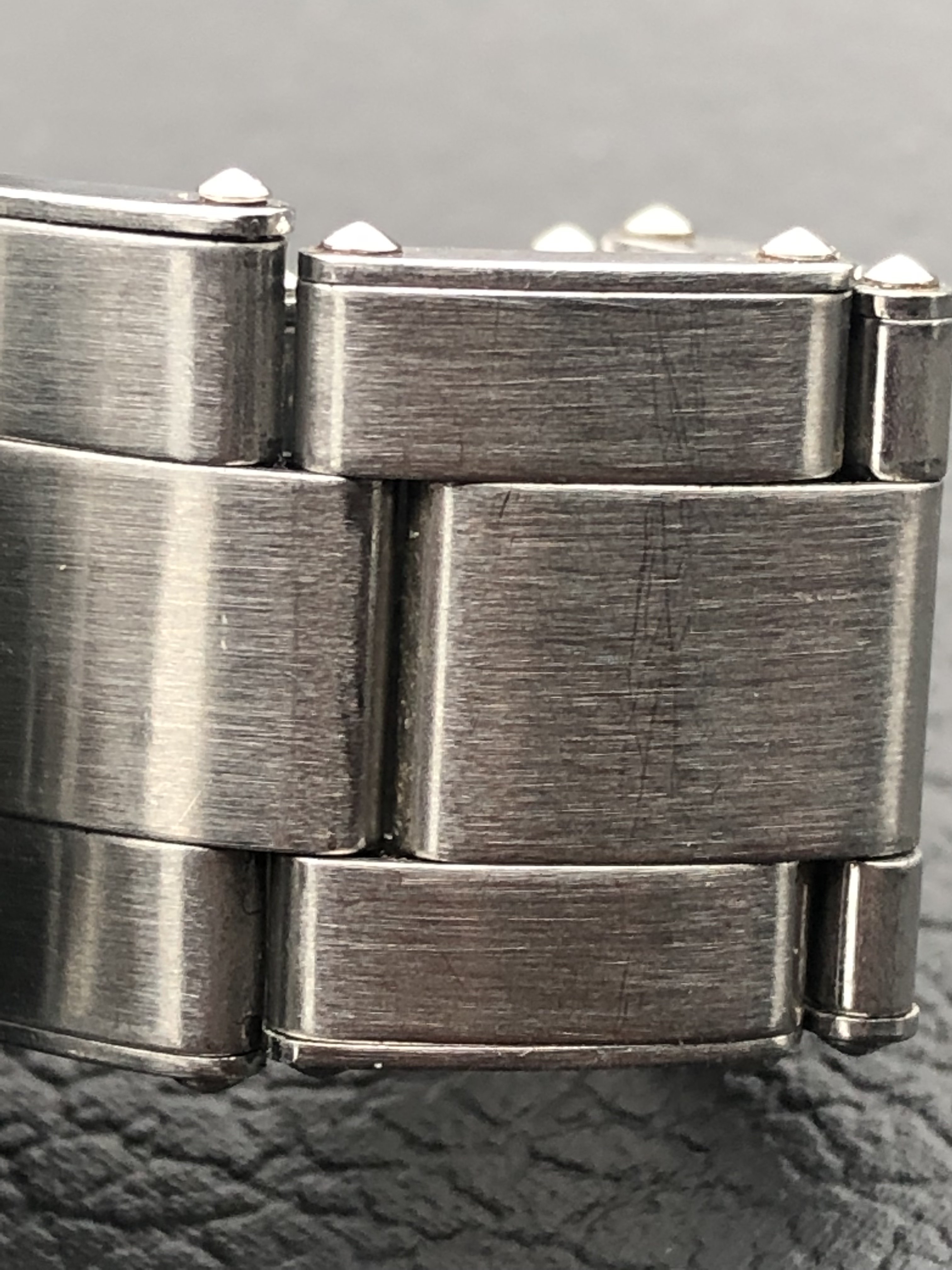

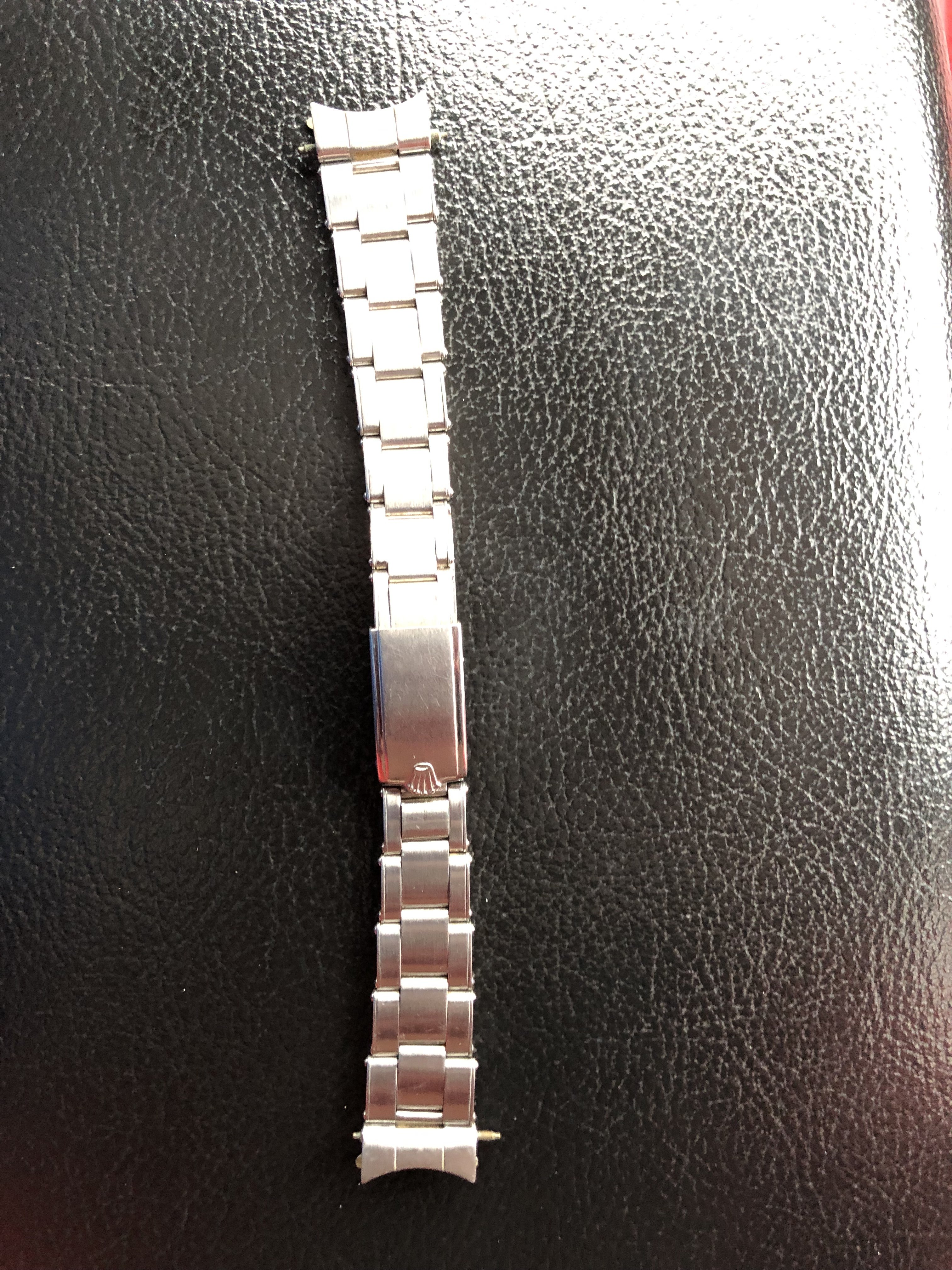

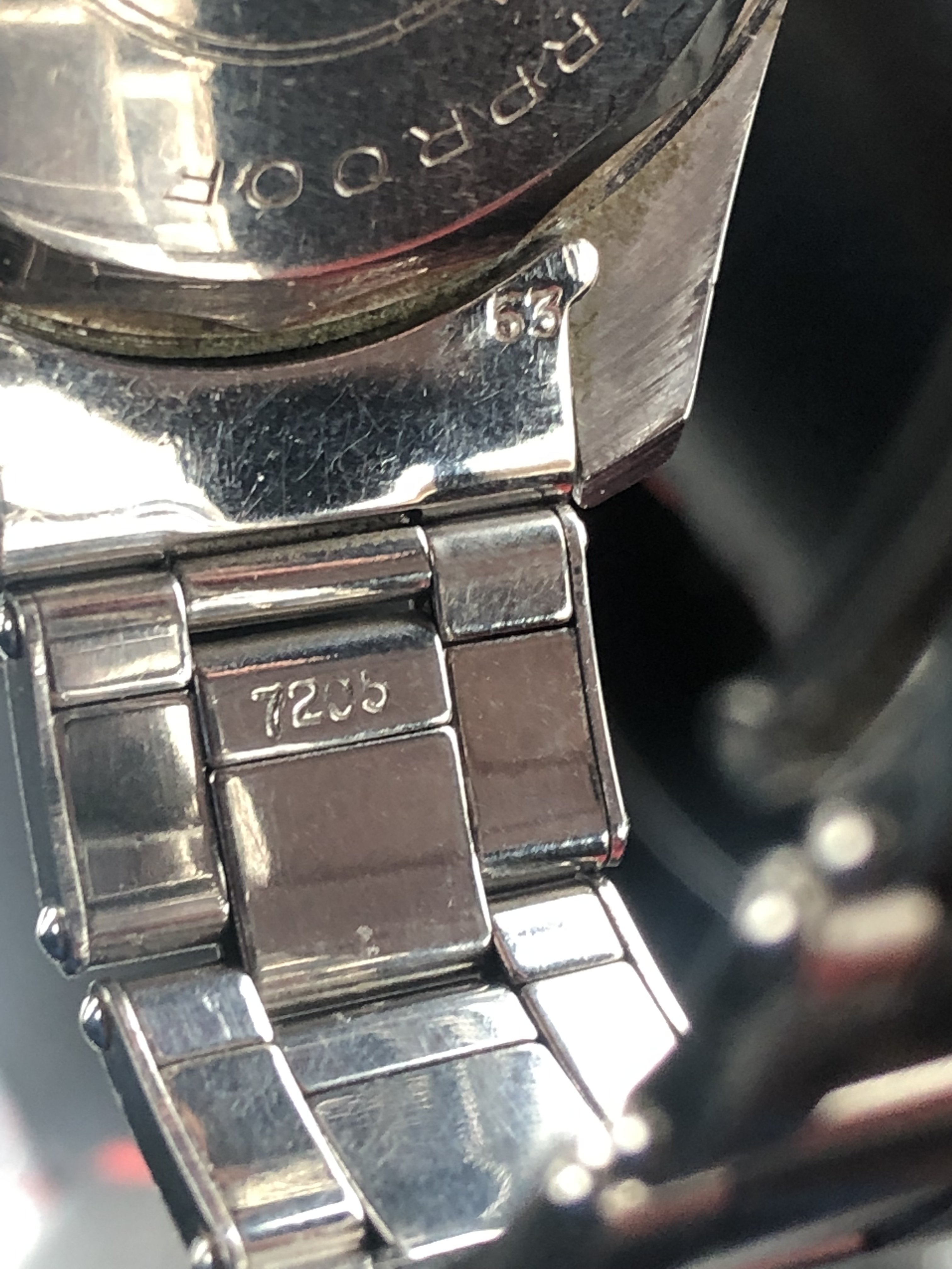

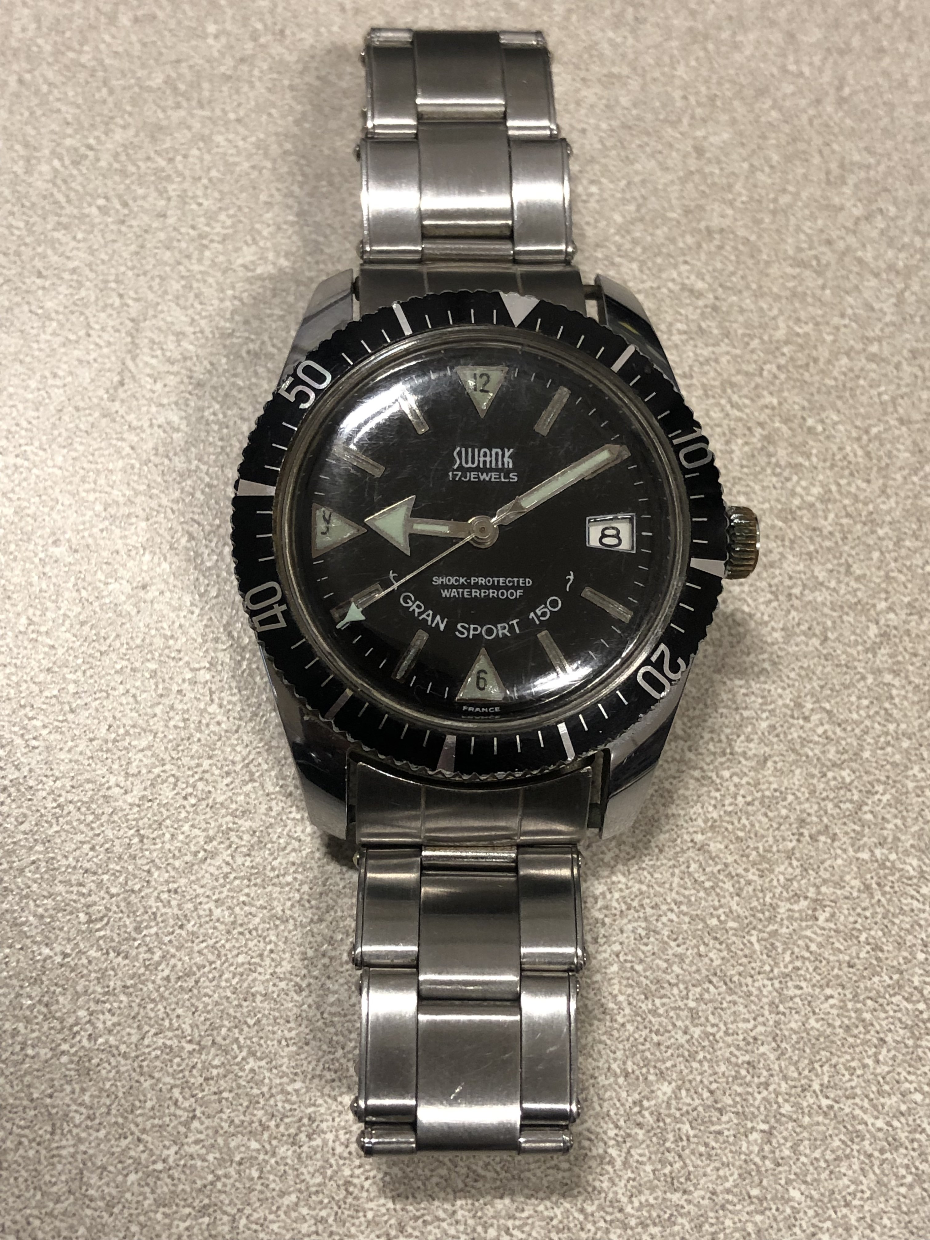

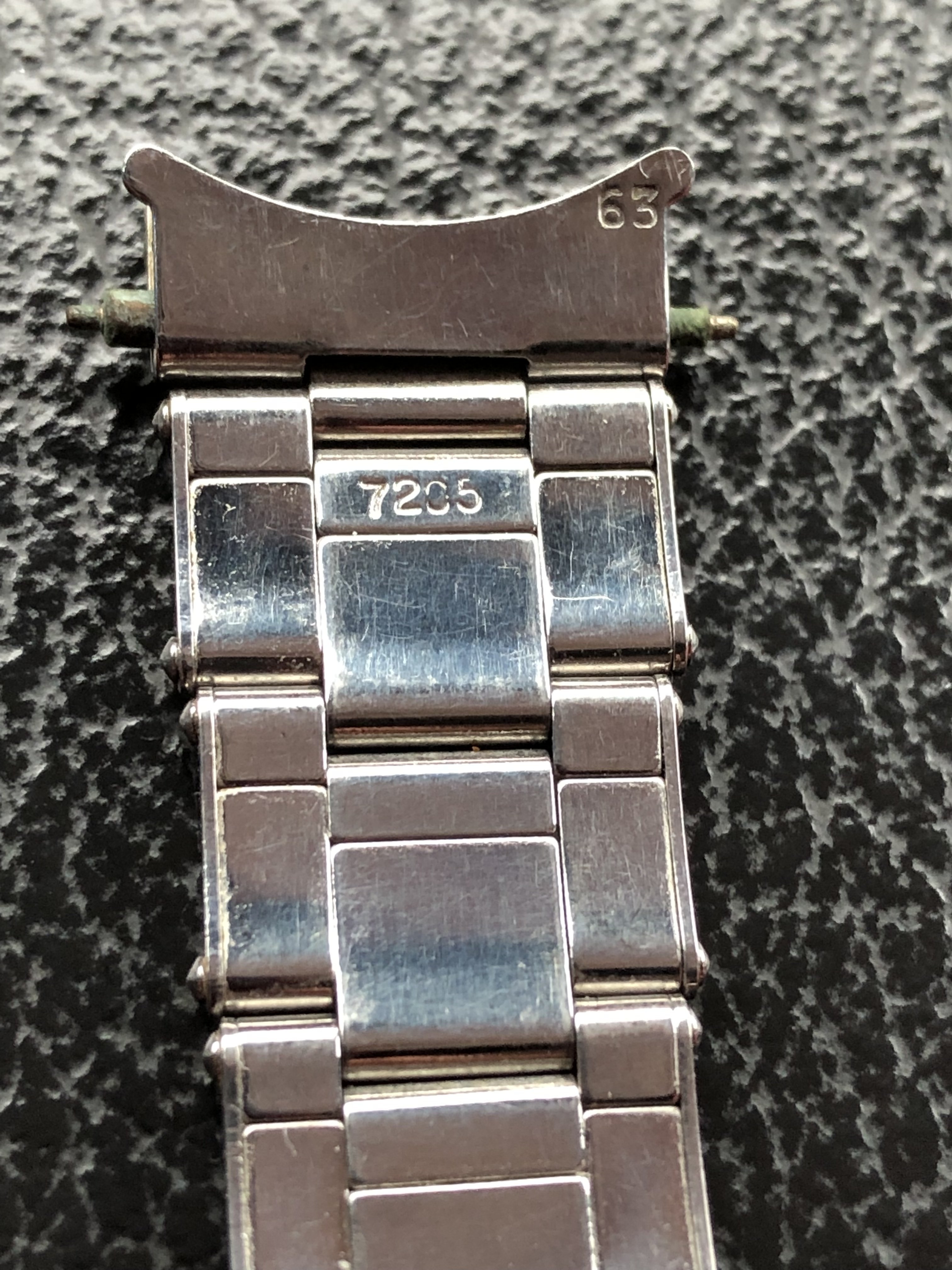

I picked up a vintage Swank watch in a bag of jewelry at a local thrift. I didn’t notice the band until afterwards. High end jeweler feels it is authentic but has no explanation for the different rivets on this bracelet as opposed to others I have seen. They deal with modern pieces vs vintage. Any opinions or explanations about these “domed” rivets?

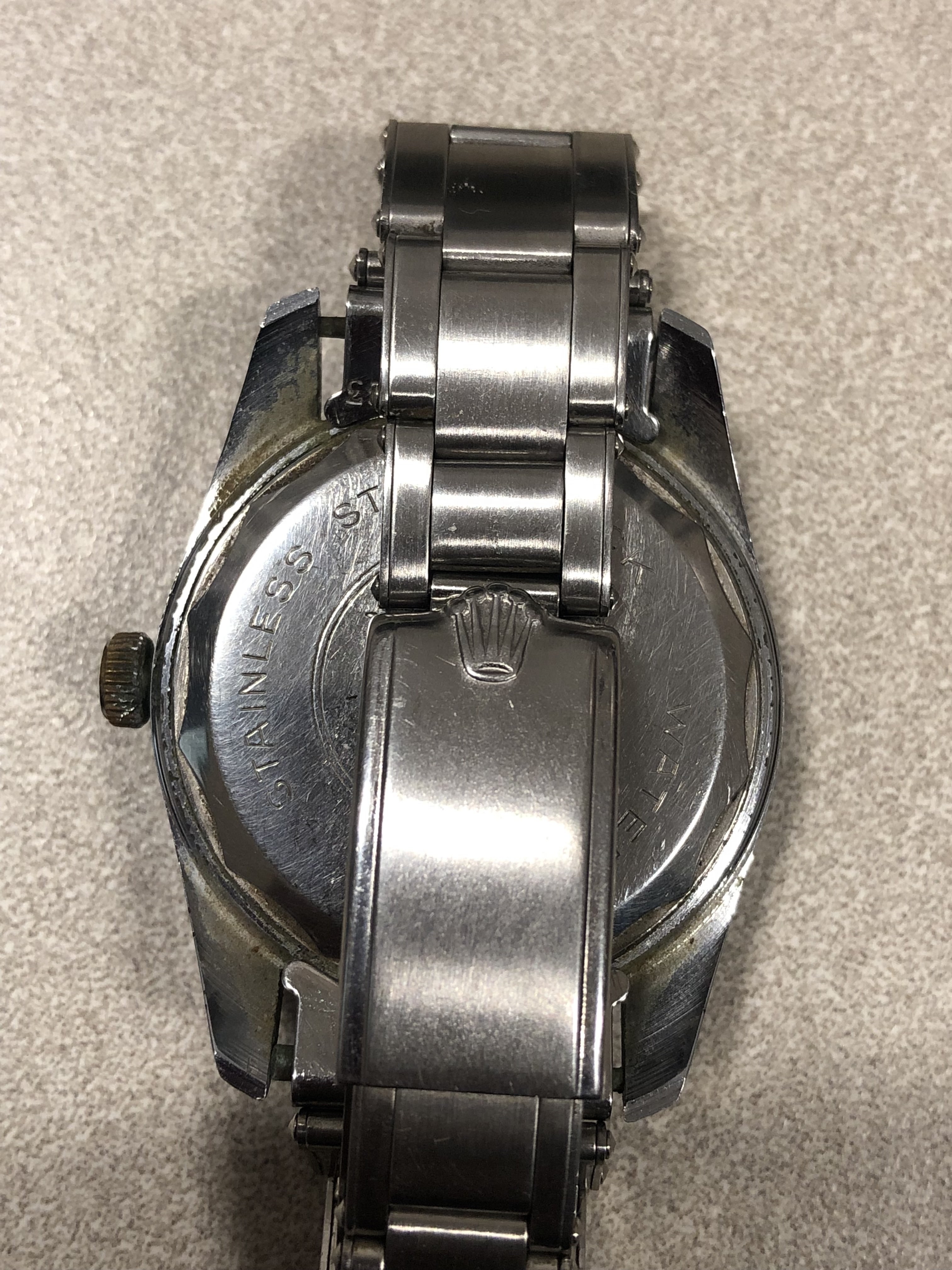

Thanks. The bracelet is actually too small for the watch. I think I’ll clean it up and put a Nato strap on it.

I haven’t seen rivets like those either.
Fake

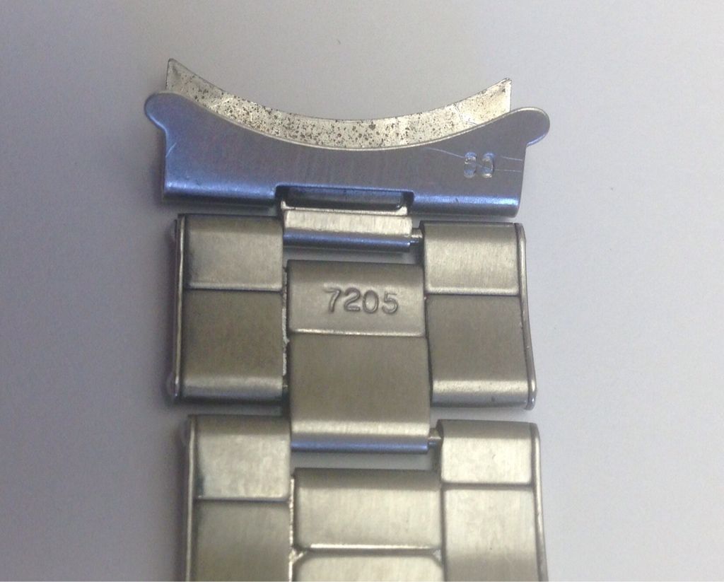

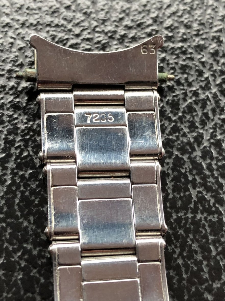

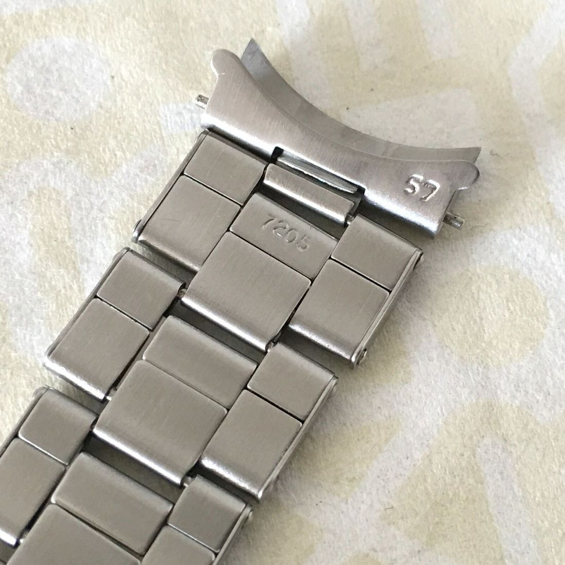

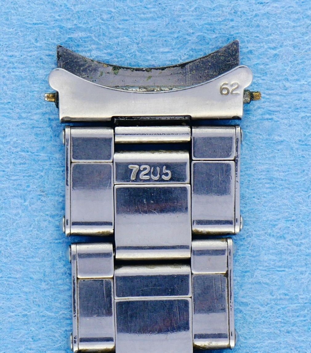

Somebody may have replaced the rivets at some point, but I don't think it's fake. First photo is OP's; next 3 are others from the web.

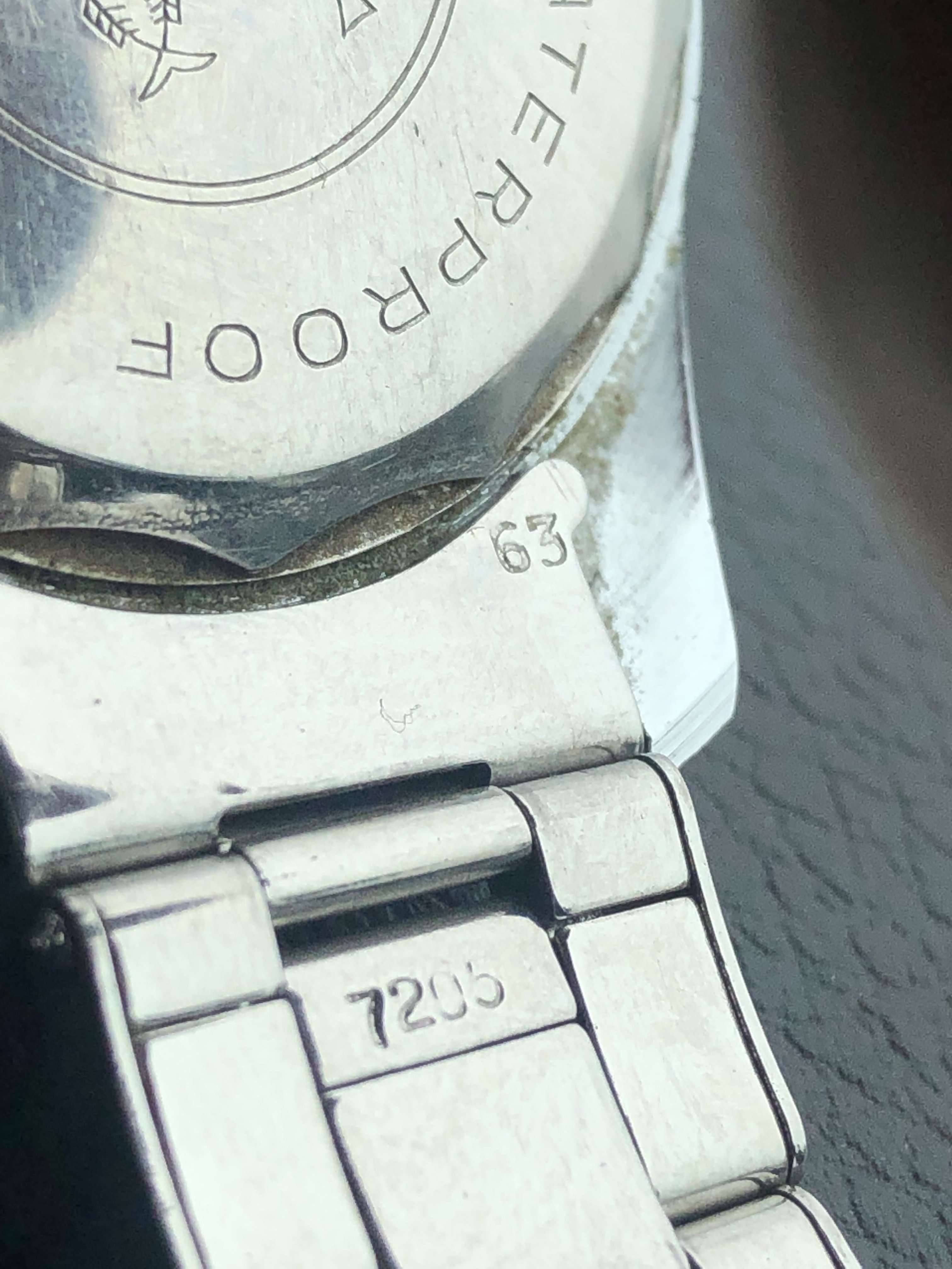

Rivets look ok to me, that’s how they look on unpolished examples.
My bigger concern is the “63” ends. They don’t show up in the usual endlink databases, and they look like USA ends in shape?

Looks like a pair were for sale previously by Lunaroyster, and are described as being 17mm.

yes they definitely look the same, more elongated than the “typical” style. Here’s one of the lists I reference. I now notice they are all 19mm and 20mm; this list seemingly doesn’t address the lesser sought after models (17mm would certainly fall in that category in my opinion).
