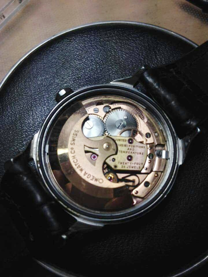

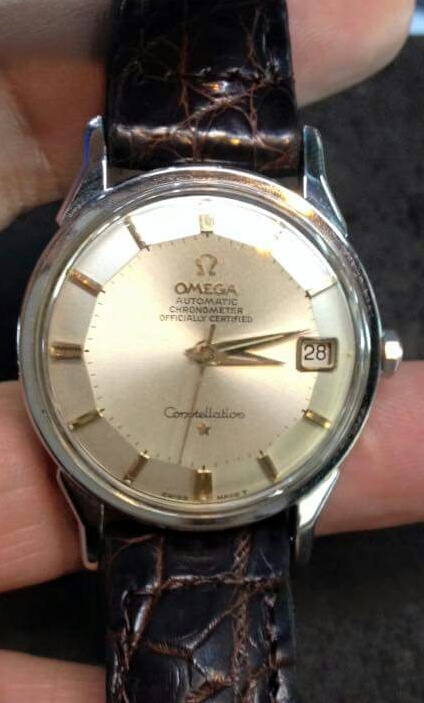

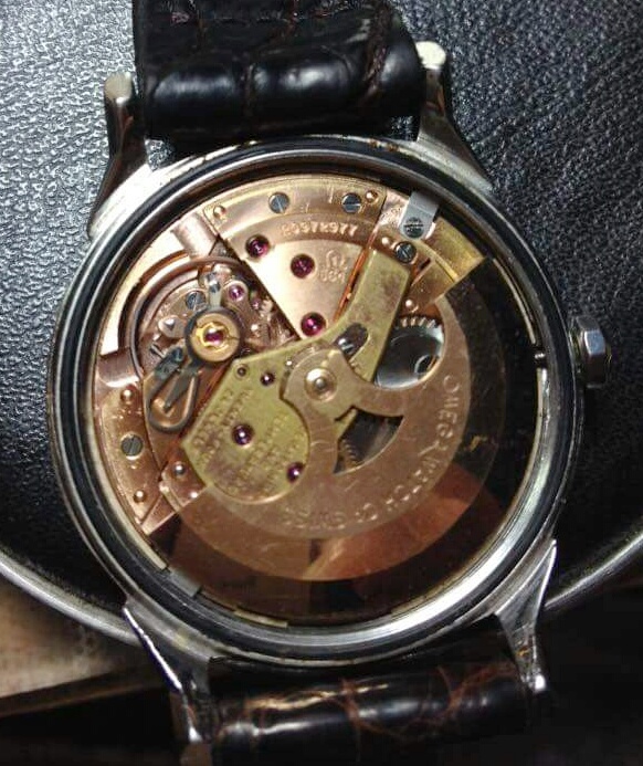

    I have the opportunity to purchase this Omega Watch. Simply; is it authentic or otherwise?
    Thank you.

    Would need clearer pics of the dial to be sure
    Minutes markers look variable but might just be the image
    Not sure it meets the MOY test
    Lugs are polished and have lost some definition
    Do you have a pic of the inside of the case back too?

    Agree minute marks not correct. Also, could be image quality but some fonts not right (first A in automatic and first t in constellation). Better pics would be good.

    Pictures are not clear, but my gut tells me that dial is good. Not all genuine dials have a short marker at 3. Some do and some don't.
    The movement has been very harshly cleaned at one time.
    Case has been polished heavily, but not the worst I've seen.
    Overall condition is below average, but looks authentic.

    Thank you. There does look to be a larger space between the A and U of Automatic than the rest. Is this what you were referring to. I can't see much wrong with the t of Constellation though my eye is untrained with regards to watches which is the reason I asked on this forum.

    Thank you. Your gut instinct is gathering more of my confidence to go ahead and purchase. However, the replies above do make me think otherwise. I will wait until I have more photos to show.
