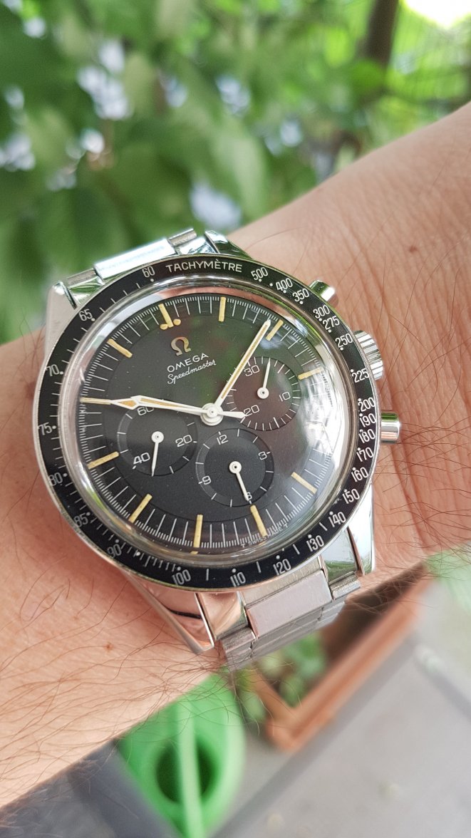

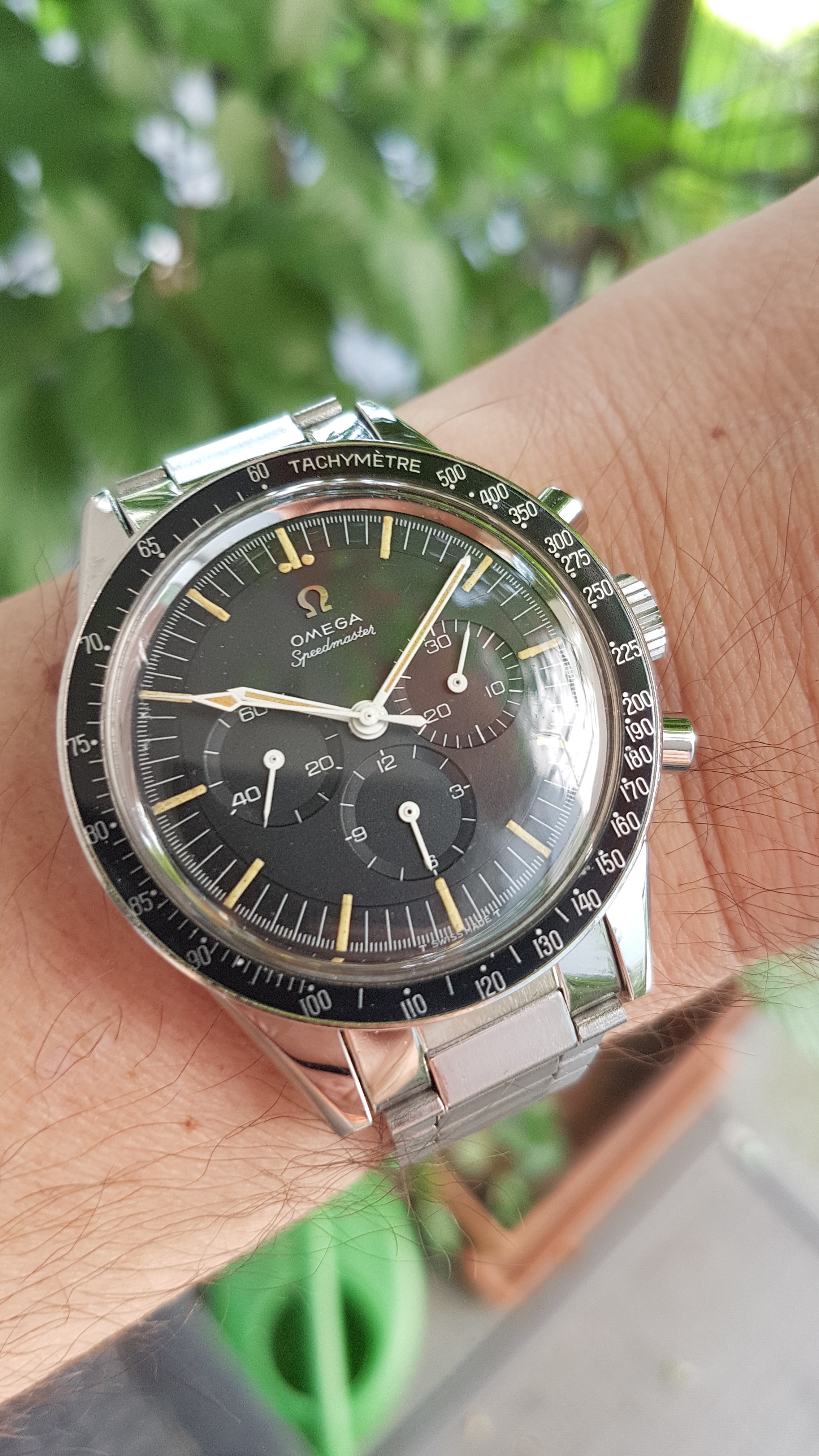

Do you have a picture of a watch? Here is my 105.003-63:

Thanks for the pic-- I gather you are agreeing a -63 Ed White can have the standard closet TT's? I don't have a watch to show: I am looking for one to buy, potentially!

You can take the picture of my watch as a reference, on how the TT should look like or you can decide it should look different.

I would agree a -63 dial can look like yours does (with standard close TT), as long as the production date based on the movement serial is around mid-1964 or later.
