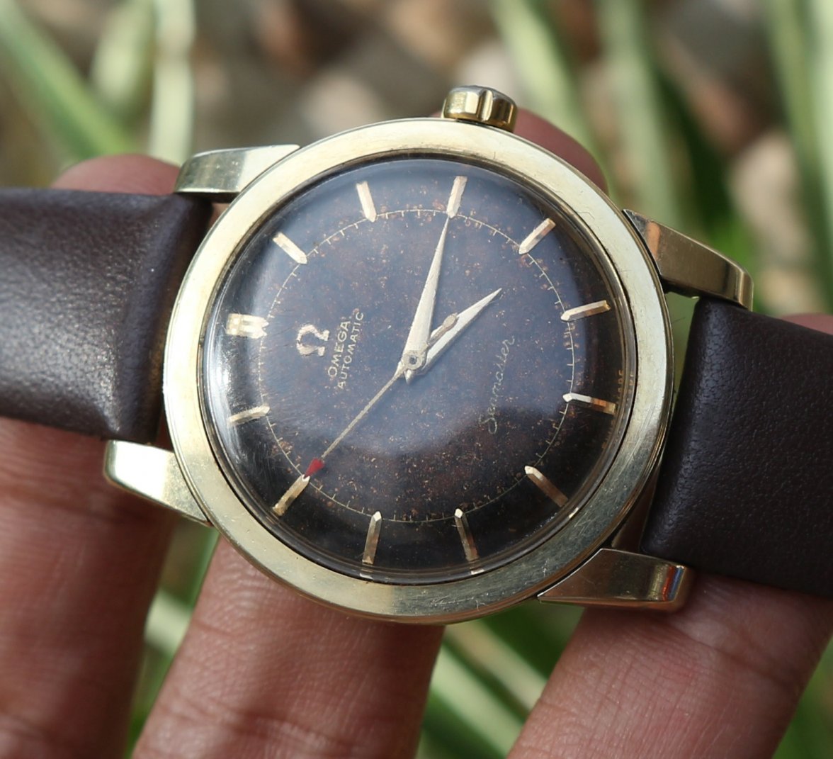

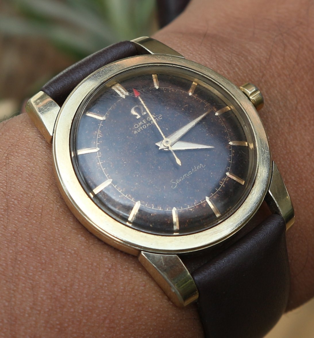

I think the second hand is not correct for this watch. I don't think it is supposed to be a sweep second hand at all, looks more like a counter or indicator hand.
The colour appears to be different from hour and minute as well.

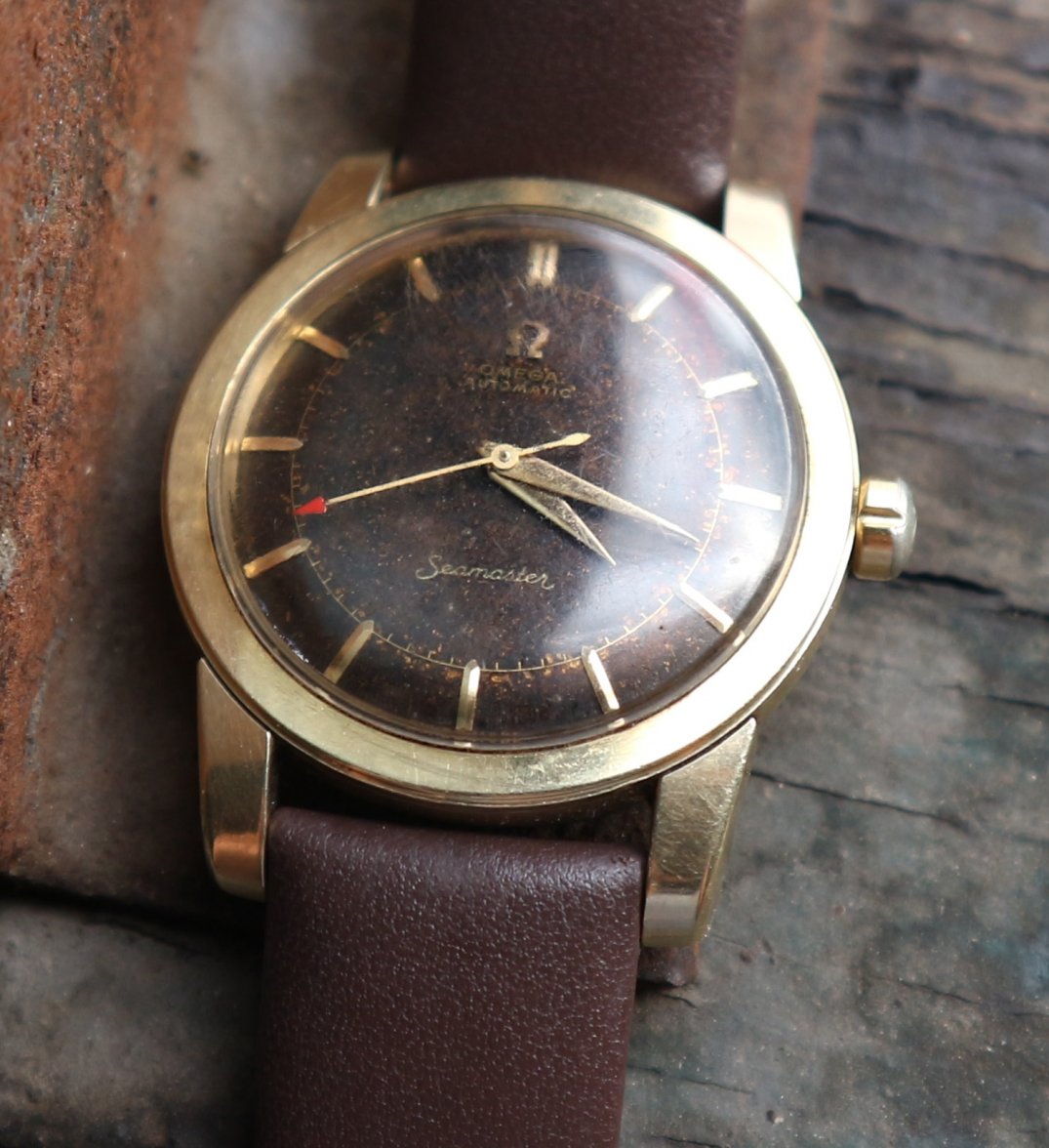

The one from closer is a redial by the way. But that's irrelevant dor the question...😁
16,305
45,025
Not original- and as @Shabbaz pointed out, Closer’s isn’t original either and the “Cima Star” I believe is a bad translation of “Seamaster”. I will say the translation on that page is hilarious:

I agree with the others that you have the wrong second hand on your watch.... because you have an original Omega case and Hour/Minute hands.
I have an old 28.10ra watch that uses your second hand in an aftermarket case with aftermarket hands.. Most likely assembled that way here in the U.S. by a distributor or Jewler..... But I believe Omega would not have used that

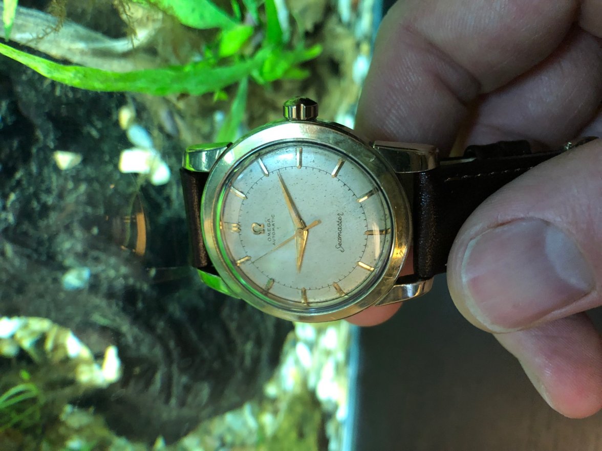

This kind of centre second hand might be Omega but is not correct for a Seamaster at all.
Arrow hands like this can be found on ref 2242...
