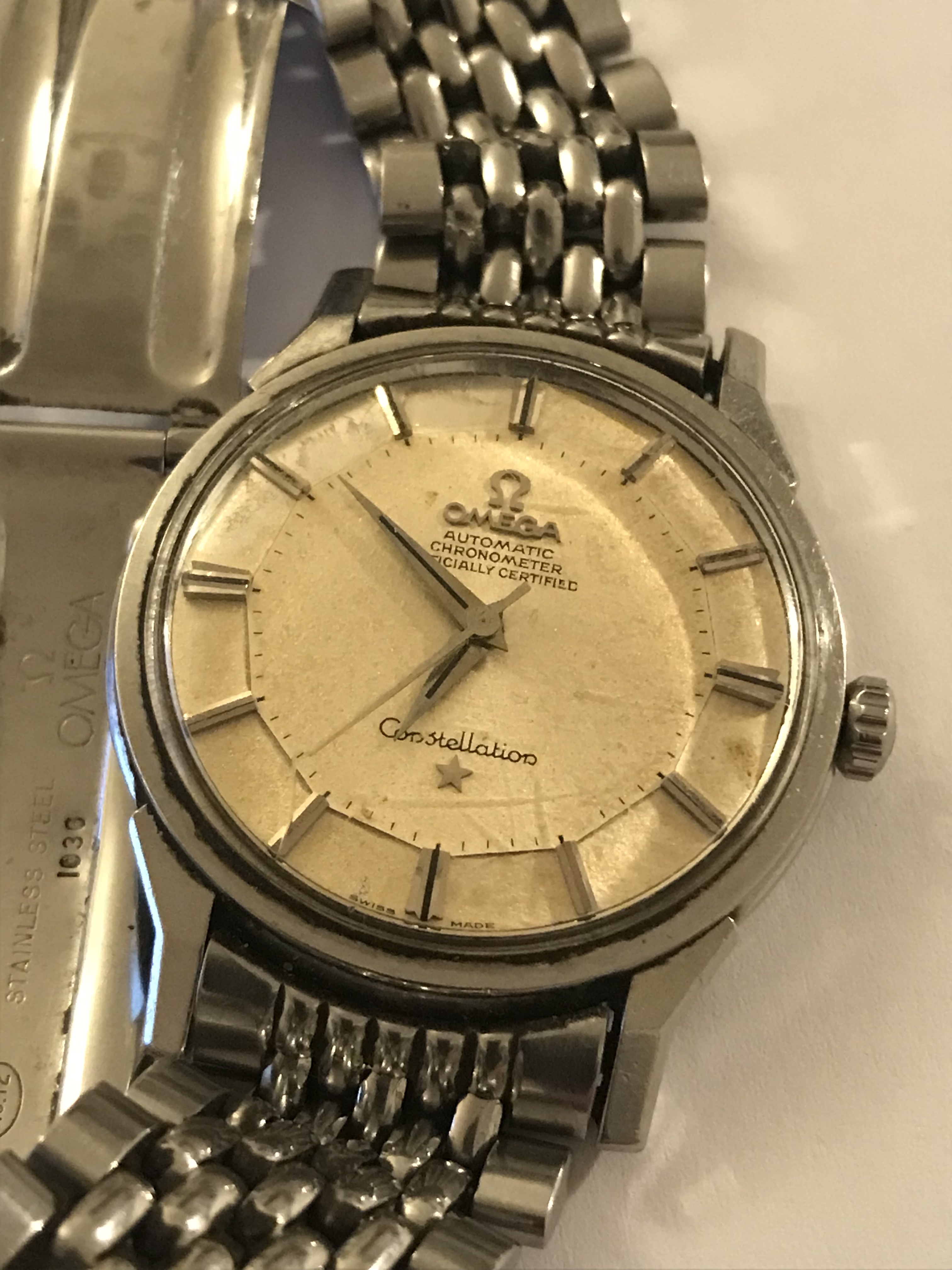

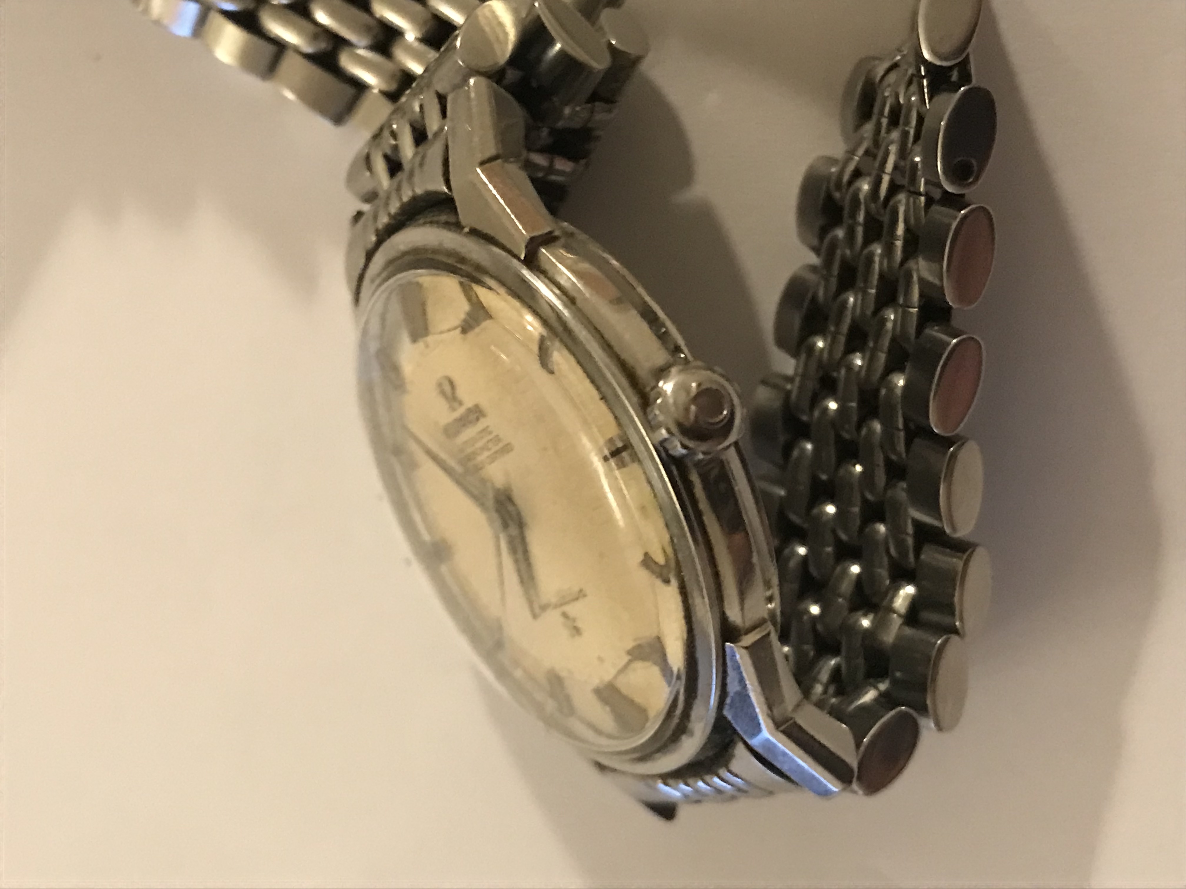

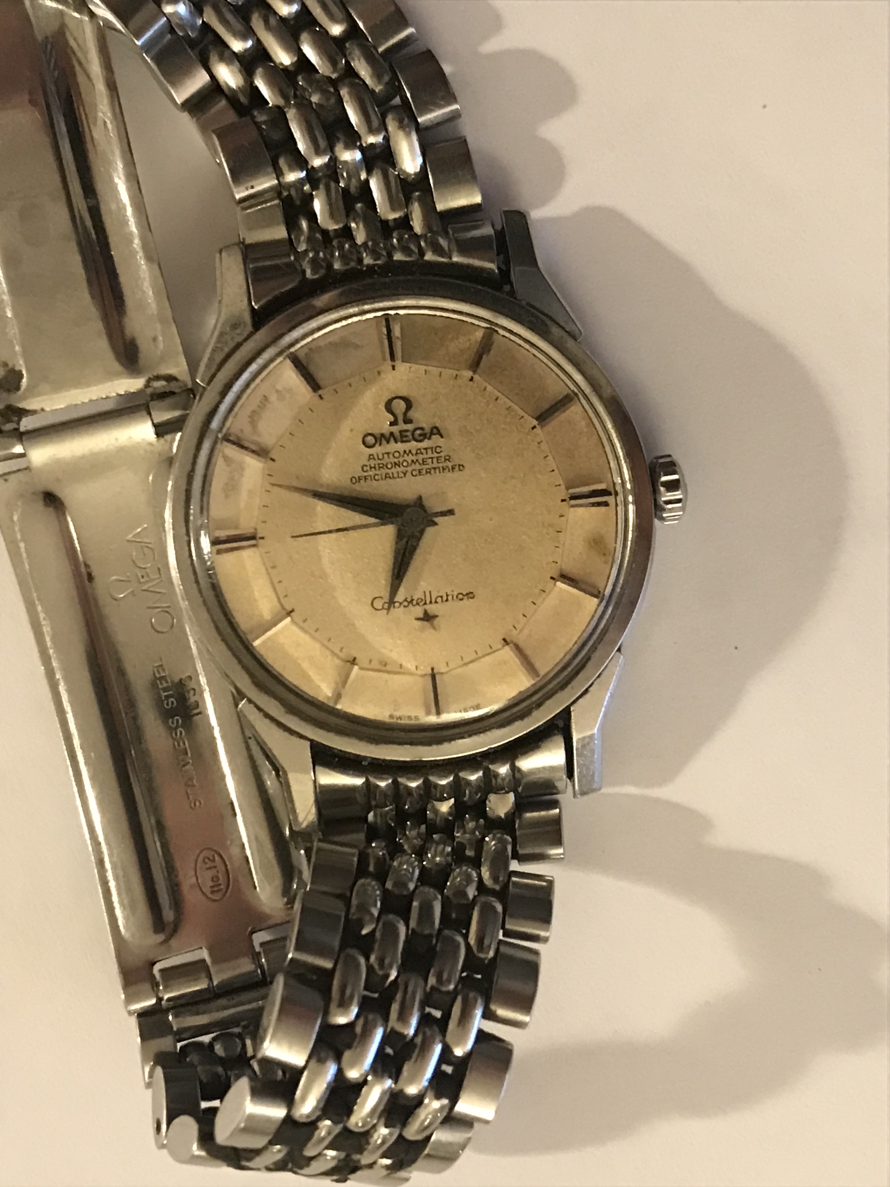

Hello,
Sorry, I 'm a novice in watch.
I've just buy this omega constellation pie pan.
this watch will go to be cleaned but before I would like a little bit more about.
Is any body can say to me, what kind of model it is, before a watchmaker opened it?
thanks for yours answers
2,816
6,951
It’s a 167.005 reference with a pie pan dial and presumably a 551 movement. It looks like the paint on the top of the non-3/6/9/12 markers has been at least partially removed. The second hand is too short, and the crown is incorrect.
1,120
1,792

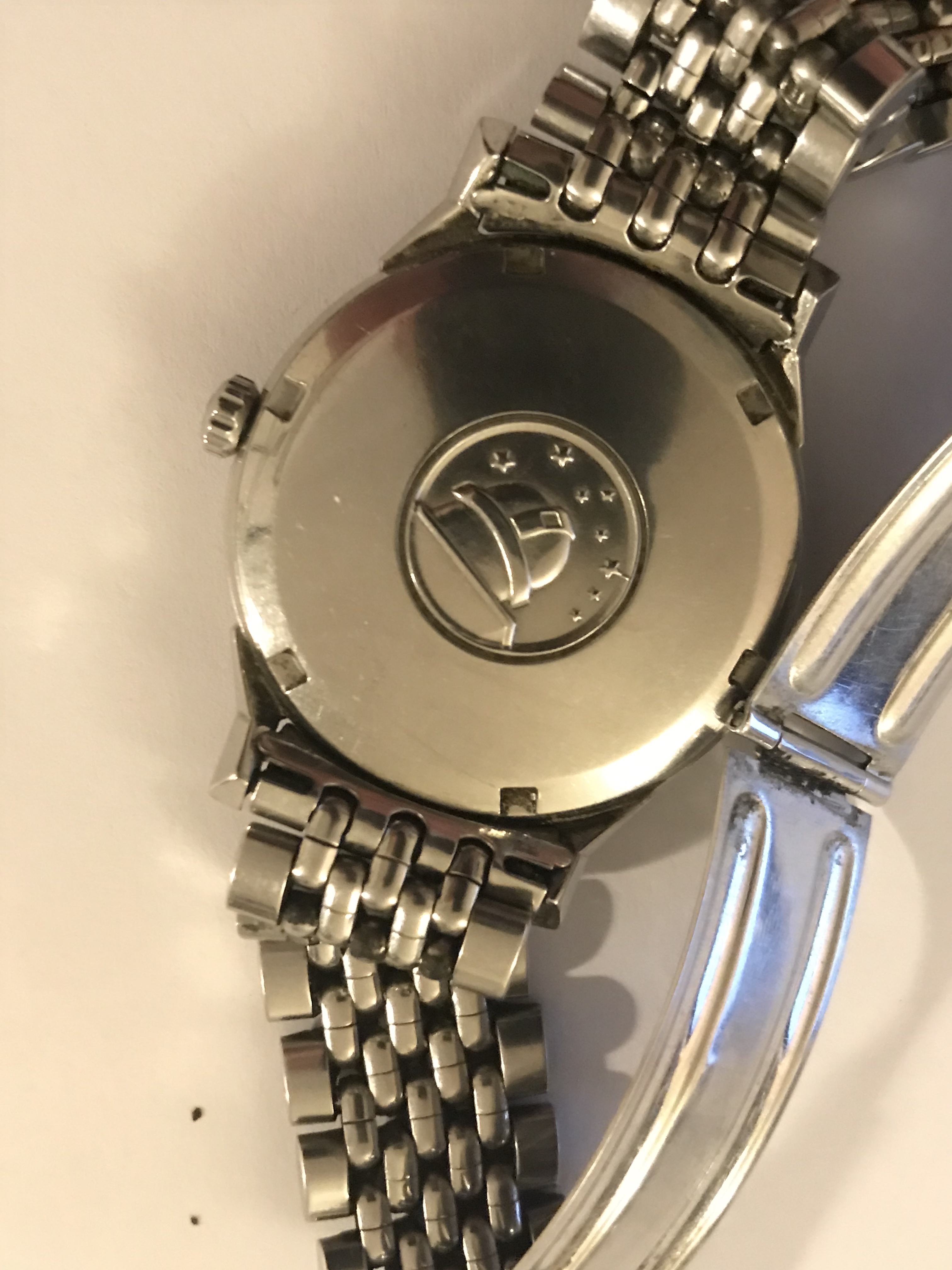

It’s a ref 14900 or 167.005, more than likely the later but could be either.
2,816
6,951
1490* refs have a slight bevel surrounding the medallion on the caseback.
6
cleaned or revised or repared by a watchmaker.
when you say "the crown is incorrect" what do you mean?
2,816
6,951
Thanks fors answers, can you say what kind of model is?
This crown is referred to as a “decagonal” crown since its 10-sided. 4204 is the part number.
3,595
13,551
Wrong bracelet too, no? The endlinks certainly don't fit.
Yeah, it’s an earlier bracelet, 5-row BoR - correct would be a 7-row, 1503 with 70 endlinks to be period-correct. Not really an issue though, in my opinion, as it can easily be sold and the right one be bought for the same money. As mentioned above, the other “issues” are definitely prevalent.
