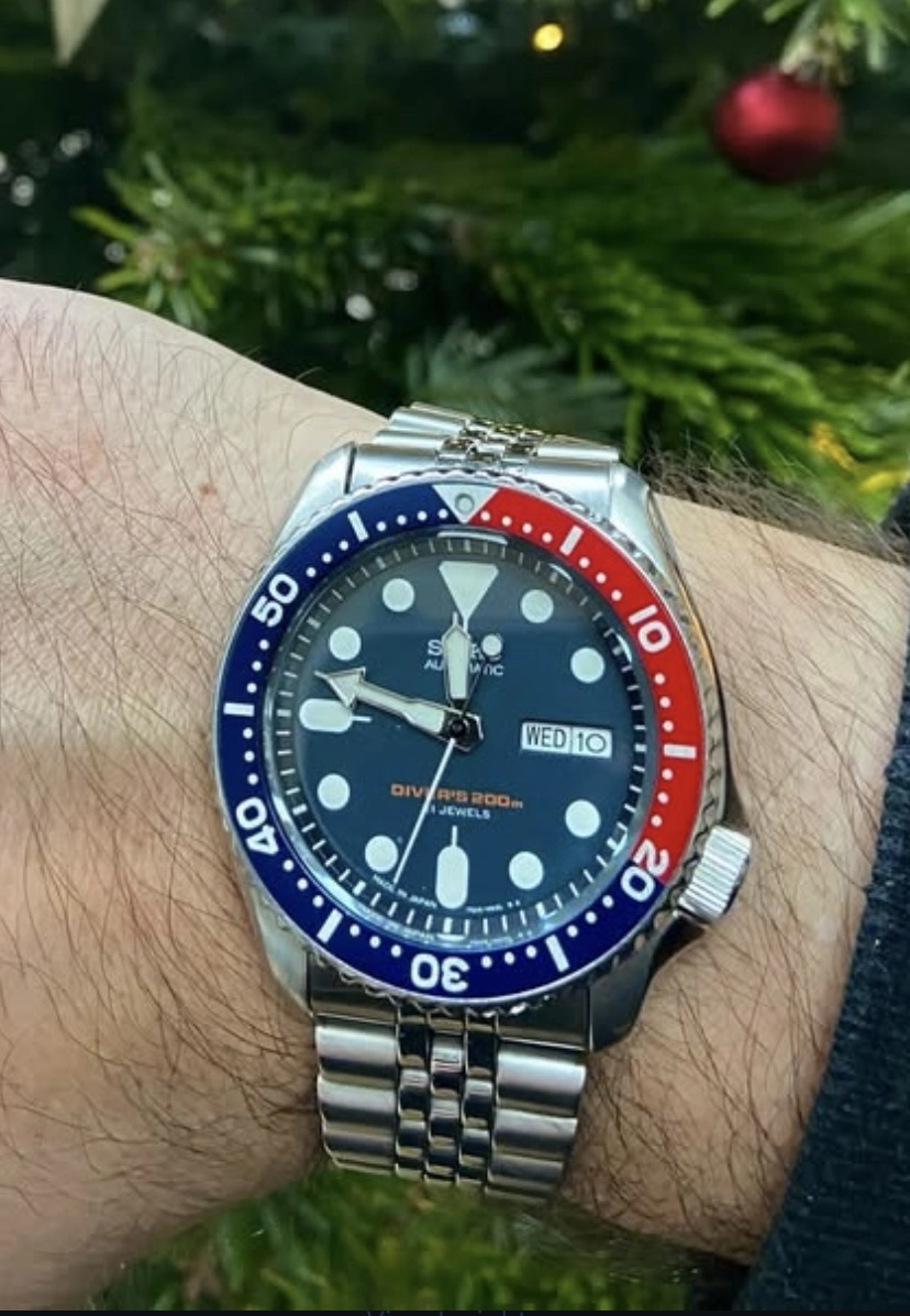

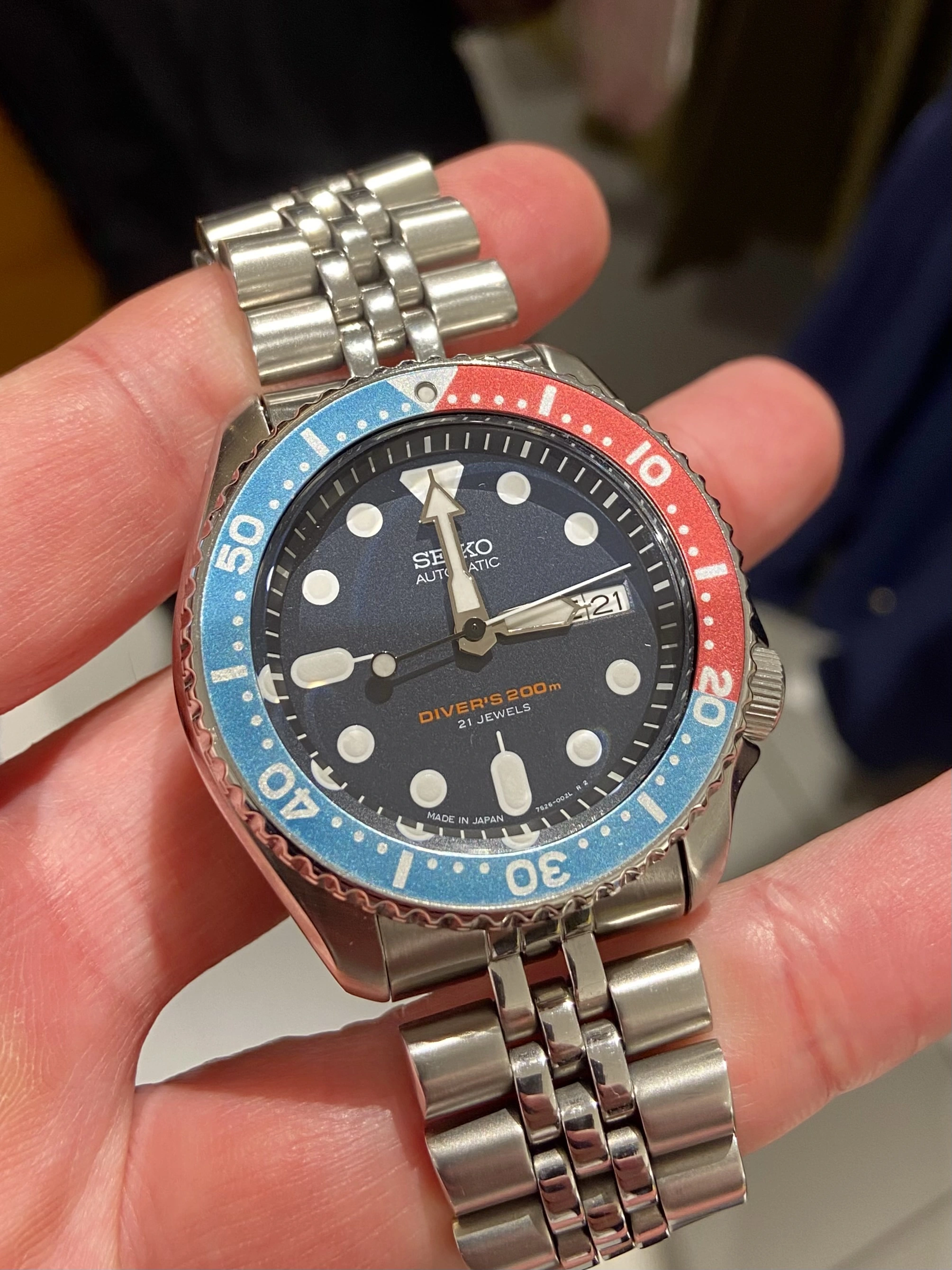

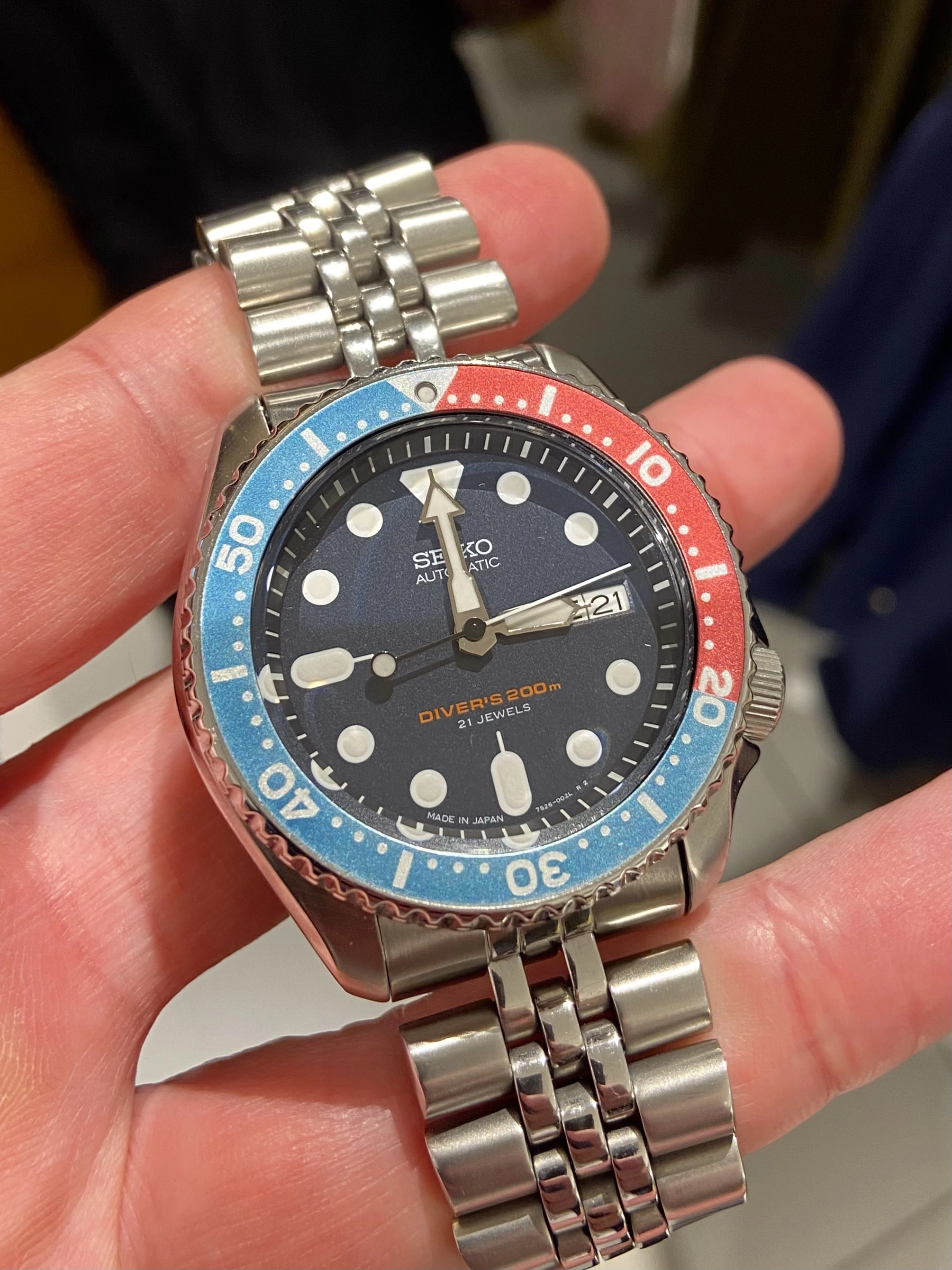

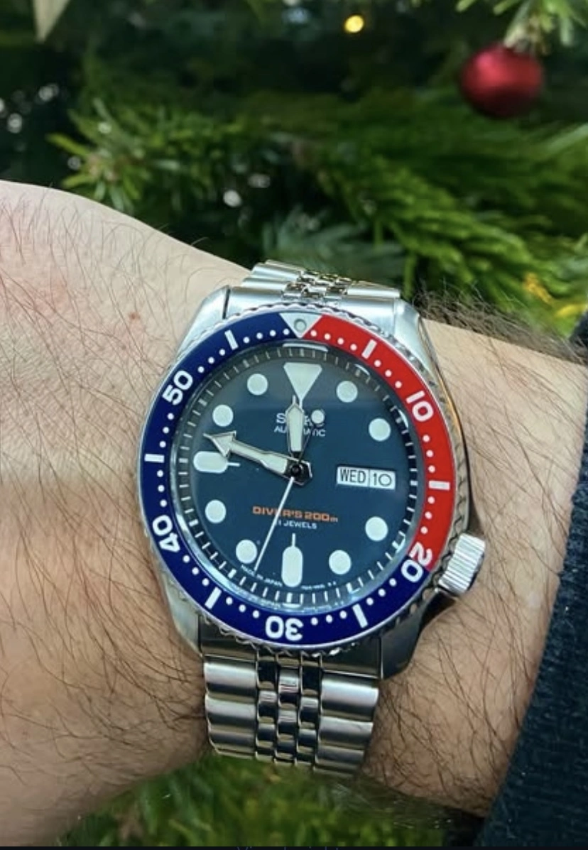

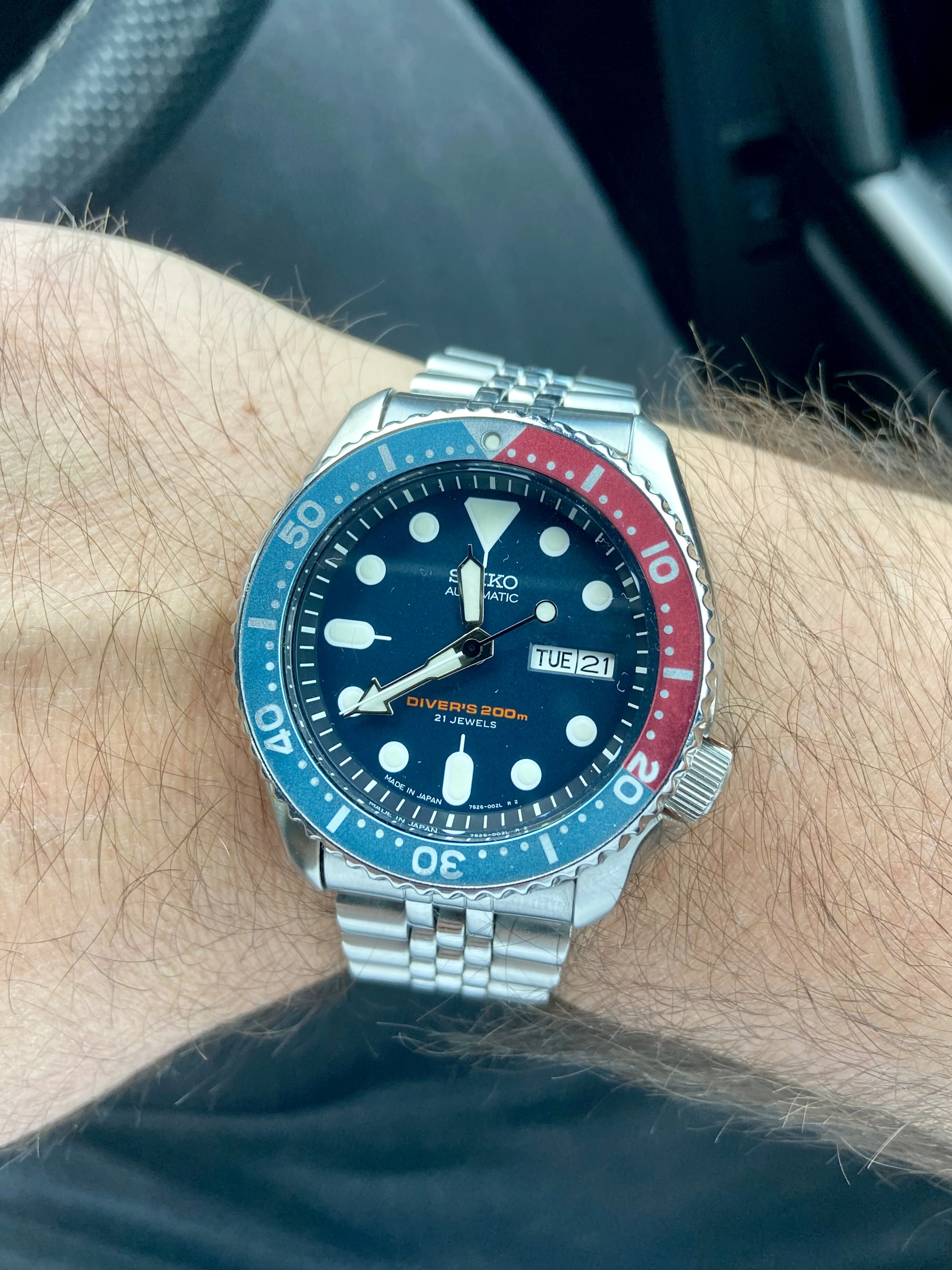

Here’s the results. I wouldn’t artificially fade a bezel on an expensive or collectible watch but on a cheap SKX I think it looks great, the subdued and faded blue and red and perfect for me and really elevate the look of the watch from the standard, vibrant colours it has when new.

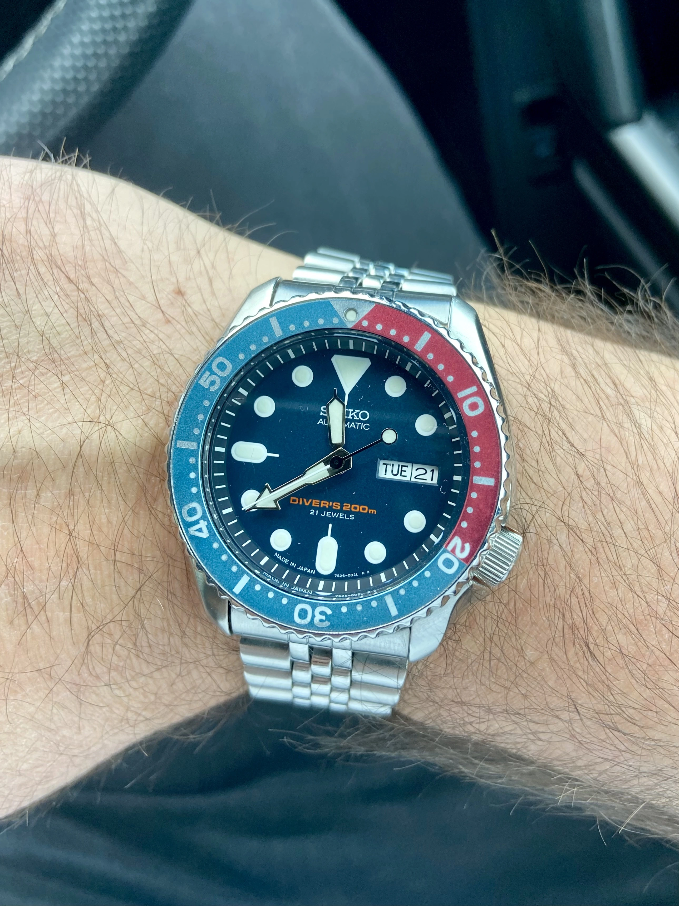

Before
After

Looks great, thanks for sharing your process and results. I always find this type of post / thread enjoyable.

You achieved a totally different look. 👍

Definitely like it I was expecting a different result for some reason.
