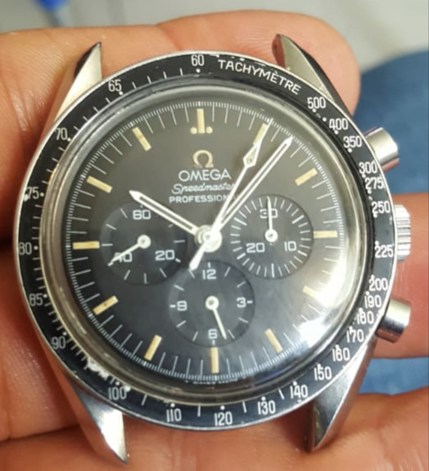

So this watch has thoroughly stumped a FB vintage Speedmaster group...
I also told them what it is, and they are telling me I am wrong...
Can you tell what it is?
2,519
17,845
A problem for sure.

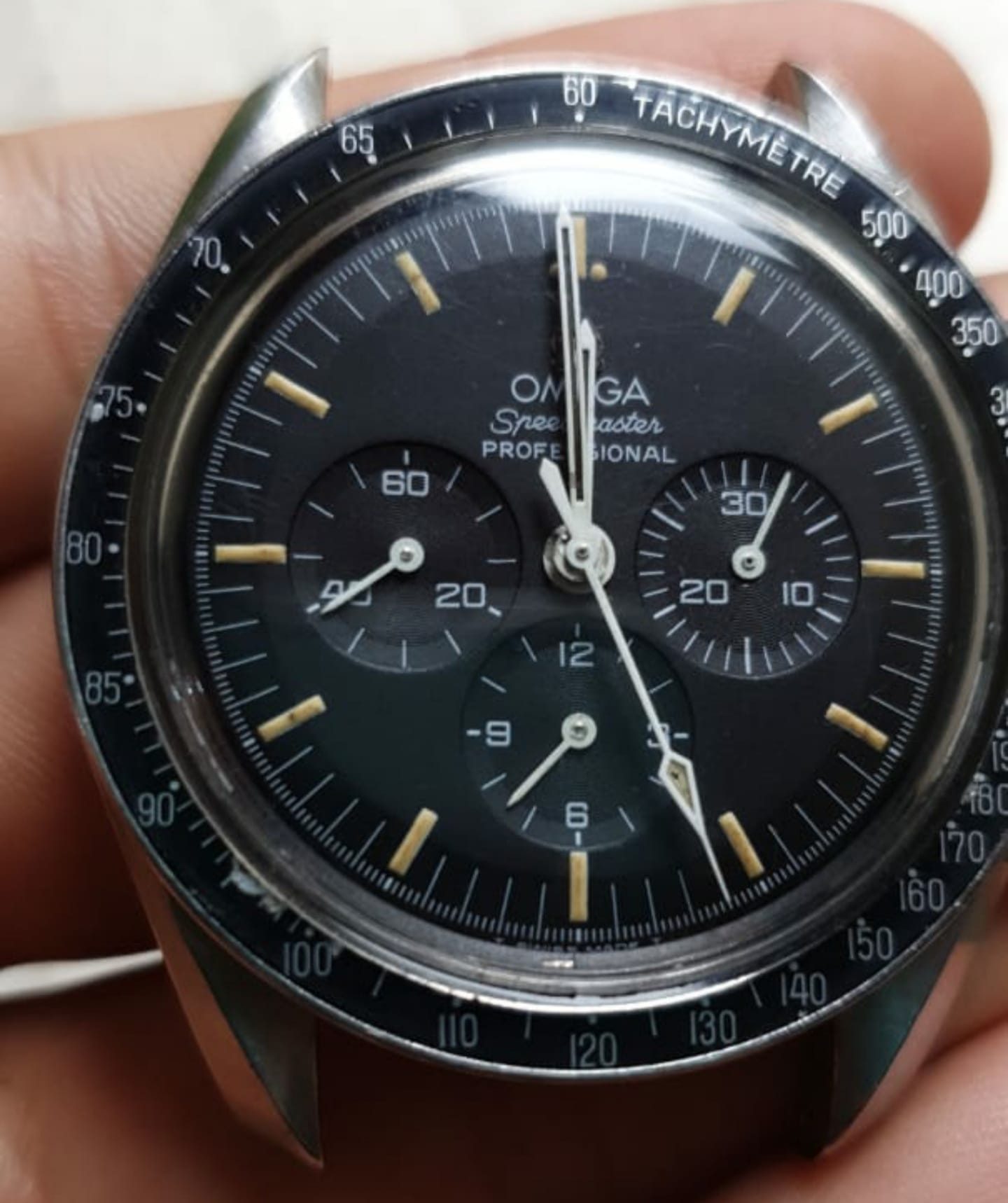

What’s up with that dial? It hurts my eyes. That’s not just a service dial.
But, I don’t see any other big issues.
1,565
3,678
Looks like a 90's era dial on which a fancy pseudo metal logo was glued.

I have a slightly different conclusion... but @Seaborg the FB group is focusing on that and drawing weird conclusions IMHO
875
2,608
A 105.012 22M serial - correct for a 65 it would seem
Was this sent to Bienne in the 90s for a service....
12,148
40,476
Almost certainly a complete put-together with a 3590 dial that's had an Omega logo glued to it.
22m movements could have been in 105.012s, in the -63 or -64 but those are too rare for this to pass Occam's razor.
18,326
27,695
I am torn between that and a service dial... That is not the conclusion they are coming to though.
6,546
22,342
I'll play. Only way to learn. This is based on what I think i see in the pictures.
Dial looks like a 145.022-76 that was relumed. Can't see a step and the dial seems to have a dome, not flat.
Has wide Ts, which the 105.012 65 could have either. Short plots.
A spear is correct for 105.012 65 chrono. The chrono spear is nicer than the hands so they don't seem to match.
The serial number matches the case model per ilovemyspeedmaster.com (although the number 6 looks wonky, probably picture). Can't tell the difference between seamaster and speedmaster 321 anyway so the movement seems okay and matches case back, assuming it's double bevel.
Don't have much experience with DON bezels. I think the number 1 in the 130 and 140 have little tails in the original bezels. Hard to see them in the pics. Has nicks but I would ask for a second opinion on the bezel since i am inexperienced but suspect.
I am prepared to take my medicine now. Looking forward to the answer.
12,148
40,476
Don't most of the AML service dials still have the medium-S font though?
18,326
27,695
Who knows... I have seen so many variations at this point I just assume service dial. At the end of the day service dial or someone sticking an AML on a later dial and then making it fit a 321, would lead to the same price. Looking at the dial back would clear that up.
@pdxleaf That is not even close to either 145.022-76 dial variations. The Speedmaster font is early 90's or so.

Idk but I hate it... That’s a FOIS AML, no? How can it be anything but a 90’s dial with a FOIS AML stuck on it?
Its on a 321...

Its on a 321...
Have they not been modified before? I know usually the other way around since the 321 needs longer feet, but it seems someone is into modding, so... seems well plausible to me. I can’t think of a more plausible option so that’s my guess. What do you think it could be?
nah it's got T markings and "Professional" unless you mean just the metal logo itself. I don't think the logo itself is off a FOIS either though, the feet on the FOIS logo are straight whereas this one curves upward like the old logo.
As to the dial feet, the heat required to solder additions on to the feet can often melt the paint, or more of the dial than just the feet, so it's not often done. Chances are this one has had its feet cut, then it's been stuck to the movement with an adhesive.
913
1,596
You’re right, it is different than the FOIS AML Now that I look. I did mean just reapplying the FOIS logo itself on a 90’s dial and sticking it on. I’m stumped then on where the AML comes from then.
