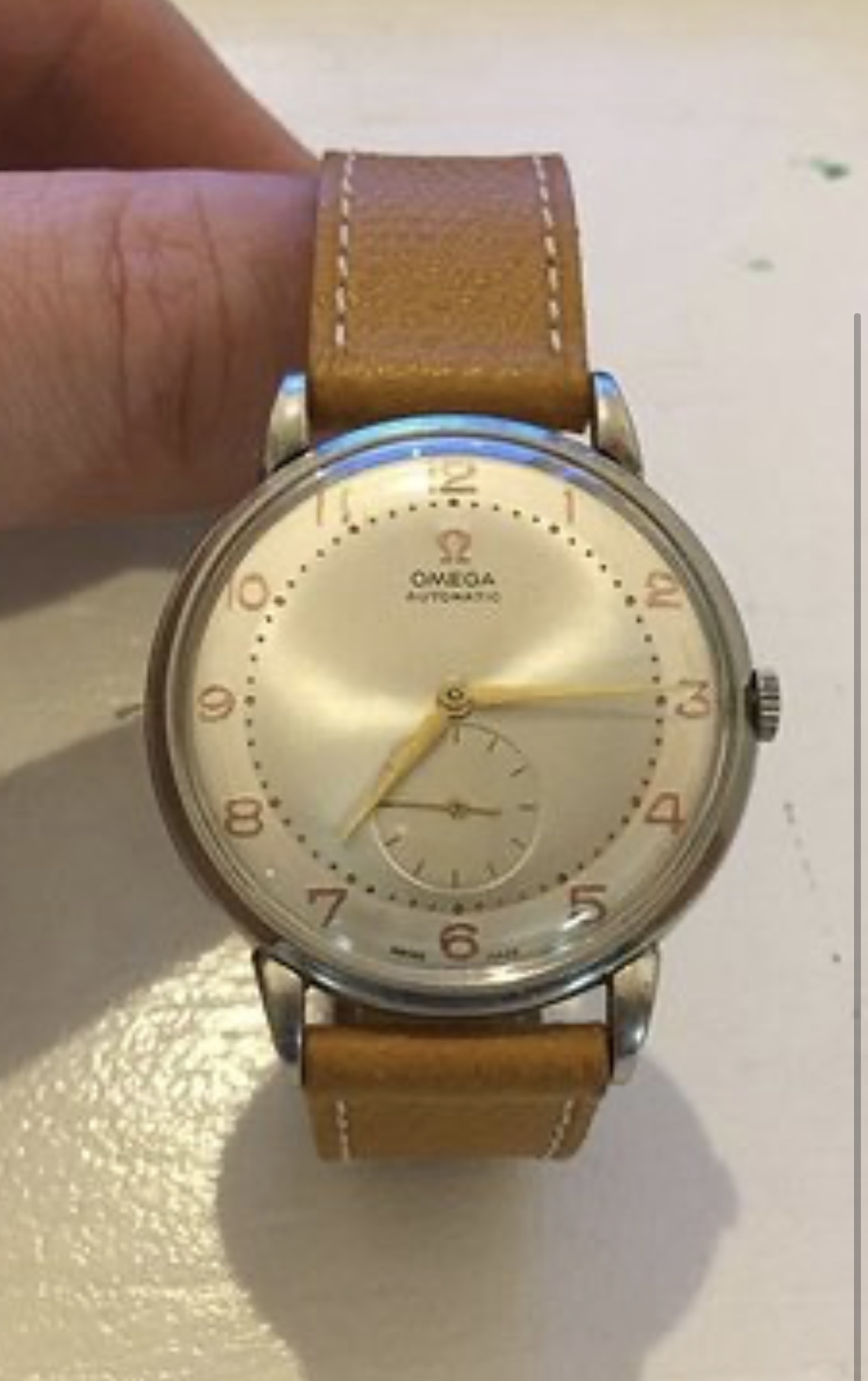

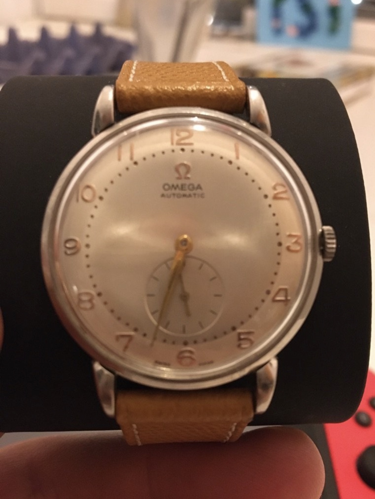

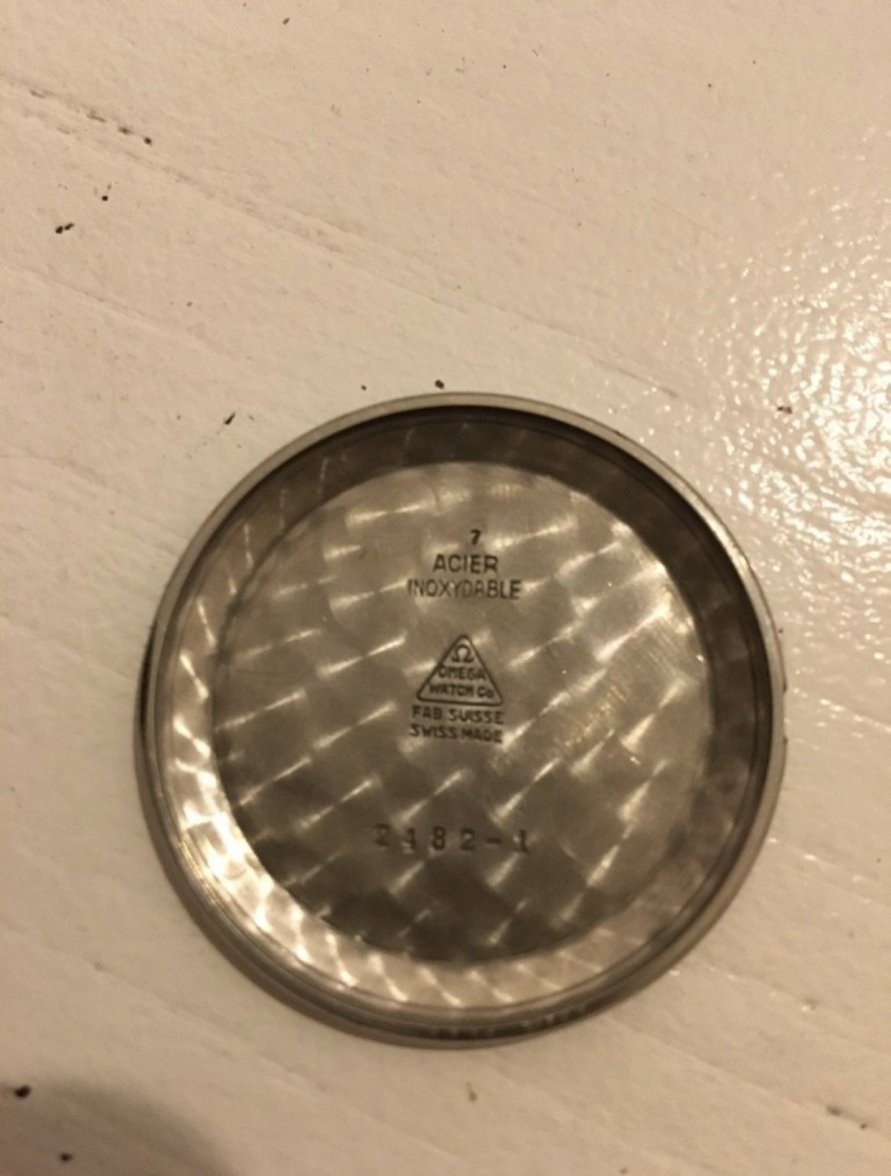

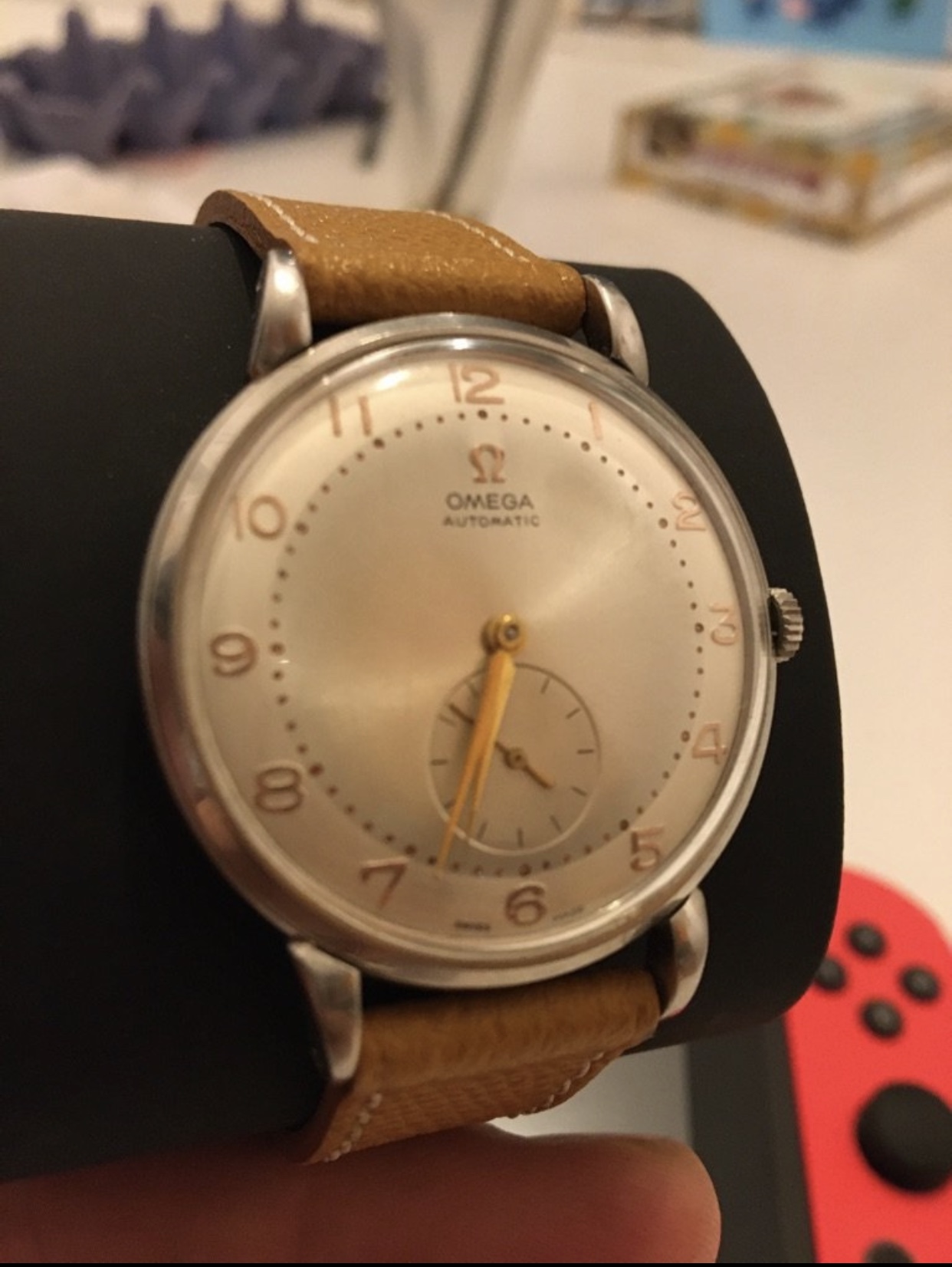

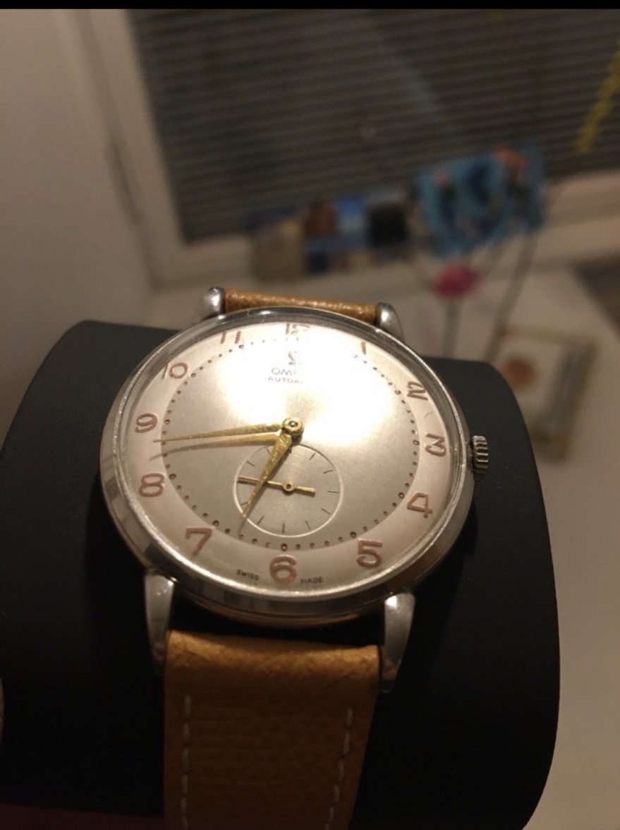

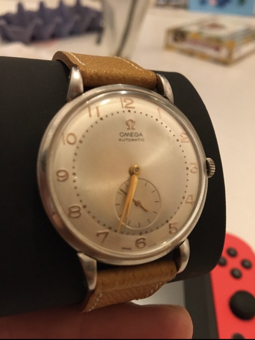

Are these correct hands for this Omega, ref 2482-1
666
485
I’m searching on the net , but something tells me that the minute / hour hands does not belong to this ref ?
Or more likely they belong to this ref but gold case.
Best regards / J

Definitely incorrect.
Not wanting to pile on, but you are aware of the dial having been renovated, right?
3,593
8,210
+1
Minute hand too long for sure!
There is a slim chance that the hands were correct before repainting, but slim to none.
I thought that to , and it’s very good that you point out that the dial is in correct. I really appreciate all help i could get.
That’s how I eventually learn new stuff 😀
5,727
9,513
If your numerals and the Omega sign are golden coloured , gold hands can be ok. These are just the wrong type. Search Google Images for this reference and go from there. .. there might be a few members here, that will have them in their stash..... Kind regards. Achim

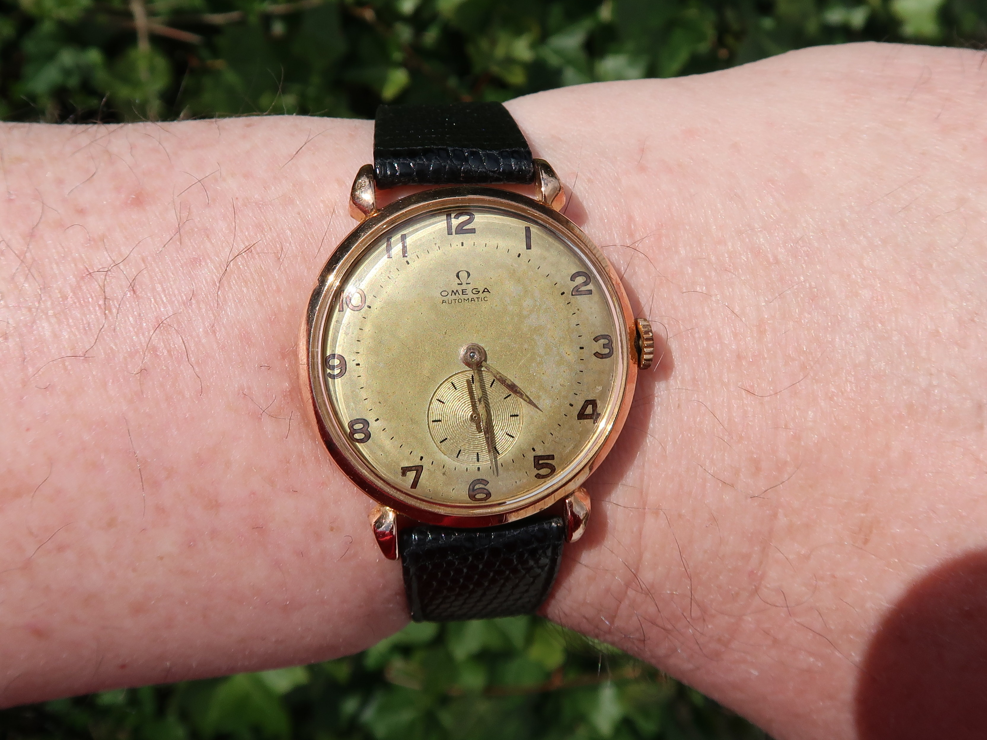

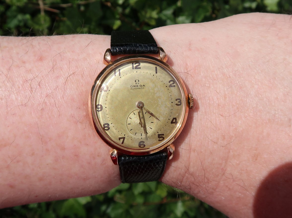

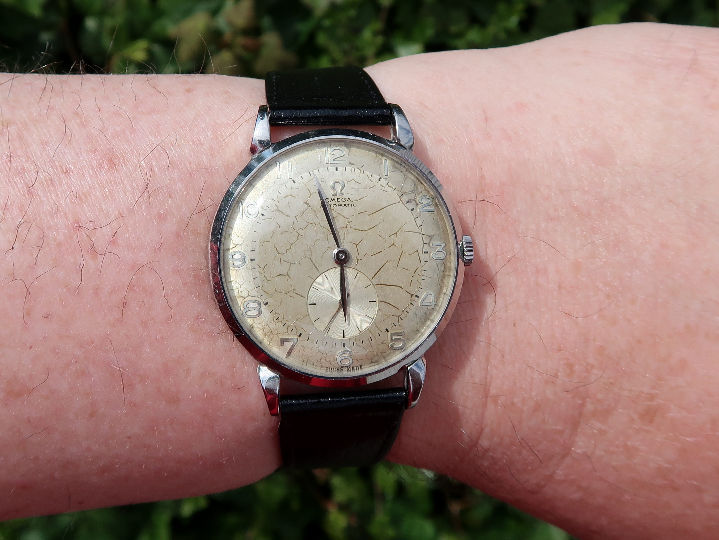

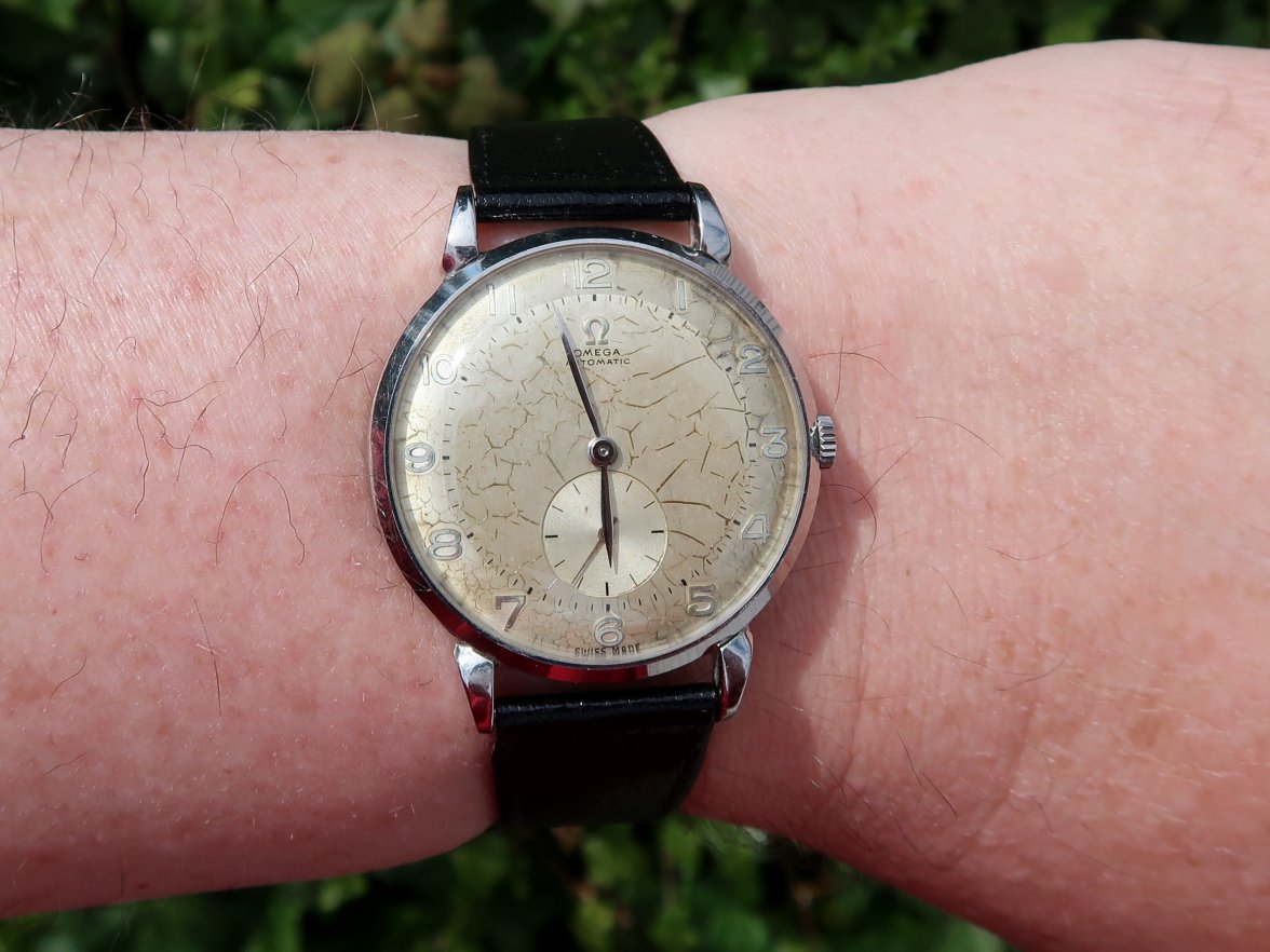

I have these two ref. 2482, they both have the same type hands, so I guess that is the type they came with
