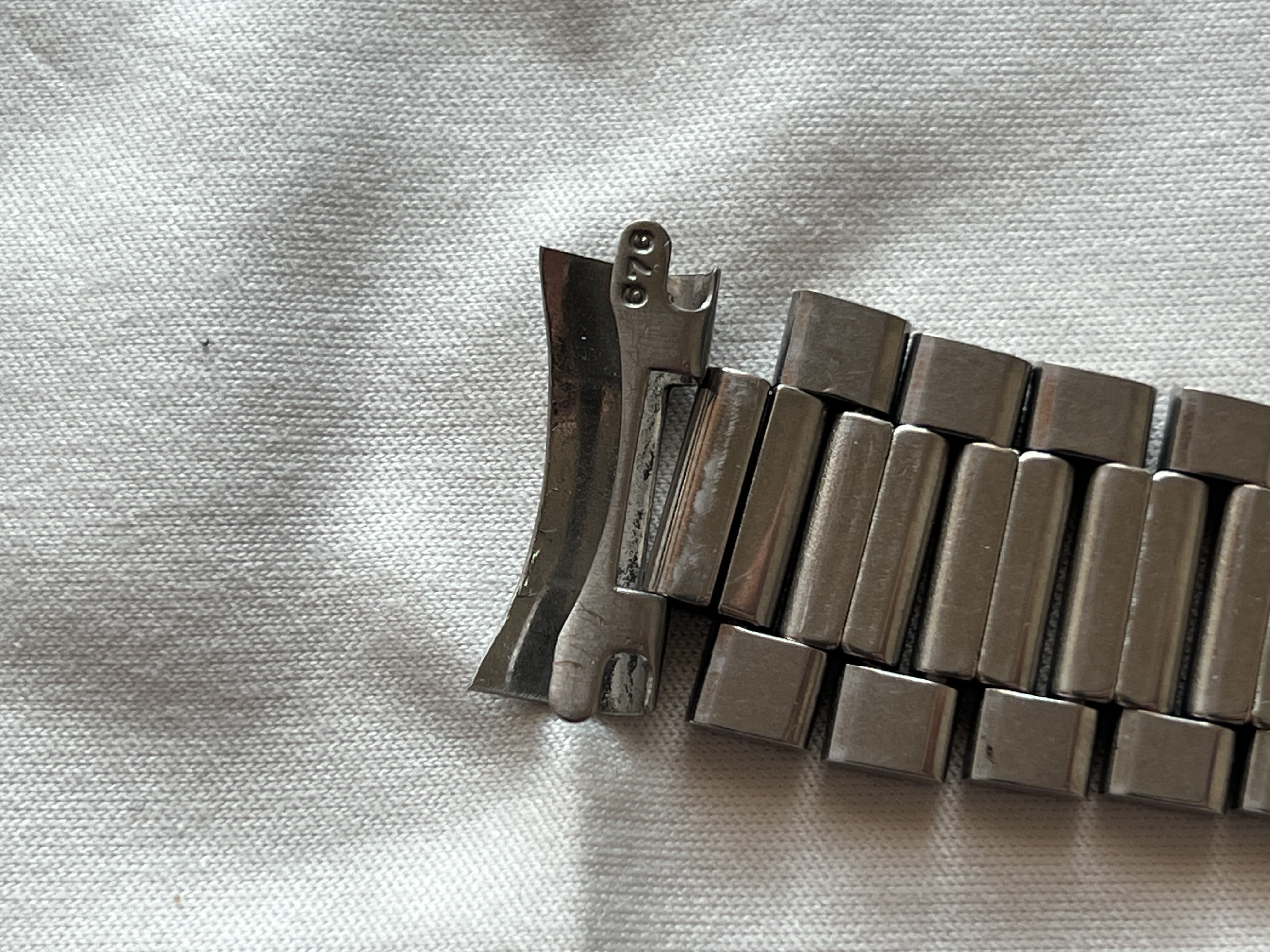

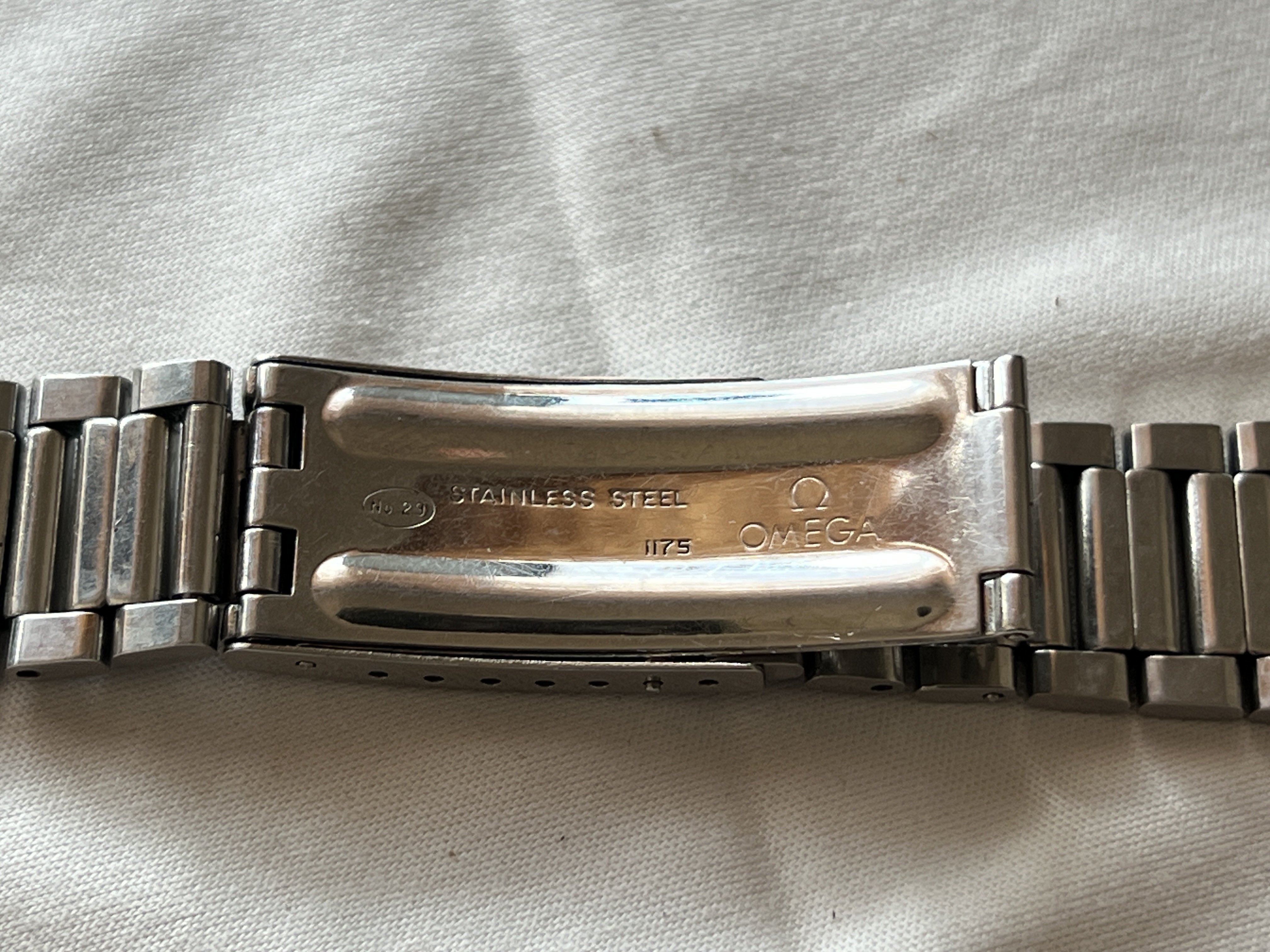

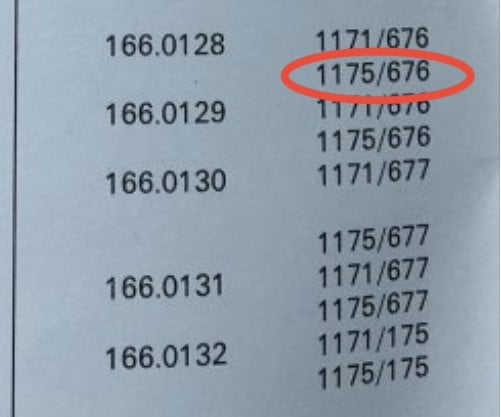

This is slightly odd, but maybe I’m not alone with this. I have a 166.0128 that I wanted to try on a bracelet. The list suggests 1171 or 1175 with #676 endlinks:

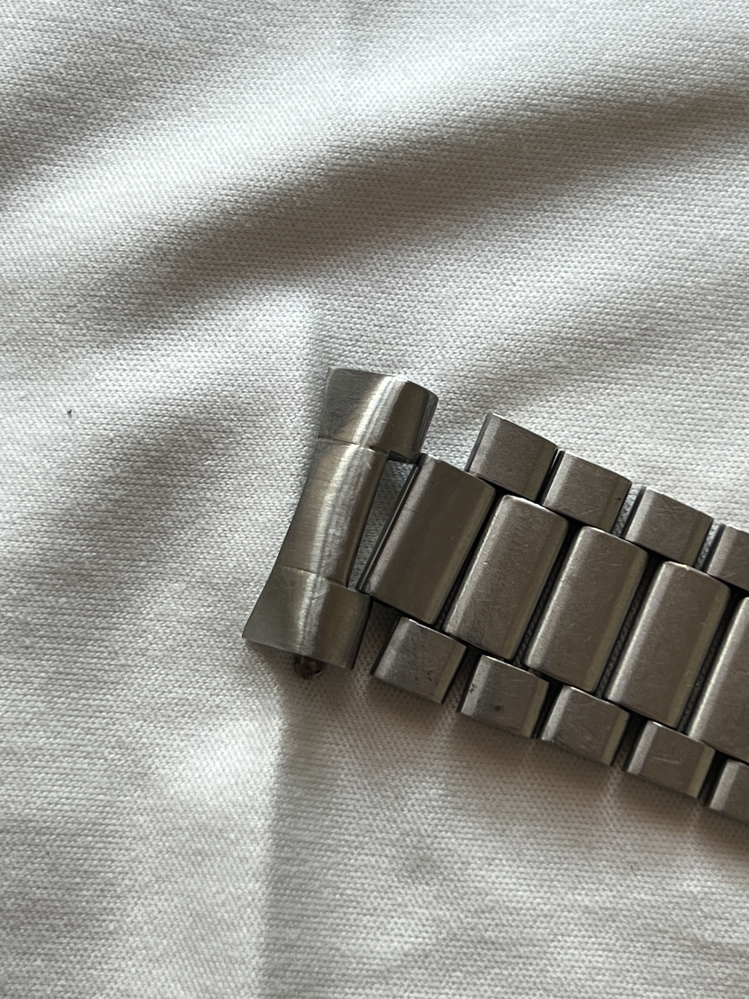

So I bought a pair of #676 from a fellow user here and wanted to try how they fit. The work great on the 1171. However, on the 1175:
Basically, the opening in the #676s is at least 1mm too small for the center link or the 1175. There’s nothing bent out of shape, it’s just how the parts are made. I’ve searched around of course and found other examples where 1175/676 was a working combination…
Any idea what I’m missing? Thanks for any input!
