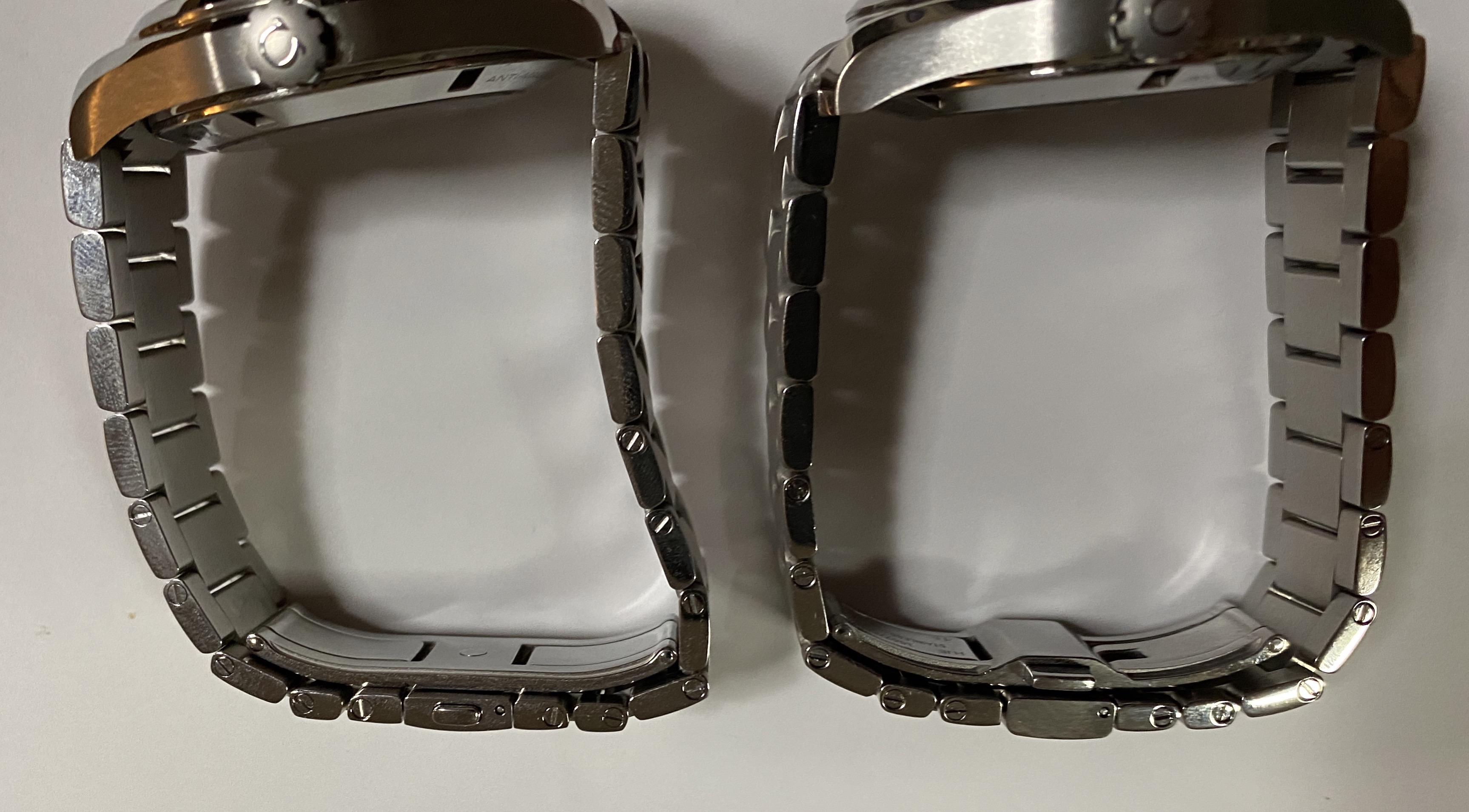

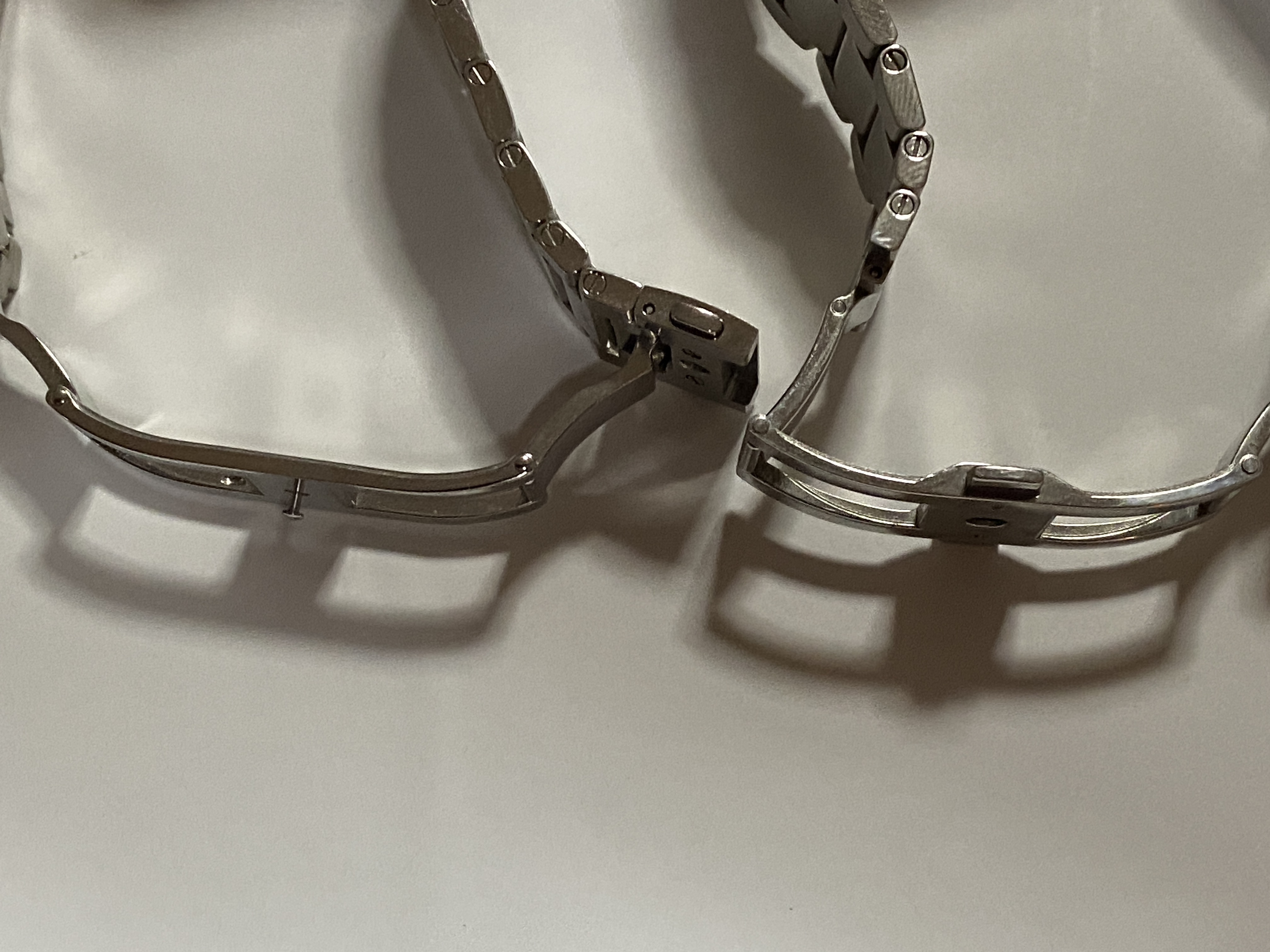

Here’s a retrofitted clasp. Both bracelets are previous gen AT bracelets (8500 series). Clasp on the left is the latest iteration on the 8900 series bracelets. This is the larger 41 and 41.5mm AT’s as those bracelets are 20mm end links tapering to 18mm at the clasp. The smaller size AT’s (38mm and 38.5mm) will have 19mm bracelet tapering to 17mm clasp so be mindful of which one you order.

Tell me, what’s the difference between these two clasps apart from the little bumper in the middle of the older clasp?

the newest version is supposed to be more comfortable to wear.

How the clasp secures. In the older clasp the closure mechanism is recessed into the tines where the bump is. On the new clasp, the closure mechanism is in the cap which allows the tines to be smooth and sit better against the wrist...

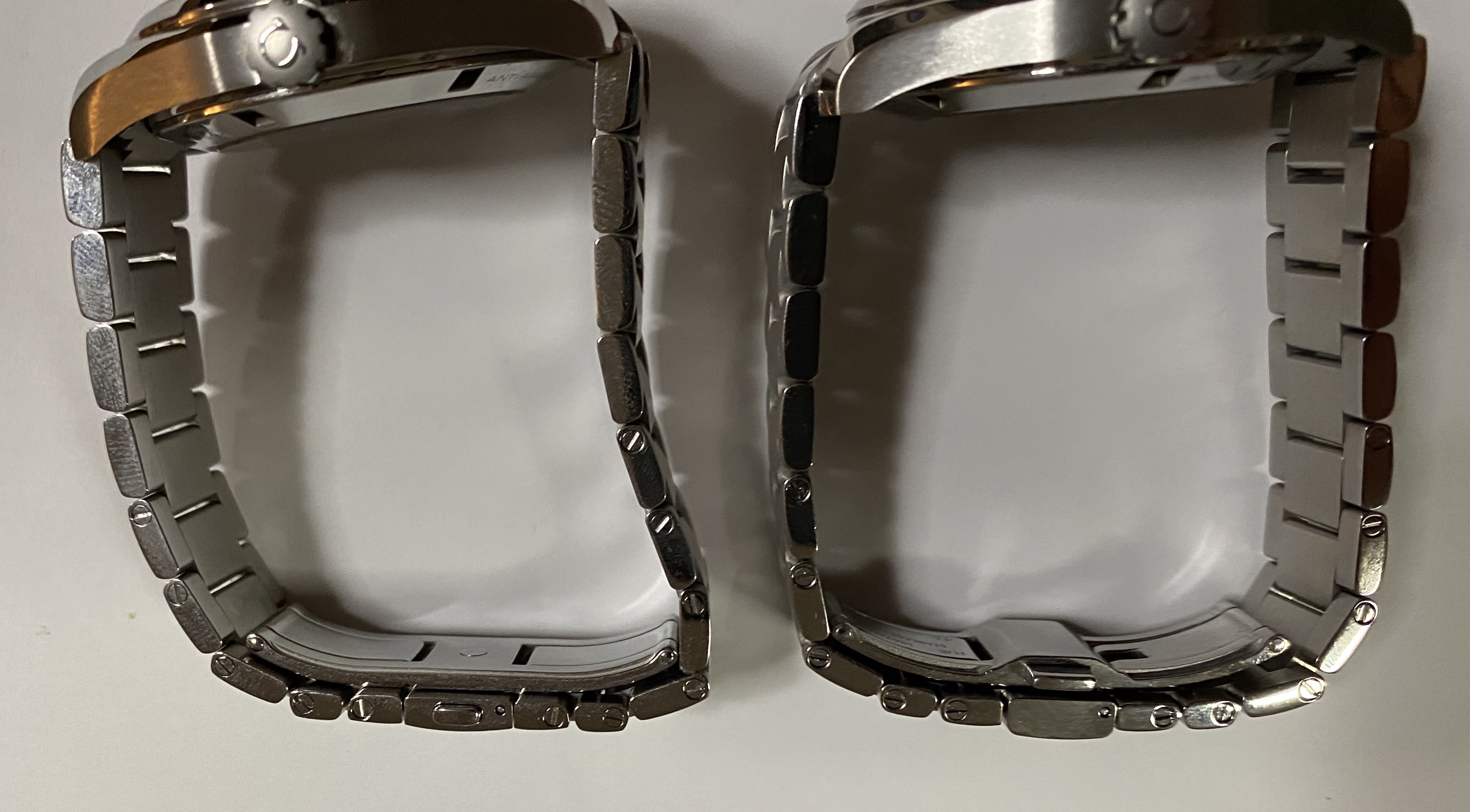

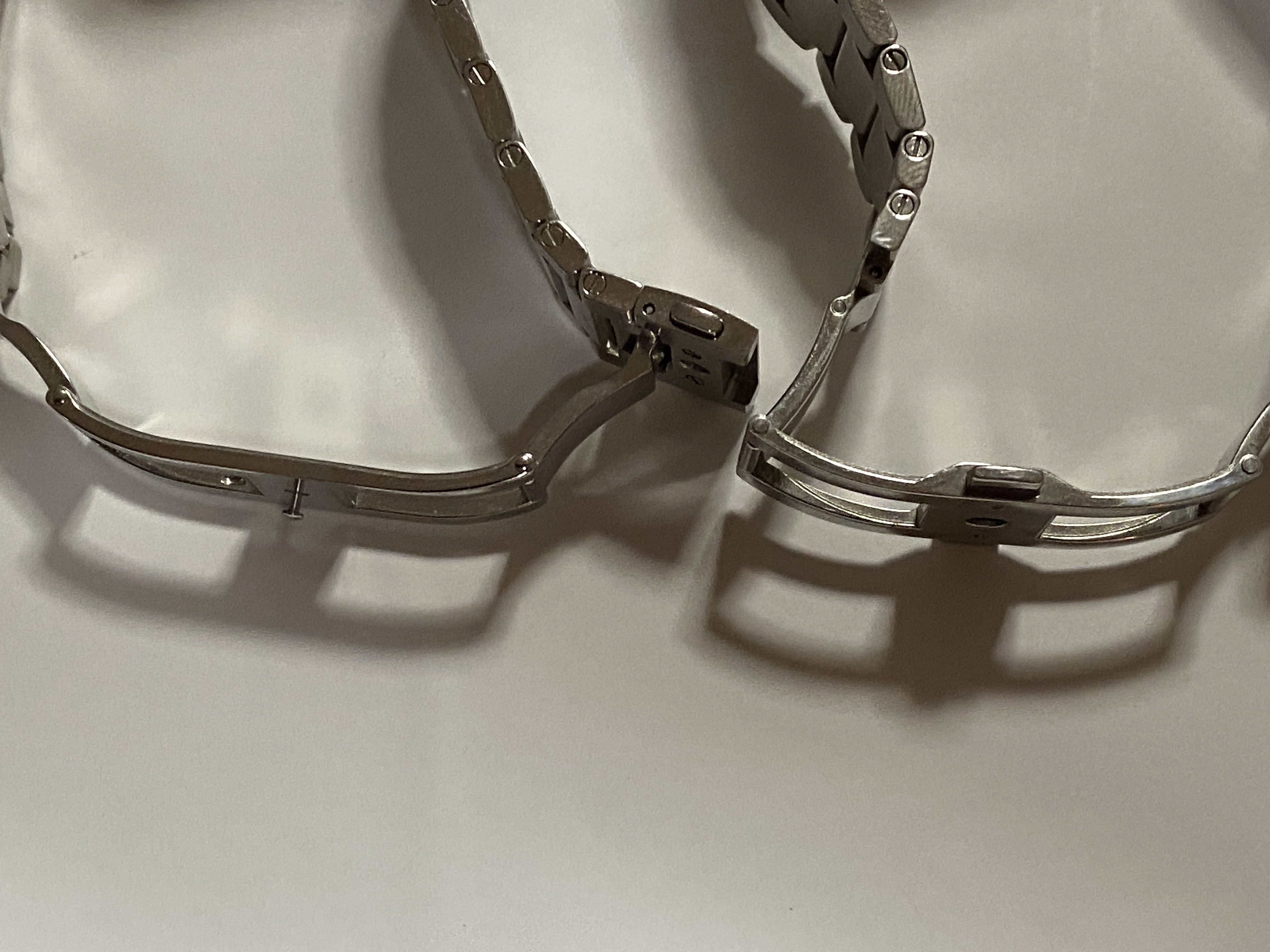

Sorry mate parts are interchangeable. Omega may not support it but that doesnt mean that it can’t be done - they are 2 mutually exclusive points.
See photos above and plenty of other posts on OF around using newer clasp on older AT bracelets.
