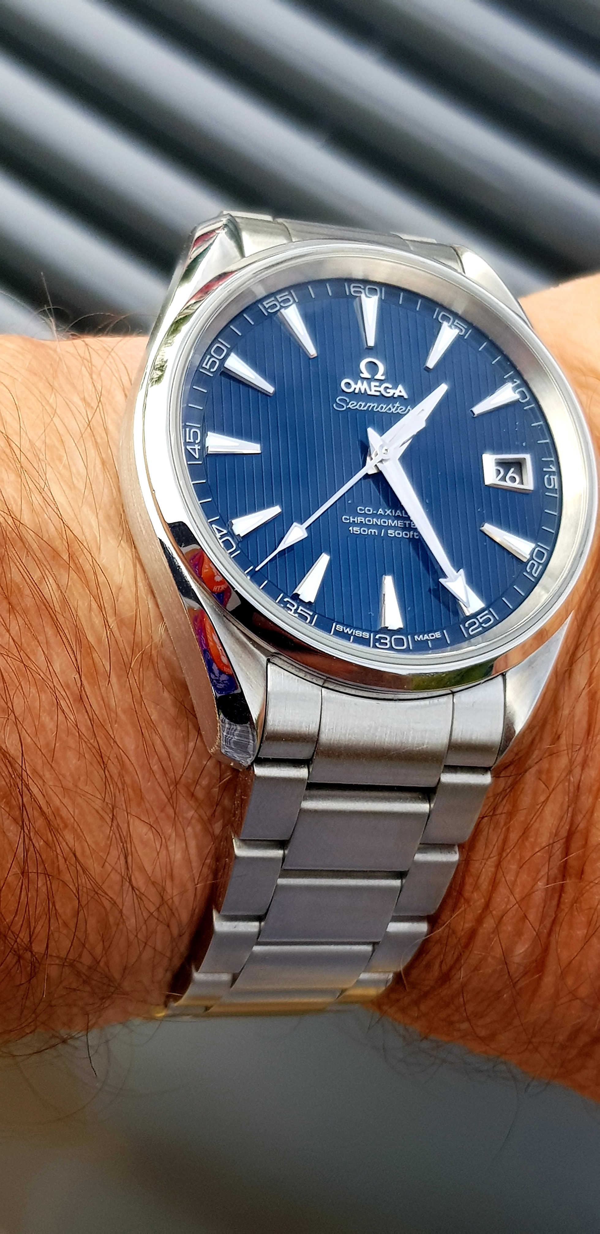

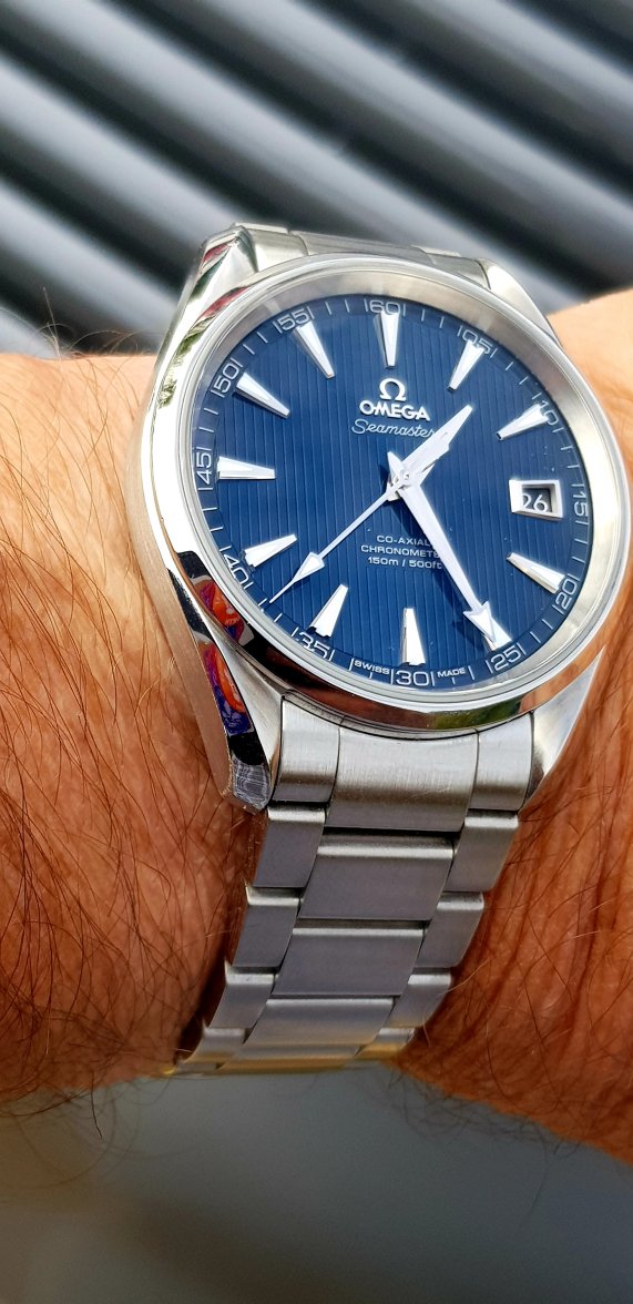

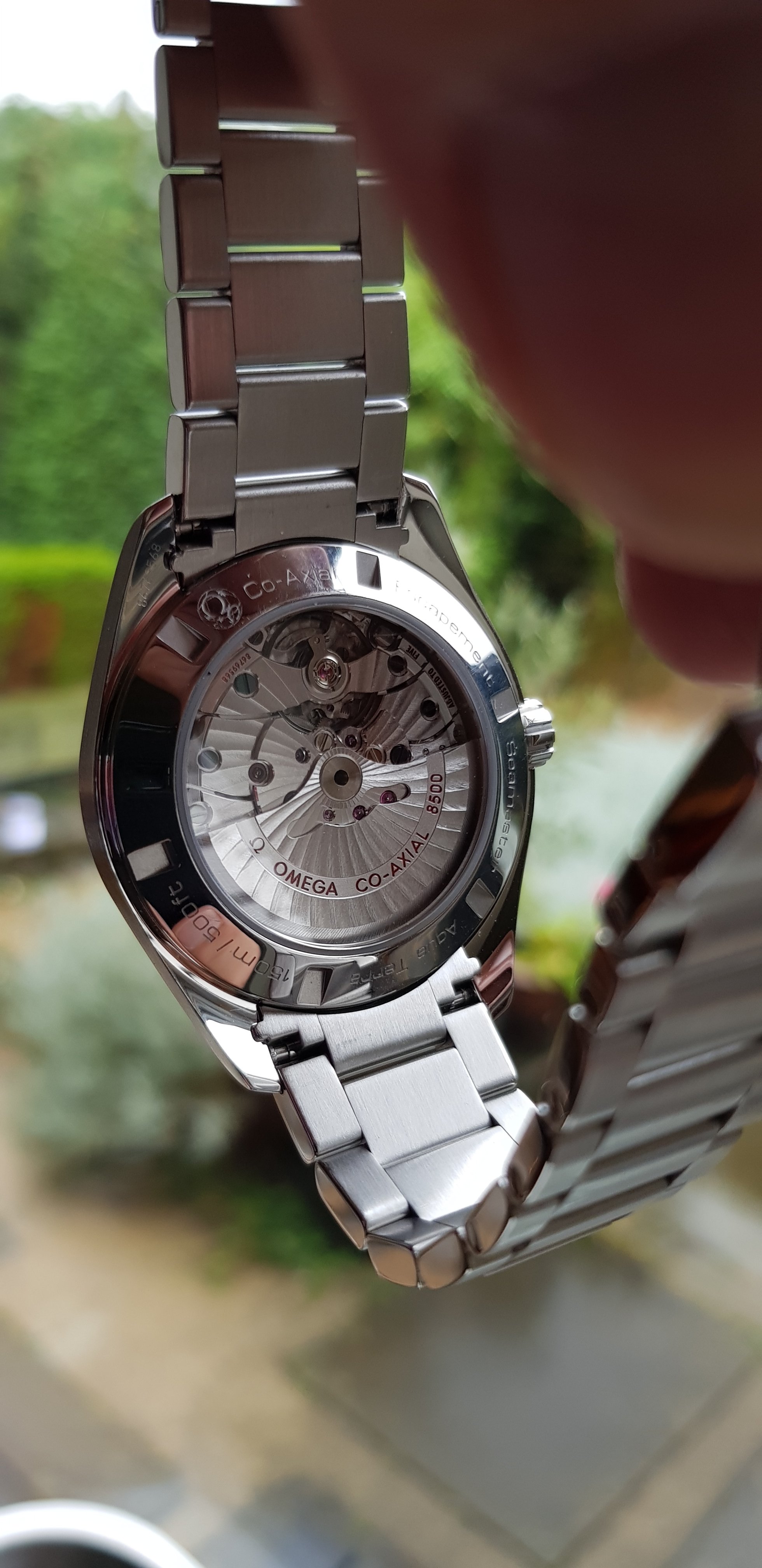

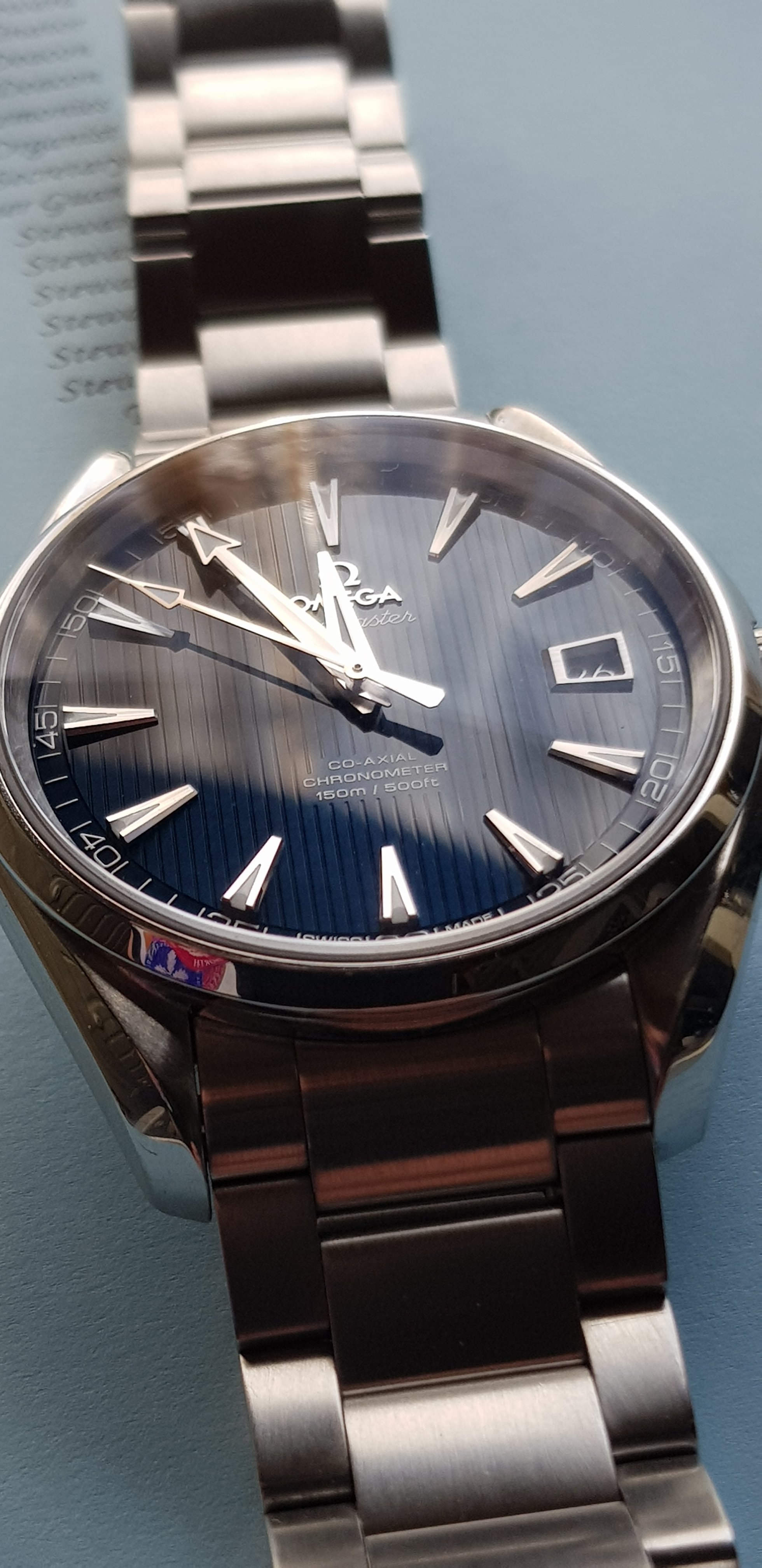

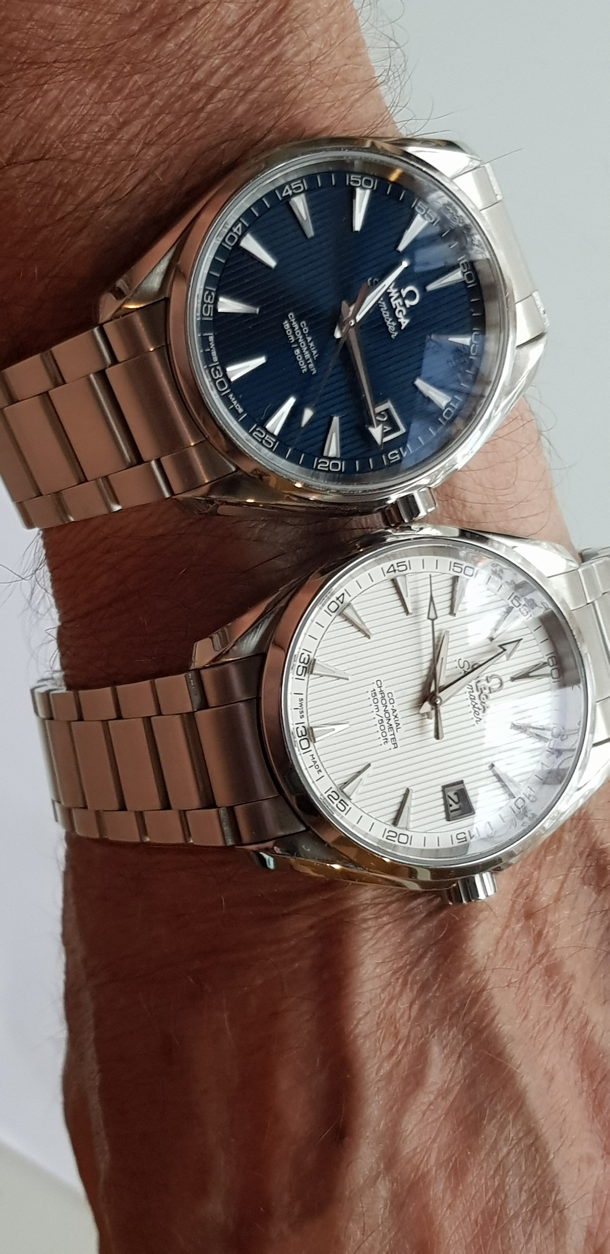

okay, okay, hold on, the photos will come from my android.
FWIW I even tried the wise old trick of trying to turn the screw clockwise (as if to tighten) and that wouldn't crack the locking compound.
Now, photos.....
