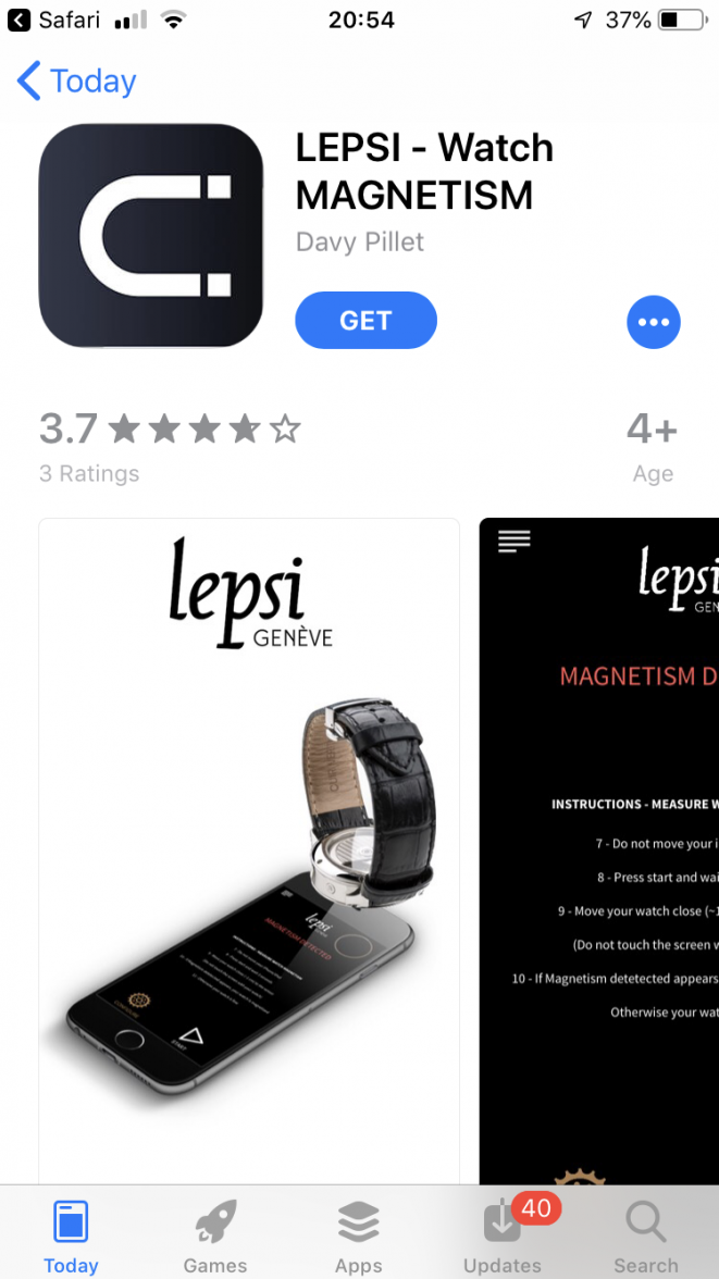

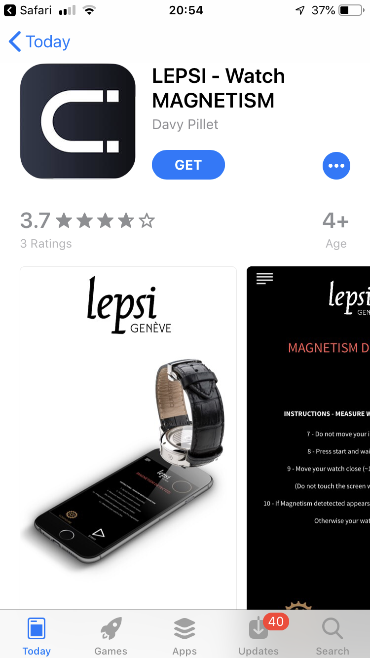

Did you get it checked to see if it is magnetized first? Is this change in accuracy sudden or not?
712
1,056
From a very small experience that I have maybe it just needs to demagnetize it and should be fine but wait for an answer from an experienced
member.
