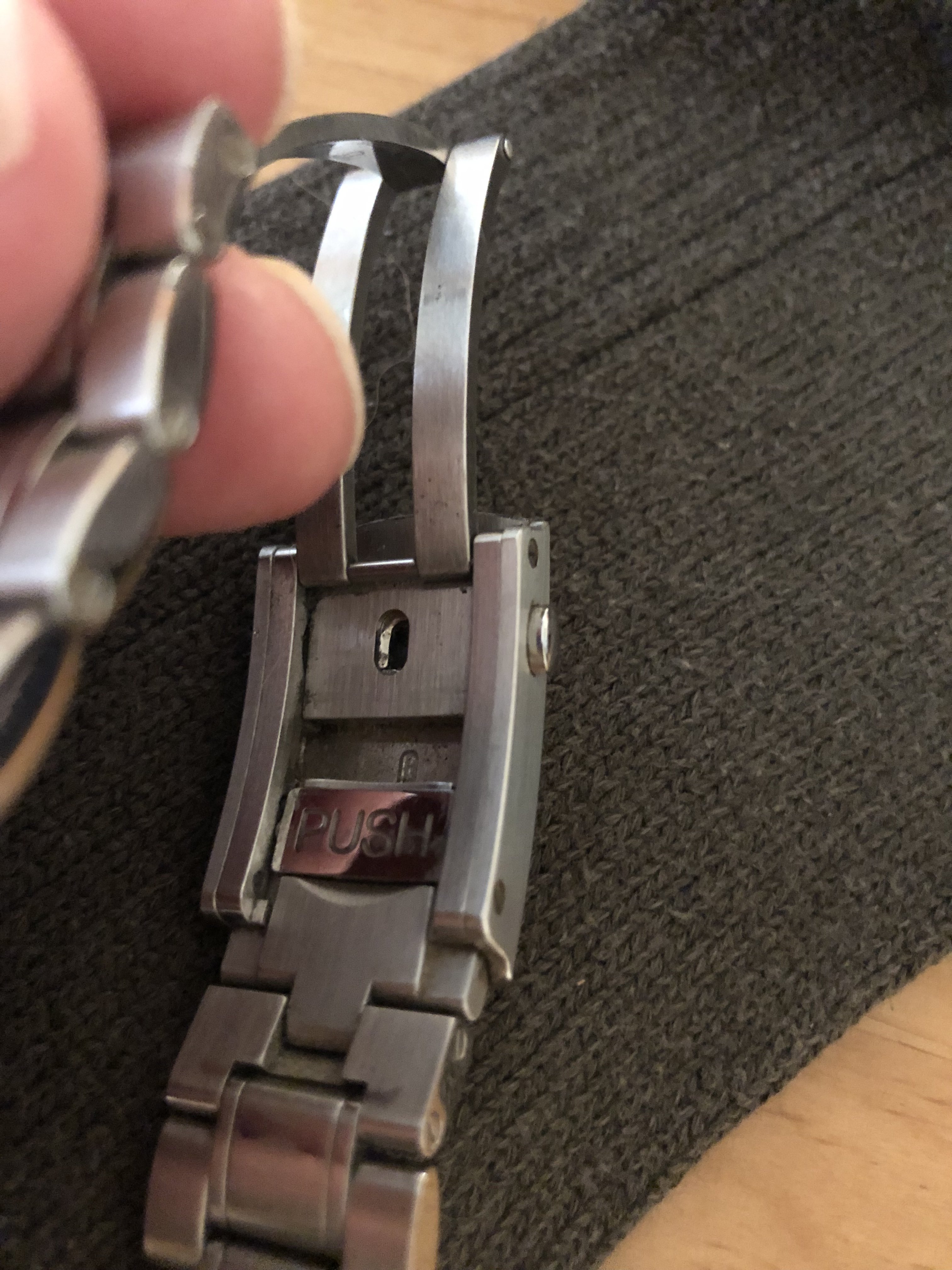

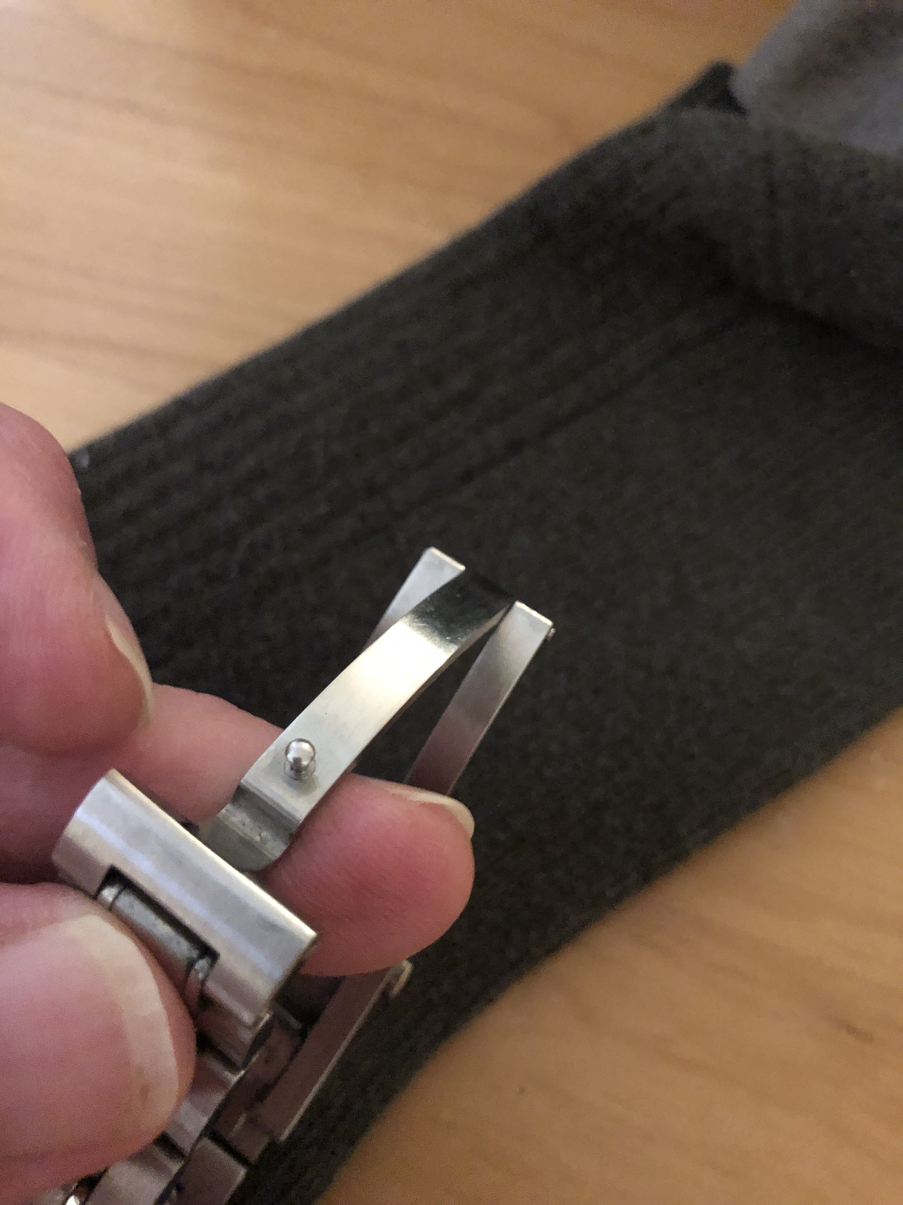

I bought this March 2018 at an Omega boutique in Jacksonville Fl which is now closed. I love the watch and it was a closet queen for the first 3 years. I only wore it on special occasions. 2 years ago I started wearing it daily. I have NOT been hard on this watch as it only has one small desk diver scratch. Last week my clasp broke. It won’t lock closed. Hard to believe after 2 years of easy wear.
Any alternative to buying a new clasp? Dealer only source?

pics?
Can you just squeeze the sides to 'tighten' the fit of the covering piece over the base piece?
120
80
Tried that. I squeezed the sides and then put clasp in place and released side tabs. Does not lock. I will try pictures but if I need a host I don’t have one any longer
285
221
I also think something happen to the spring because the clasp looks fine for me. Did you try to fix it to a local watchmaker? Doesn't seem to complicate..

Thanks guys. I just called him and he thinks he can fix it. I will take it to him this weekend

It does need a cleaning but that’s not the issue. The spring in the lock system is inop. I can. Slide the release tabs on the clasp from side to side. Will clean anyway as it needs it thanks

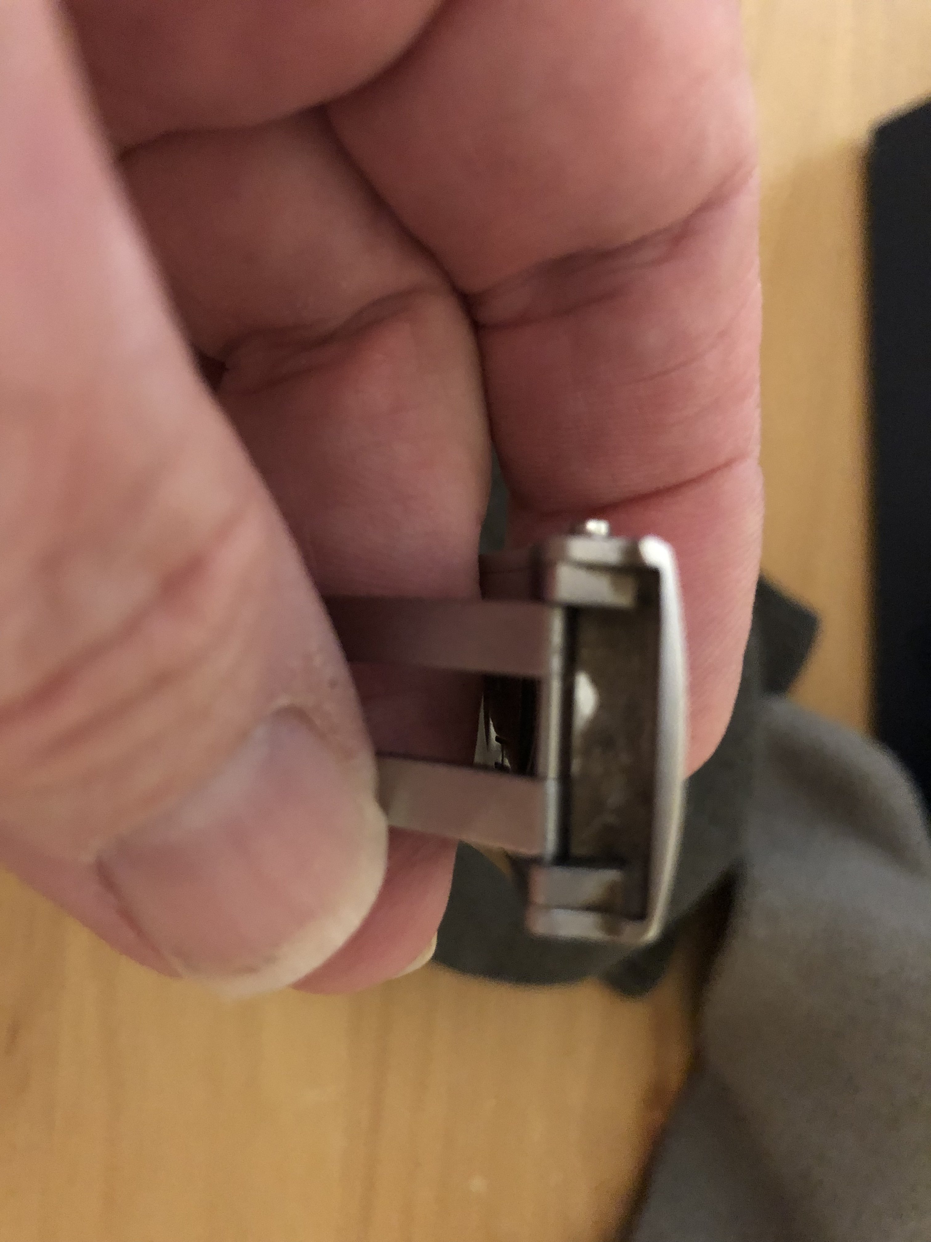

77
28
Spring looks heavily worn to me.
I’m more ocd than most, but with all of my bracelets, I always release the pressure on the clap as I put it on over the tang, to avoid this wear caused when simply pushing it closed. Perhaps this is standard practice though

When you say the spring looks heavily worn tell me what you’re seeing. Is the whole too big? I have not been releasing the pressure on the clasp. I have been snapping it shut. I guess that’s wrong
It looks like there’s an angled groove in that would match the locking tang.
I don’t know whether this would be considered wrong or not. I’m more ocd than most and try to minimize how much I take off a watch to avoid wear on locking mechanisms. I don’t know how much it helps to push the springs in while locking, but someone could probably show me irrefutable evidence that it has zero effect and I would still do it. It doesn’t exactly take extra time

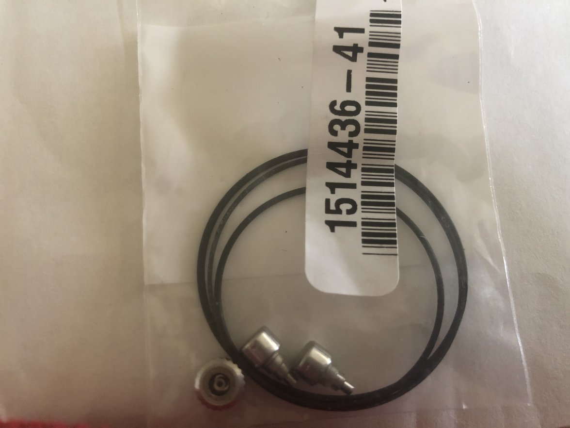

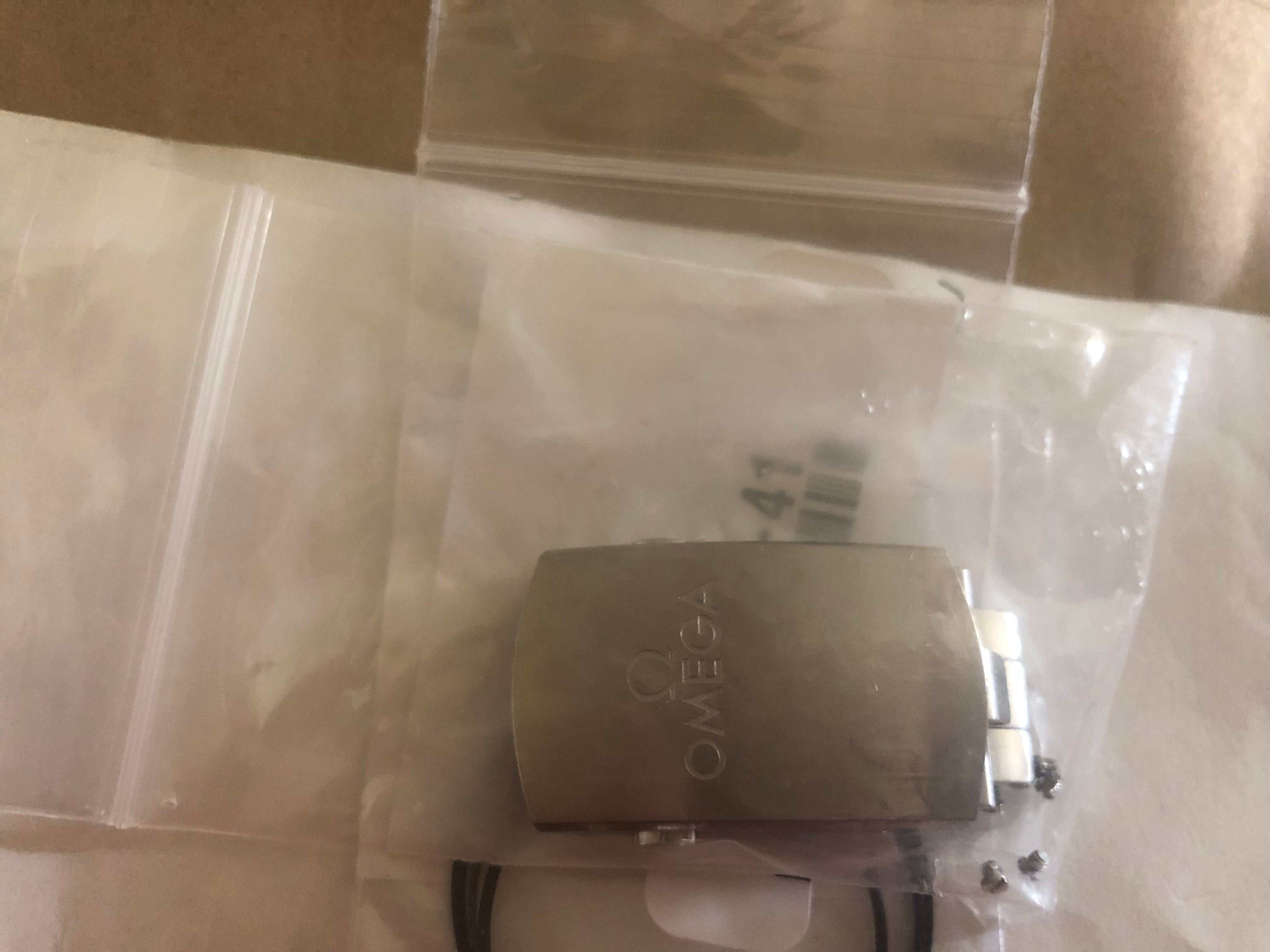

****UPDATE***********
I received my watch back and they replaced the buckle but also the crown, two buttons for the stopwatch function, resealed the watch via water resistant service. Tested to factory specs. It was returned to me with a beautiful red case. No charge for any of it. Thank you OMEGA.
