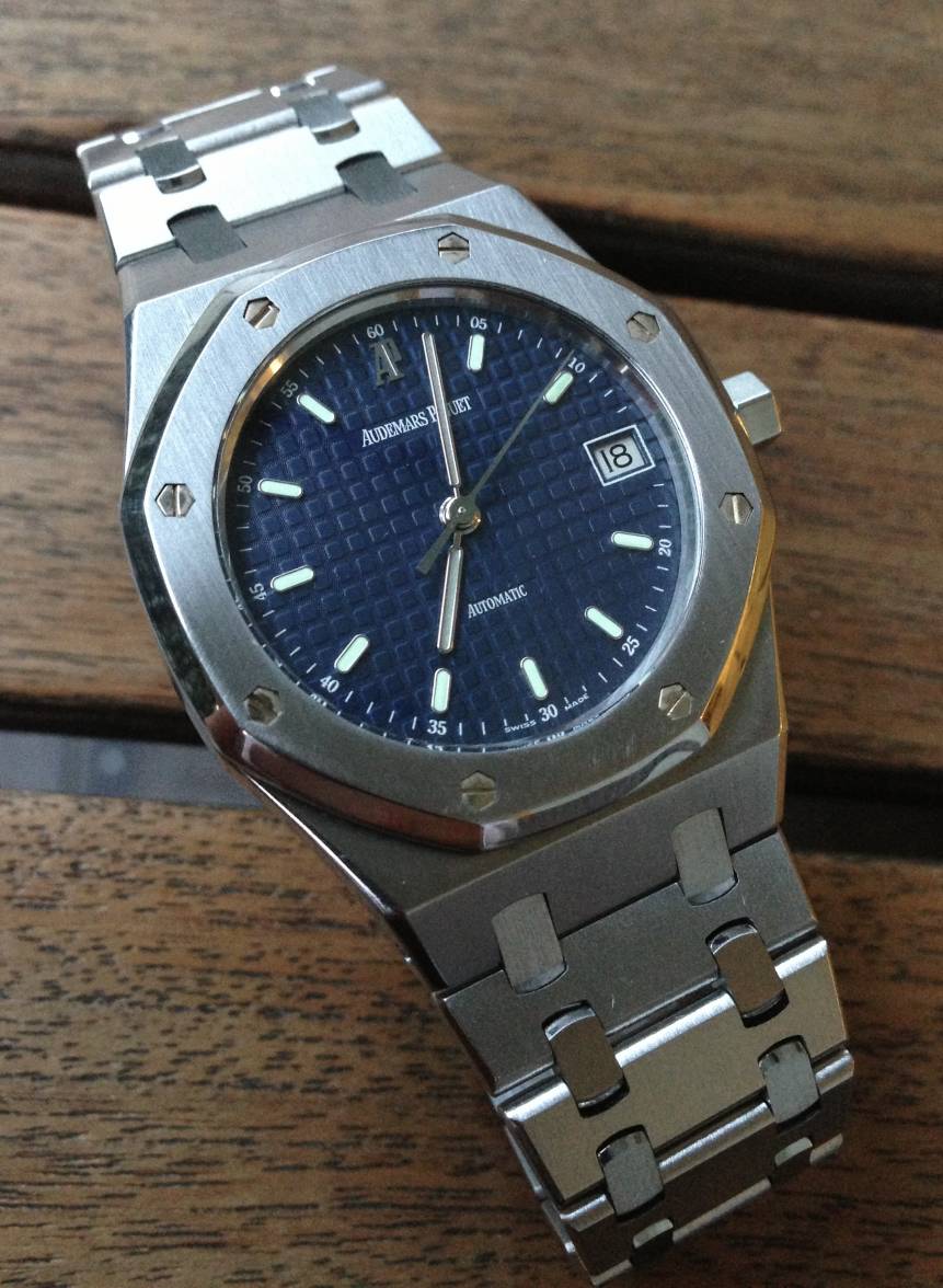

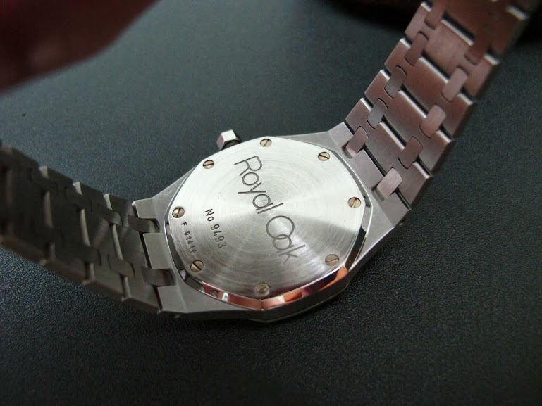

I never thought of myself as a Royal Oak sort of chap as I thought they were all waaay too big for my scrawny 6.3" wrist. However, one recently came up for sale in a local forum. It's an older 36mm 14790ST. Out of curiosity I decided to meet the seller and try it on. And surprisingly, the 36mm size worked quite well! It looks legit, dates from 2005, but it doesn't come with B&P, and the seller is the 2nd owner. Any red flags for the watch or any irregularities that I should be aware of? Thanks guys!

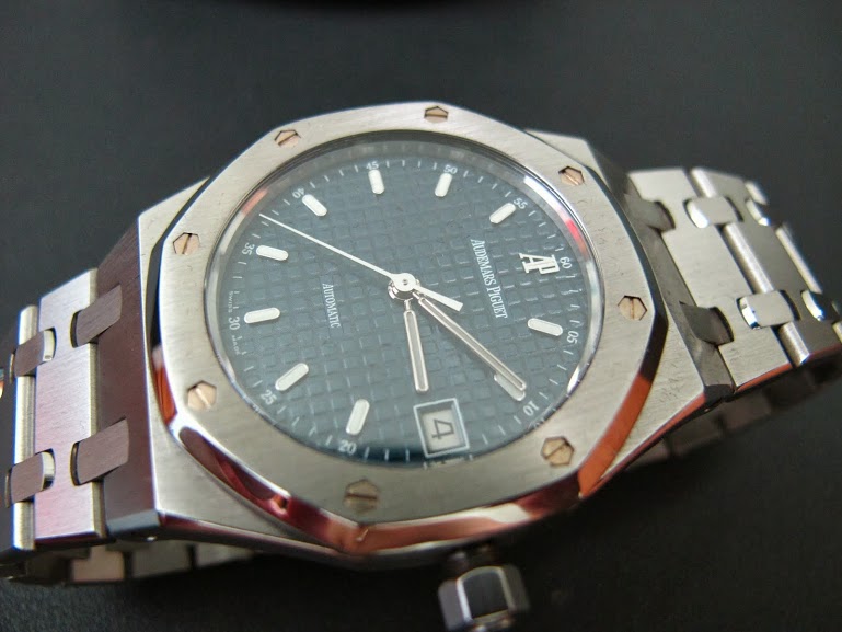

Looks legit to me. Looks as though it has had a polish, the edges aren't OEM crisp, but not too bad. The dial with outlined date is correct I believe. The F serial was produced from around 2001-2005. AP makes a lot fewer watches than other manufactures. A service on these can be expensive, so make sure you allow for that in the pricing. AP posts pricing on their website for various services. I haven't checked "market price" for these, not a lot of these come up for sale. There is a current version in 37mm, the 14550ST. Good luck with it!.
Is that the dark blue dial or is it the AR coating giving that tint to a black dial? The older 36 mm models are decent. One of the West Coast Florida guys has the annual calendar and that size works well on sub-7" wrist.

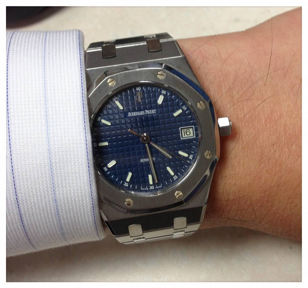

Yup, it's the dark blue dial. It comes off slightly bluish-grey in real life though, which I was attracted to. It's fairly subdued which I like. Thanks for the info about servicing Darlinboy - I'm going to call AP tomorrow to check their prices. I thought the JLC servicing prices were high in Singapore (more expensive than Rolex) but apparently AP is worse.

So here's the happy end to the RO adventure. It turned out that there is a place locally that can service RO's (and has parts) at a reasonable price so I took the plunge and bought the watch. I'm really liking it. The dial colors change with the lighting, much like my teak-grey AT8500, and the bracelet is just awesome to look at. Size-wise, the 36mm is perfect for my wrist. Any larger and the overhang would just make me look odd. Plus I still can't get over the fact that it's actually <10mm thin, which surprised me when I first wore it. Yippee! Thanks folks for advice and enabling
