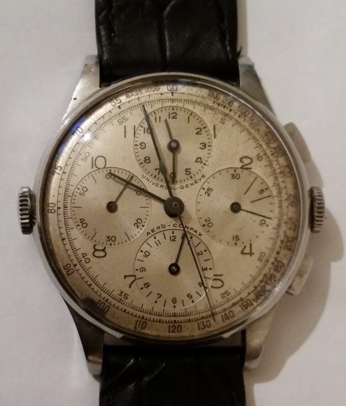

Anything wrong with this aero compax?
  1. ELV web Mar 6, 2015
    2,668
    24,651
    image.jpg image.jpg image.jpg image.jpg I think it is original but would like to get second opinions from the experts here.
  2. MMMD unaffiliated curmudgeonly absurdist & polyologist Mar 6, 2015
    4,642
    31,005
    I like it. A little grotty around the edges of the dial, but a nice and original watch.
  3. jordn Wants to be called Frank for some odd reason Mar 6, 2015
    713
    2,011
    By in large it looks original, but there is something suspicious about the 2 and 7 numerals. I've never seen the 7 bleed into the subdial on a universal watch, but there isn't a comparable dial in Sala so I'm just guessing. Could be an older refinishing job. the dial is in a crummy condition, so not worth consideration imo

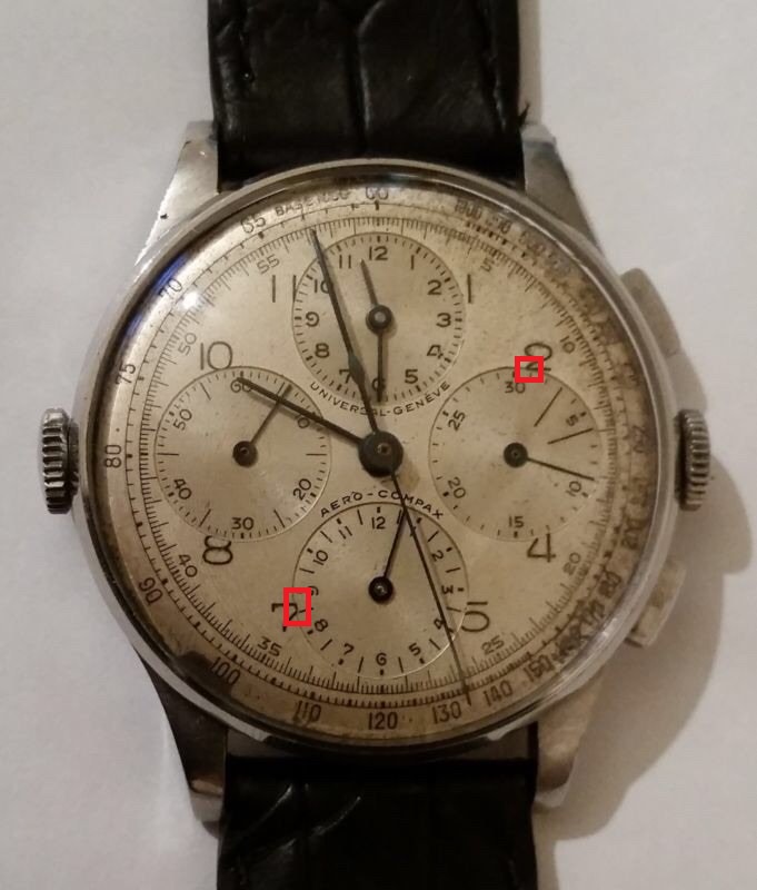

  6. jordn Wants to be called Frank for some odd reason Mar 6, 2015
    713
    2,011
    Sorry, I guess I wasn't being clear, but my point was that the numbers are supposed to be interrupted. On the OP watch, the 2 and 7 look filled out. Not saying this is a redial, but it's possible it has been retouched by a second party. It's also possible that it might be a mistake in part of the dial manufacturer

  8. MMMD unaffiliated curmudgeonly absurdist & polyologist Mar 6, 2015
    4,642
    31,005
    Ah, I see what you mean. For me it's within the range of normal.
  9. woodwkr2 Mar 6, 2015
    1,366
    819
    100% original, un-retouched.

  10. ELV web Mar 6, 2015
    2,668
    24,651
    Thanks guys, the bleeding at 7 also caught my eye but I think it is just the age :p. And it seems at right price (just about half the chrono24 after some negotiation). It is the watch featured in hodinkee by Eric last week or so.

  19. x3no Mar 14, 2015
    853
    2,434
    Wow that one is gorgeous! Something about this one though gives me a "redial" feel. Just looks very nice--too nice--for its age. I'm no expert but at that price it would be something I ask from the dealer about!
