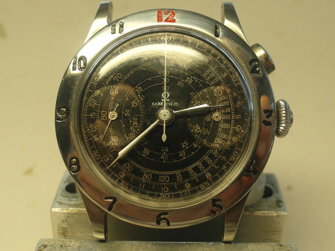

  10. watchyouwant ΩF Clairvoyant May 11, 2016
    5,146
    8,657
    it is printed black over silver with white omega writing; as it should be.....
