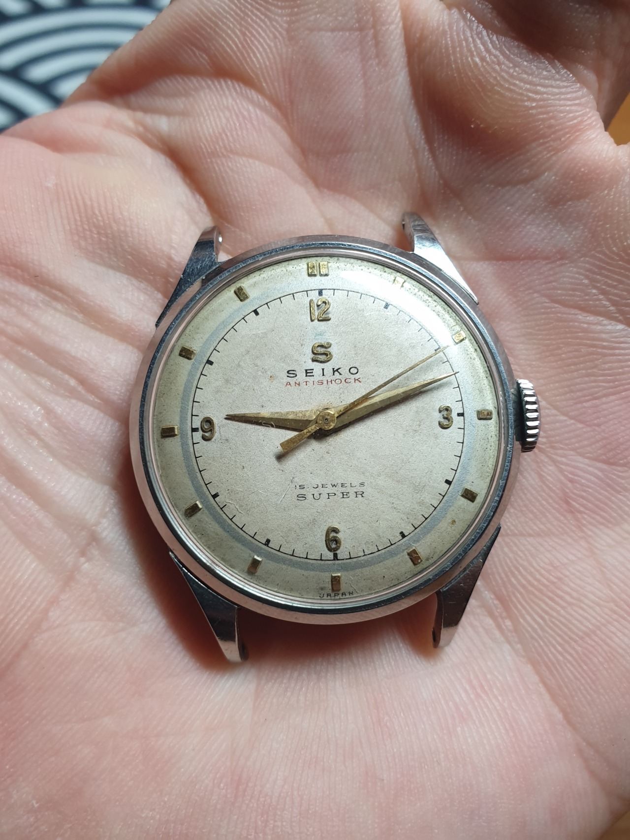

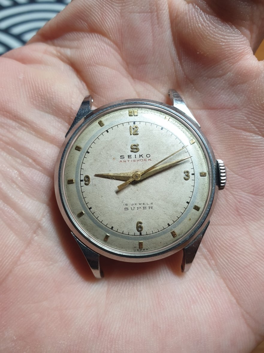

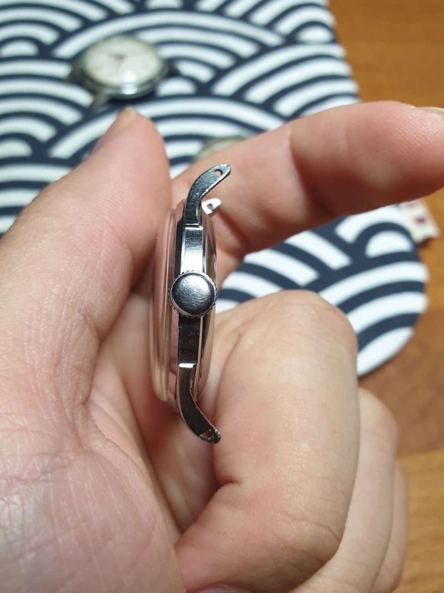

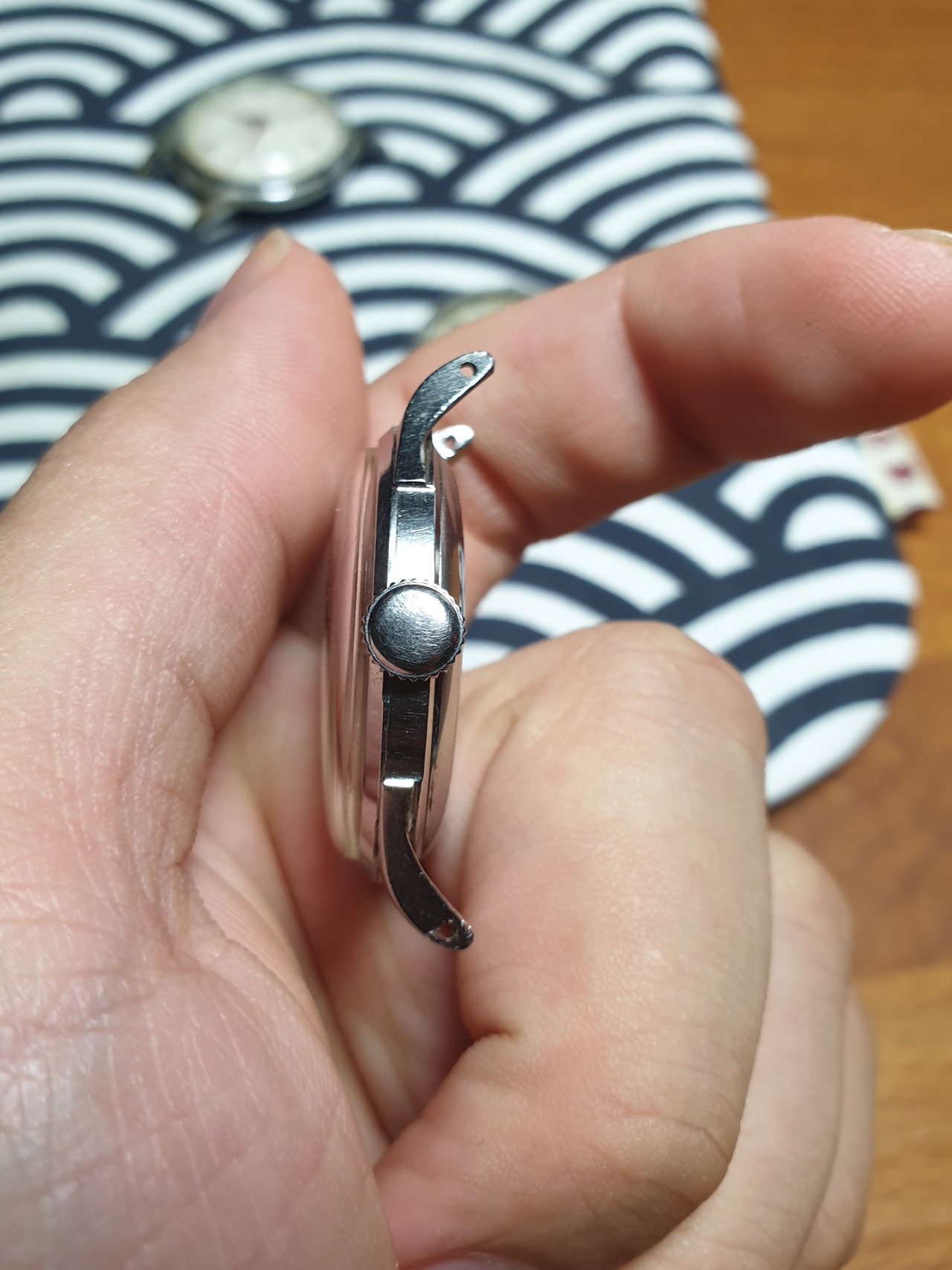

I was browsing for something else, and came across this vintage S Seiko from what the seller believes is the early 50s. Only 31 mm, but I was considering that a military type bund style strap in leather might really up the presence of the watch in a sort of old fashioned way. Pics below, no movement pics available though.
Anyone have any thoughts on it? Advice? I have some vintage Seikos, but nothing this early.

I'm no expert, but I'm wondering if it is a redial. The hour markers on the track don't seem to match the batons (especially around the 4 o'clock mark), and it just looks weird to have the hour and minute hand poke just beyond the track like that.
333
736
The hands are definitely wrong. They appear to be out of a later watch, Seiko Crown(not the chrono) comes to mind as to the source. I noticed the possible redial too, but I don't even know what model this is to help more.
Op also needs to provide better pictures. I'm no expert either but a movement pic would definitely help.
Edit: Forgot to say the lugs are rather thin and that I would just stay away from this. What's up with the blue(or grey?) ring on the dial?

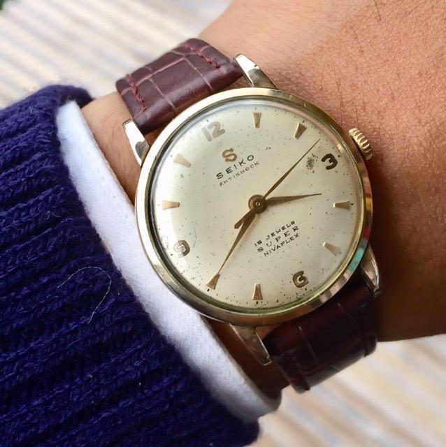

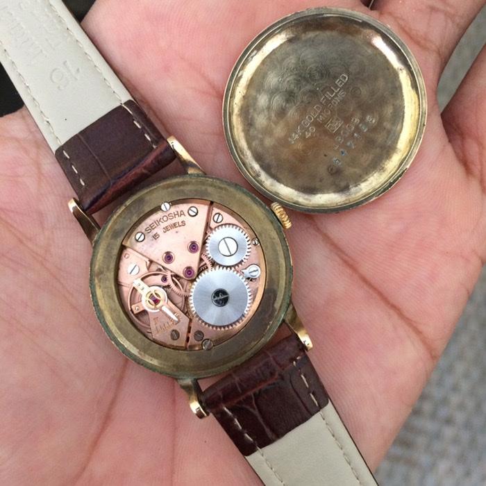

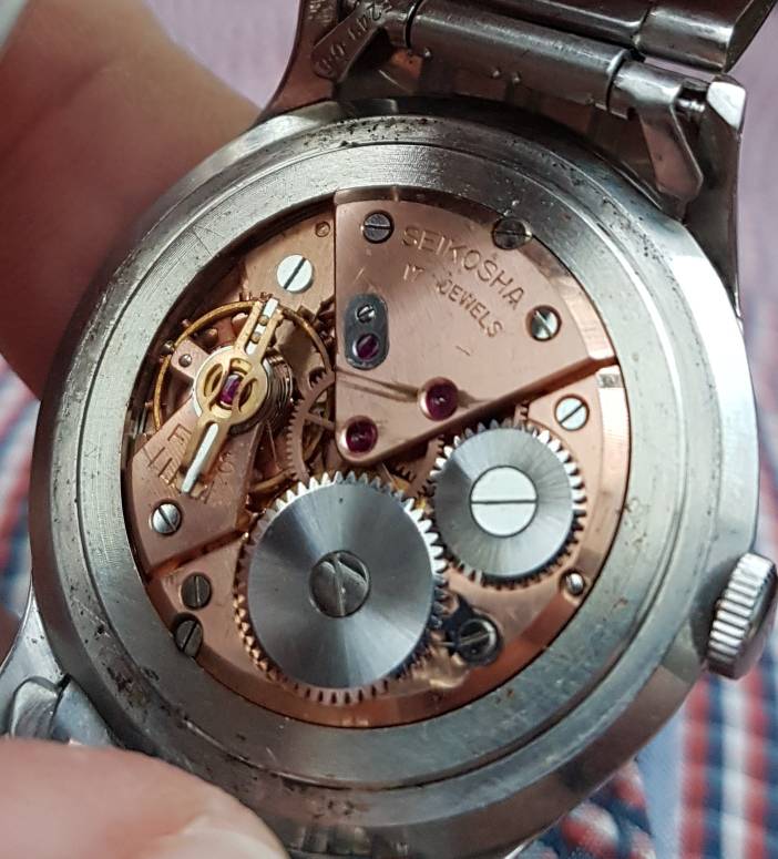

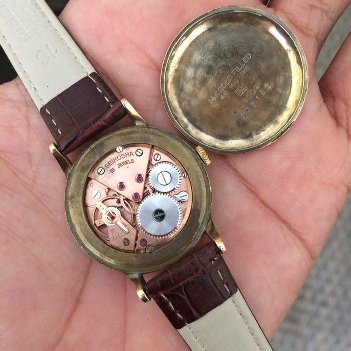

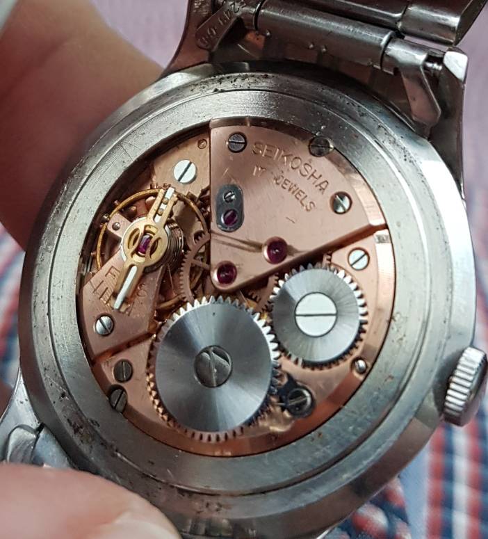

Here are a couple of mid 50s "Super" Seiko photos with their movement shots, from another japanese only forum I'm in, in case you find it helpfull.

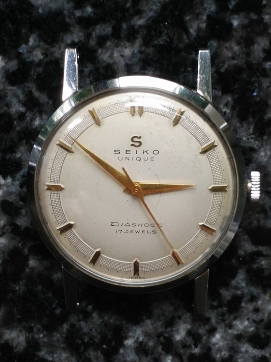

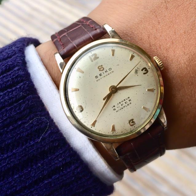

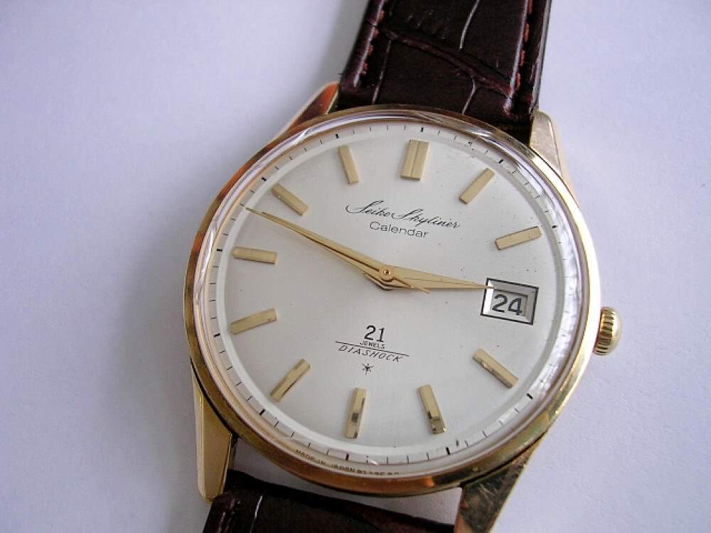

Really interesting Seiko from the early 50s; original dial IMO but not the hands.
337
453

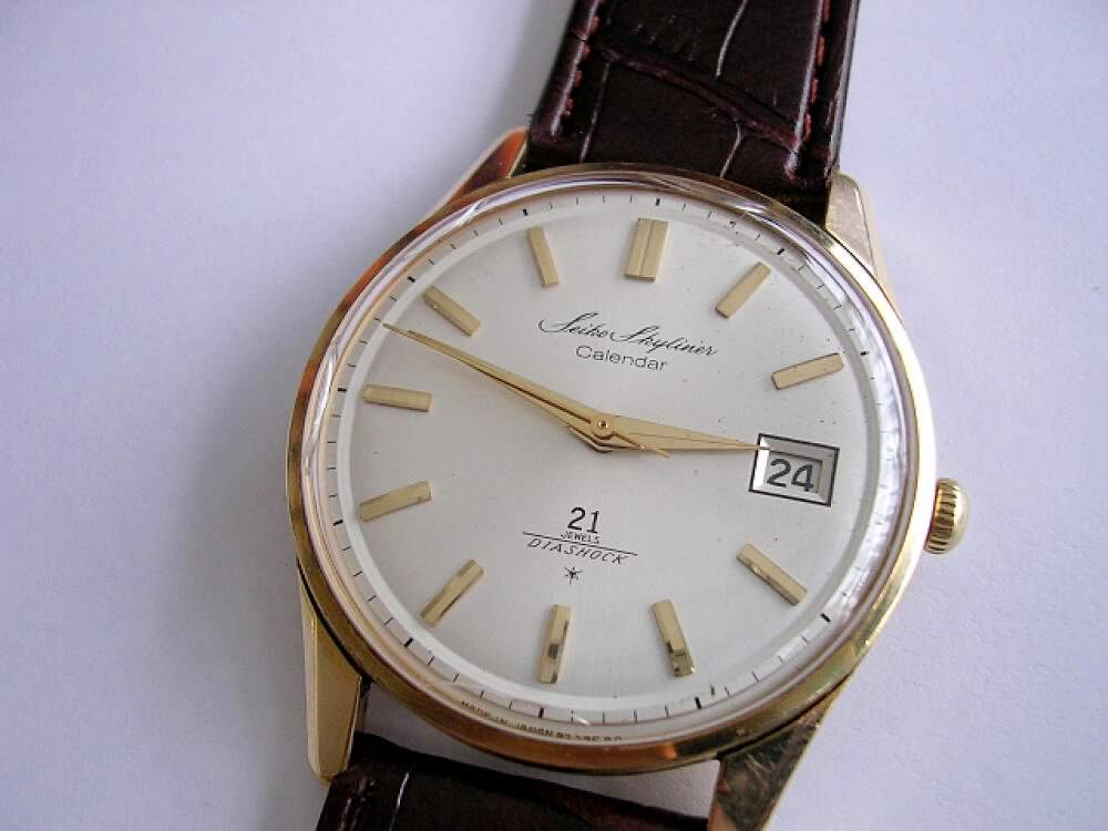

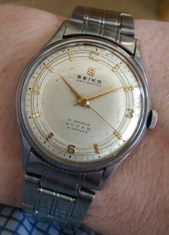

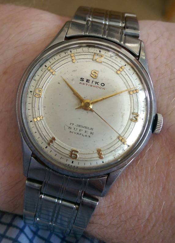

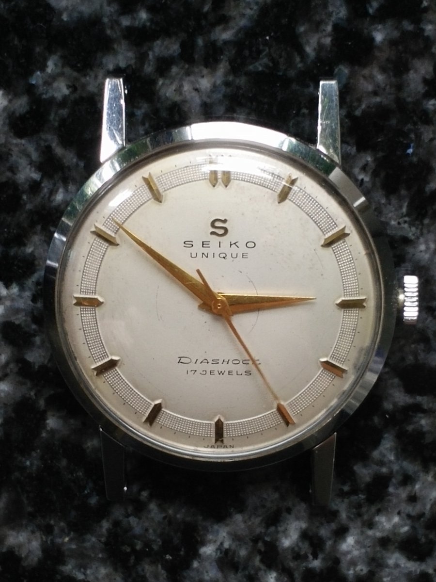

The hands look like these from the Unique and Skyliner again from the 50s but with 17 and 21 jewel Diashock movement, so maybe they were used in Supers and 15 jewel Nivaplex movement too? Can't say for sure, you definitely have to see movement pics too.
