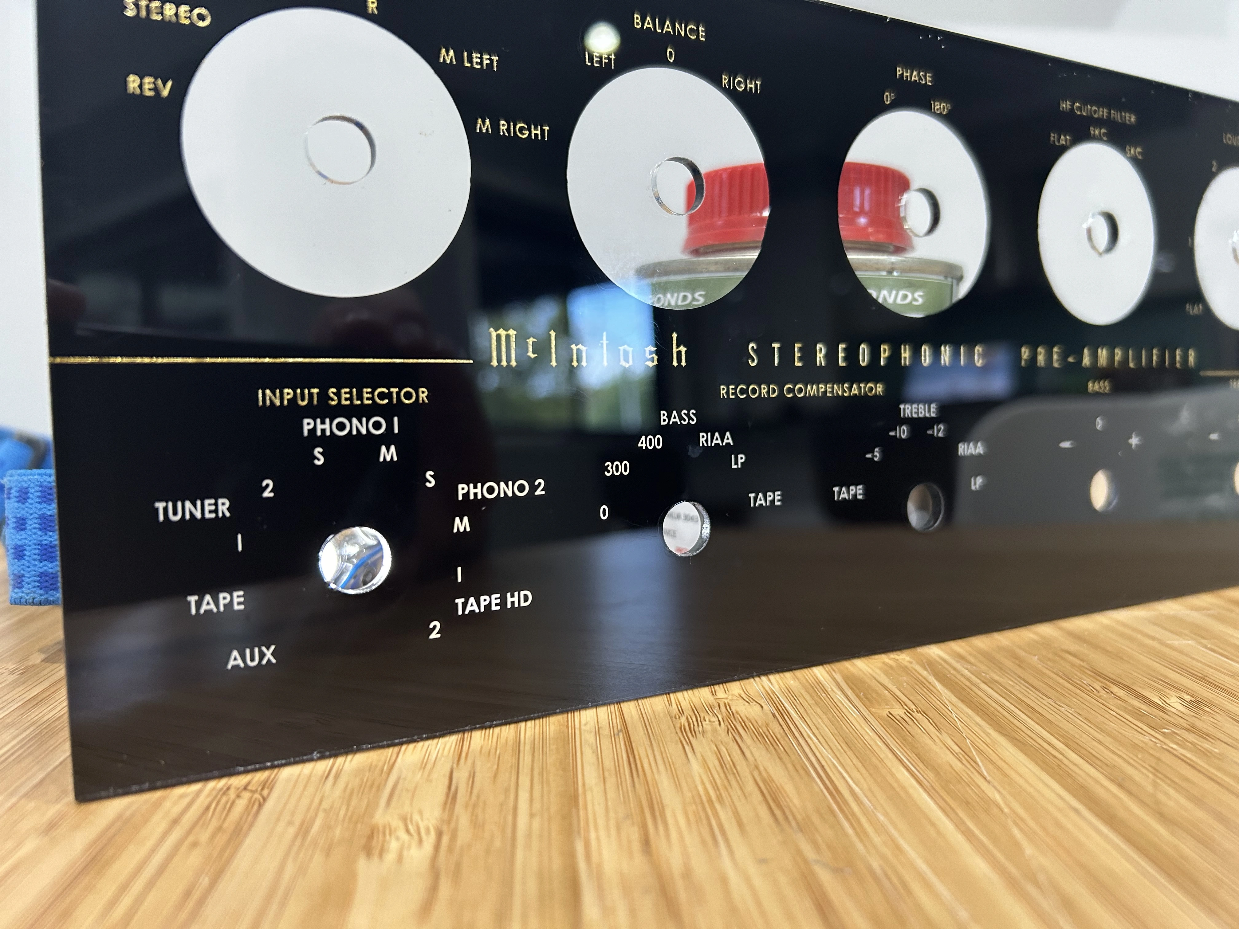

I’ve bee through this with a 1962 McIntosh Tube Preamp I restored as the front panels for those are also NLA and I managed to recreate them and even 24k gold leaf the lettering.
So this is a much easier task once I’ve done the artwork and tooling to make sure the print can be done perfectly. The issue is finding suitable discs to do the work on. I’m a bit loathed to potentially ruin a $200 date disc to test and the only ones I can find on eBay that are decently poor condition are the curved 1500 varieties.

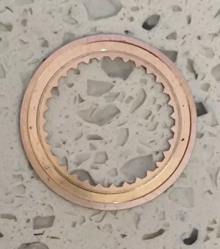

I have a bunch of regular date disks. Some damaged. Most are curved to fit the dial. I discovered in working with the 56x movements and laser cutting some dial blanks that the curved disks do not work well. So I have been speculating on if it might be possible to laser etch a blank. I was going to try this for a 752, but a nearly complete movement showed up recently for the price of a date ring.
I also learned that in cases like 166.067 which I got a week or so back that a flat dial will not fit into the case, since the stem does not align as the movement needs a curved dial for clearances. There is no chance that the 752 will fit with the flat day ring. The cheapest I have seen a 752 date ring is around 50USD. I think oFrie had some foreign language disks when I looked once.

This is my latest aquisition. I am still awaiting for it to arrive.
