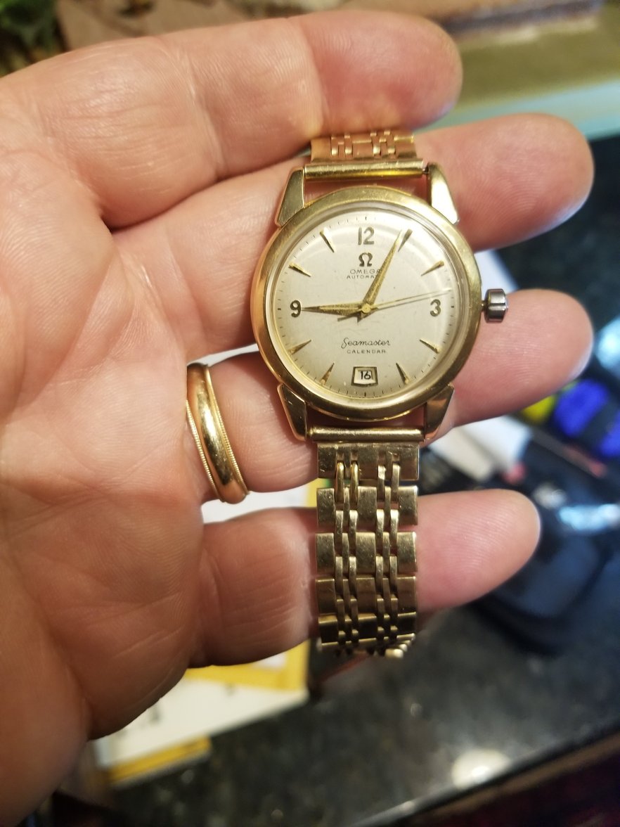

I thought I'd go ahead and try switching movements between my 2627 and my 2757 today. I watched all the videos I could find and the 2627 went great. I undid the case clamp and out it came. The 2757 on the other hand was still tight as a drum after stem and clamp removed. Can anyone please tell me what I missed?

I've gone into it in another post but the cliff notes is: I bought a 14k (case/bracelet) 2657 with a TERRIBLE redial and missing stem/crown. To replace the dial I sourced a nice original dial in a well loved 2757. I'm not a purist and want a nice looking watch to wear with a suit a few times a year. The movement switch was a quick "test fit" to see what they would look like t in the opposing cases. The plan is to keep all parts together so if passed on new owner can reverse the process. The 2627 removal was 1 case clamp and would have been a stem removal both of which are very easy. I was under the impression the 2757 was the same process.

You can remove the crystal and hands. Use soft stuff to protect the dial then gently push it down (at the rim) and see what happens.

Dial probably a bees wing thickness too wide and a shade stuck. Pin opposite side of the case clamp.
Usually I use a screwdriver and gently try to lift movement out from the clamp side

Thanks Don!!! less than a minute!! Now to get the other one out.

Movement fits and looks great I think I'm just waiting on a new stem and crown to finalize the switch. One thing I can't figure out is why the stem and crown pictured won't seat properly even though they came out of this movement?

You have to fit the movement pin exactly at the inner middle case cut out slot....

I can't seem to get it any further while in the case. It seats fine when out of the case, when the new stem comes I'll try again and set the new crown accordingly.
