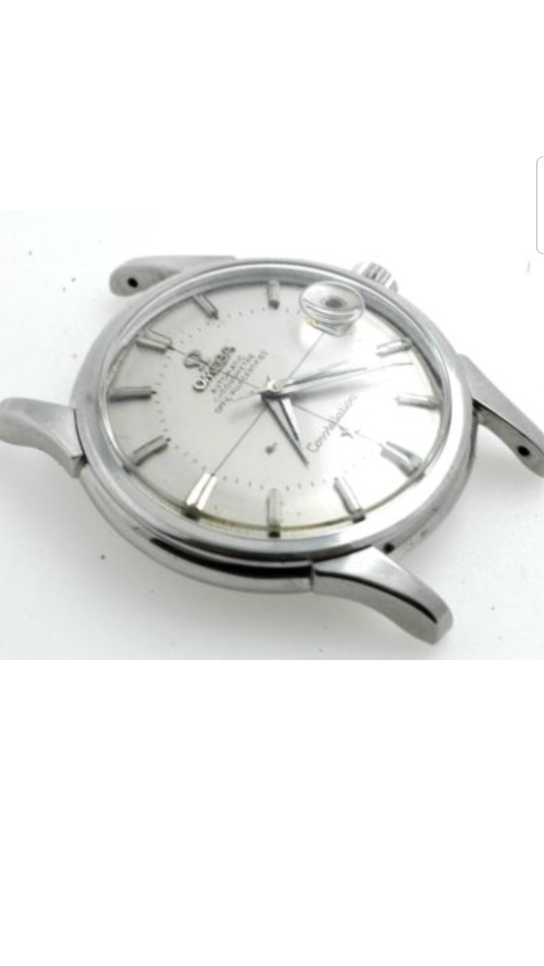

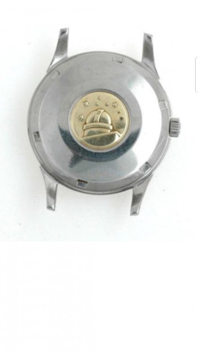

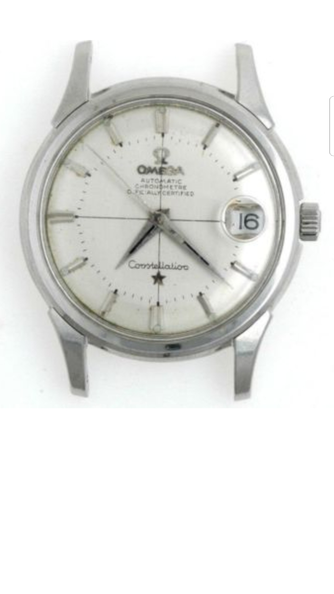

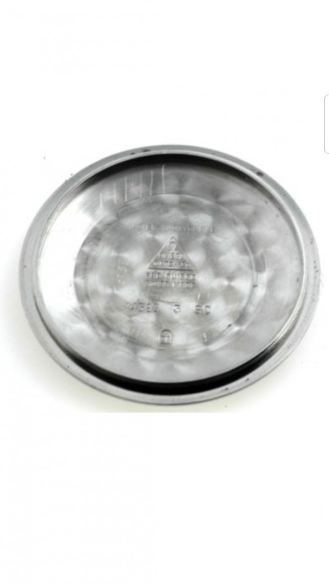

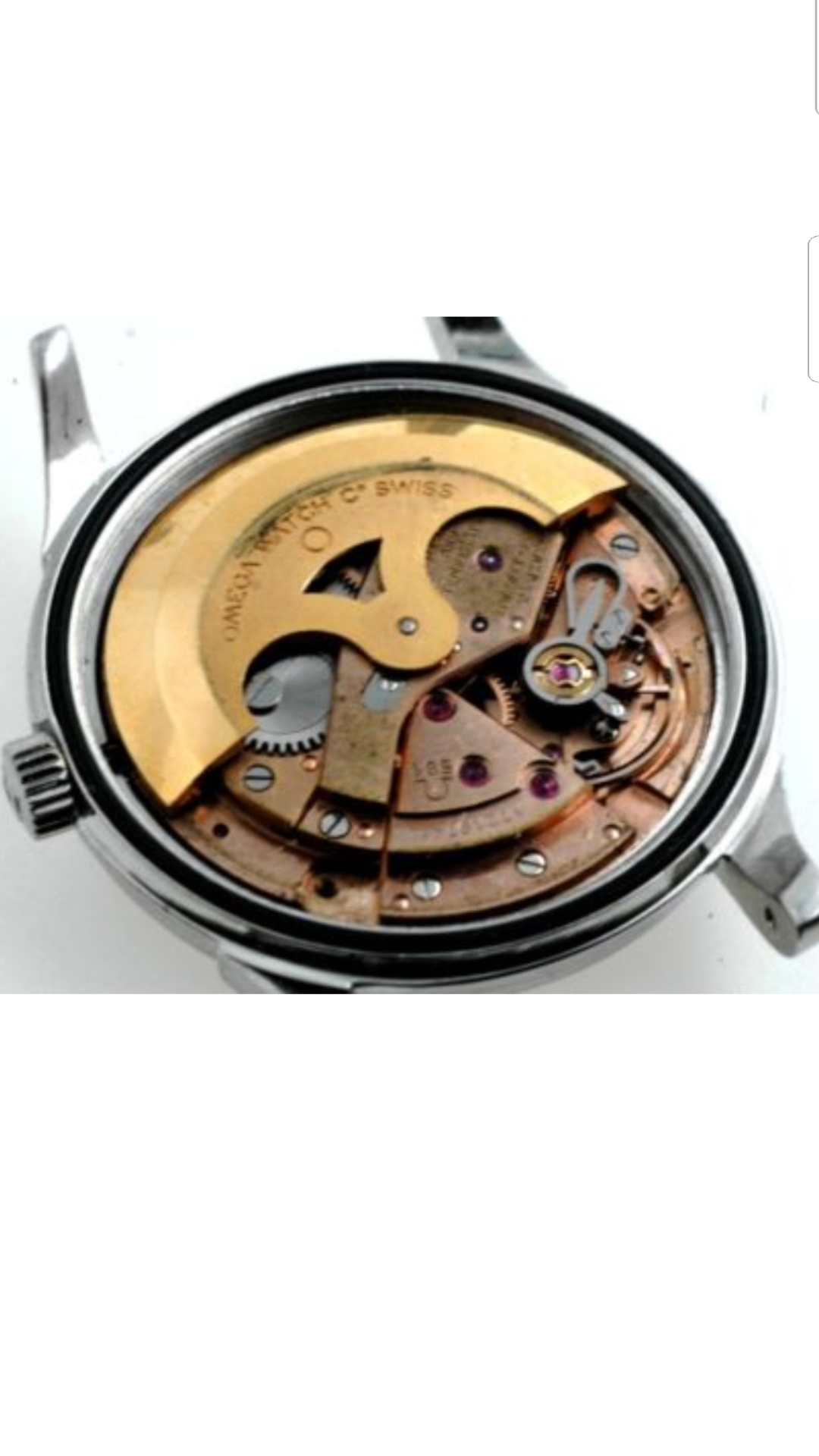

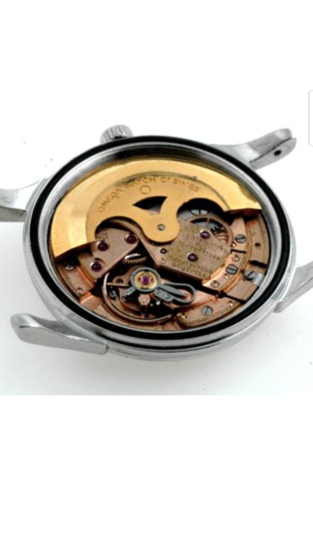

    Good day all OF members.
    As my hunt continue, came across this 14393 3sc with 561 cal.
    Besides the wrong crystal and crown, is there any problem with this watch that my untrained eyes ( and lack of knowledge) missed?

    Dial seems to be messed with.
    Hands wrong
    Crown wrong though not alway prohibitive, simply piles on.
    Movement - can’t see details but also looks put together - ex, can’t see serial #
    Just....My 2 cents
    You need better photos to get good look where it matters as far as movement goes
    Good luch

  3. X350 XJR Vintage Omega Aficionado Oct 5, 2018
    12,619
    29,918
    Sorry, your eyes need more training, its a pile of shit.
  4. Rochete Oct 5, 2018
    1,232
    5,571
    The whole of it is a huge red flag.

  5. Foo2rama Keeps his worms in a ball instead of a can. Oct 5, 2018
    17,103
    25,348
    “Oh my god” is what I exclaimed when I saw the pictures... and not in a good way. Look at the hour markers vs the outer track.
  6. Sherbie Oct 5, 2018
    1,323
    1,860
    And All 4 lugs are different shapes
    As others have said, Its a pile of pooh

    + rotor rub
