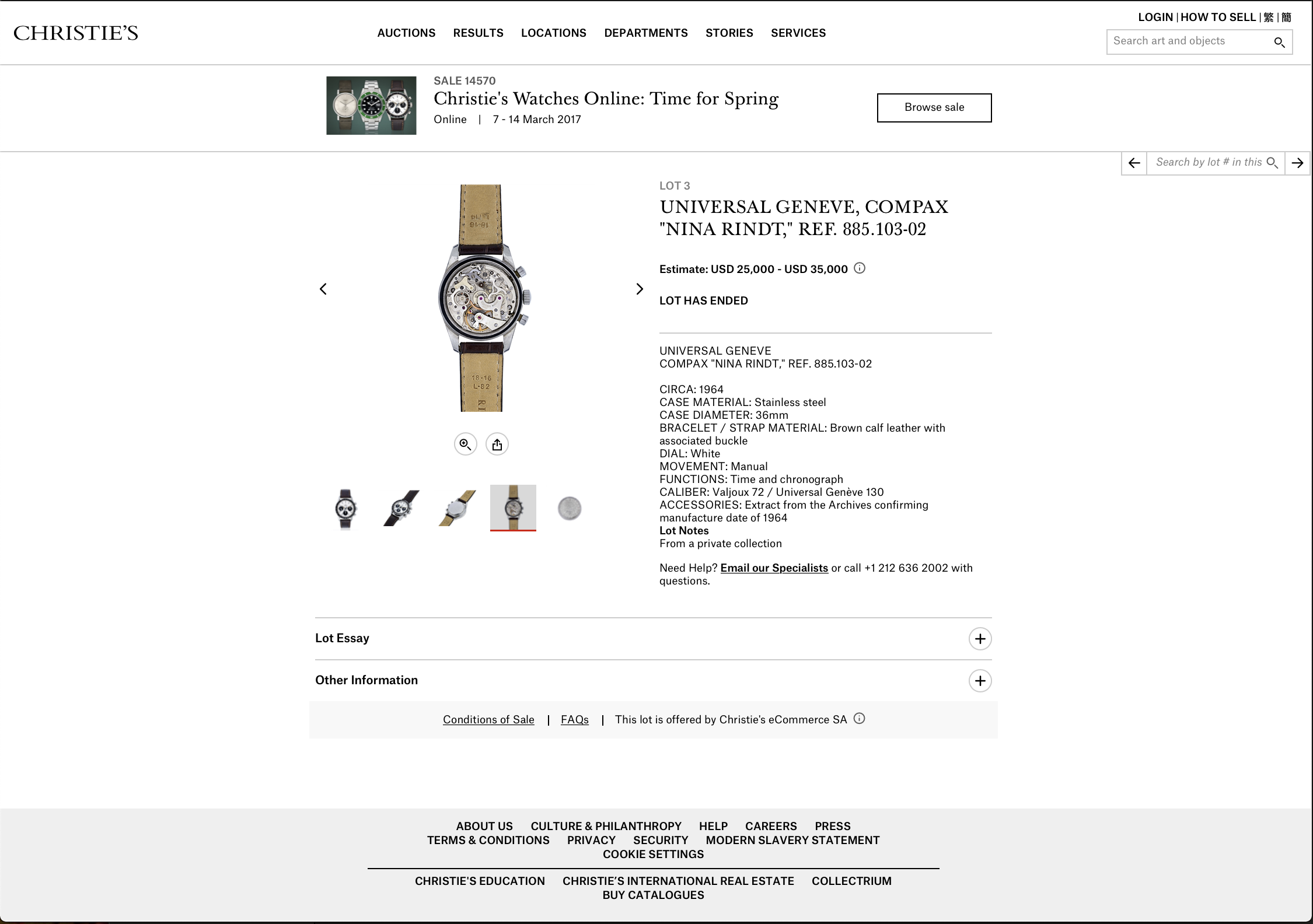

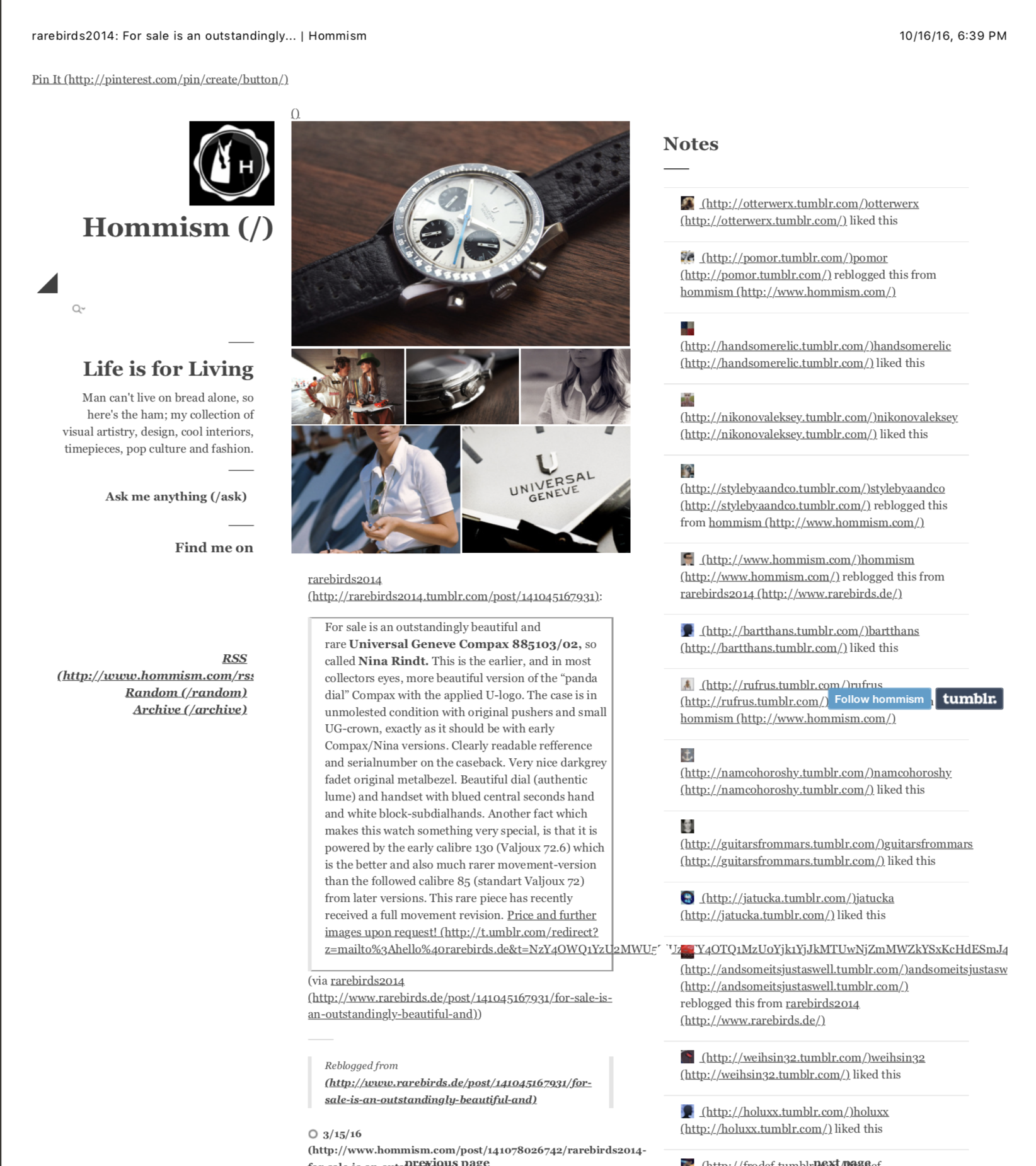

Mine is very early sn and has cal 130...I have seen at least a half dozen others with cal 130 including two sold by Rarebirds and one at Christies

@CajunTiger are these /02? Would you have a pic of yours and the rarebirds (the rarebirds I see are stamped 85).
Christies I had a blurry pic, but now have found a better one showing 130 (though I can't see a serial on it), thanks!! 👍

The Rarebirds were sold a few years ago
Search thru his archive.
I may have saved a copy of the listings, I’ll look

Interesting that both Christies and rarebirds pieces have the later (2.56 serials) thick register hands with lume. If the Cal 130 appeared on early Ninas, I would have thought it would only be seen on the 2.41 serials with thin hands. Curious.
