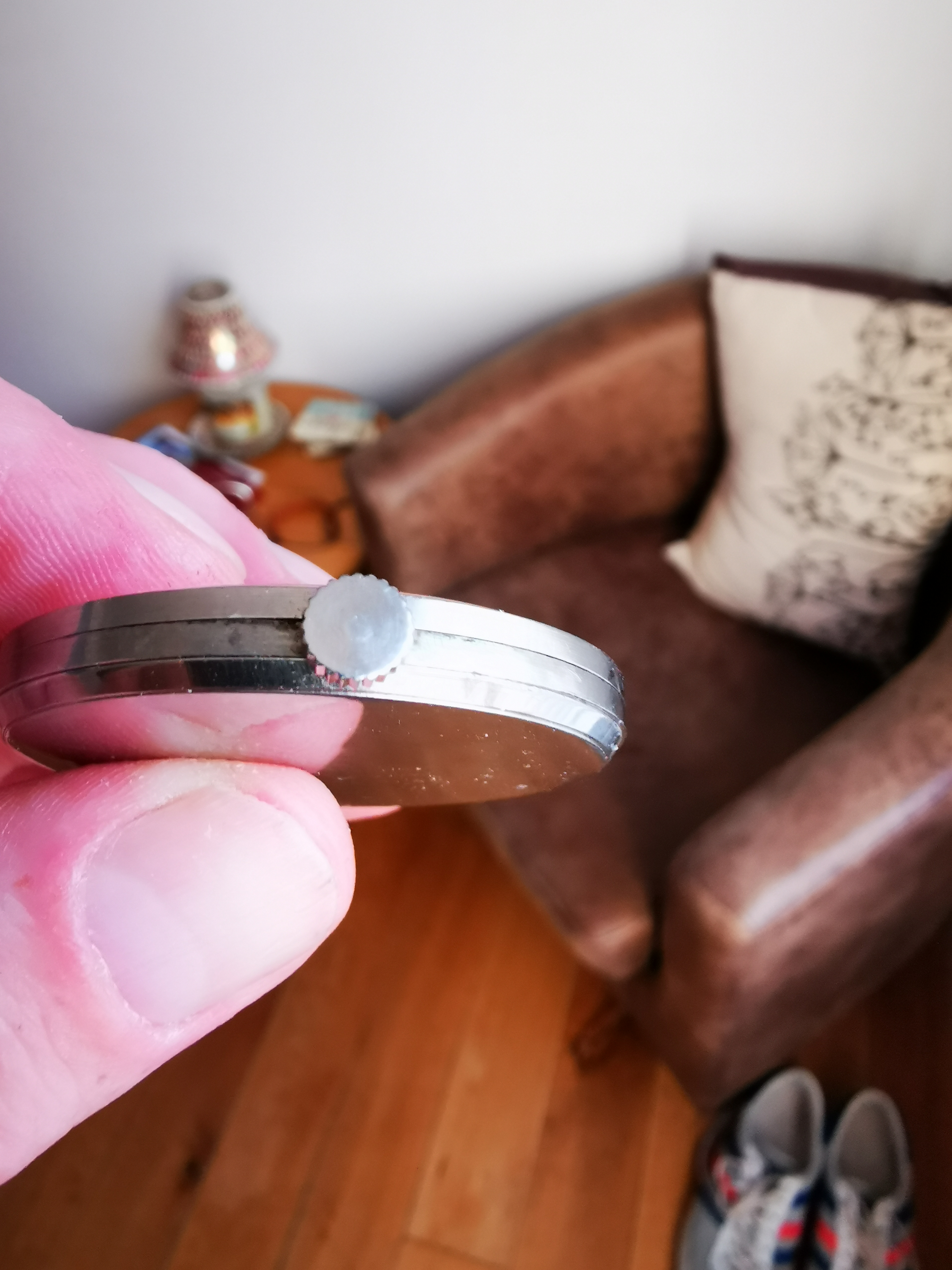

Could be an insert from a travel clock, but the crown was usually at the 6 for those, and mostly had an alarm.
I think it may be a CK1055 where the bow was part of the case and has been removed.
However, without more detailed pictures we can only guess.

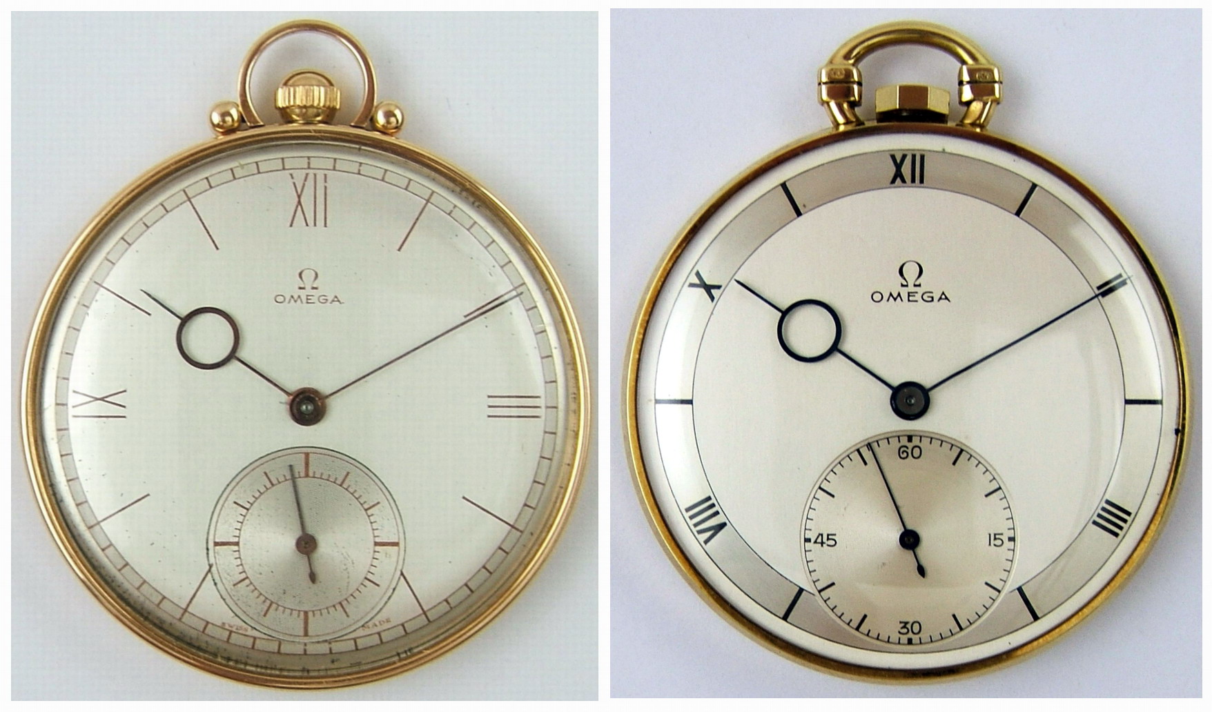

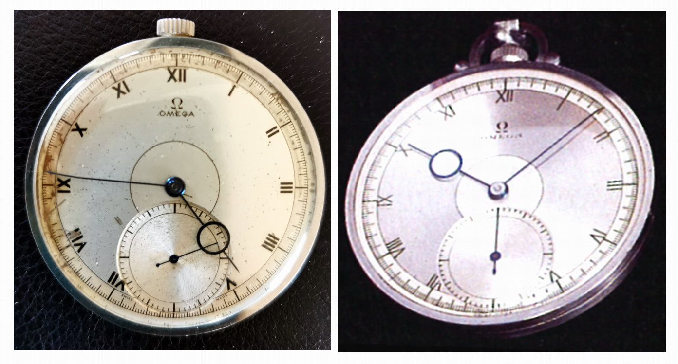

I think the spot by @JimInOz (showing ‘Catalog picture from collection of @Tire-comedon’) is on the nail (good spot Jim!). There is another image of a CK1055 on Page 98 of AJTT. I show an image which compares the OP’s watch with another CK1055.
At this time, Omega made pocket watches with calibres 37.5, 37.6 and 38.5, with many variations of dial, hands, stem/bow, case and case material. What is unusual here are the 1/5th marks on the minute scale - which would normally have been used on a watch with a centre second hand (such as a chronograph). The reference 1055 (CK1055 for steel, OJ- /OT1055for gold) had these 1/5th marks - and also the (lovely!) pontife hands.
Whilst it sounds plausible that this watch was part of a travel case, Omega didn’t use this calibre in a travel case (or other ‘unusual’ forms). The sharp edges to the case were not because of it fitting into a mount or stand - they were the style of the case. It is most likely that the original stem/bow were at some time removed - and if the OP shows us a detailed image of the top of the case, this might be apparent.
In summary, my bet is a CK1055 dating about 1938 with ‘modified’ (removed) stem/bow.
As for servicing, if the OP so desires, it shouldn’t be too difficult a task for any (proper) watchmaker.

My guess is that it's a travel "clock" that would have been pressed into a folding case.
I agree and I have looked but seen nothing similar

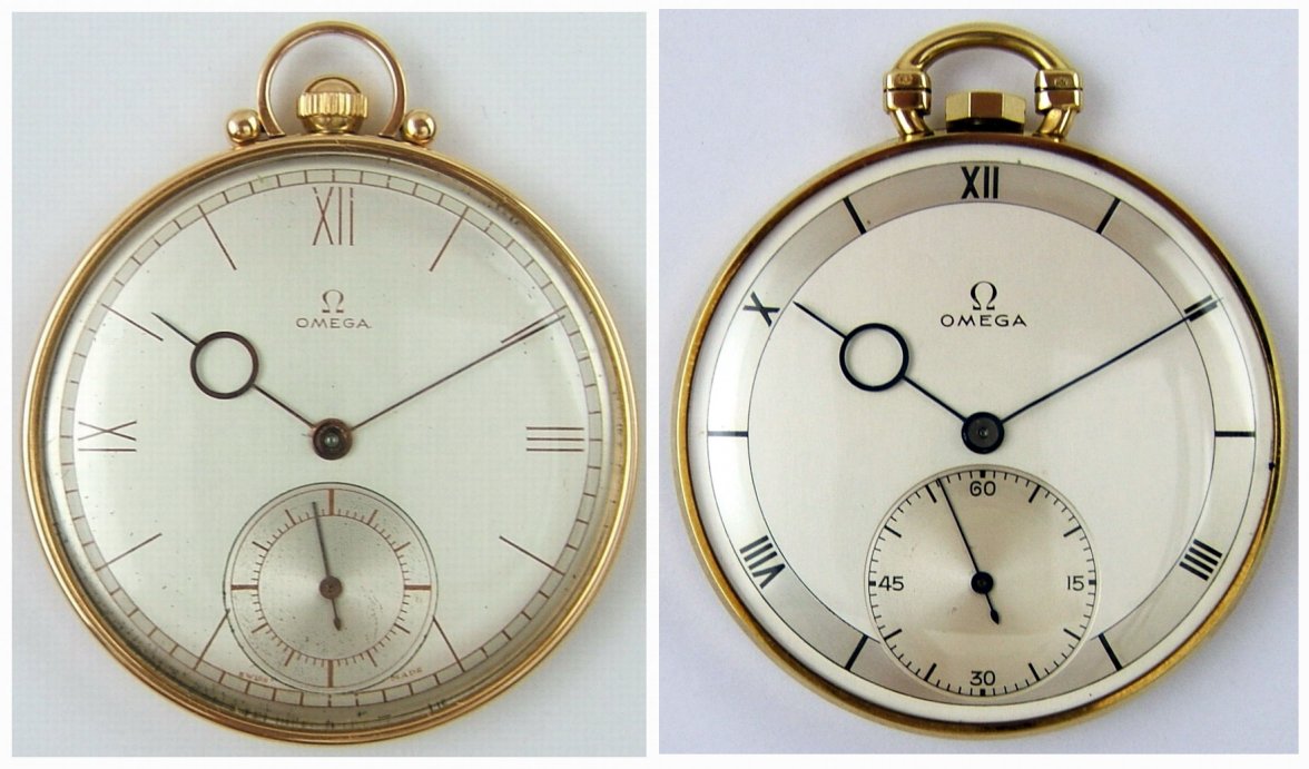

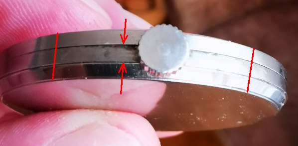

Does this help
I’m afraid it doesn’t help much. As you have already gathered, you present a bit of a mystery. I have tried to show (with markings on your image) that away from the crown the (front) bezel and (rear) caseback line up with the case of the watch - but not where the crown is. Maybe the stem was removed and the case polished back?
What is missing is a view of the inside of the caseback - which would usually give at least a case number. You tell us that there’s nothing. So I don’t think you’ll get much more.
In your first post, you said that you were looking to restore the watch - which will be difficult! I show a couple of similar 37.5 watches (dials are of course different from yours) to show the way your watch probably started.
Sorry not able to offer more.

Hmmmmm. Maybe a car clock? Is there evidence of wear from a bracket it might have fit in?
No signs of any wear at all
