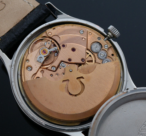

    I really like to color and that it has a date. I can't seem to find anything on this and more surprised that there is no engraving on the movement.

    Its a more modern Seamaster, probably 1970s some time, do you have a serial number for it? And is this a watch you've bought or one you're considering buying?

    HMMM, never seen a blank movement before ????

    More information on the cal. 1002 movement here:
    http://www.ranfft.de/cgi-bin/bidfun-db.cgi?10&ranfft&40&2uswk&Omega_1002
    I'd say that this watch is what I like to call a "Mumbai Special". These are put together in horological chop shops in India. There are always some of these avaliable on eBay at any point in time.
    The watch has an incorrectly refinished dial. I don't think this shade of blue was ever used by Omega. Fonts and spacing seem to be more or less correct. The real tell here is that the hands and dial have luminous material, but there are no "T's" next to the "Swiss Made" at the bottom of the dial that would have required by the law at that time.
    These 1000 series movements don't usually have a lot of engraving on them, and this one looks to be in better shape than many I've seen.
    If you didn't pay more than a couple of hundred, then then you probably didn't get burned too badly.
    Hope this helps,
    gatorcpa
  9. Taddyangle Convicted Invicta Wearer May 24, 2012
    4,820
    31,398
    Thanks for that link. It appears the movement is from 1968-73 era. As I look more closely at the case, I see that the movement is not centered in the case, so I suspect this is not the original case.
