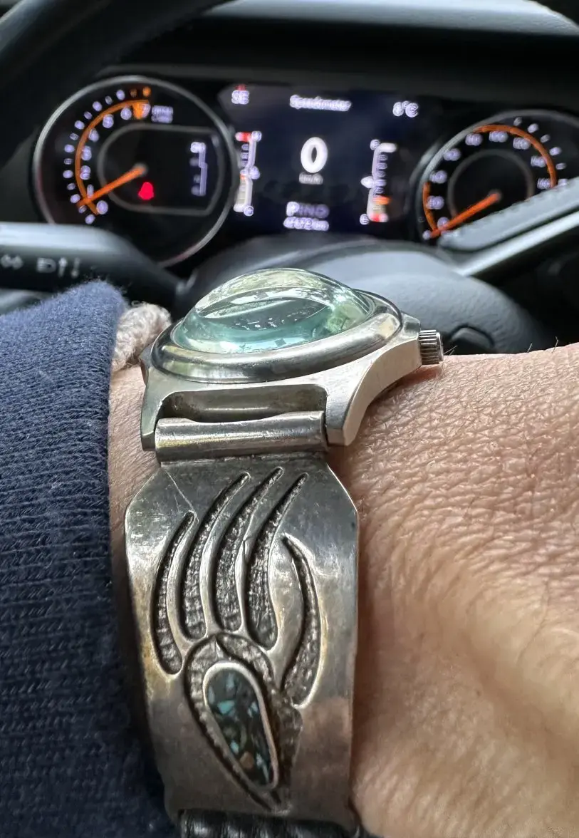

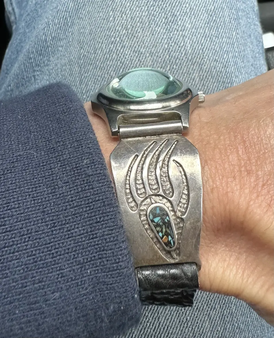

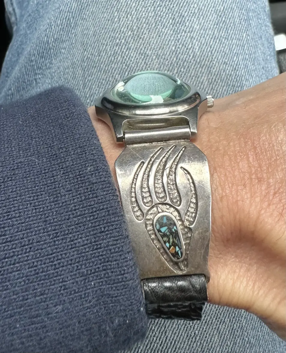

Any creative tips for getting this off?
7,177
23,253
This was easy to put on, but the significant thickness is making it nearly impossible to remove with a 6767 spring bar tool without buggering the whole strap up.
Any tips on what to use to remove this? Dental floss? Thanks.

Maybe you tried it this way already; but I have fairly good luck by inserting the spring bar tool along the edge of the strap (as opposed to the top side or the underside).
Good luck

Thanks. Could you explain a bit more about this technique?
52
214
Feeler gage. Slide between strap and lug until it touches the spring pin under the shoulder. Works every time

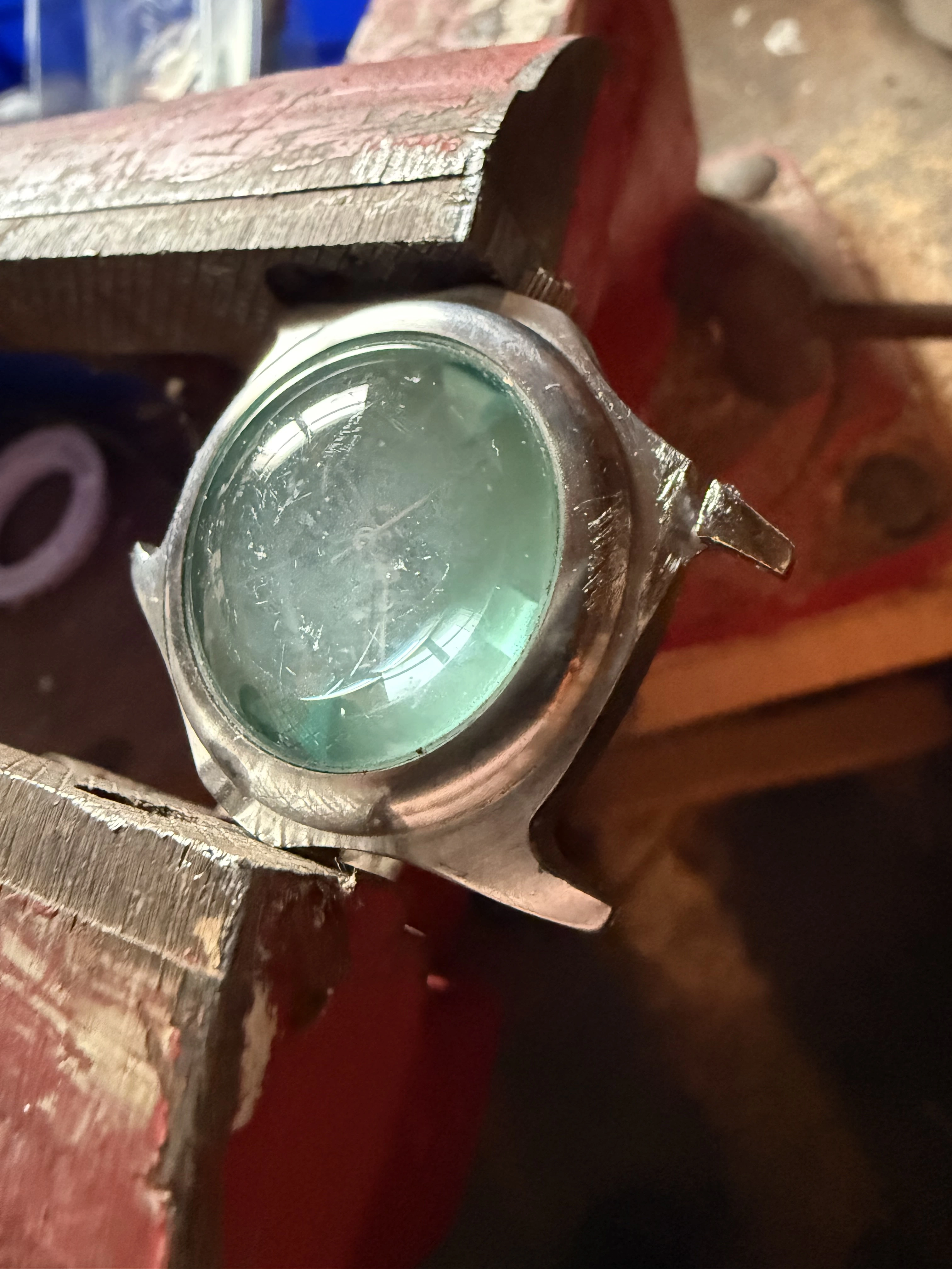

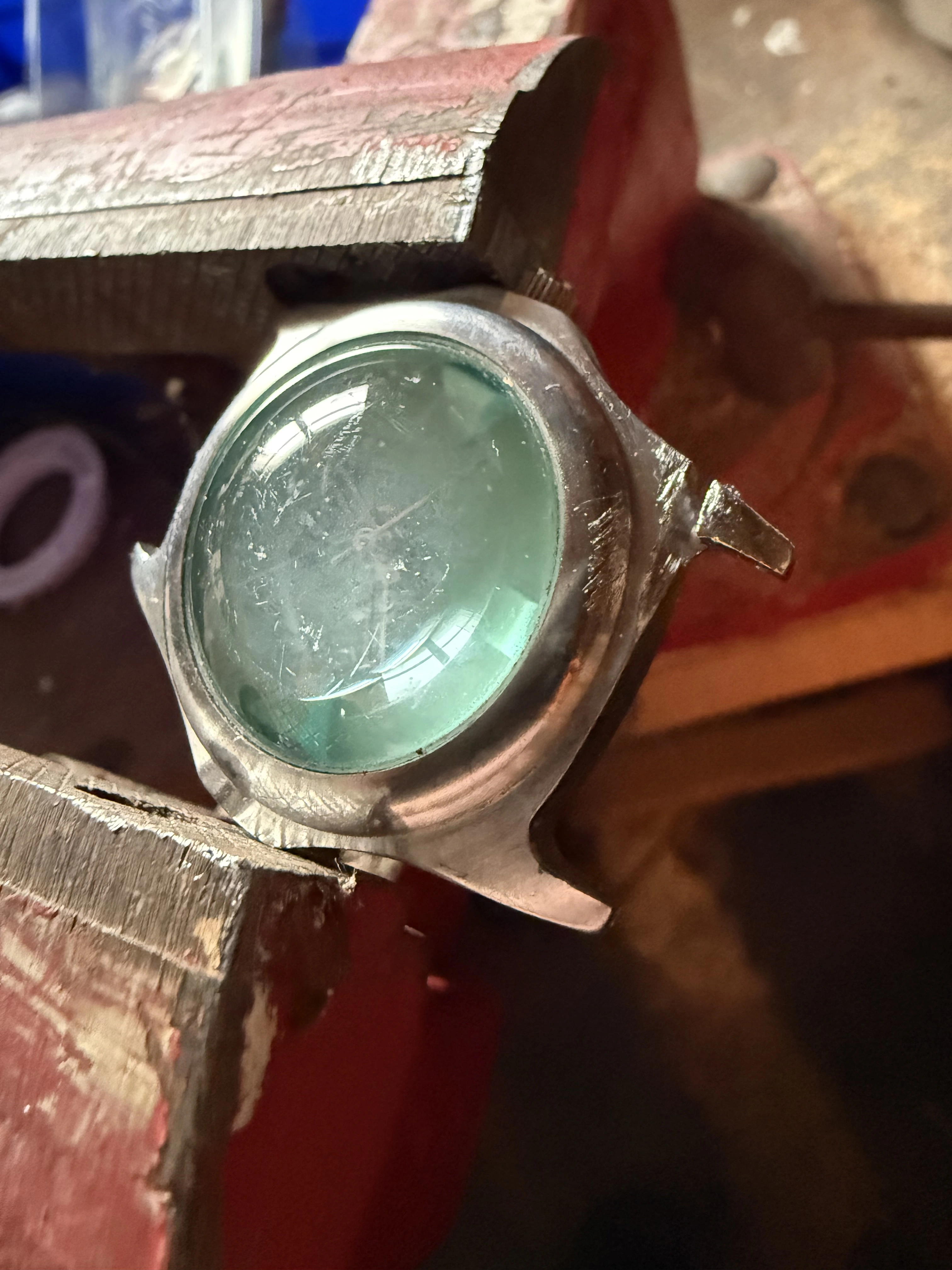

Beautiful watch and strap Bob. I once put spring bars that were designed for drilled lugs on a sterling silver onlongapo strap.
Strap was worth more than the watch. I sawed off the lug. I am hoping the experts will have simpler solutions if any of the tips already submitted fail.
Victim. And as the saying goes… photos or it didn’t happen.

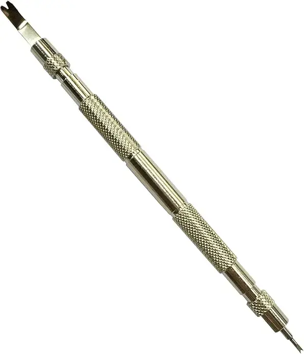

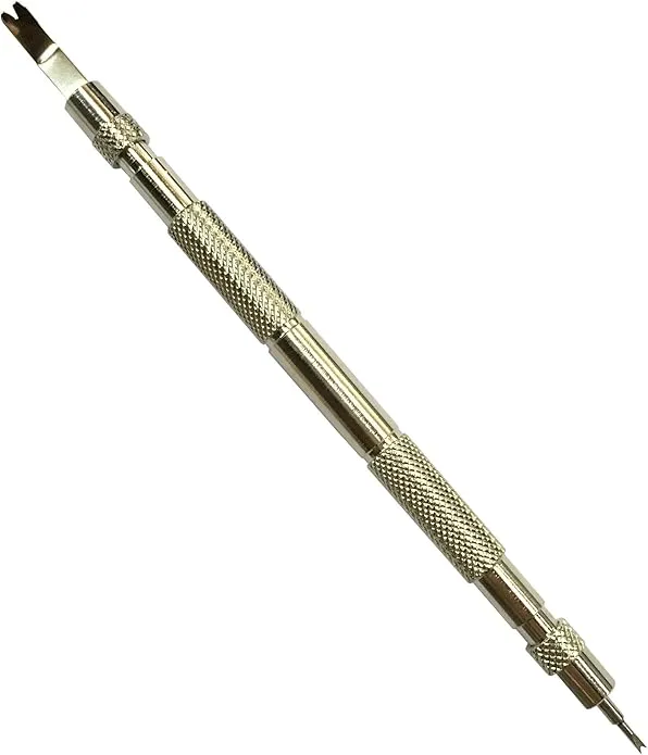

This is why I use a 6111...
You can slide the wide fork down the side of the strap, and press to remove the spring bar...
