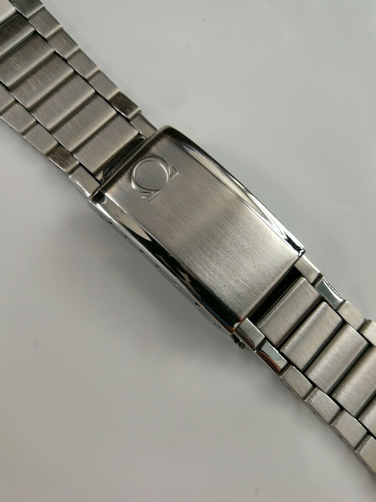

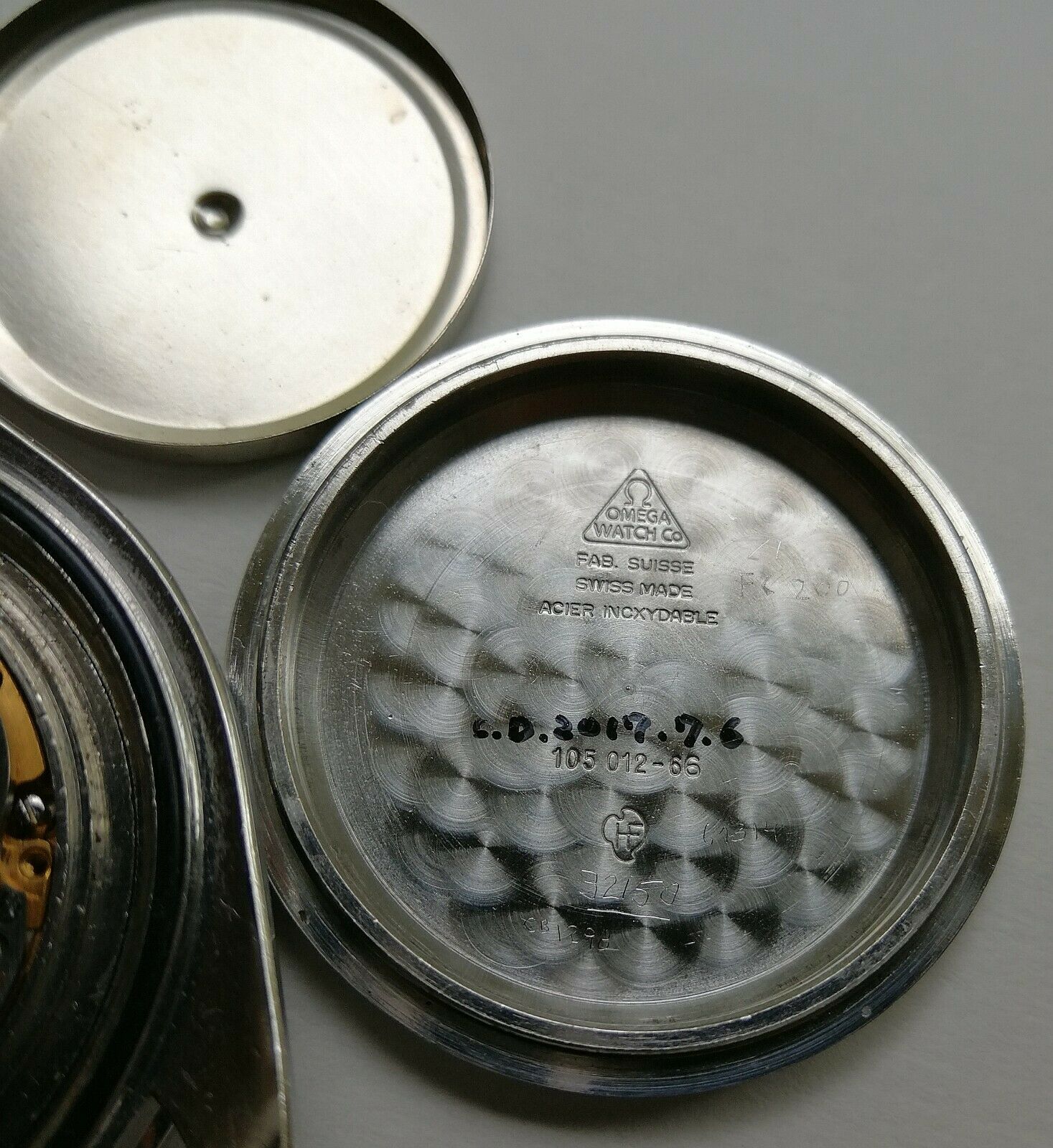

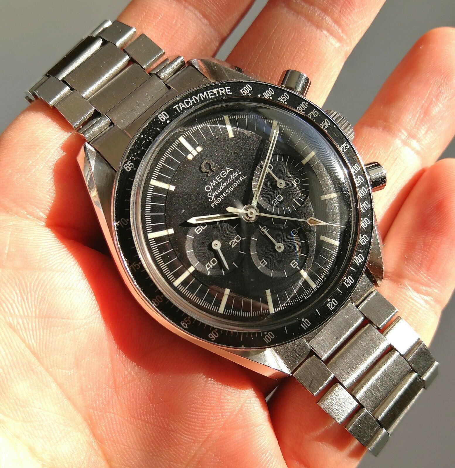

Another unusual, not surprising, listing on eBay, an Omega Speedmaster 105.012-66 HF with the wrong pushers, wrong bezel, wrong movement and maybe wrong crown. The movement number is 17302122 which is early for a 66... more likely a 2998 movement. The case looks good, and the caseback, from what can be seen, looks sharp and a nice 1039 bracelet with 516 endlinks dated 3/68. Parts are from all over the map.
Right now the bidding is near 3K. What are your thoughts on this one? Worth paying for the parts to resell? Not me... but, if anyone does... I have dibs on the caseback.

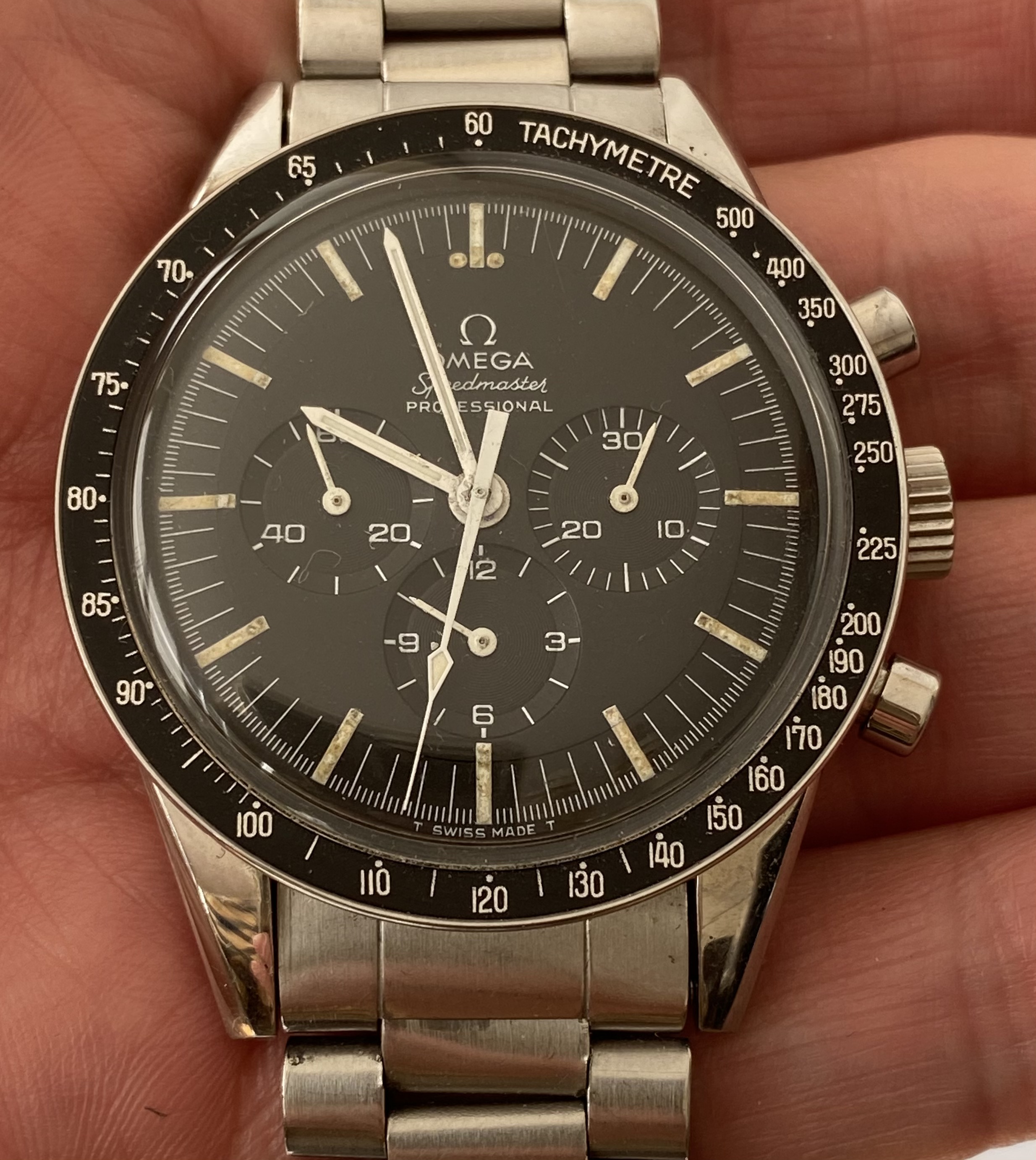

Be careful of these assembled watches. I wasn’t and picked up an assembled Ed White last year.
https://omegaforums.net/threads/eba...t-what’s-wrong-why-i-grabbed-it-anyway.99150/
I still have it and haven’t changed anything, other than having it serviced. It keeps very good time and I really like the unusual service dial.
I’m happy with it, but as the old thread indicates, I’d have a hard time selling it.
Given how early that movement serial number is, I’d pass on that HF.

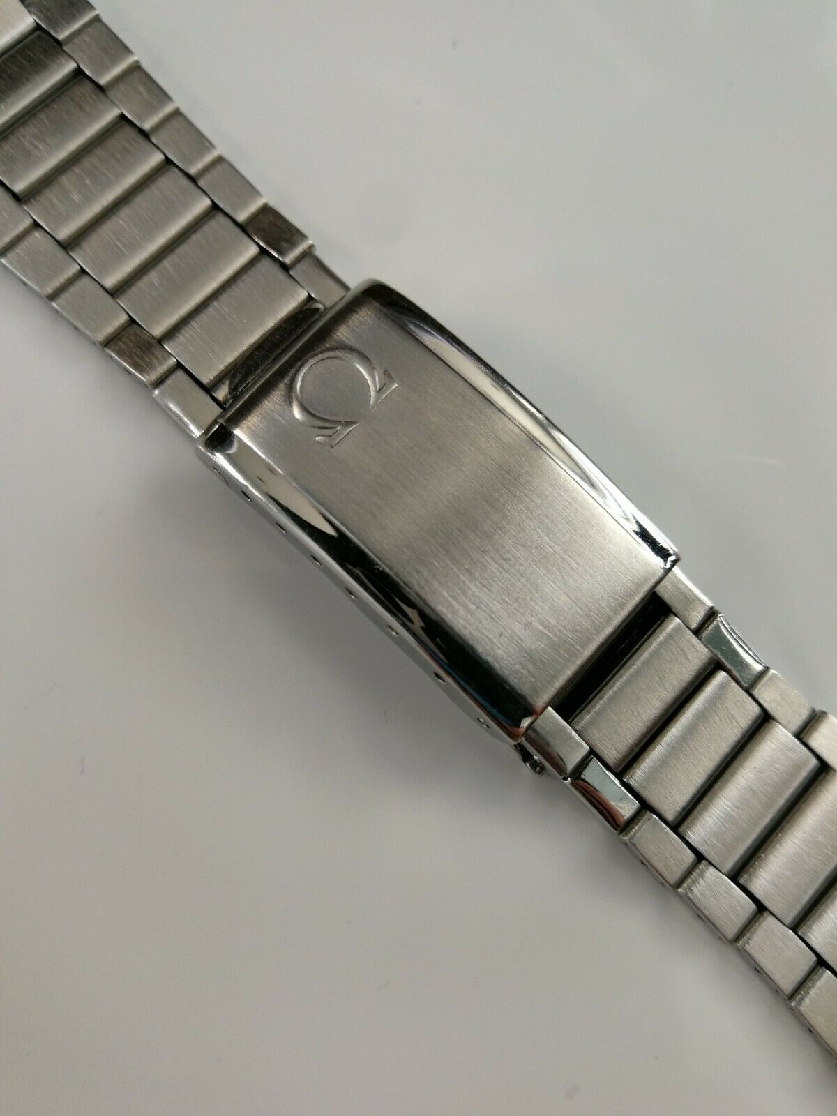

IMHO (dare I have one), I believe that the listing (and the bids) are way over! By a tall margin. I am somewhat doubtful of the authenticity of some of the parts....as I said this is just my opinion. I feel the bracelet 'Omega' markings are 'off'. All the bracelets I have demonstrate a 'sharpness' of font and stamping. In my Country, the term 'Bitzer' refers to a Dog (Canine) from many bloodlines....This watch is a Bitzer! Yes the listing makes reference to this but it ain't worth the dough!
Please do your own research...be critical at best....think wisely before sinking large sums into sub-standard examples UNLESS you're after 'that' part and are willing to part with $$$ to get it! 😀

It's interesting how quickly *off* things look (especially re: bracelets) when brushed/polished. The bracelet's legitimate, I'd hazard, but has clearly been brushed (it should have polished sides and a brushed center). I personally actually sort of like strange franken-ish put-together watches with incorrect bits, but if you look at prices of 1039/516s, cal 321s, and hands, this watch is already priced higher than its parts, as far as I can tell.
