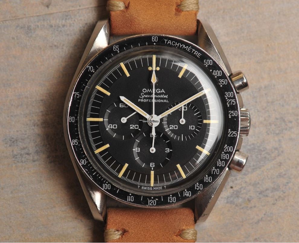

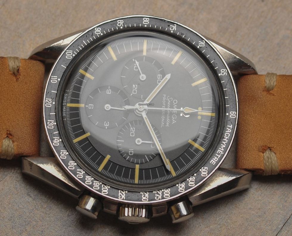

  1. djmusicman Jun 1, 2018
    634
    1,397
    How can we tell if a watch has really clean original lume or if it's a really good relume? This 145.012-67 dial looks good but is it redone? Thanks 145.012-67 1.JPG 145.012-67 2.JPG
    Etp095, nonuffinkbloke and Baz9614 like this.
  2. trash_gordon Jun 1, 2018
    591
    1,226
    You need a UV-Lamp to verificate
  3. Philou Jun 1, 2018
    236
    478
    as @trash_gordon said, UV lamp is a must to check the lume.
    Your dial looks original but I am more circumspect about the hands installed

  5. djmusicman Jun 1, 2018
    634
    1,397
    I guess it's because they match perfectly. I'm more concerned about the dial, relumed hands don't bother me for some reason.

  7. Philou Jun 1, 2018
    236
    478
    Hands looks very even and clean, I would like to see them under UV light to be sure they're not relumed

  9. ewand Jun 1, 2018
    1,291
    5,855
    It looks almost too good & clean to be straight...
    and this upload_2018-6-1_10-56-24.png might be a clue as well... how much is the seller asking?
  10. djmusicman Jun 1, 2018
    634
    1,397
    $9000, I just spoke to the seller and it's already reserved.

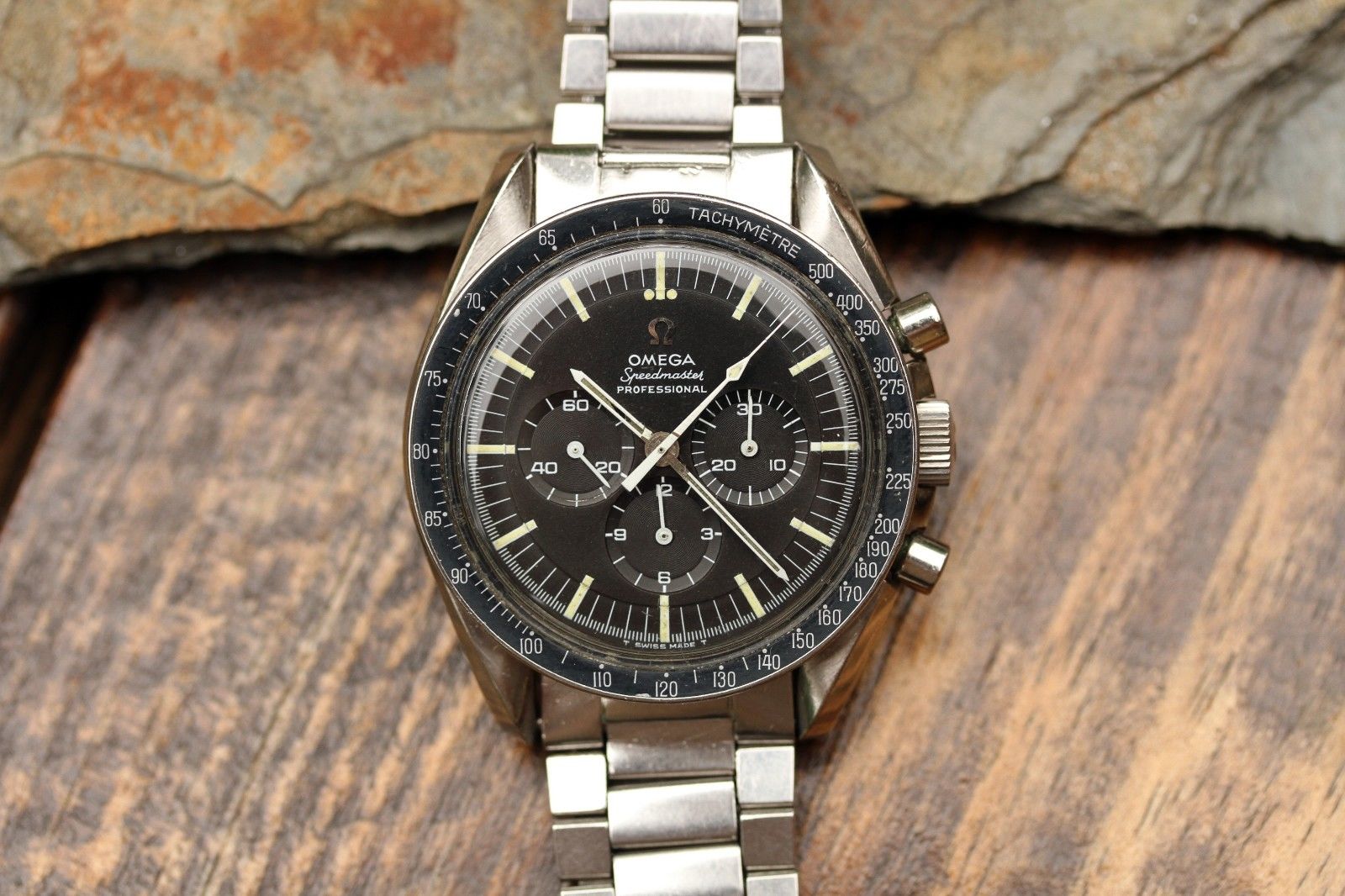

    Etp095 likes this.
  12. djmusicman Jun 1, 2018
    634
    1,397
    Yes, I've seen that one, the left chrono dial is marked.

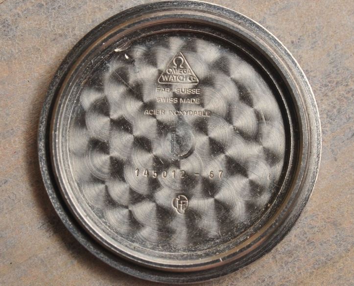

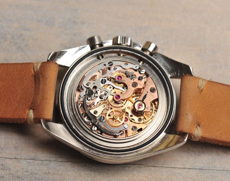

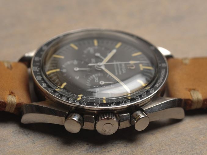

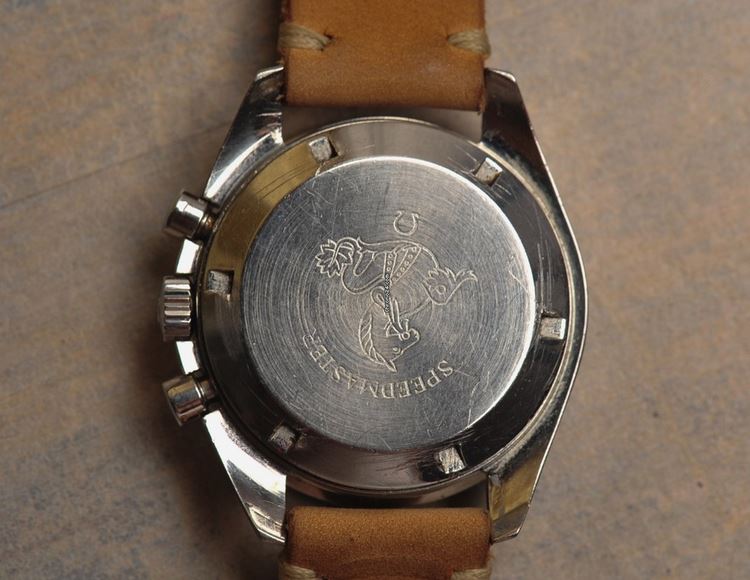

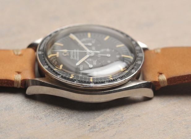

  13. djmusicman Jun 1, 2018
    634
    1,397
    Caseback has some toolmarks but is otherwise in good shape
    Case looks crisp
    Etp095 likes this.

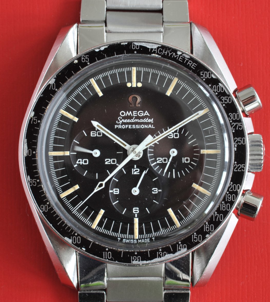

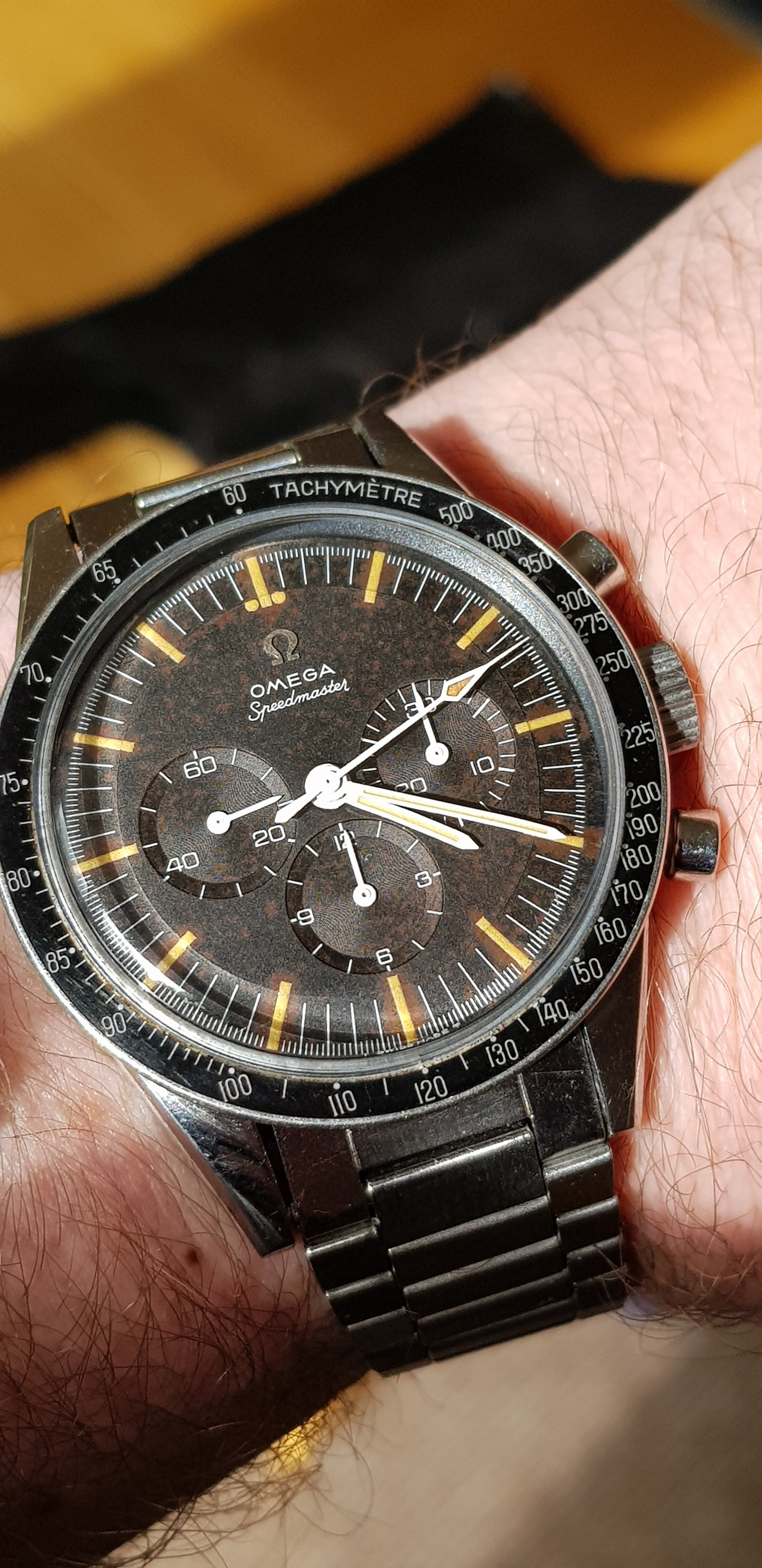

  16. lando Jun 1, 2018
    649
    1,179
    The dial lume on that watch looks very much like the one on my -67. Slightly shrunk and with some darker spots in it. A similarity in hour and minute hand lume can also be seen on these two watches.
    OP lume is identical in color on dial and hands. It does look relumed to me.
    Here my -67 for comparison:
    nixf6, Etp095, SpeedyPhill and 2 others like this.
