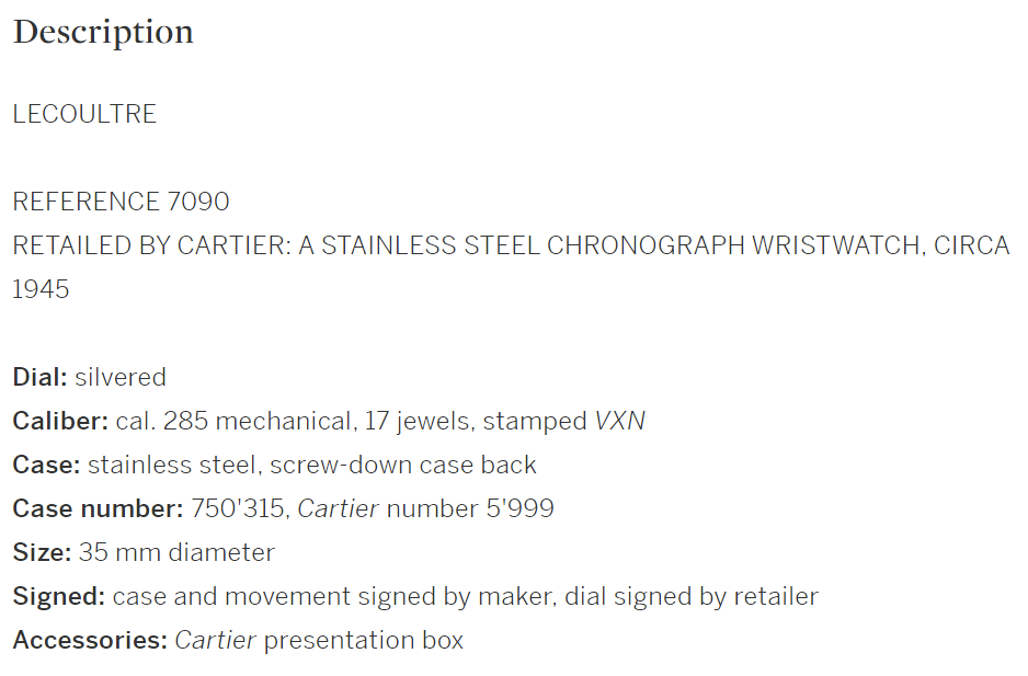

Another Cartier-signed, LeCoultre-signed UG

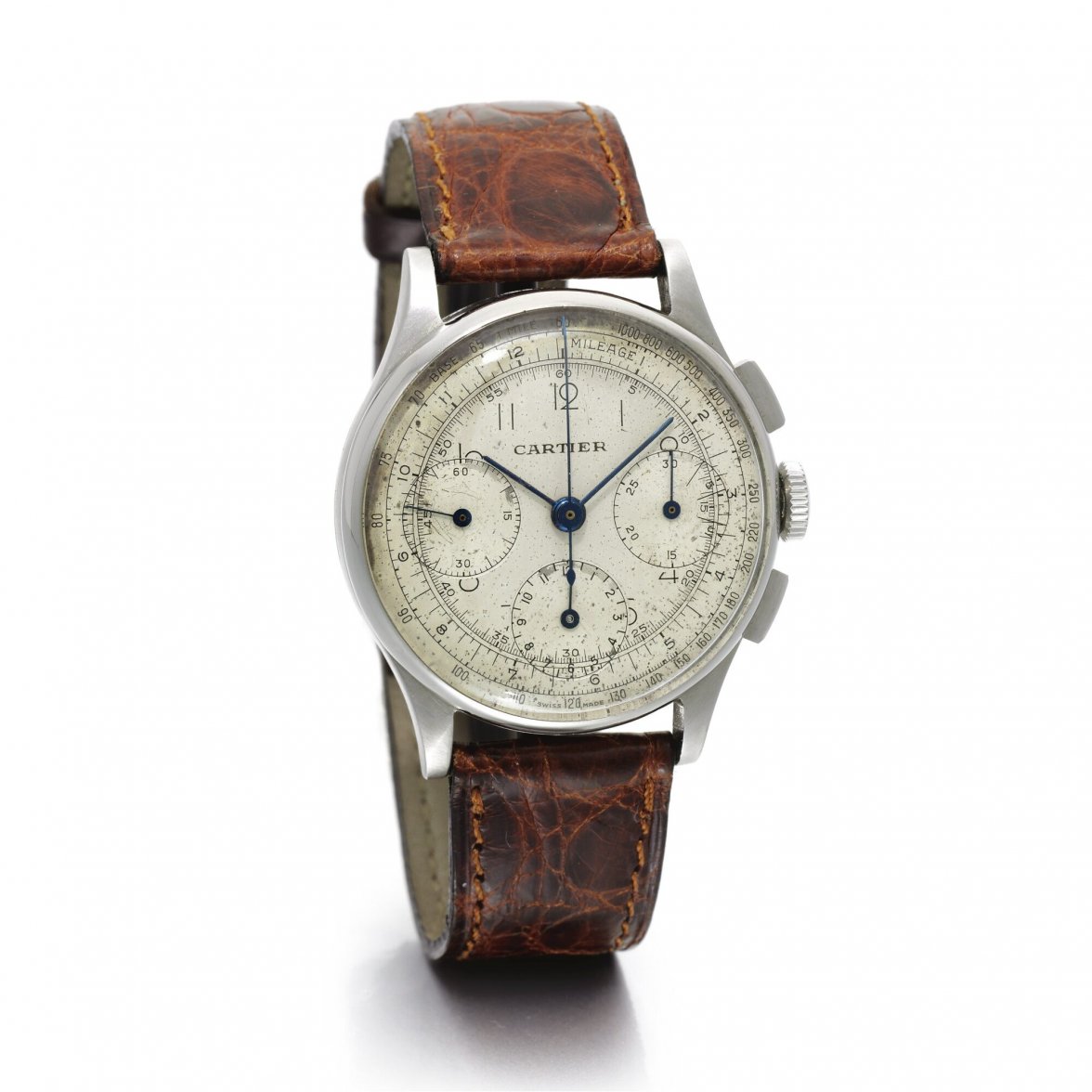

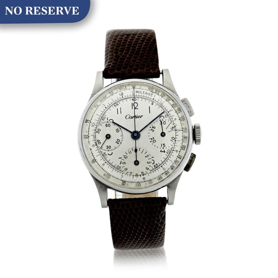

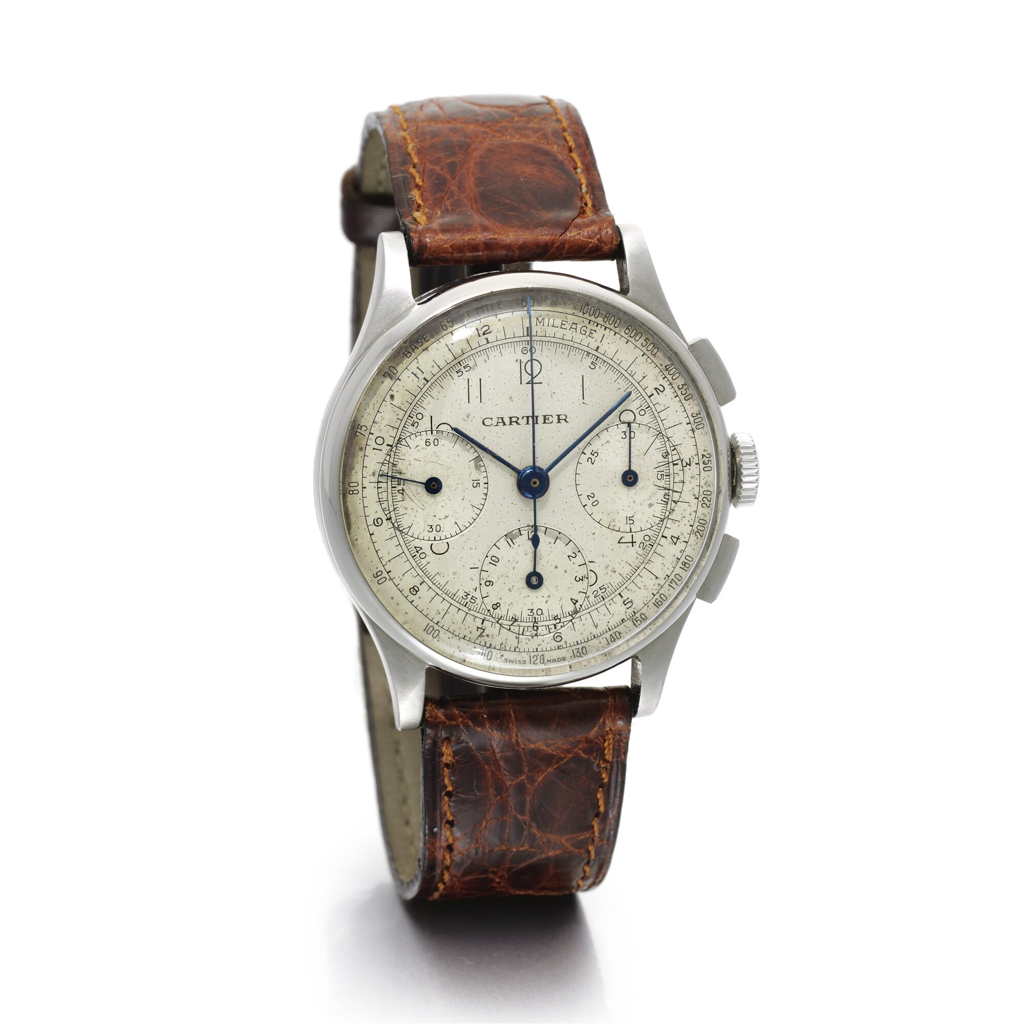

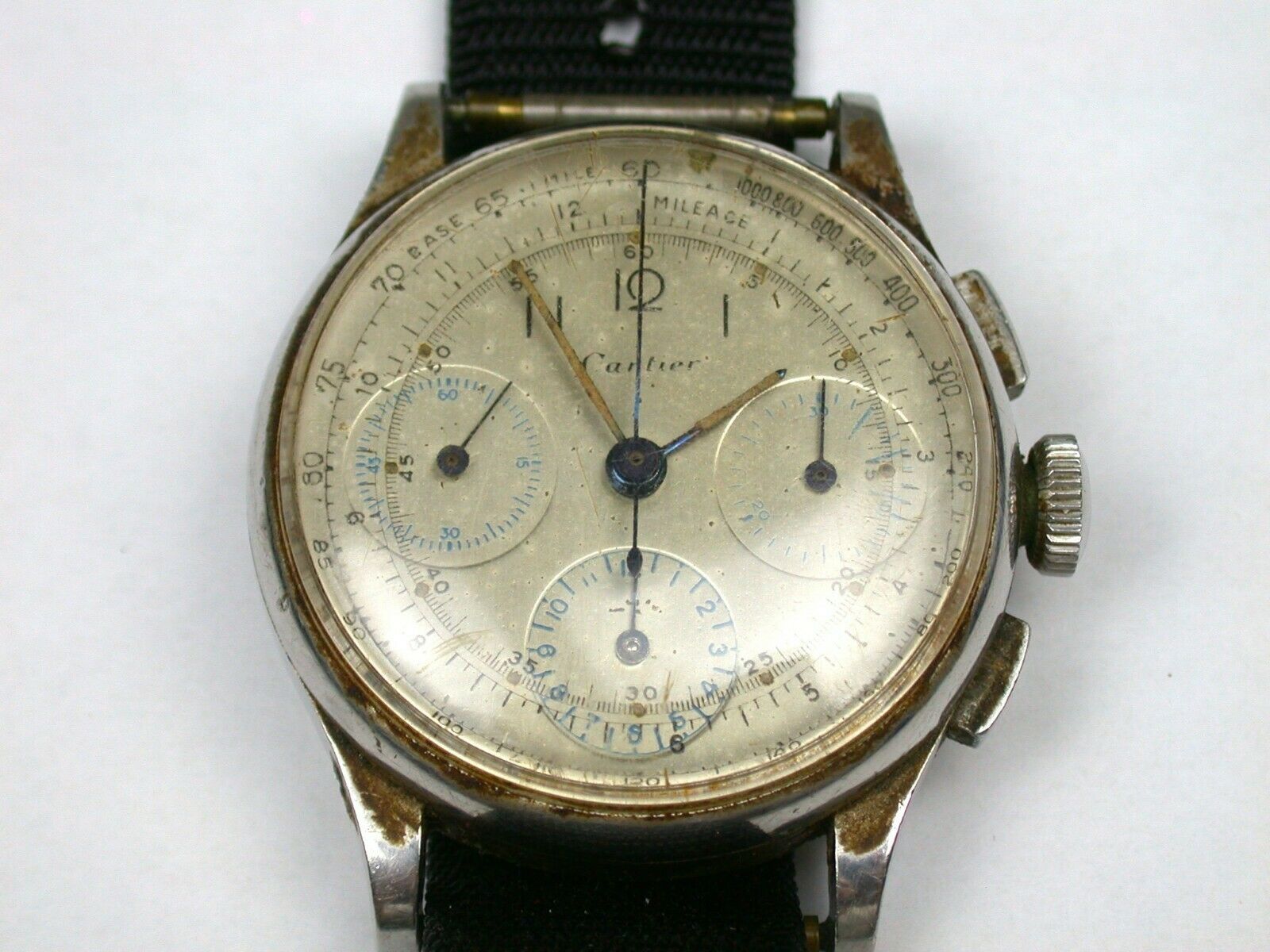

Has someone claimed that this is not a redial?
13,179
52,367
So ugly it has to be legit? 😁
3,095
23,794
You mean this is the real deal?
13,179
52,367
Never resolved ... I’d vote🤮
2,801
4,864

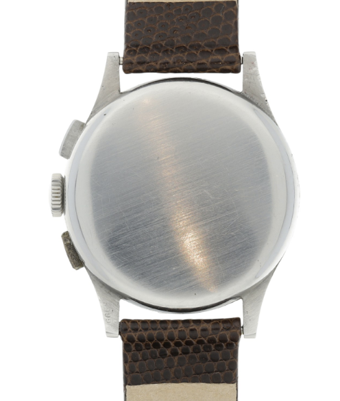

What is really special about this example is the "screw-down case back" that was designed to look exactly like a snap-on case back.
1,195
1,979

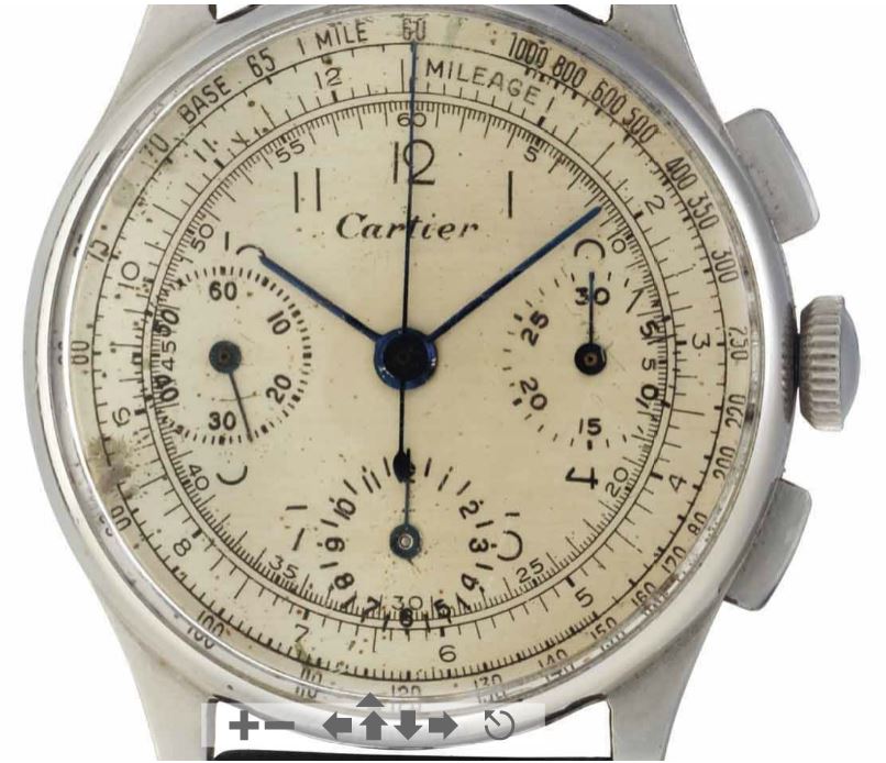

I'm not feeling the dial, even if original its pretty ugly ?
5,920
9,188
The dials are intriguingly similar but it is IMHO impossible they ever remotely would have had a chance to pass Cartier quality control. Given the close serial and being the same reference I assume they are of the same batch. My conclusion is that this may have been a batch which was originally sold by Cartier but that by some kind of weird coincedence they were both redialled by the same, not overly talented, party.
5,920
9,188
The German tank number approach suggests a total production of 75. Sounds sensible.
