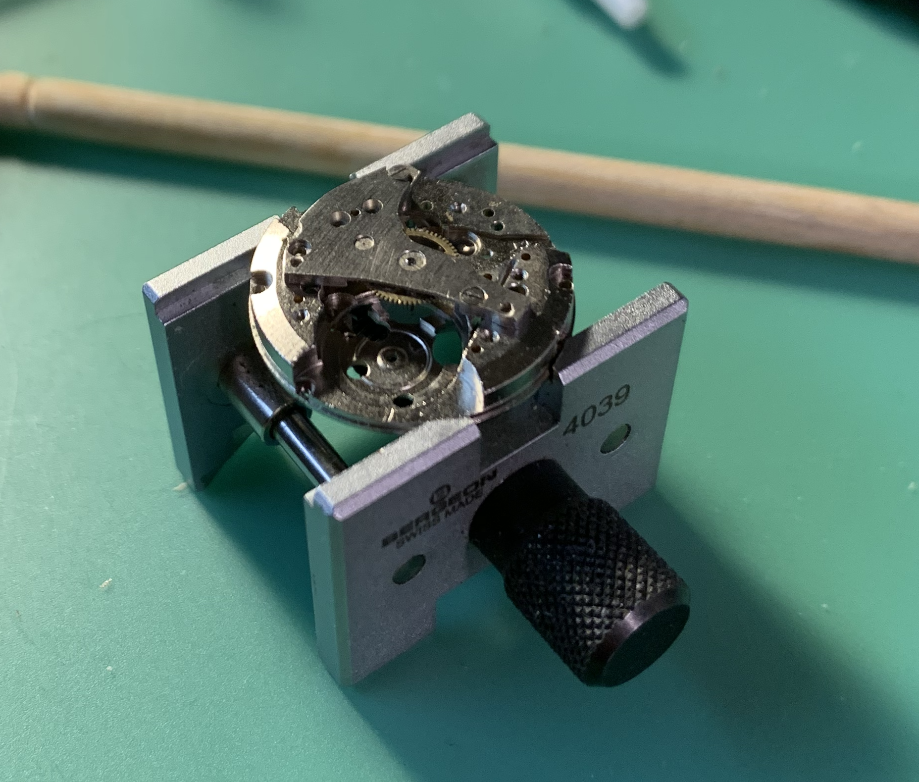

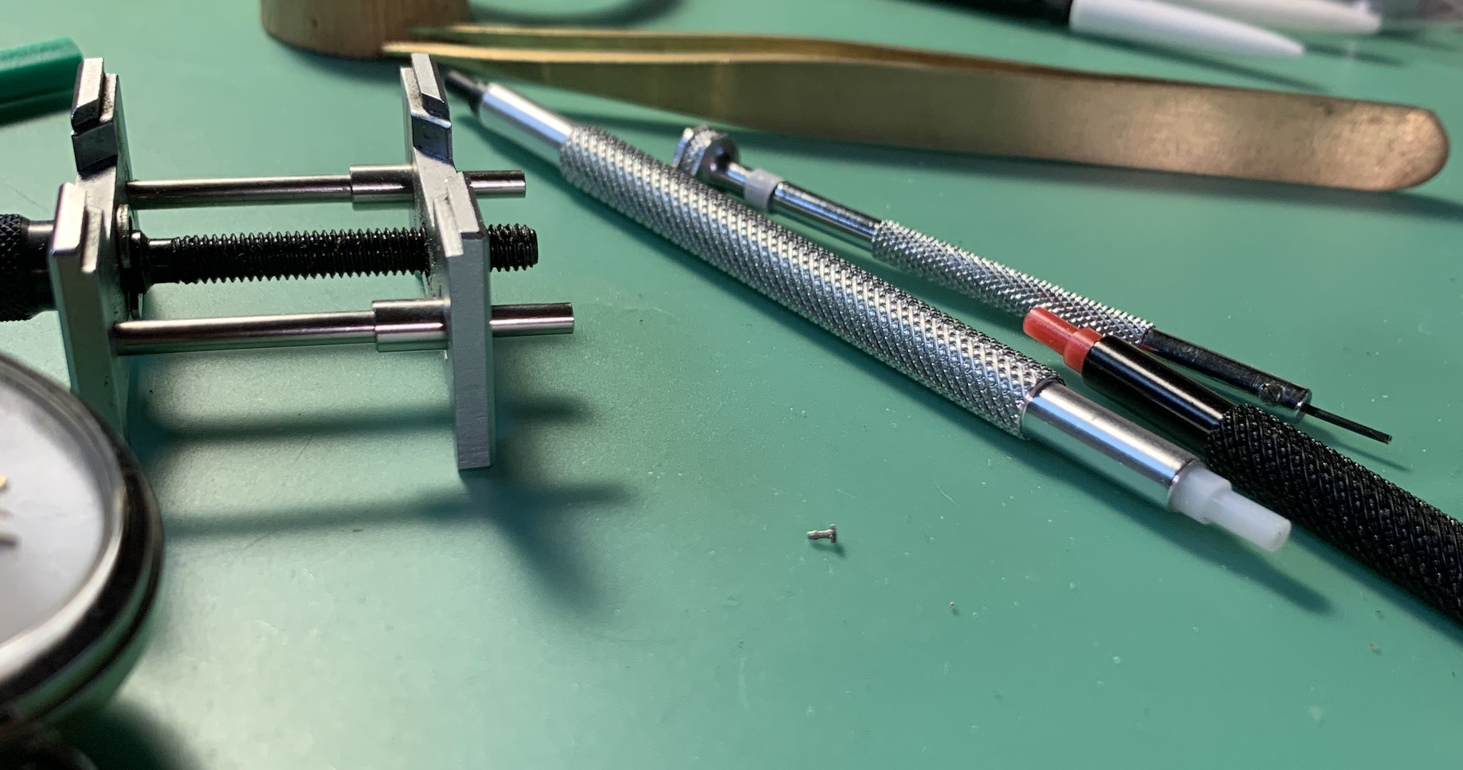

Look what I found. The missing cannon pinion!

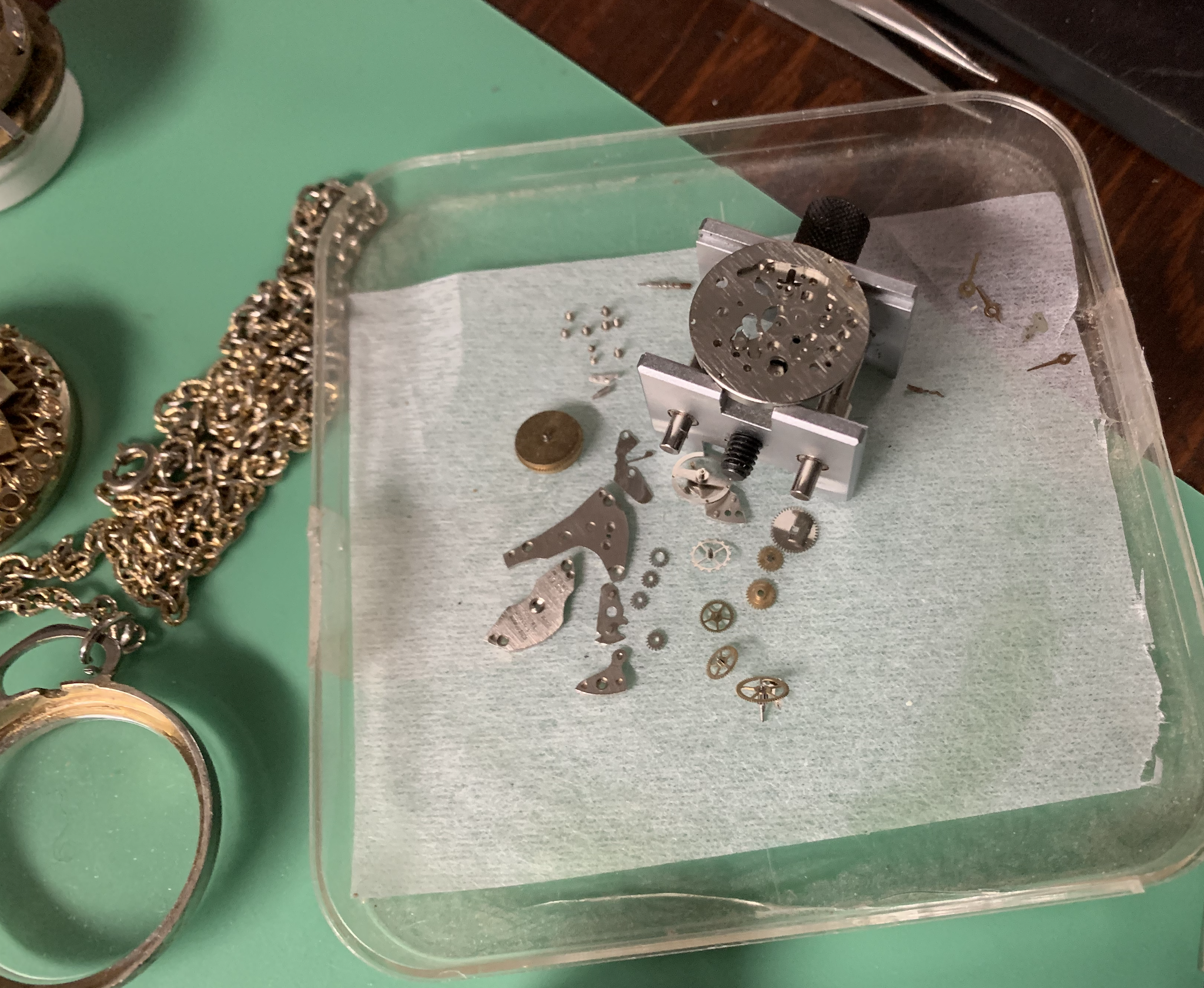

I can not resist a challenge. Is there enough of this watch to assemble it. The broken stem presents an issue as that will make winding and setting difficult. Not sure how long this has been apart. Longer than i have owned it. Amazing that all the parts are there save one set bridge screw.
so can it be done? Am I motivated enough to assemble a watch in a few hours.

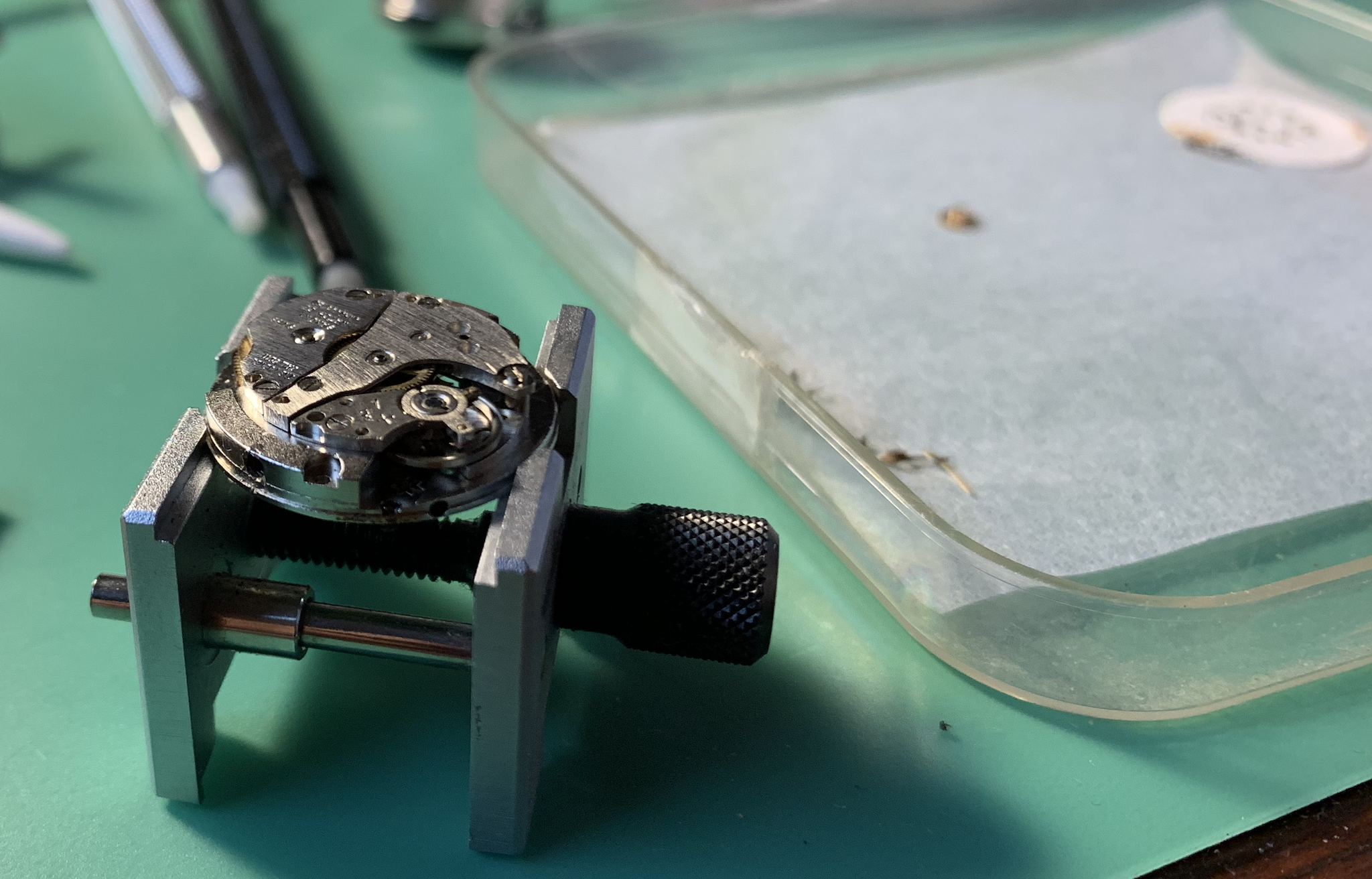

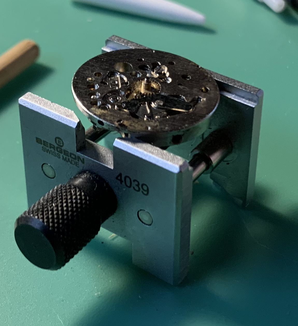

Once the wheels are back in, we may have something. Now for the dial side.

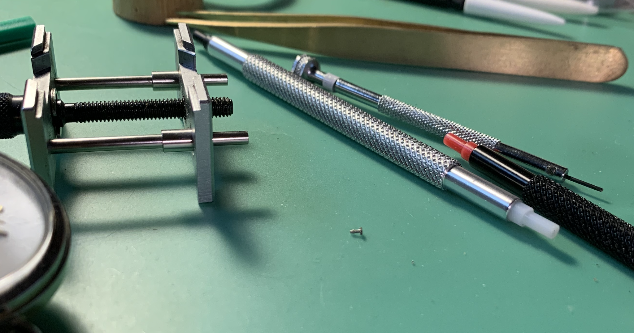

The setworks is there save the one screw. Force a few turns on the click then add a balance.

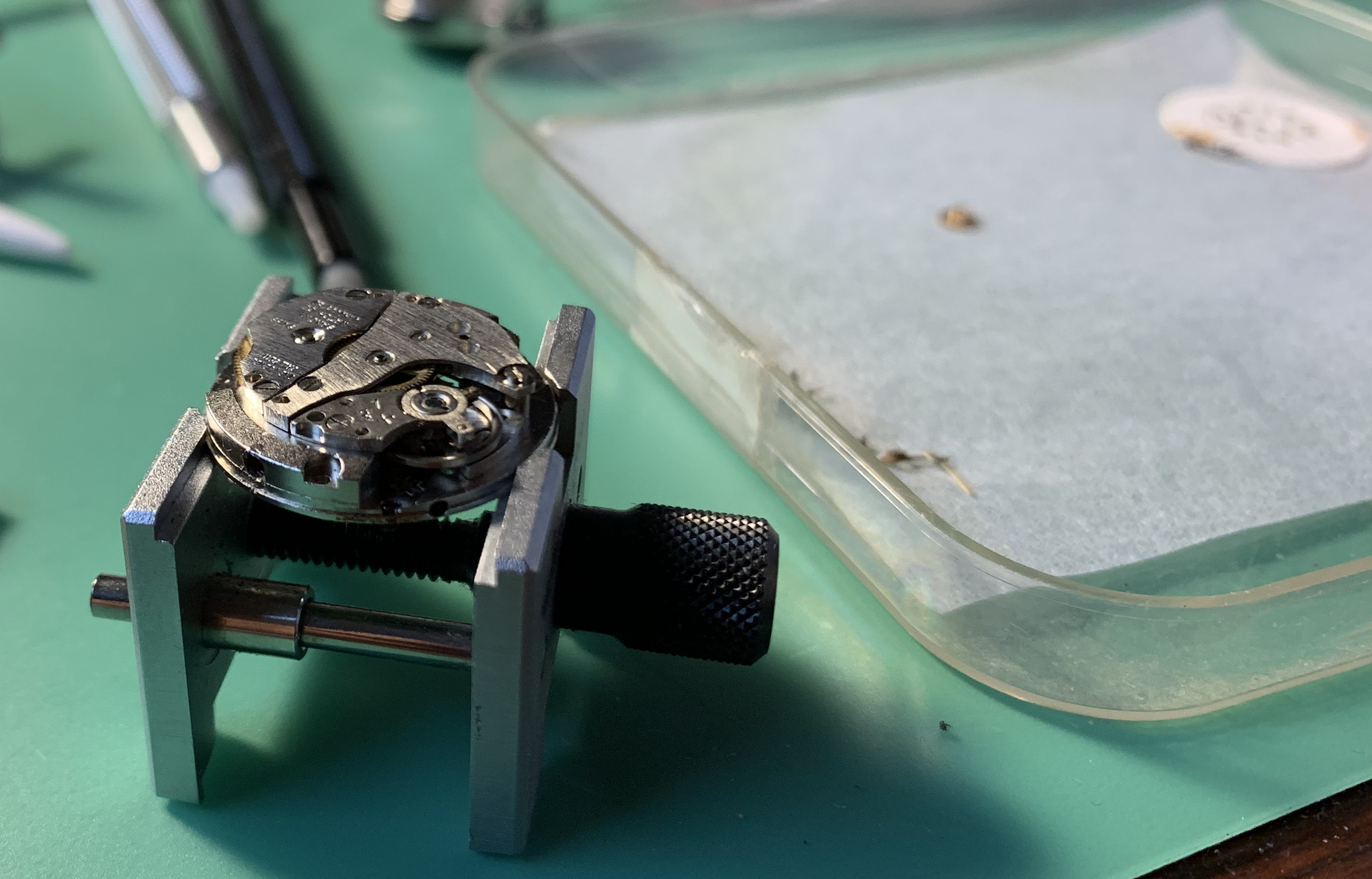

Wow it actually ticks.
I am amazed and impressed. There must be something said for these old pin levers. The finish on this is of quite good quality. They must have been designed for easy assembly. Most of the work was getting the train to line up with the pivot holes.
