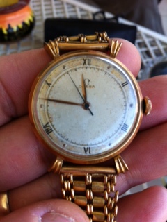

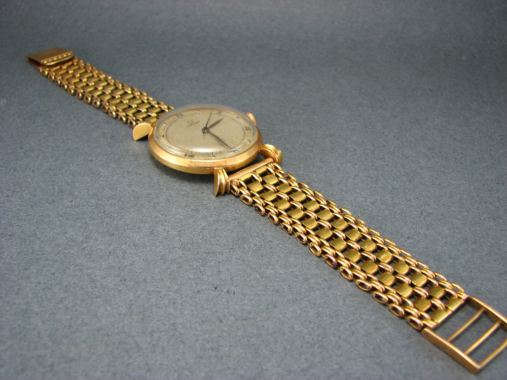

  4. Ungar Apr 7, 2014
    7
    Forgot the photos

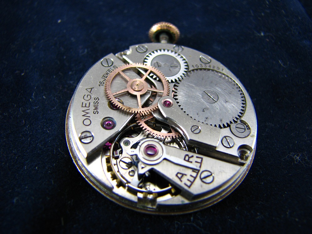

  5. hoipolloi Vintage Omega Connoisseur Apr 7, 2014
    3,516
    5,792
    Looks like an Omega in the 40's with a 14K custom made case , powered by a 30T2SC . Need to see the movement serial # and inside the caseback to confirm.
  6. Ungar Apr 7, 2014
    7
    Thak you "hoipolloi". The case is marked 18k and indeed looks custom made, but the serial number on the case is 100792 and from what I have seen on the internet that means it's much older, doesn't it ?
  7. Patrick Dixon How do these messages get here? Apr 7, 2014
    236
    113
    It's the movement serial number that will date it, not the case serial number.

  9. hoipolloi Vintage Omega Connoisseur Apr 7, 2014
    3,516
    5,792
    Yes, the movement serial # will date the watch, btw, the SC (second-centrale) version means it's not quite old

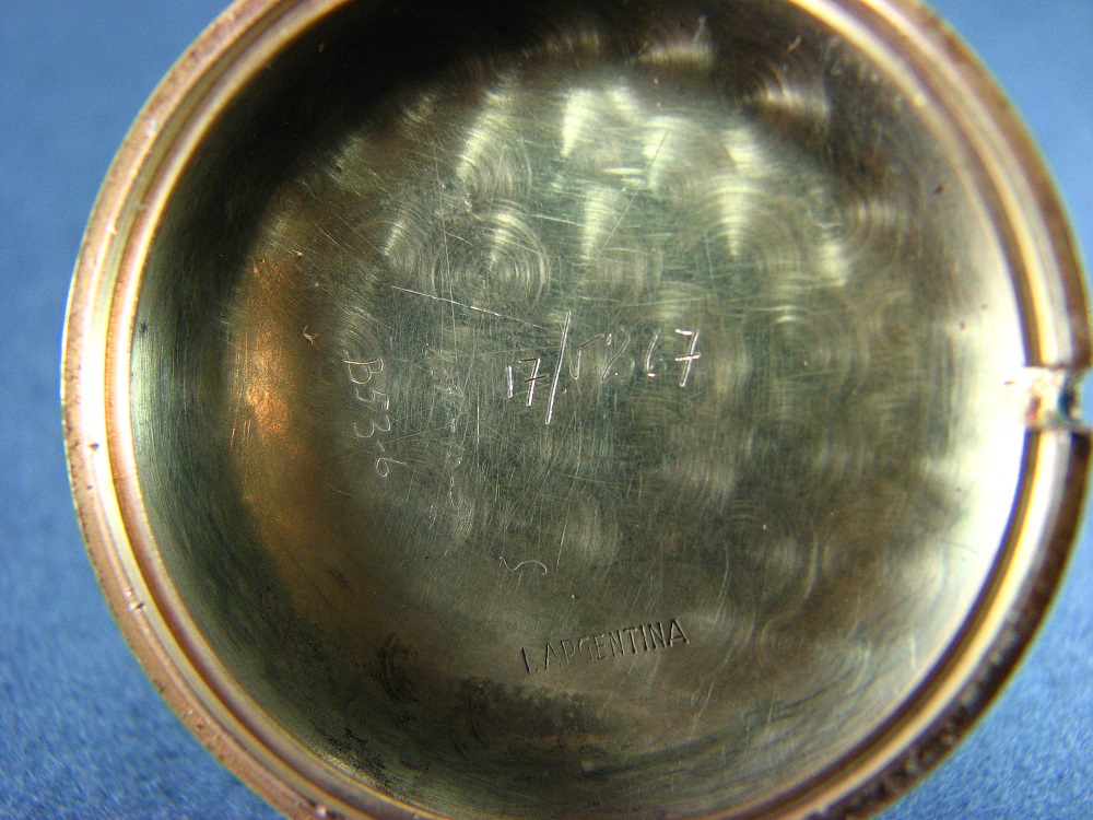

  10. Ungar Apr 9, 2014
    7
    Now I know the case was made in Argentina :) and that it was made in 1944 (I think).
  11. Privateday7 quotes Miss Universe Apr 9, 2014
    5,753
    2,903
    10 million serial number put this watch production from 1944 to 1947. It is a custom made case from Argentina, so naturally no official reference code in Swiss database.
  12. CanberraOmega Rabbitohs and Whisky Supporter Apr 9, 2014
    5,570
    6,208
    but for the after-market case, a beautiful watch.

  15. John R Smith Apr 10, 2014
    1,320
    726
    Oh, I really like the case. It's a lot of fun, and with the aged dial the piece has a unique charm :thumbsup:
