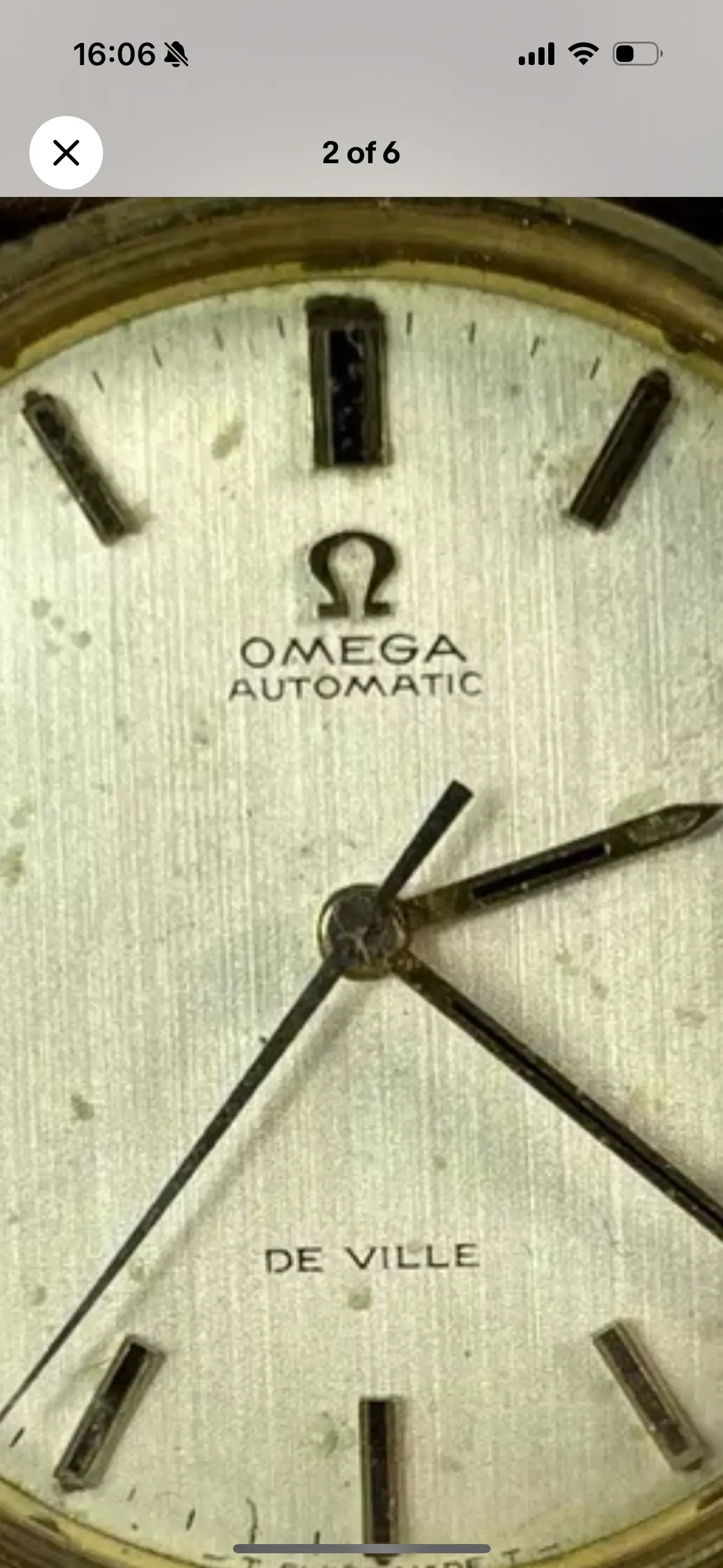

Am I right in thinking…
45
9

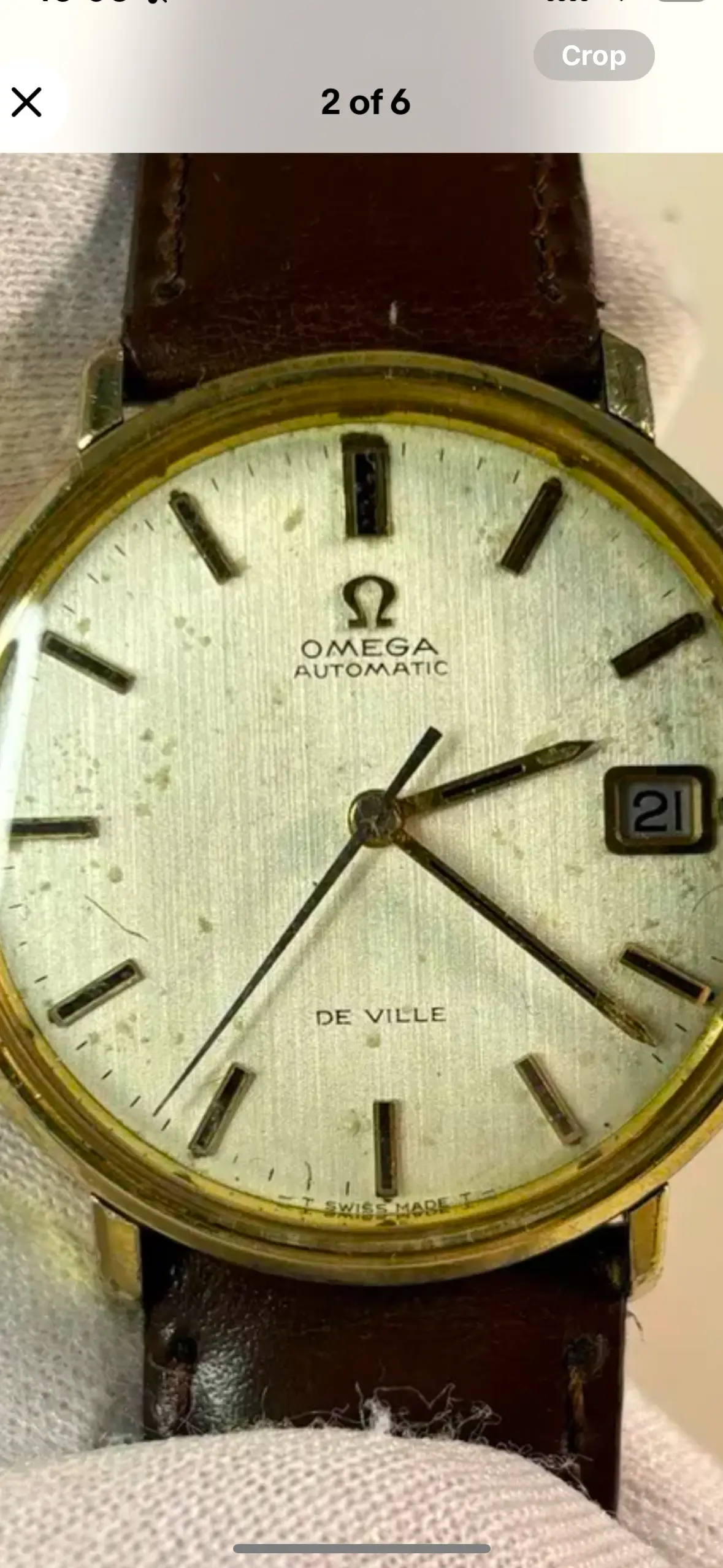

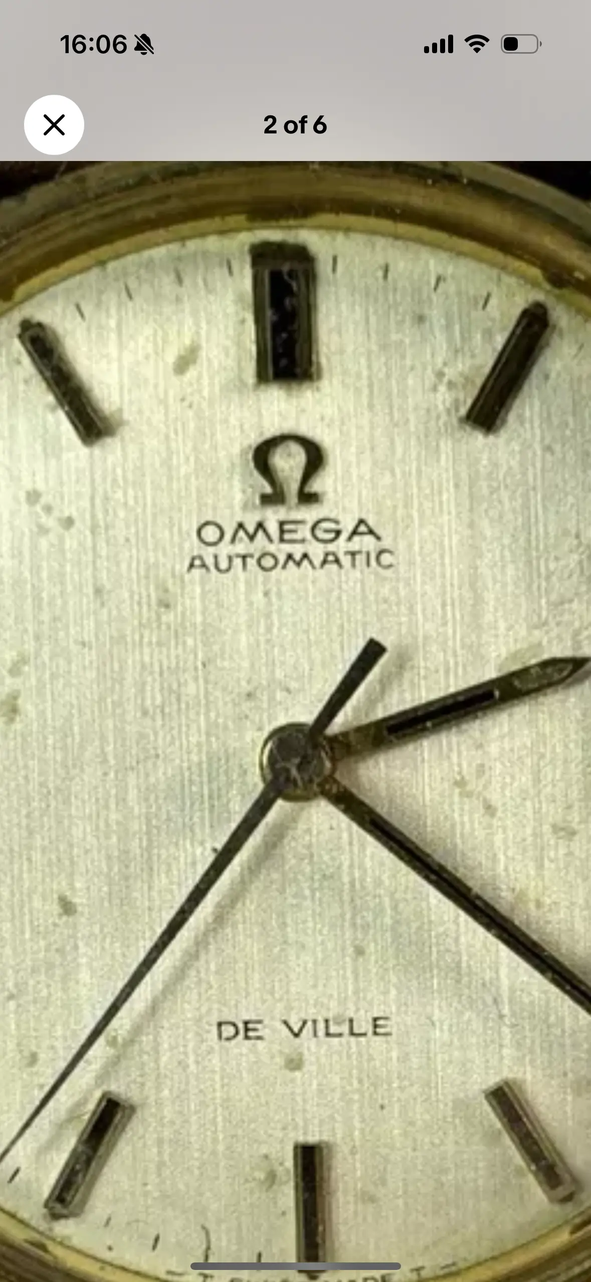

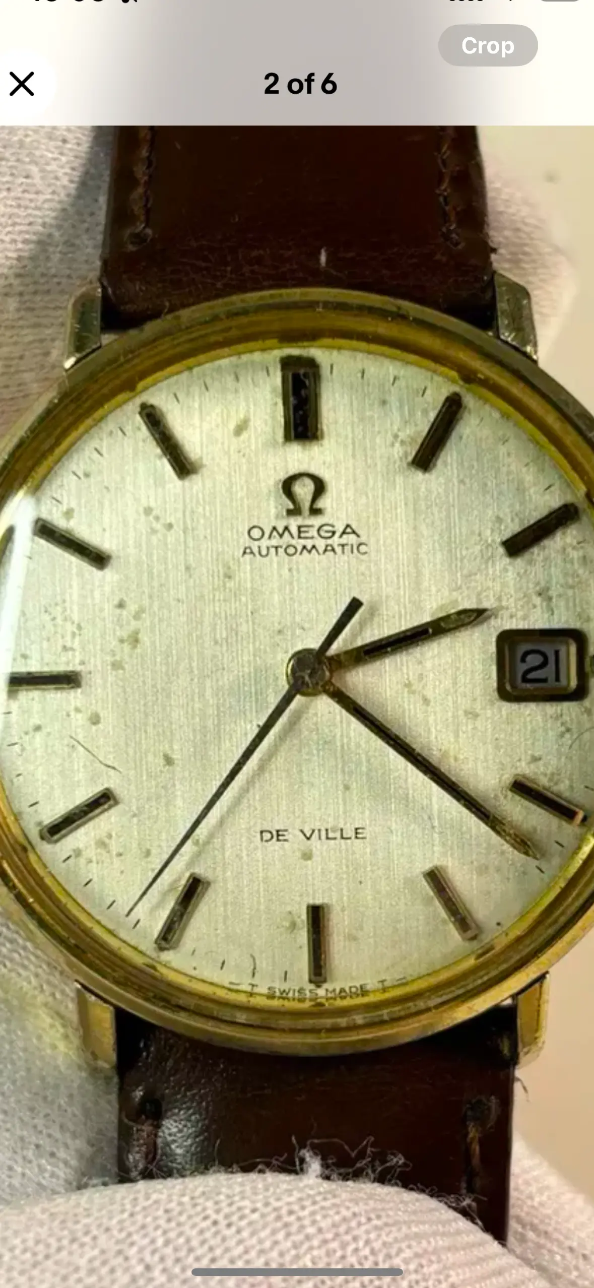

The “Omega” on this looks dodgy? The G isn’t sitting well with me which might suggest a redial!
197
162
Omega printings on the dial have evolved over the decades, so it looks different from the later prints. I don't see the 'G' being unusual for this dial.
221
353
I would call this one damage instead of patina. The dial is missing the seconds ticks between 23 - 30. There was likely some moisture intrusion as the right side is discolored.

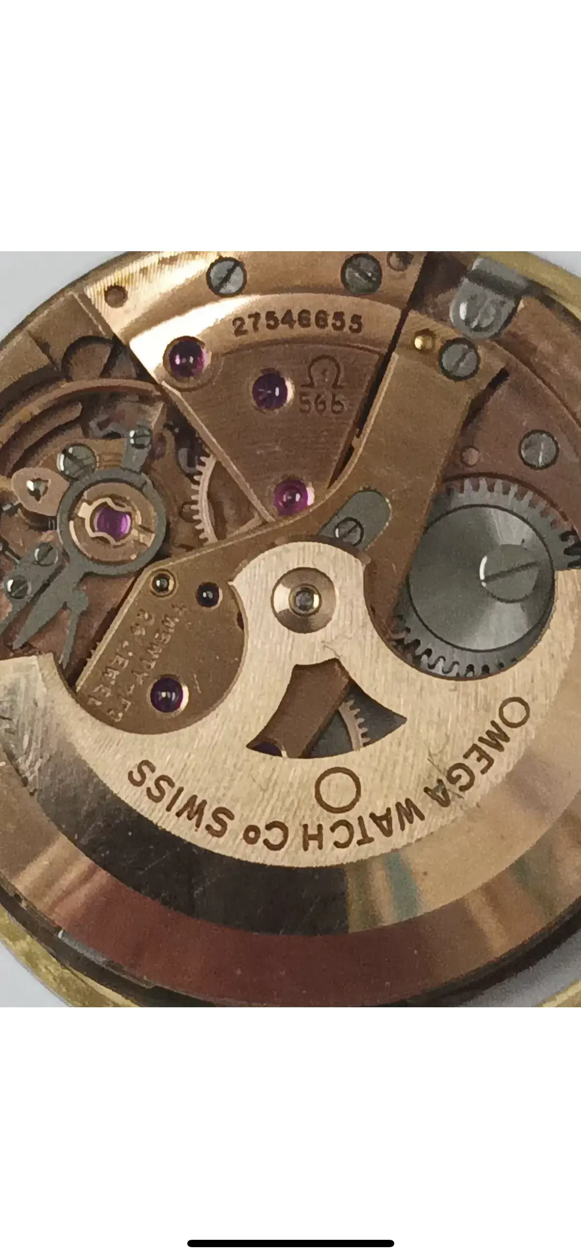

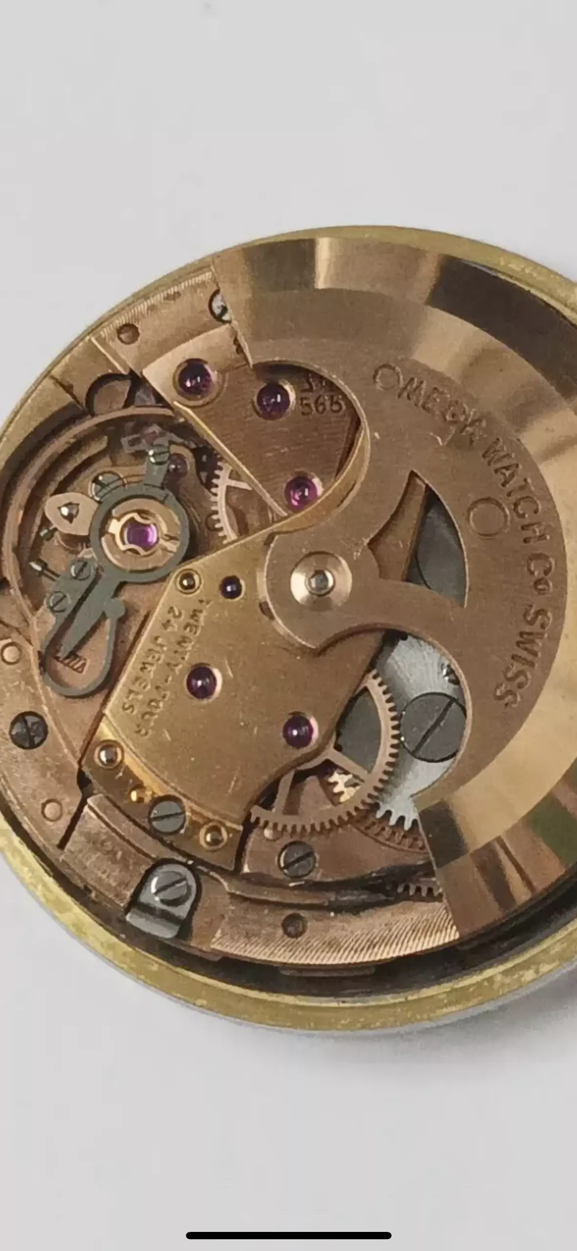

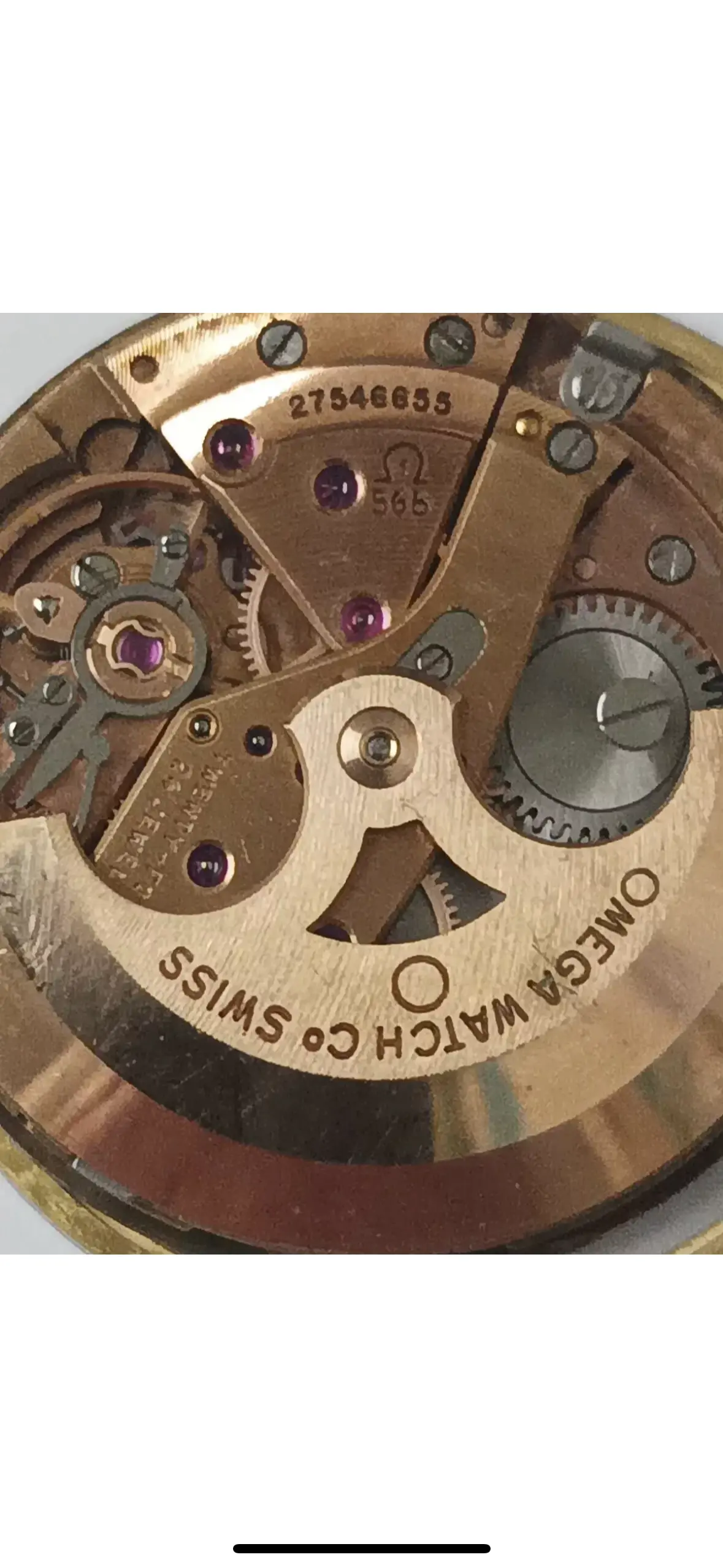

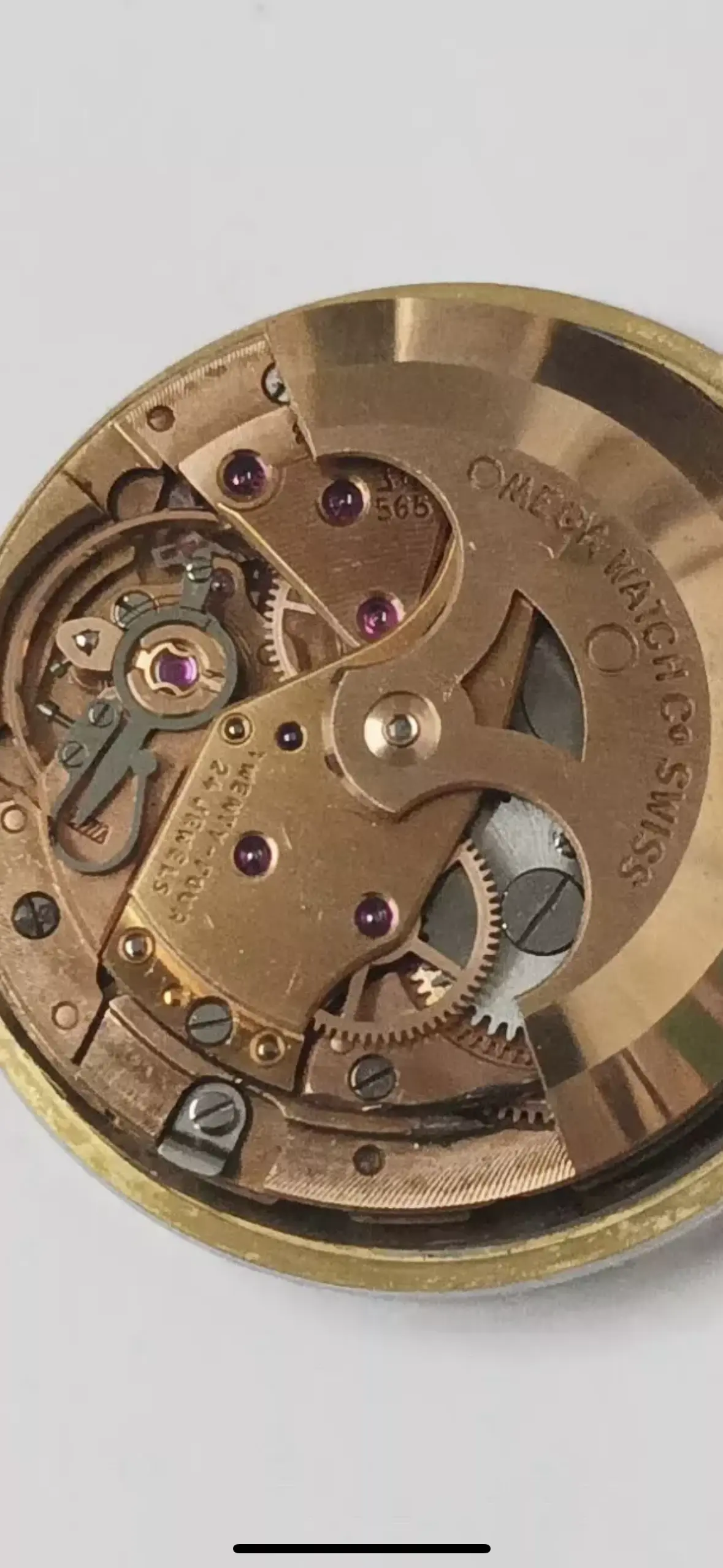

Does anyone see that there appears to be no balance wheel ?
Look closer 😁
it is a smooth balance so it is harder to see than the older style, but you can even see the hairspring.
