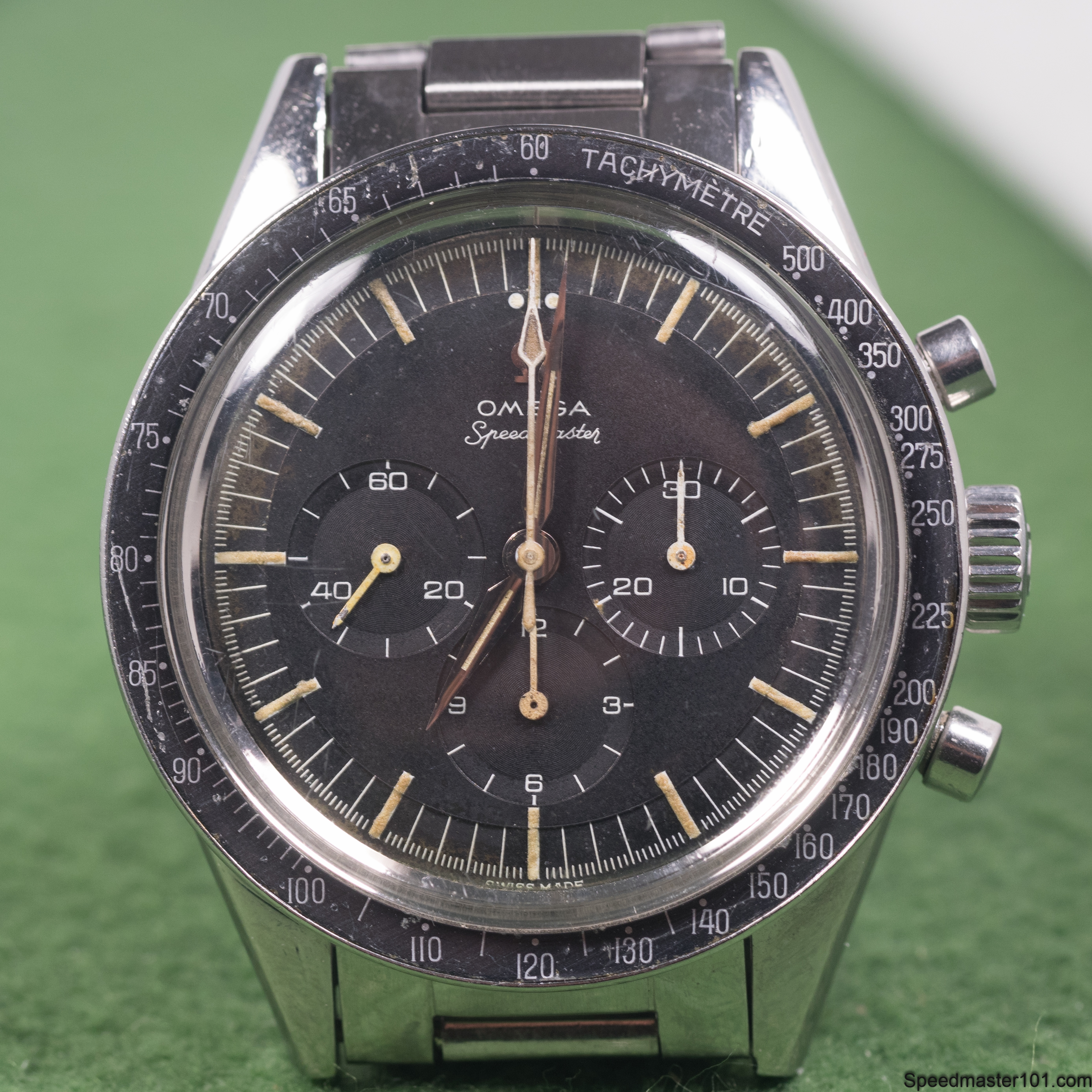

Here is an example of a early 002, note the H/M hands are modern, but aged to match
Here on this pic we see the correct dial for a 105.002. The swiss made is without the TT and fits perfect inside the silver rehaut covering only half of the swiss made writing. This is how it should look like.
The dial of the discussed example is from a 105.003.
Look at this pic of three 105.003's that I took a couple of years ago:
The left one is the modern service dial from Omega for that watch. In the middle you see a beautiful chocolate dial and this watch has got the silver rehaut from the 2998 inside. Just look, how the 105.003 is slightly to big and how the T swiss made T and the outer printing is covered too much. Just as we see it here.
The 105.003 on the right has the correct dial and the correct black rehaut leaving space to see the full printing.
None of these dials (002 or 003) has the same design as that of the one in question so a better proof would be an all original 003 having the same dial. Your picture is too small but based on what you said on the chocolate dial, I bet you could still see some parts of the Swiss Made marking which is different from the other one. T or no T would largely settle this question for good.
