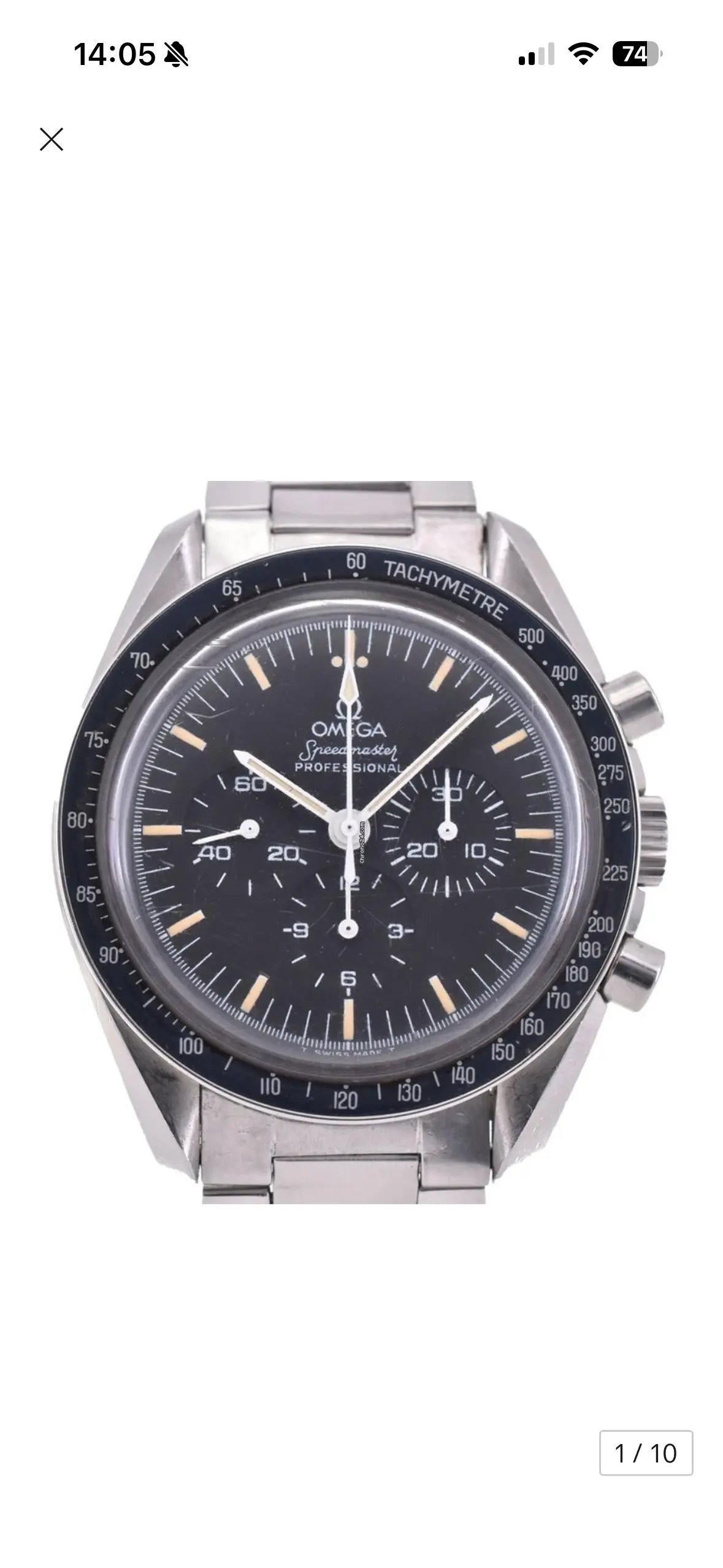

Hi all,
I am looking for my first vintage Speedmaster. Originally I was planning on buying a birth year watch, but realised I much prefer the appearance of the step dial. And it is nice to have a watch from around the time of the landings.
I will order Moonwatch Only, but in the meantime I would be interested in hearing whether I have assessed these watches correctly. I don’t have a huge budget, but would like to end up with a watch that I could wear regularly.

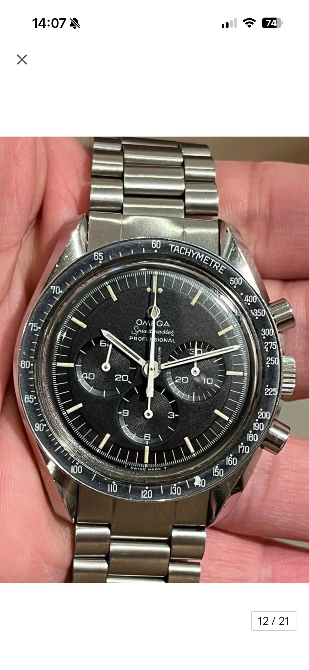

Watch 1:
  • Dial and lume look quite nice.
  • Some discolouration on hands.
  • Case looks ok
  • Incorrect bezel
  • No bracelet

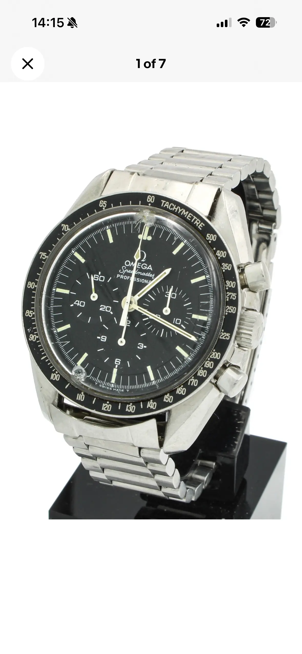

Watch 2
  • Wrong hands and bezel
  • Dial, movement and case look nice otherwise
  • No bracelet
  • Maybe will sell cheaply?

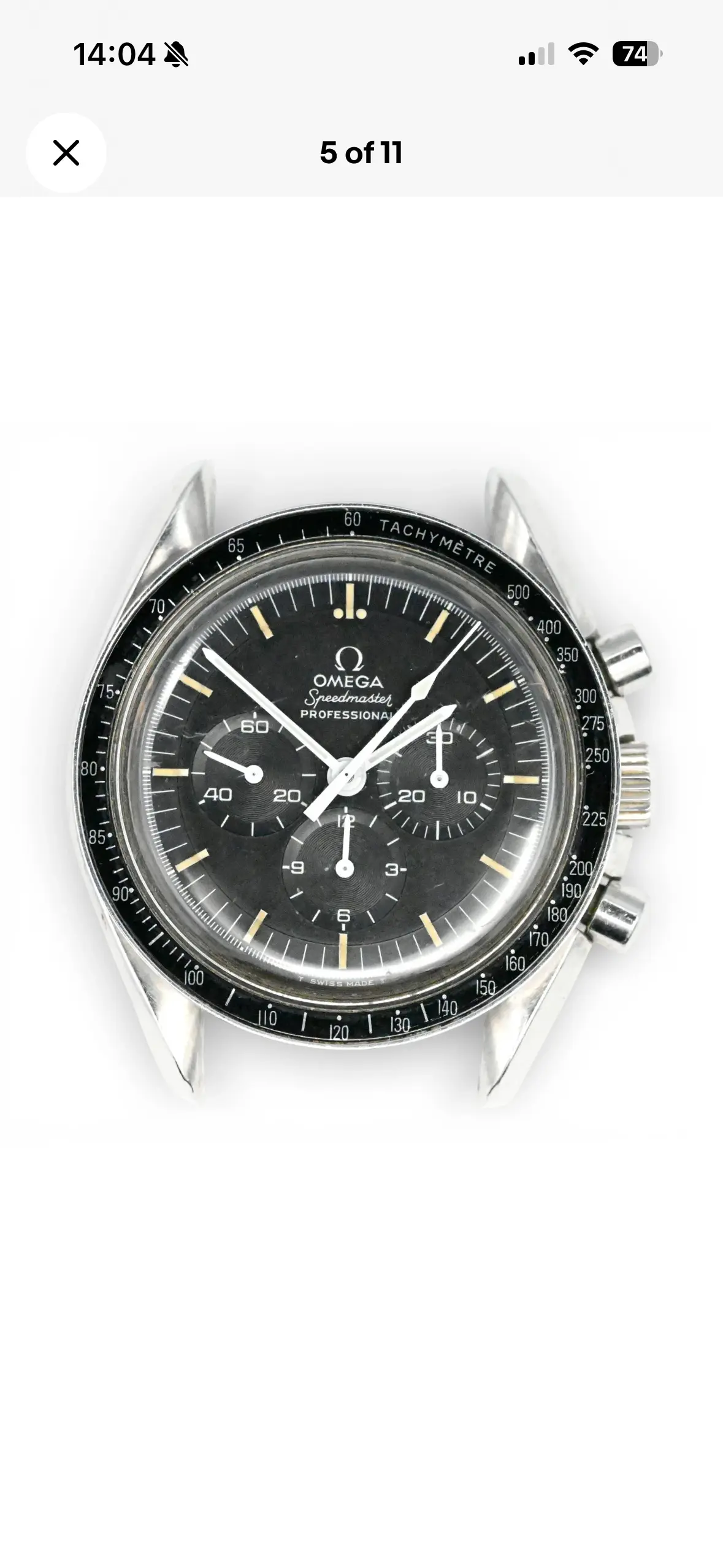

Watch 3

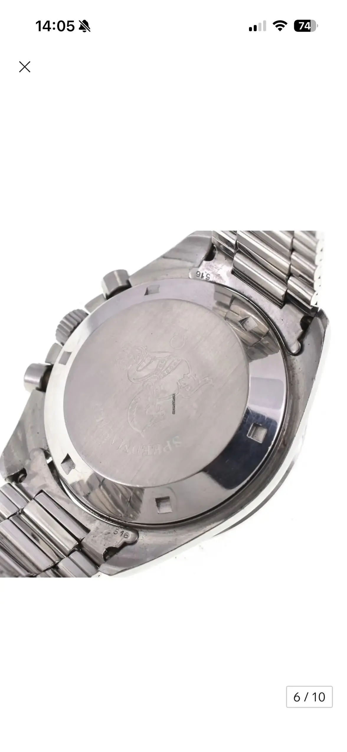

  • Looks nice overall but I think it has lost the step dial? Hard to tell in pictures.
  • Quoted serial number is much too late.
  • Bracelet.

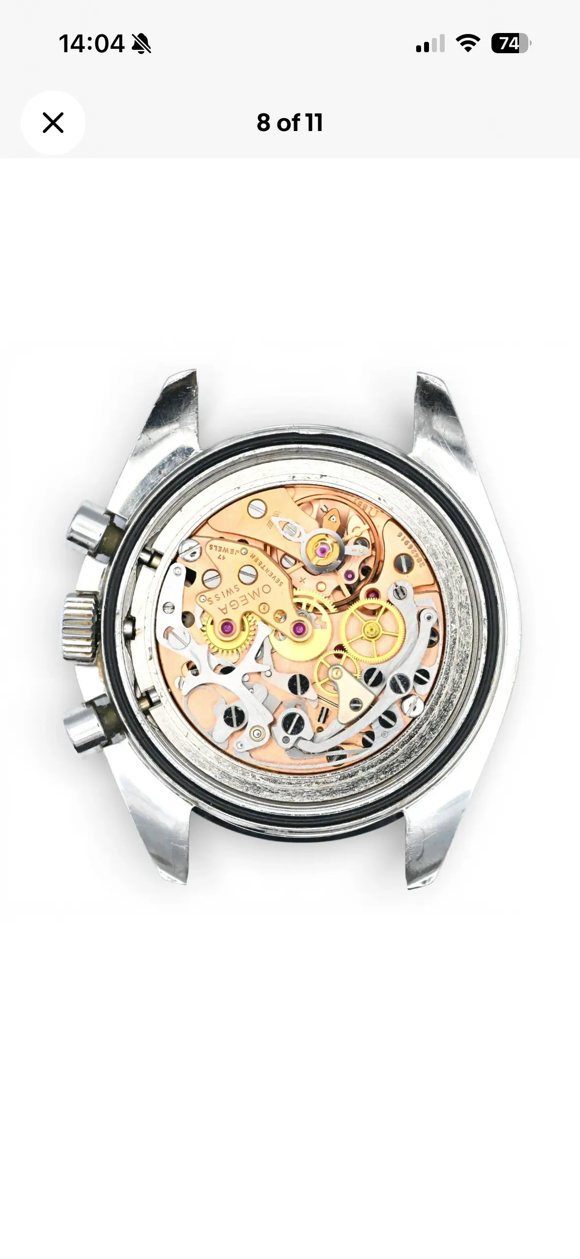

Watch 4
  • To my eye looks nice if a little faded.
  • All components seem correct.
  • Most expensive of the five watches.

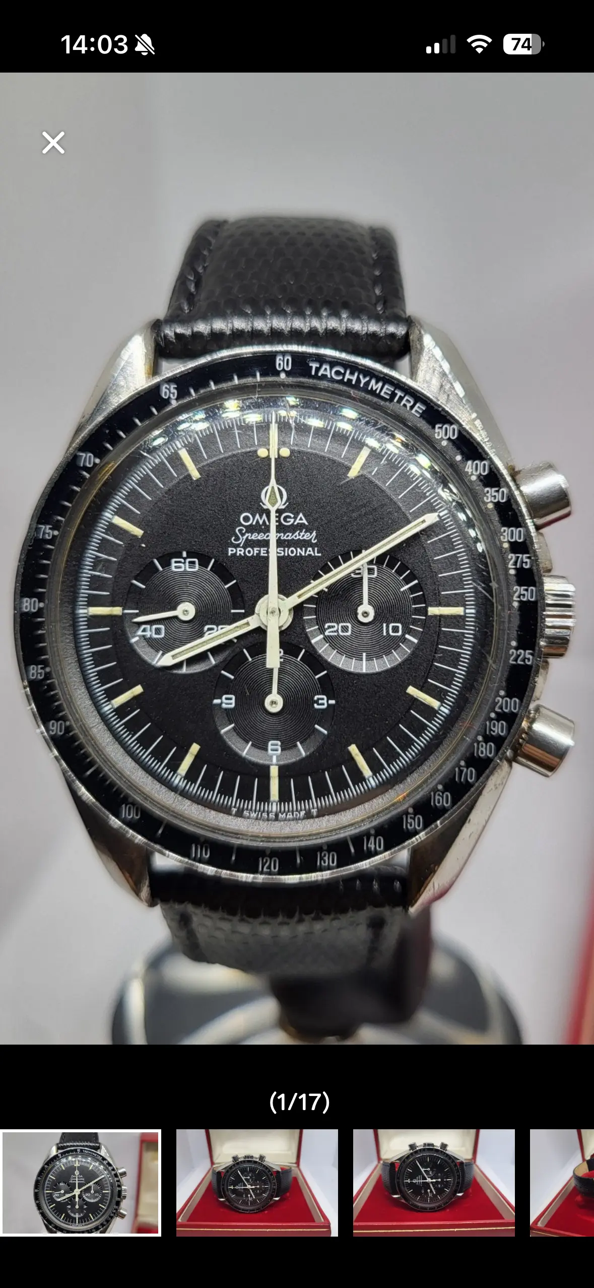

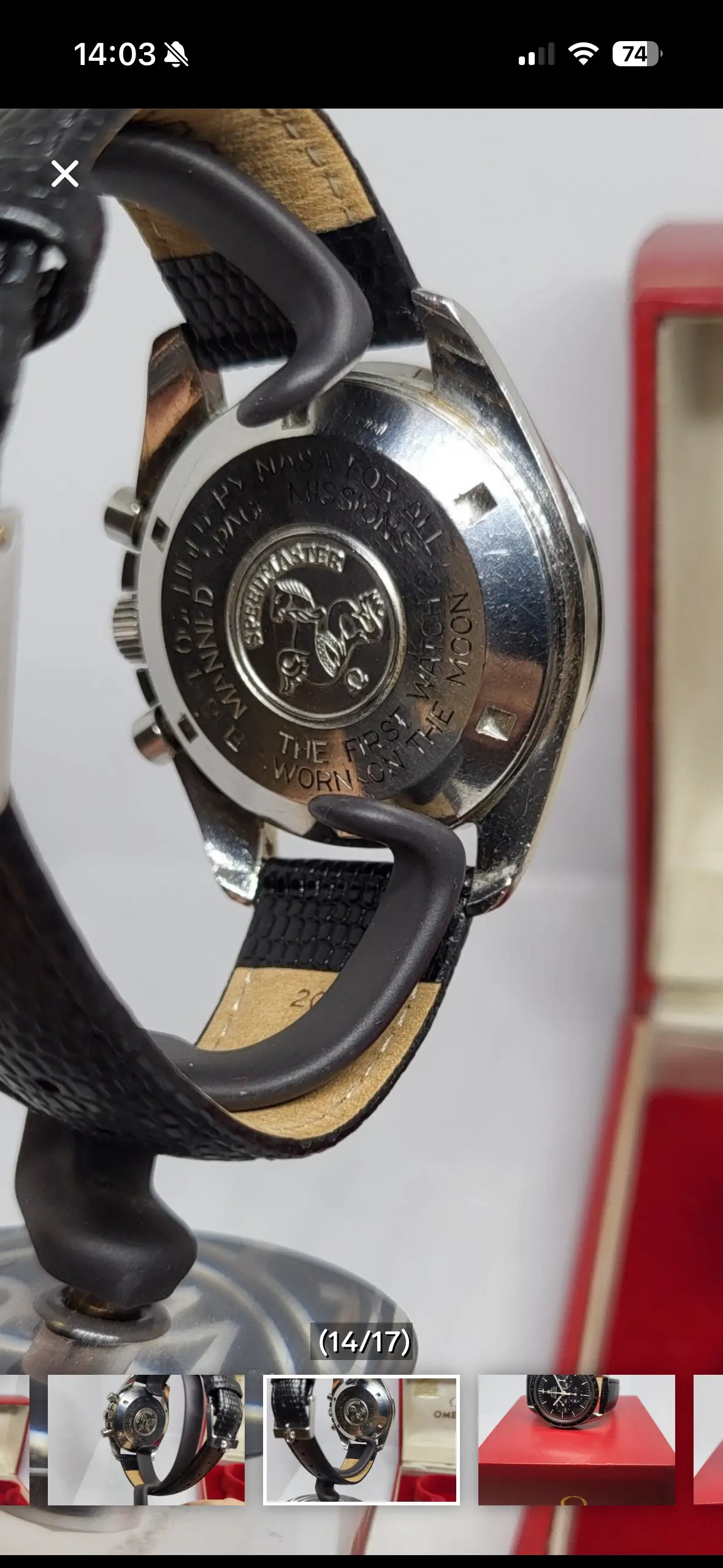

Watch 5
  • Needs tidying up.
  • Lume is washed from dial? Uncertain.
  • All components seem original.
  • Case could be over polished?
Please can you let me know your thoughts on these and whether I have judged them correctly? I am working on a tighter budget, but of course I don’t want to shoot myself in the foot by buying the wrong one.
Thanks in advance!

There is a reason why #3 is the most expensive. It’s the best one.

It's a lot to look through so I just took a quick glance. It seems that you have learned a lot, and if you continue to follow some auctions to completion and keep records, I think that you will have as good of a market sense as anyone. FWIW, it would be helpful to narrow it down to a smaller number of watches, provide more information (e.g. sub-reference, serial numbers, and prices if applicable), more photos (e.g. to evaluate case condition, crown and pushers) and fine-tune your questions.

Why do you say the bezel is wrong on #1?

There is a lot to wade through, but I think that #4 is the most expensive, the one with the ugly hands and the bracelet.
#3 looks nice, but seems to be a franken based on the partial information provided.

For the bezel on #1 is the font not wrong? From what I researched I think this is one from the 90s.
Yes, that's correct. I missed that while trying to look quickly through the watches. Good luck with the search.

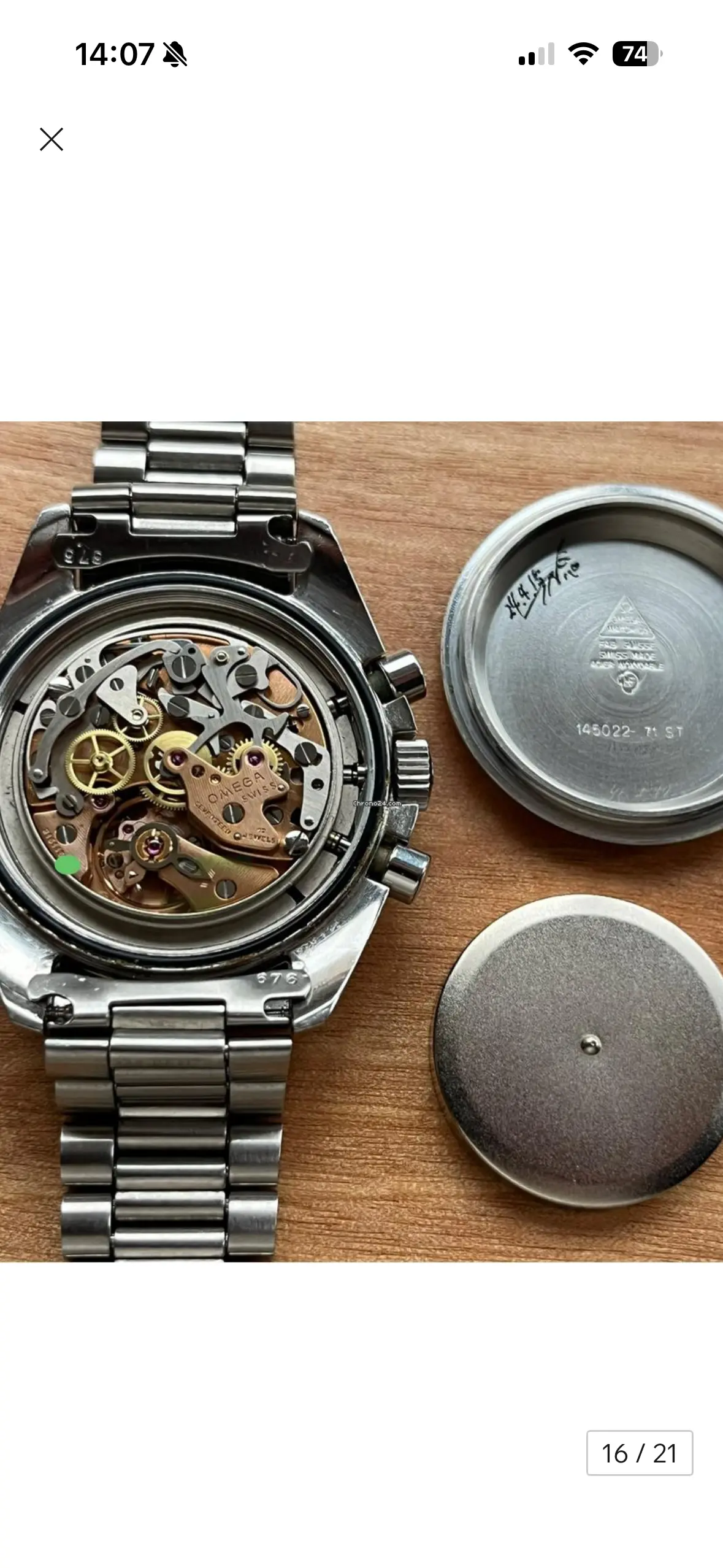

Watch 4 looks like decent -69 more pictures needed- what is asking price?
Watch 5 is -71 ongoing auction from known reliable estate seller
Both will need service. Do a deeper dive comparing those 2.
I would forget about watches 1-3

Watch 1 was the only one for sale here, but the asking price is around $6500 USD which seems very high for the condition.

Watch 5 was probably my favourite out of them as I think it would look quite nice after it was serviced. Plus from what I can identify all the correct parts are there. The serial dates to around mid 72 so that also seems correct.
The main negatives for me was that the lume is not a particularly attractive colour. And I was struggling to see if there was even any lume left on the dial. Plus I felt like the case was lacking definition, but it could just be the lighting/background.
I assume this would safely fit into the poor condition category so isn’t worth any more than around 2500 USD?
Watch 4 looked ok, but I wasn’t so keen on the lume lume/fade. It did have an archive extract which along with the originality is why I included it. That is around 4800 USD on Chrono24. But after I pay 25% VAT and for a service I don’t think I like it enough to justify the cost.
