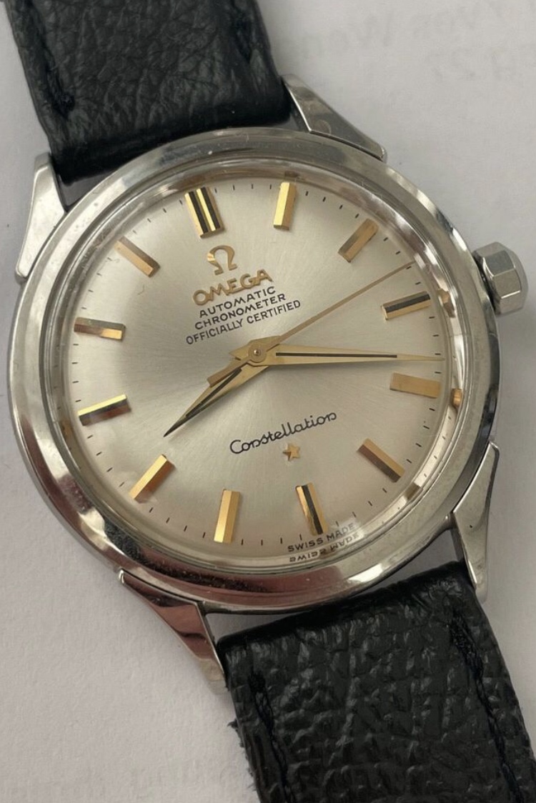

All right with this 2582 5 SC?
94
64
Hello OF,

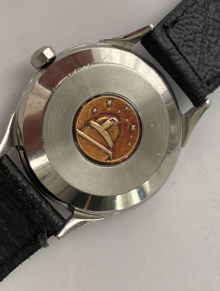

Nice Dial in my Opinion. Should the hands not be faceted? Also a bit confused about the brown, copper Cap. Bad sign or only patina?
Quite cheap for now, around 350 €
3,596
13,551
The discolored medallion would be the least of my worries.

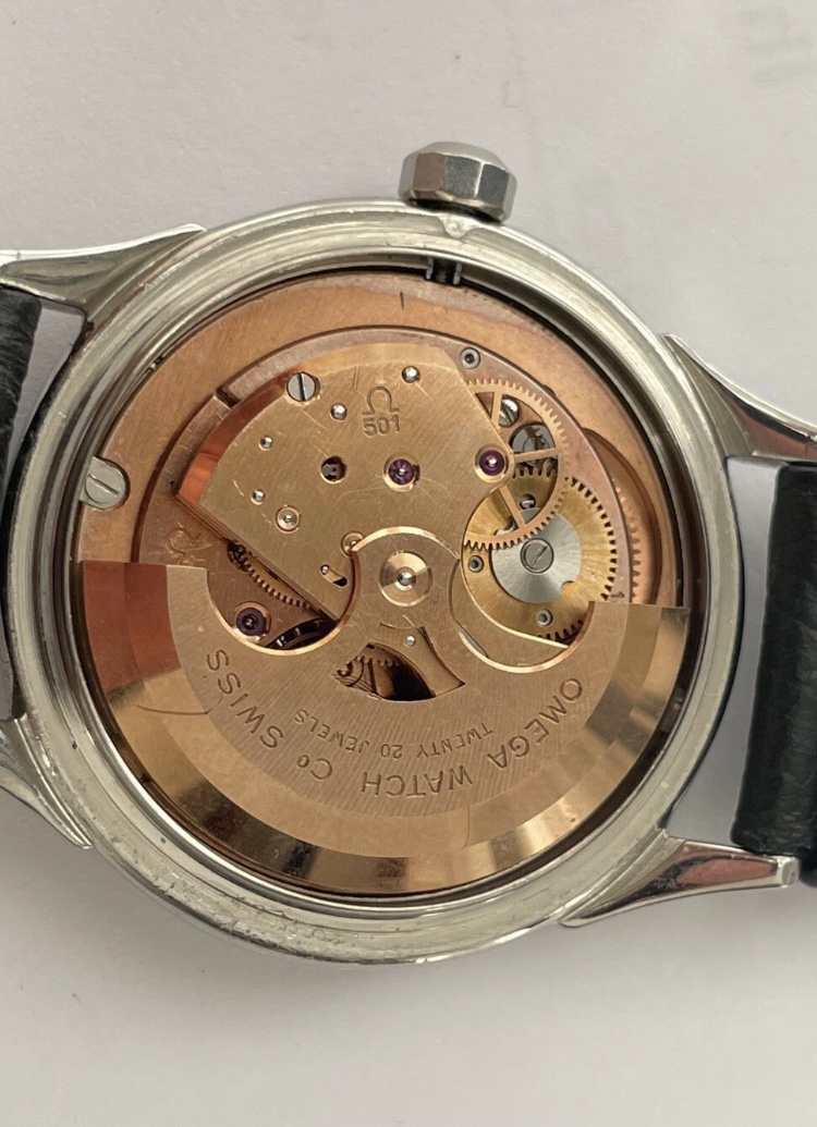

The movement does at least have the wrong rotor - or it’s just a transplant of a non-chronometer 501 into this Constellation. There shouldn’t be a sunburst dial in a 2852, and on top of that, the seller is well aware of that and chose not to disclose any of this in the Riccardo offering. The watch was offered on IG for 1000€ or so, when the issues were discussed in the comments he participated at first, then deleted the post. I’d be hoping for more transparent behavior, especially from someone with 14k followers - this is just plain dodgy in my book.
94
64
Thanks for sharing your knowledge! The watch was not what I’m looking for, but perhaps also interesting for some other readers or potential bidders here 👍
