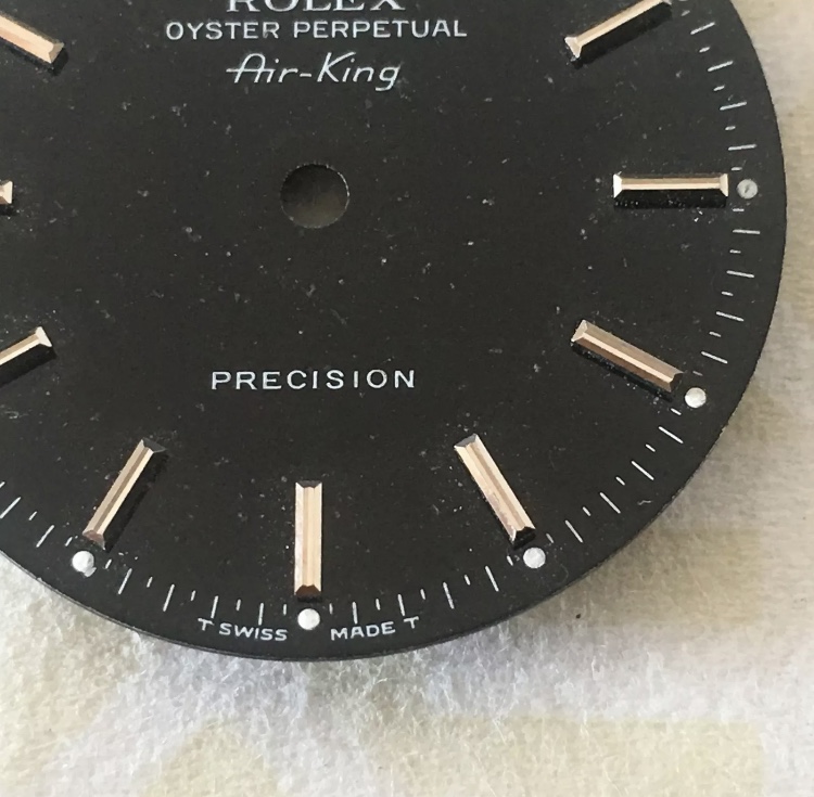

Hey Guys,
Thinking of changing out the dial on my 14000 Airking as I find the silver on silver near impossible to see in lower light (aging eyes) and selling mine and hunting down a black one is far more hassle than just swapping the dial out.
Wondering if you guys could verify is this is authentic or not. Seller has tons of positive feedback so that’s a good start.
Dead Link/rover/0/0/0?mpre=https://www.ebay.com/ulk/itm/383093146922

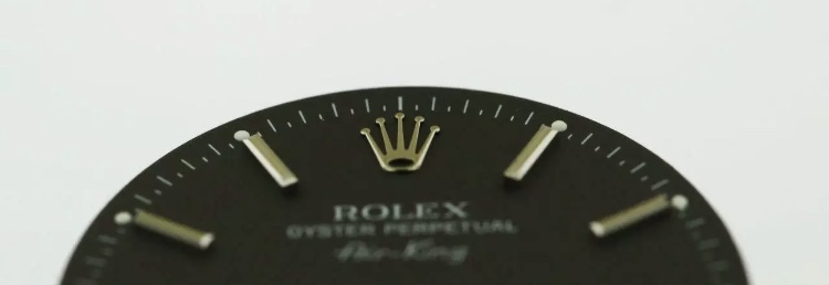

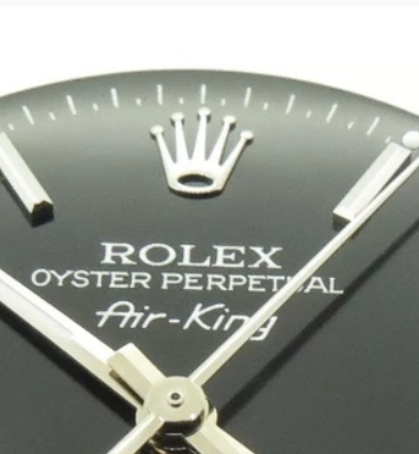

Is the middle of the coronet a bit off or it is an optical illusion?
This is why I ask here!! Keener eyes than I. I have read in other threads here that they are hand applied and sometimes can be a hair off- higher or lower but not sure about crooked.
Anyone?
1,615
3,862
A bigger version of this picture could be useful :
ca73e2d8-f988-432b-ba9a-d1b2541937fa-jpeg.822799
To repaint the dial, the indexes would have to be removed, and put back again. Impossible to do without leaving marks. Here, I'm not sure.
Also, not 100% sure about the lume plots.
I held the screen 30cm away, shrunk the image to equal the diameter of the dial and couldn’t see the flaw.
1,440
3,774
What about now?

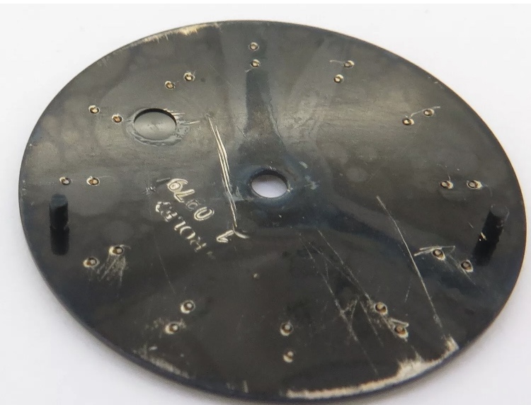

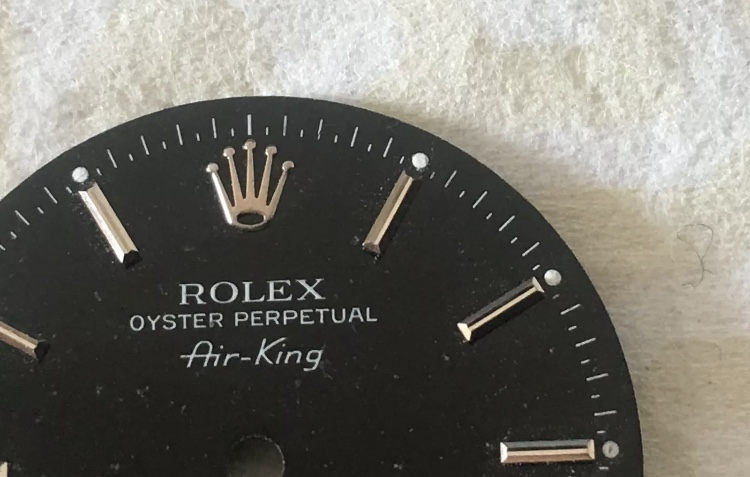

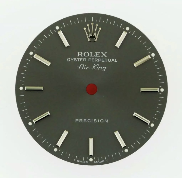

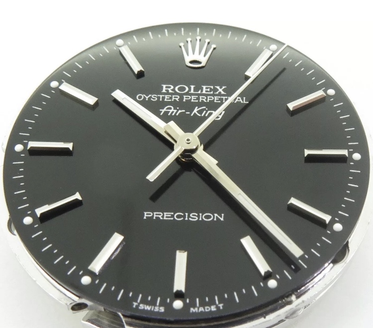

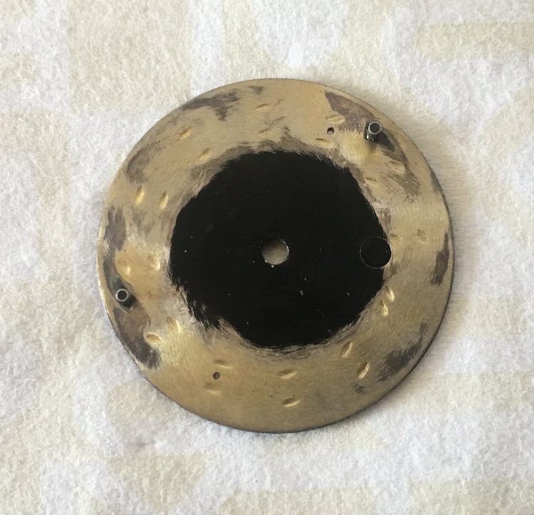

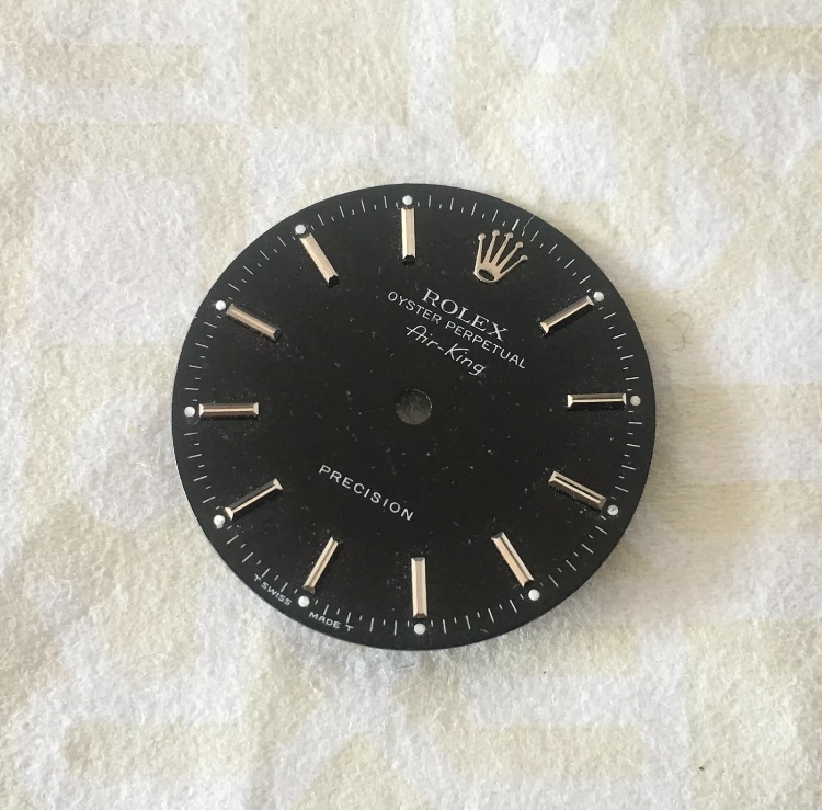

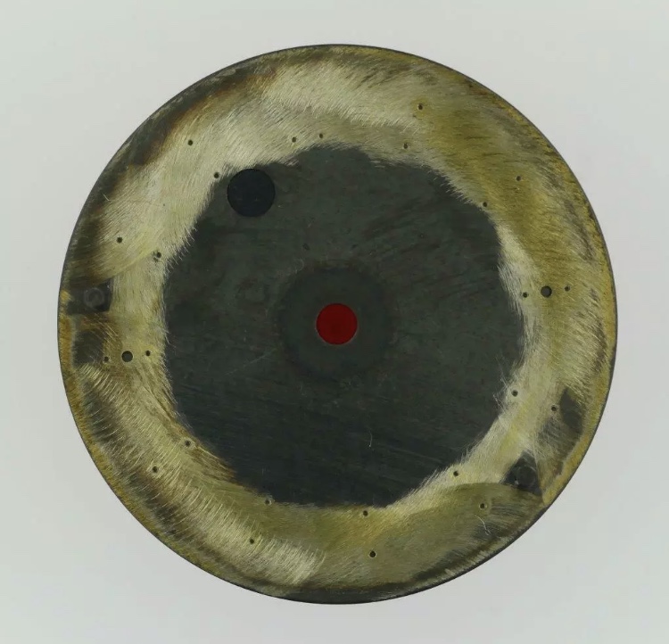

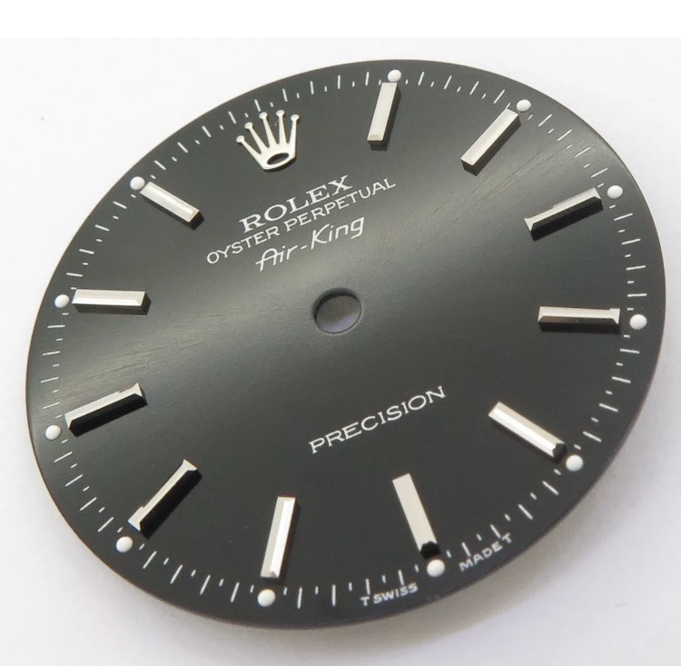

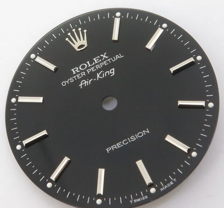

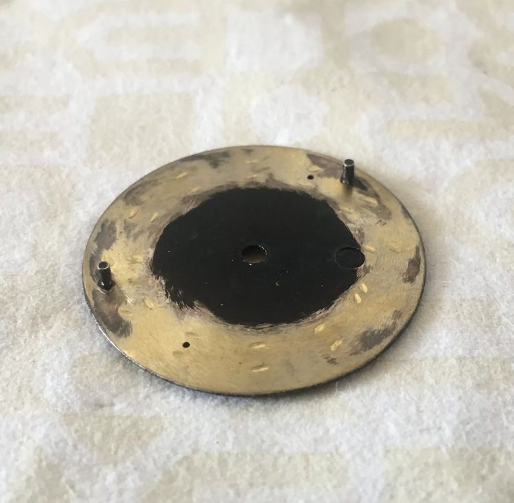

Here are a few comparison images from two other dials, one currently listed (but not nearly as clean) and another finished auction-both state genuine Rolex. The finished back on the above is what has me scratching my head as it’s not like the others.
I would love it to be the real deal as it’s so clean and it comes with hands, but obviously I wouldn’t have posted it here if I weren’t sure.

And one other thing I am noticing, the coronet on the one in question seems very flat whereas the other two seem more rounded.
But that may be me just trying to see problems now.

The ‘T Swiss Made T’ aligns differently, on the proffered dial
Personally, I would not endorse that dial as authentic

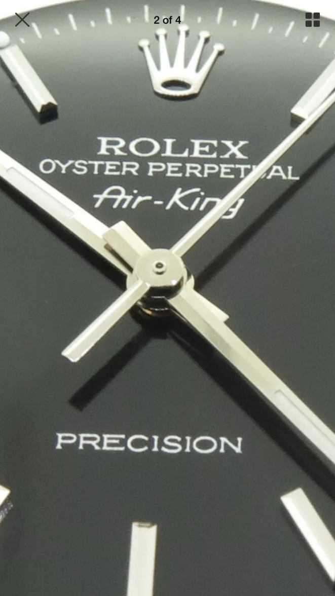

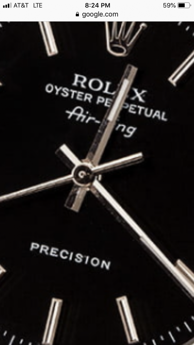

So, looking closely again- there seems to also be differences in the text- the one I linked above has serifs on the letters and the ones from the other auctions and from the screen shot from Bob’s I am posting below don’t....hmmm
Bob’s screenshot
eBay dial

And I agree with you, it’s seemingly perfect. If it’s a fake it’s an excellent one- the sunburst on the dial is excellent and the lume pips and minute track are perfect. This is a tough one as I don’t want a fake, and shipping it back to AU is a pain despite the 30 day return. I know to some it’s only $400 so doesn’t seem like much of a deal but it’s the principle of doing my due diligence.

Not trying to split hairs here-the 14000 had a long run so I’m sure there were variations. Just want someone who has has taken these things apart to see the serif text and the back and say- that’s totally a fake, or yeah, that’s the real deal.
