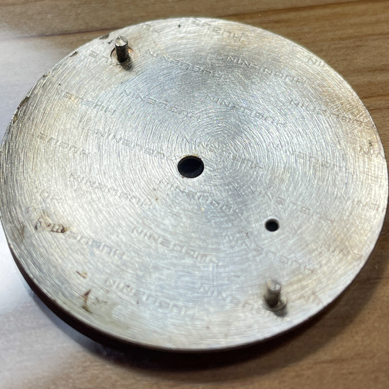

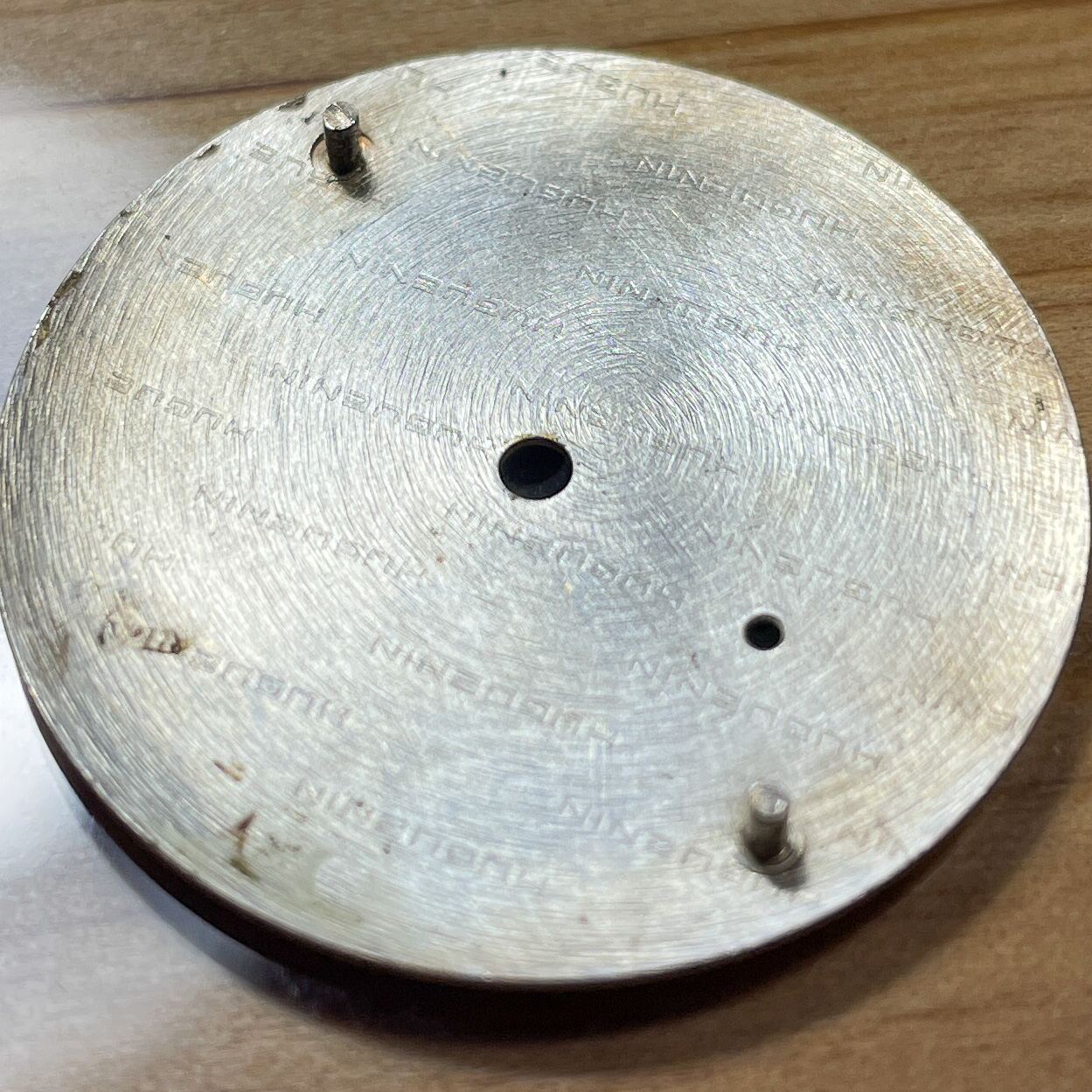

I managed to dissasembe the watch today in order to overhaul it and took some closer photos of the dial and its back.
The maker appears to be "HUGUENIN" and from a closer looks this is not a redial, in my opinion.
I would appreciate it if someone else with more experience on the subject could help me.
13,676
19,044
Could be a factory replacement (service) dial. Logo is still not right for a late 1950's watch.
These things happened.

In this case, would I be able to receive an 'extract from the archives' or it will be considered as a 'fake'?
13,676
19,044
Omega will give you the extract based on the case and movement. They will not opine on the dial.
gatorcpa
24,836
55,255
Later OMEGA font on a radium dial. 😕 It really seems like that text must have been reprinted. Strange. Anyway, I don't think it will stop you from getting an Extract.
