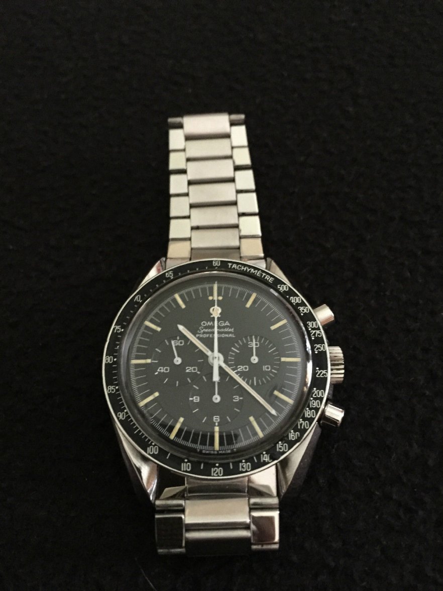

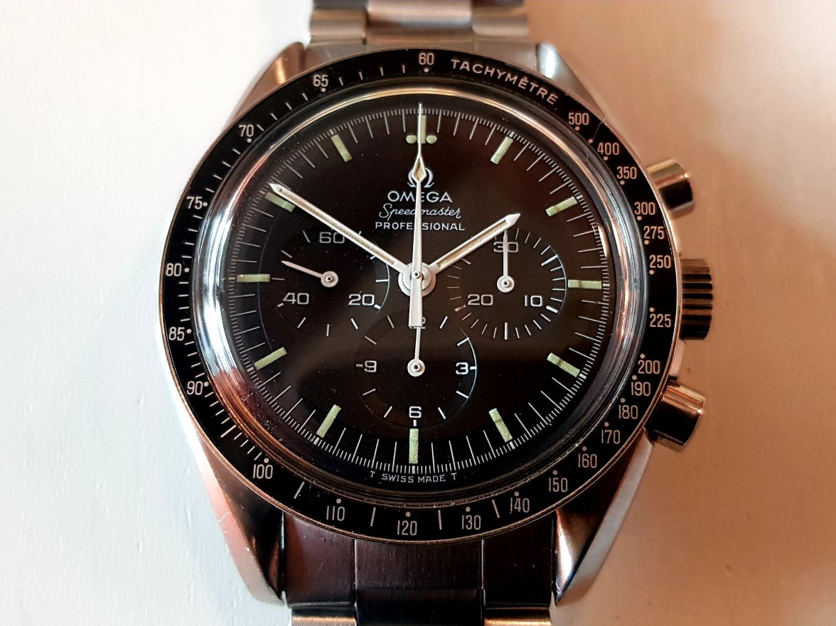

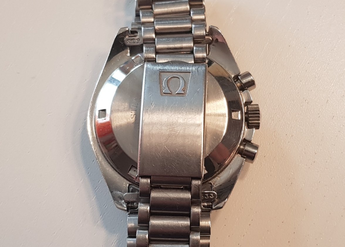

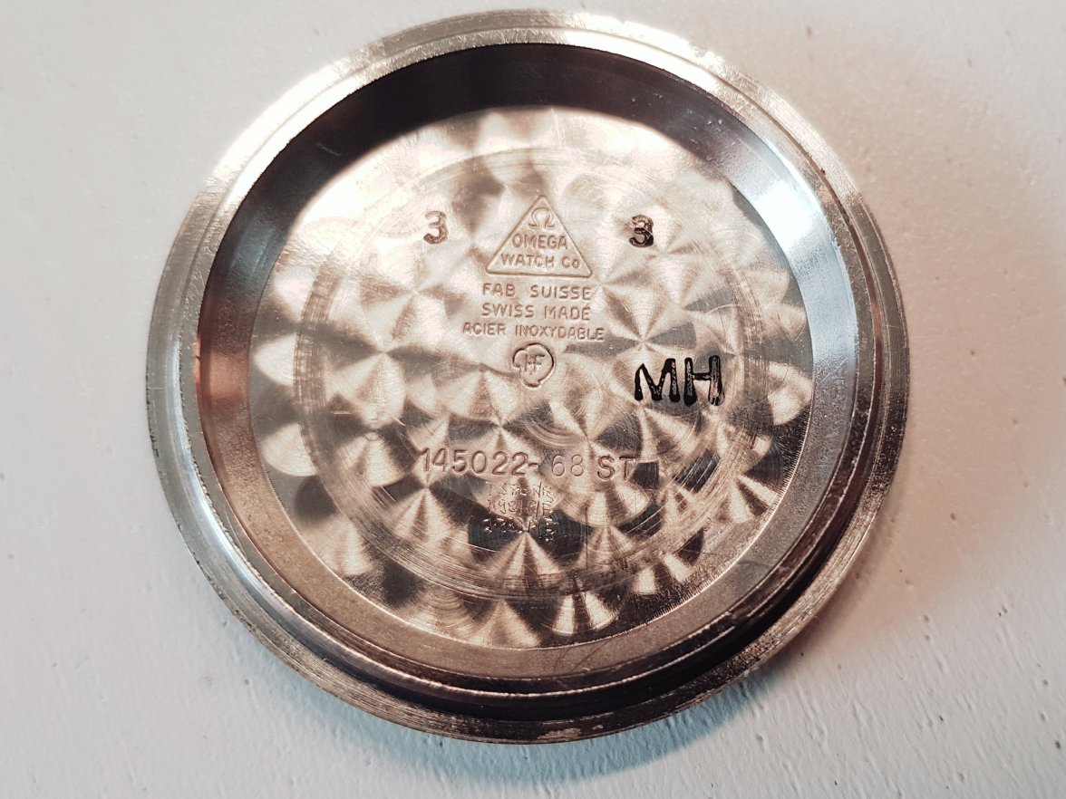

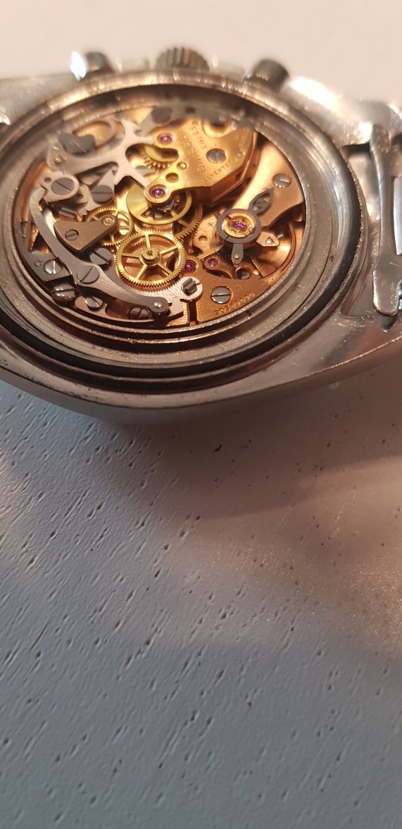

    I have been lurking around small ads and I came accross a 145.022-68 speedie. I just wanted some thoughts and help from experts there.
    Everything looks good and original, except for the 861 movement, if I read the serial correctly it's supposed to be from 1971...
    The seller is asking 4900$ open to discussion.
    Thanks for your help ! 20190315_151946.jpg 20190315_152310.jpg 20190315_151758.jpg 20190315_151602.jpg 20190315_130511.jpg 20190315_130251.jpg
    Here are some pics :

  3. MaiLollo Apr 3, 2019
    1,560
    4,331
    It looks like a 30.5m serial number. It wouldn't be correct for a 68.
    Maybe it would look more like a 69 who has had the caseback swapped? Bezel is a modern service part.

  4. snake.doctor Apr 3, 2019
    146
    288
    Can you teach me how you can say the dial and bezel are not correct for a 68 ?
    I tried to identify the parts with the speedmaster101 website and it looks like I missed something.
  5. boogedyboo Apr 3, 2019
    429
    908
    The dial should have an applied metal Omega logo instead of a printed one.
    The bezel should have the dot above the 90 and not next to it.
    MikiJ and connieseamaster like this.
  6. Screwbacks Apr 3, 2019
    1,682
    4,857
    those advices should serve as a warning signs .
  7. snake.doctor Apr 3, 2019
    146
    288
    I made the mistakes because I had read that some 68 have the painted logo on the dial. Well thanks for the informations. As usual this forum is very helpful for novices like me looking for help.
  8. Om3ga321 Apr 3, 2019
    474
    674
    The indices are also longer on a 68.

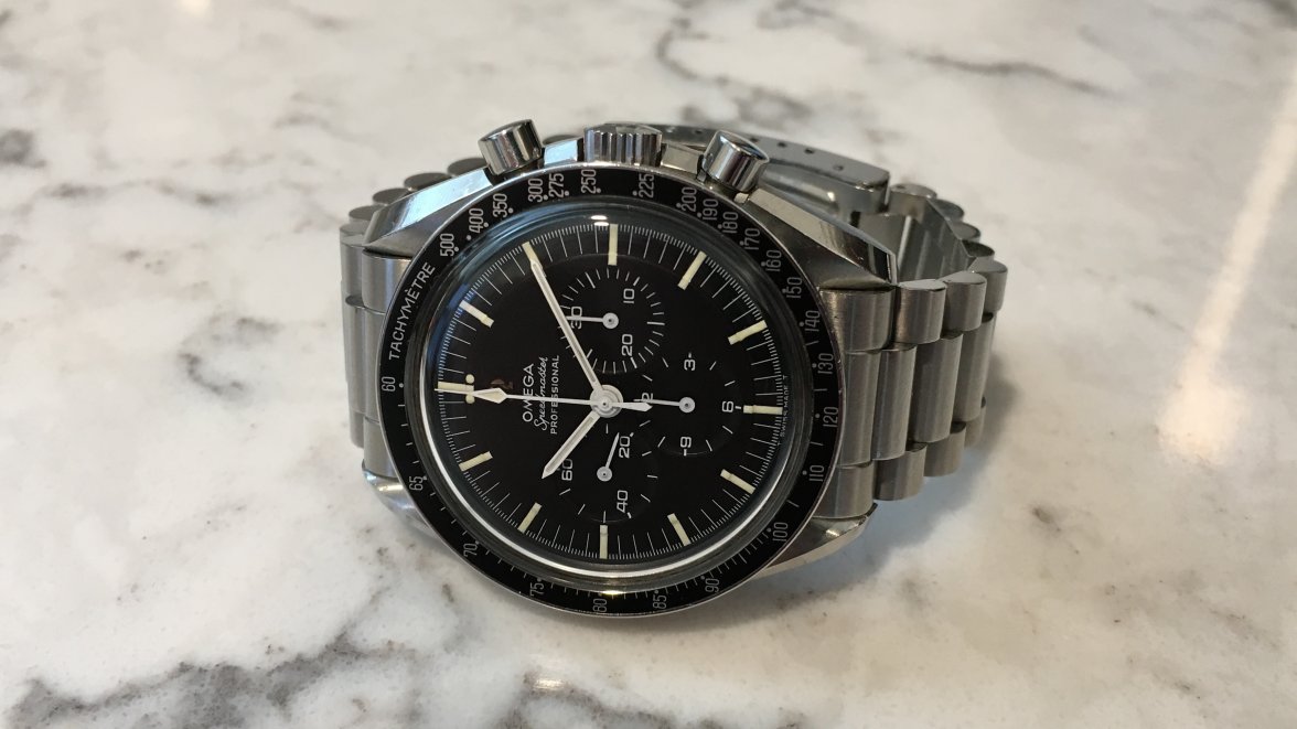

  10. gemini4 Hoarder Of Speed et alia Apr 3, 2019
    5,855
    16,579
    Here are 2 145.022-68 examples. Either chrono center seconds hand is considered correct.

  11. Pahawi Apr 4, 2019
    1,150
    3,360
    Drop end chrono hand on a 145.022? Thought the 145.012's were the last to carry those?
  12. gemini4 Hoarder Of Speed et alia Apr 4, 2019
    5,855
    16,579
    Humm. 145.022-68 Drop chrono second hand is
    Questionable in MWO 1st Edition.
    Not correct in MWO 2nd Edition.
    William says either is ok.
    Edited Apr 4, 2019
    ext1, Pahawi and TLIGuy like this.
  13. TLIGuy Apr 4, 2019
    2,014
    10,421
    Indeed. My -68 single owner Transitional with drop end chromo hand. Lots of fine example out there.

  14. Pahawi Apr 4, 2019
    1,150
    3,360
    OK - thank you :)
