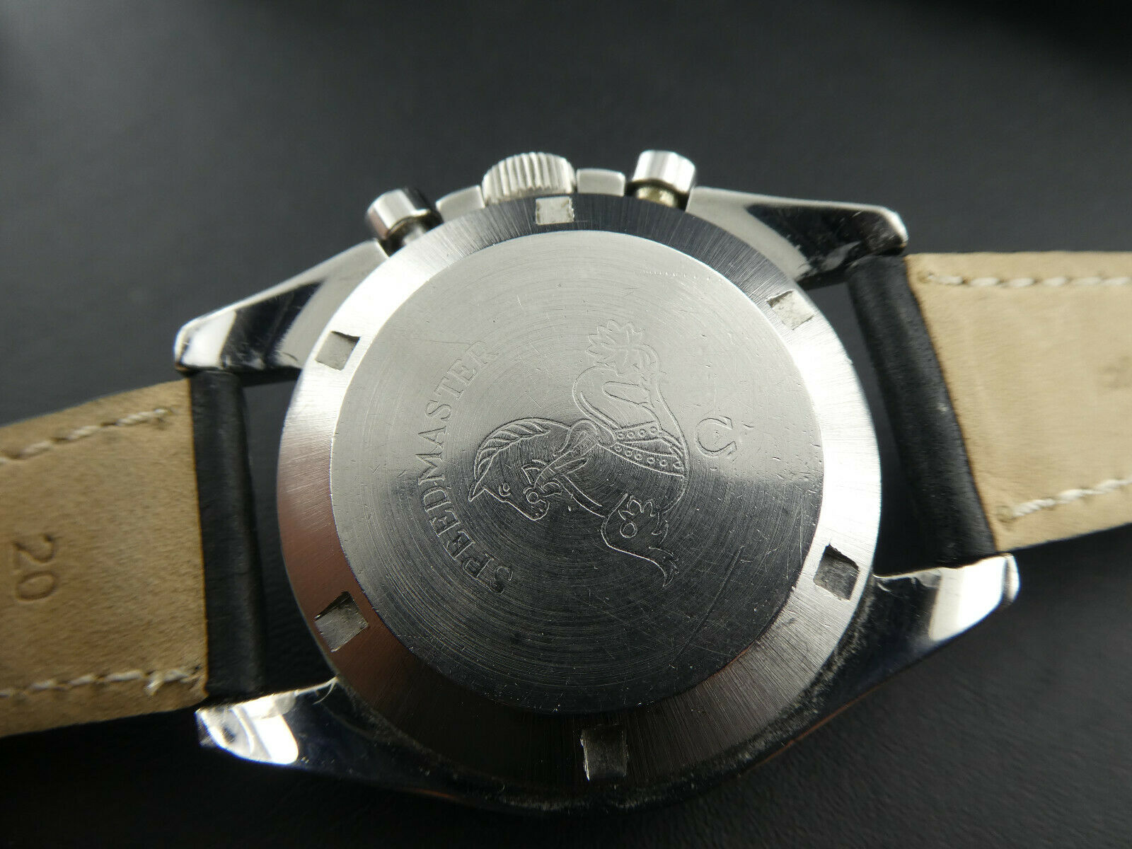

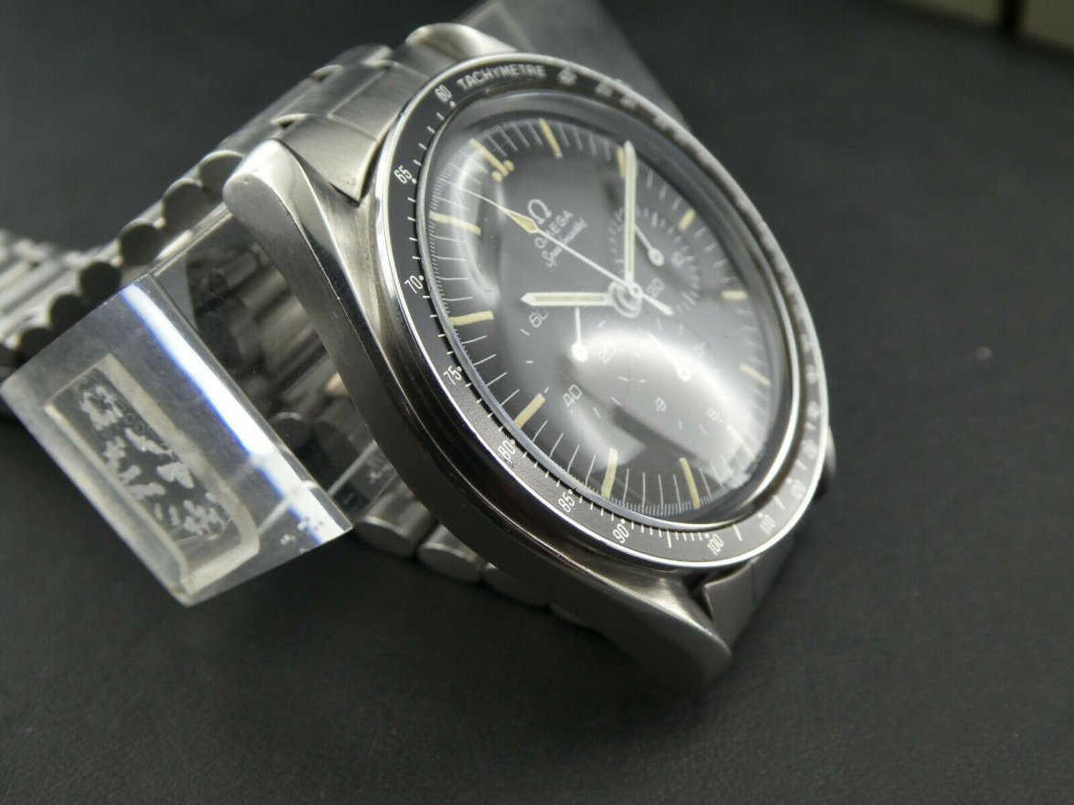

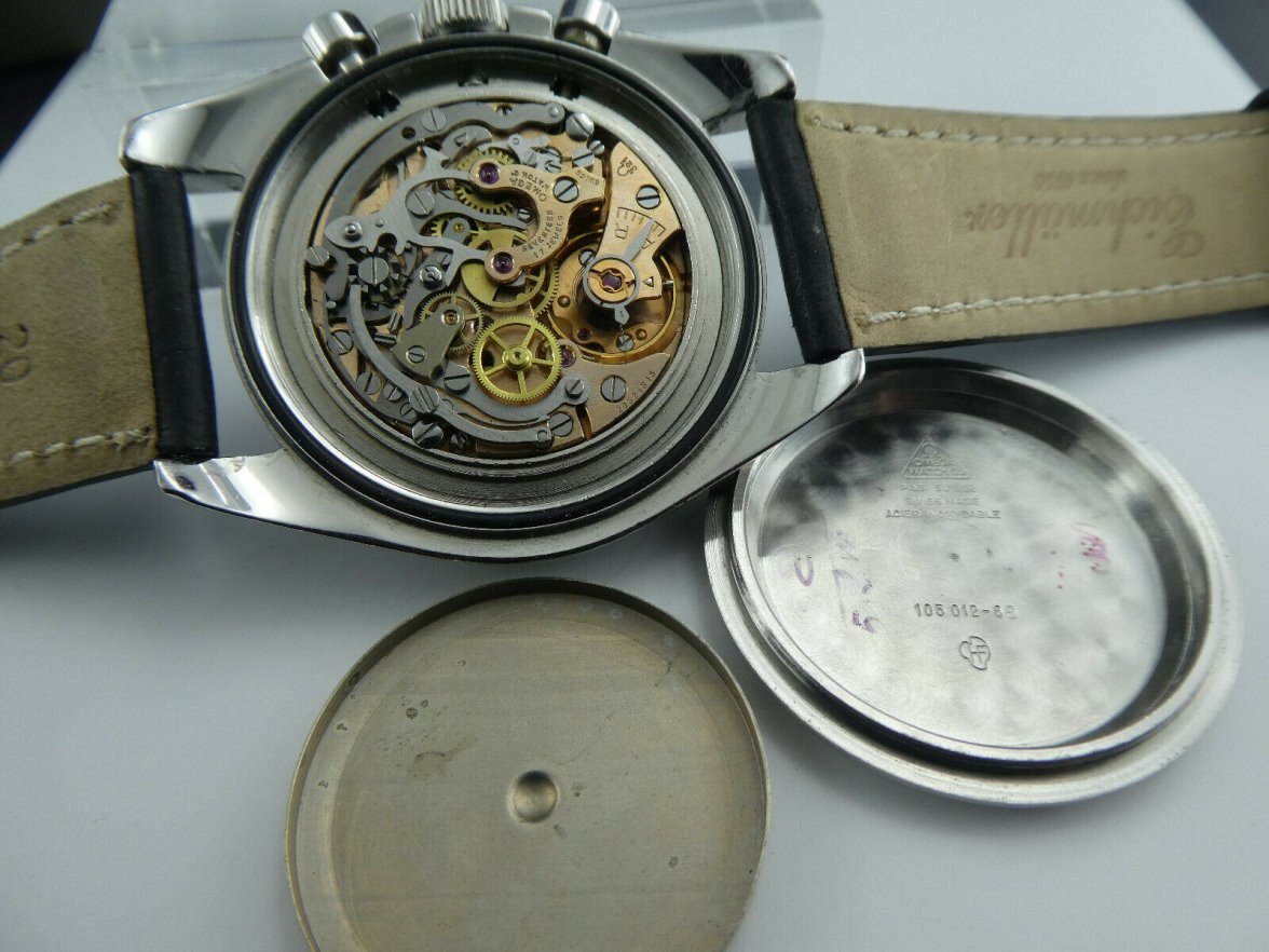

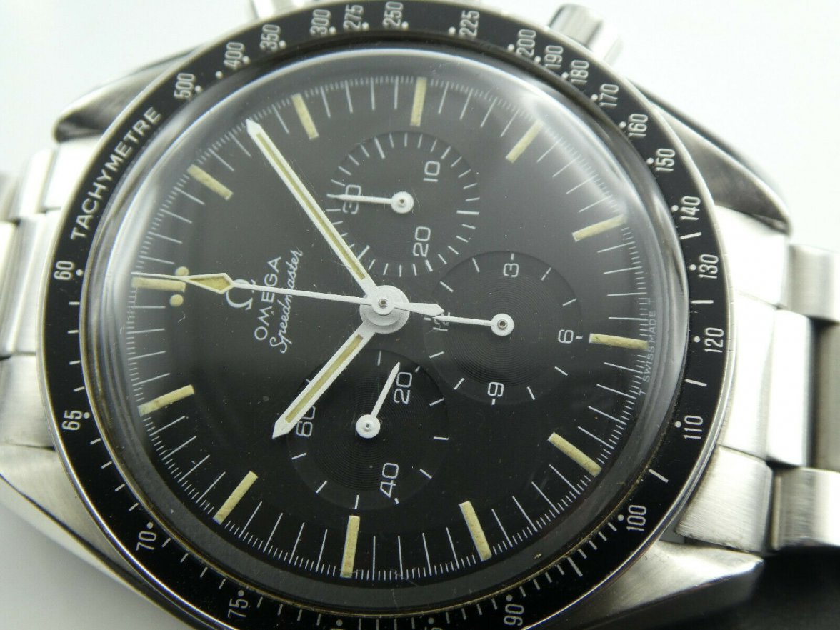

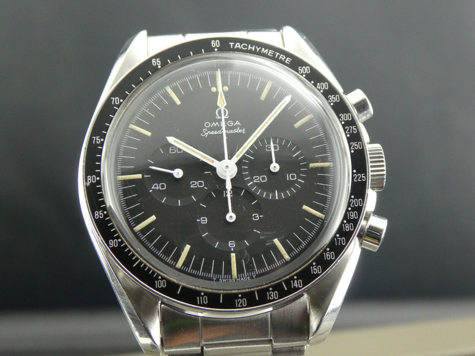

    Hi all, I am looking to buy a 105.012 or 145.012 (would be my first vintage watch/vintage Omega) but I want to get one at the right price and not get mugged. I've been doing a lot of reading and searching diligently and came across this, was wondering what people think?
    s-l1600.jpg s-l1600b.jpg s-l1600c.jpg s-l1600d.jpg s-l1600e.jpg s-l1600f.jpg

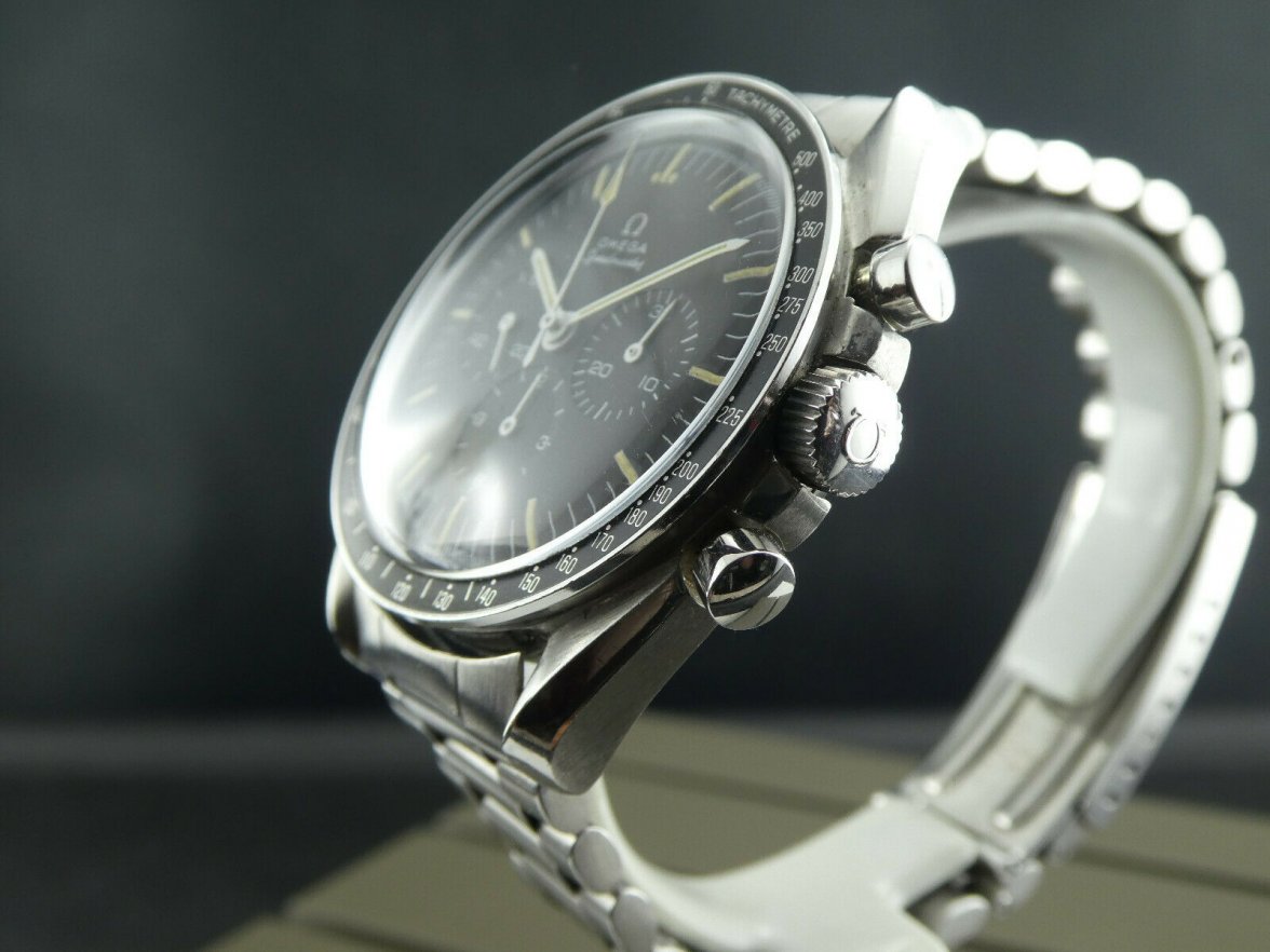

    I realise the bezel is a replacement and as a DNN the wrong type for the watch, I am also curious about the serial which appears to start 2052 1... which I believe would make it a 63 rather than a 66 as per the case back. Is that something to worry about? I can't quite figure out the crowns and pushers thing and whether they are original or not and how much it matters, but otherwise it looks good to me and thinking it might make a good first purchase?
    Seller is asking for Eur6900
  2. Kazyole Jul 9, 2019
    543
    1,897
    Should have an applied metal logo stepped professional dial. Avoid.
  3. Foo2rama Keeps his worms in a ball instead of a can. Jul 9, 2019
    17,103
    25,348
    Service dial. Domed, no aml, long indicies. And oddly narrow T’s.
    Late 80’s post DNN. Technically the DNN is only the version with the serif font.
    Edited Jul 9, 2019

    Dial looks off.

    Now that I think about it. Didn’t this pop up last week or so? I think there is a thread on it. The Narrow T’s on a service dial are odd.

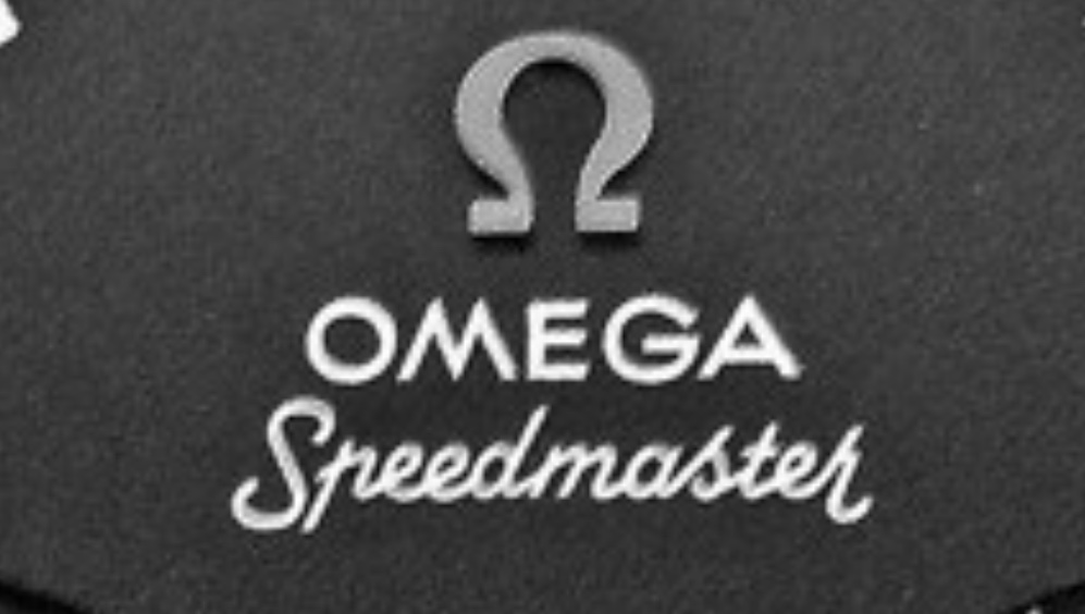

  6. airansun In the shuffling madness Jul 9, 2019
    2,520
    17,674
    Indeed. The dial is the most interesting part of this watch. Note the appearance of OMEGA on the dial.
    Would love to see the other side of the dial.

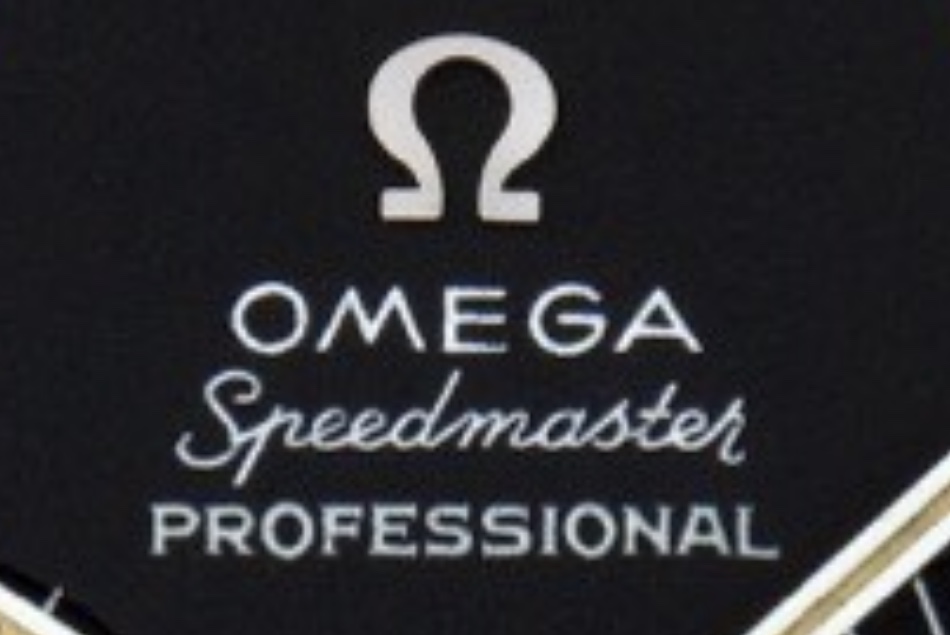

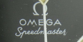

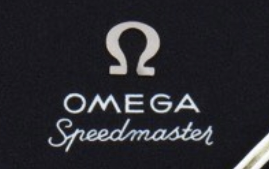

  7. airansun In the shuffling madness Jul 9, 2019
    2,520
    17,674
    For sake of comparison:
    This dial
    MWO service dial
    MWO A7 dial
    MWO B2 dial

    I postulate that service 321 dials where ordered in small batches post 1969. ( there might be pre pro service dials pre 69)
    As they had limited need and limited shelf life my assumption is that most of these batches had small differences on them as we see. I’d also assume the Speedmaster font roughly changed at the same time production 861 dials changed as they used the same masters for the screen print.
    This one is just really odd due to the narrow T’s.

  9. boogedyboo Jul 9, 2019
    429
    908
    Wrong dial, wrong bezel, wrong crown and serial number seems off. I would stay away from it.

    Everything about this watch is wrong, and whoever re-polished this caseback should get a... :whipped:
  11. aprax Jul 10, 2019
    315
    940
    For the sake of completeness let's also mention the service pusher at 4 o'clock. The movement definitely does not belong in this watch, see the symmetrical coupling yoke.

    You are being mugged.

    Wow - thanks all. Rookie mistake on my part I didn’t pick up on the lack of an AML which I 100% should have done as it’s one of the things I like about the 145.012 and 105.012. I put it down to a mixture of excitement and tiredness clouding my judgement. ::facepalm2:: In any case this is settled now, it’s just a bad watch all around and poor value. I’ll keep looking. Thanks again
