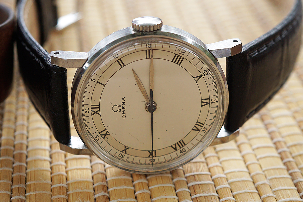

Here's a photo of a friend's contemporary model with a similar dial (less crosshairs) and hands, although a different case.
[credit to cicindela for resizing this photo]
A close inspection of this, and other, image(s) in my files leads to me to believe the dial and hands of the example currently offered on eBay are original. With a more suitable crown and case refinishing to bring it closer to original condition, the subject of this thread should find a home in an Omega fan's collection. A ~ 10% discount off the asking price would make the deal do-able in my book. (And no, I'm not the eBay seller!)
This contemporary model is quite attractive to me. Yum! Do you have any info about the model or reference? Thanks!
2,434
19,756
Sorry, I don't have that info at hand. It was acquired last year from a source in the Midwest that specializes in estate sales. And it's even more evocative in the metal than in that photo!
